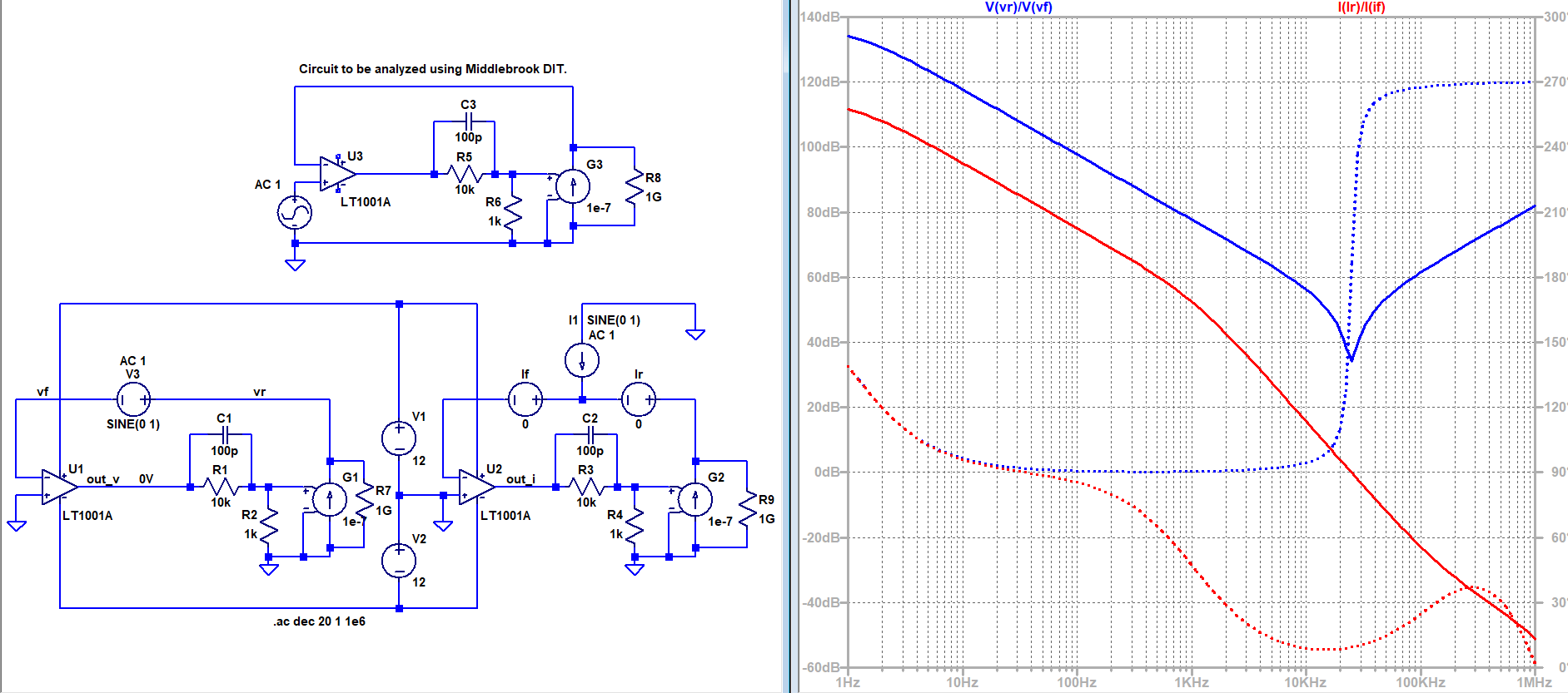

How would you interpret that claim in light of the fact that I can drive both CFA and VFA inputs with either current or voltage sources? Attached please find Middlebrook applied to a VFA to which a current source supplies feedback. Because of the use of the current source, Middlebrook demonstrates that c.f. predominates in this circuit, whose gain block is a VFA!
It turns out that if the impedance of the source seen by the feedback input exceeds that of the feedback input itself, c.f. predominates. Otherwise, v.f. does.
Looking at the schematics, I only understand that lower left part cannot work.
The voltage source in the feedback loop sees an infinite impedance from the current source, so that inverting input sees nothing.
I cannot see how to conclude anything of this scheme.
I tip my hat to you - you are correct! To remedy the situation, I added a 1 Gohm resistor across the current sources. Please see the updated attachments.
Middlebrook supplies the conclusion: there is more current feedback than voltage feedback in this circuit. And yet we've used a VFA as the gain block! How can this be?
It is because of what I have said before: To a good approximation for high loop gains, the ratio of current to voltage feedback at the inverting input of a circuit is a ratio of impedances: that of the feedback network (1Gohm in this case) to that of the inverting input (less than 1Gohm.)
Middlebrook does not reveal circuit topology; it only presents the voltage and current loop gains from which we can infer the feedbacks as described in the article I referred to.

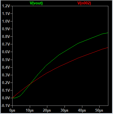

A demonstration of how the distributed nature of a real device can mimic a delay. This is a 5 stage R/C lowpass (1K and 2000pF) compared to 5K and 10000pF. This is grossly exaggerated a transistor like this would not even have 100kHz ft. If you saw this on a scope you would call it a delay but all ten devices have at least some current flowing instantaneously with applied step.

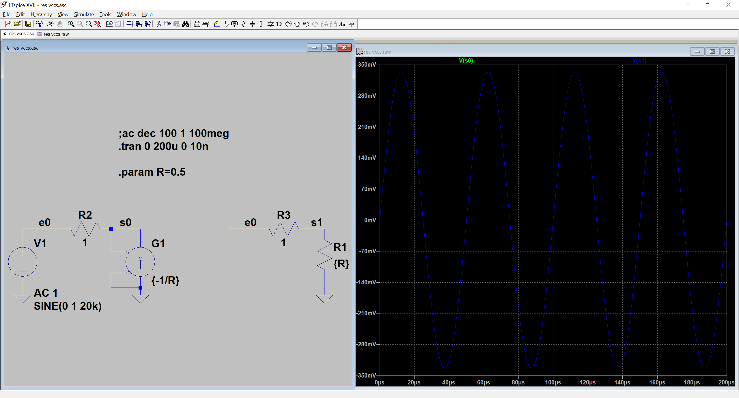

I'm not sure what you mean by "single device input." To me, by definition, a CFA's inverting input is connected to emitters/sources/cathodes. Current on demand is inherent in such a connection. And as long as the impedance of the inverting input is less than that of the impedance of the feedback network that that input sees, bandwidth can be held more or less constant as closed loop gain is varied. These characteristics are inherent in every CFA. They are not inherent in VFAs.
See attached. Current on demand is not inherent in CFA.

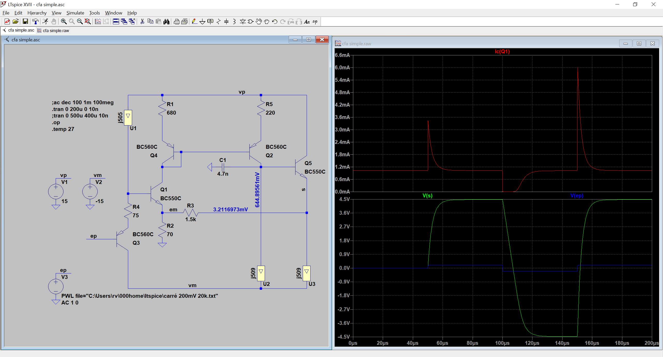

Constant bandwidth is easy to obtain with VFA, as current on demand.

I hardly think your circuit is representative. Would you compensate a practical amplifier like that - VFA or CFA?
Its not surprising you have 'COD' like behaviour. You simply shunted some of the current mirror output to ground via C1 (4.7nF!?), so the front end is driving hard to try to recover the shunted current via Rf. If you do that to a classic VFA you get the same behaviour but the output of the VAS slews because the LTP tail current is fixed i.e. one half of the LTP is likely to turn off. What you have demonstrated here is that if you **** the compensation, you can get 'COD'.
There is no argument that there are tweaks to the VFA topology that will give it some gain bandwidth independence and high slew rates. This is why we should be clear about what we are discussing. There is certainly a big overlap in the two topologies wrt to behaviour as the (open) loop gain is raised. But, to try to sort this whole CFA vs VFA thing out by arguing about the behaviour in the overlap area to my mind seems a waste of time.
But, the question remains, is your circuit a VFA or a CFA?
It could behave, small signal, like a CFA, but for lower closed loop gains (that is, lower R3/R2 ratio). Try R3=150 ohm and you'll get it.
For the R3/R2 as in the schematic it will likely behave (small signal) as a VFA.
The compensation is indeed poorly chosen; I would rather connect C1 between the Q2 collector and the Q1 emitter, resulting in a Faroudja compensation schema, but of course, more analysis is required. If C1 is connected as Faroudja compensation (and the amp is stable), then the (large signal) "current on demand" feature is guaranteed.
Or at least add a resistor in series with C1 to make a lead-lag compensation.
Of course it not representative of a realistic amplifier.
This caricatural scheme is to demonstrate that "current on demand" is not inherent to so called CFA but only to those which have a diamond (or similar) input.

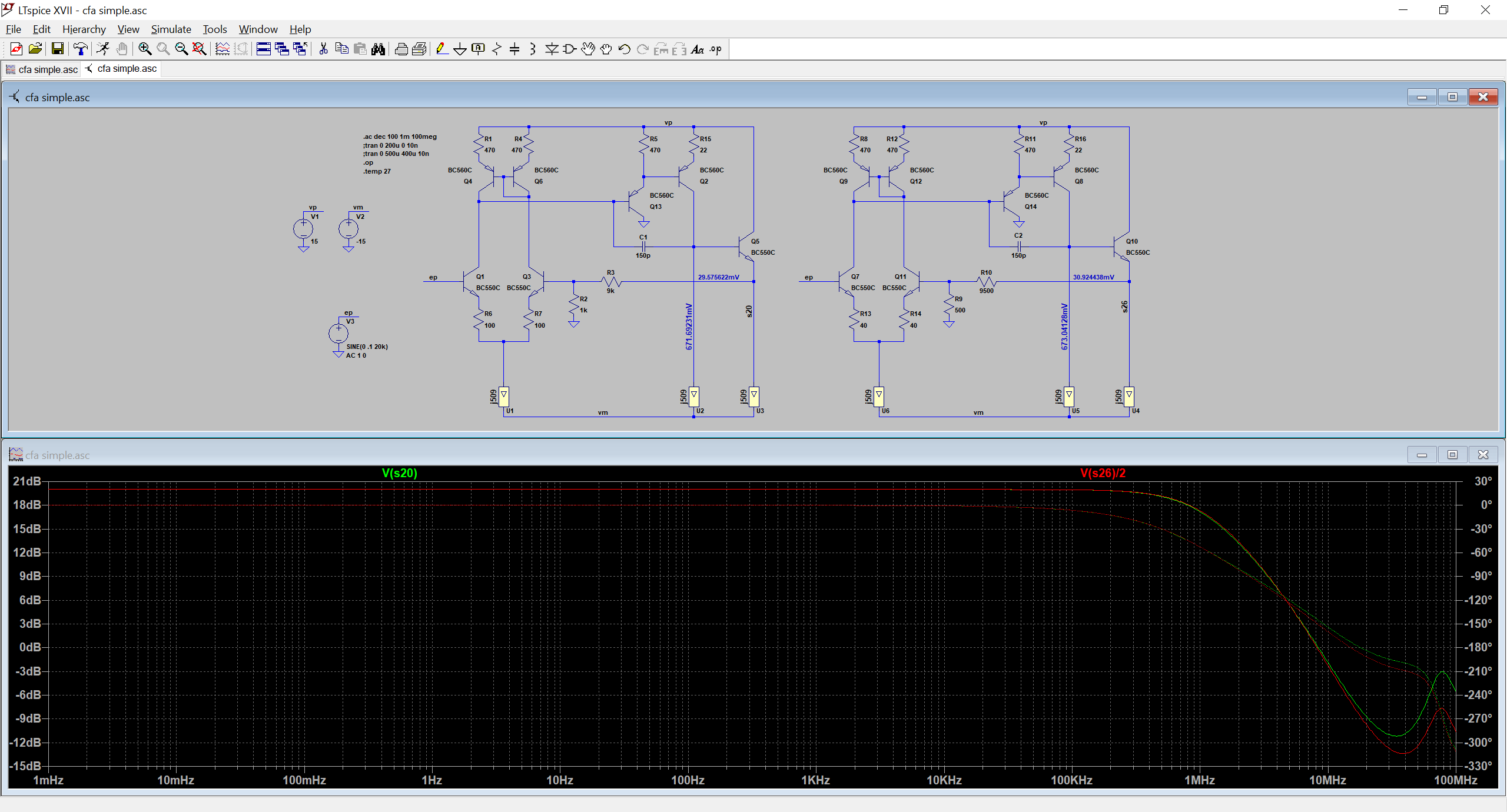

Of course yes.
Gain bandwidth independance is obtained by playing with Rg resistor.
You have the same result by playing with the emitter resistor in a LTP or a double diamond.
Double diamond VFA allows same slew rate as so called CFA.
