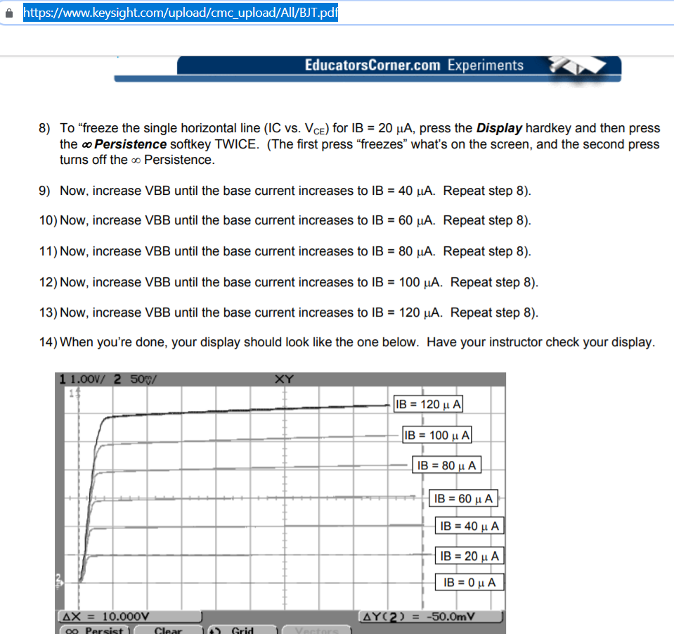

There is a graph provided in the reference, the deviation is substantial above ~2V Vce.
Yes, I see. And yet, curve traces that would seem to belie that graph are readily available.

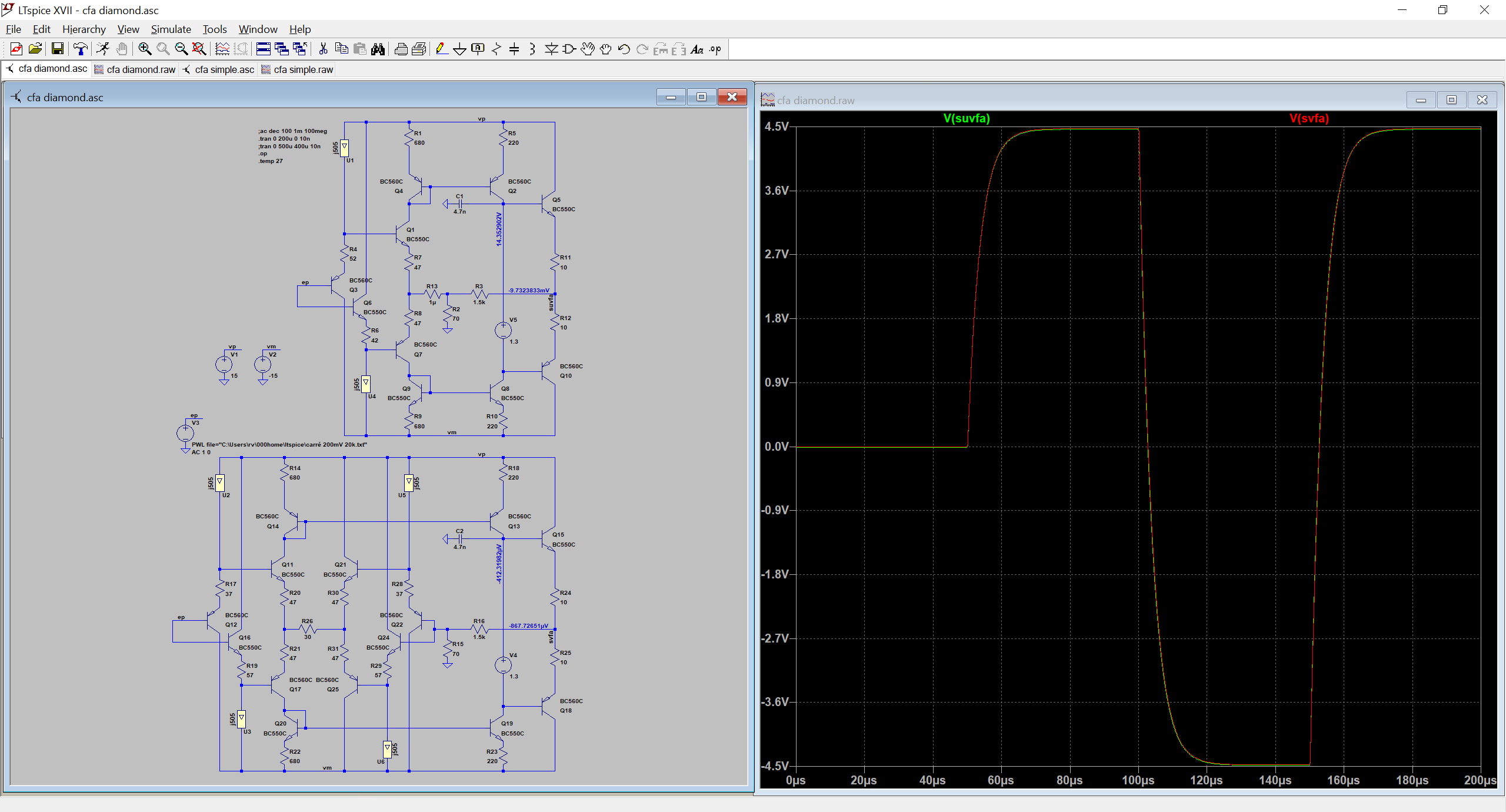

I wrote many time what are the differences between VFA and CFA and never change the facts.
I posted simulation of most of my statement so you can't say I interpret reality.
Look at the attachement. I only add a diamond to a CFA. Of course the scheme are not optimal as I drew them in 2'. But it is easy to see that the VFA has the COD feature, and by changing R26 I can have constant bandwidth as with a CFA. This is neither interpretation of reality nor fact changing.

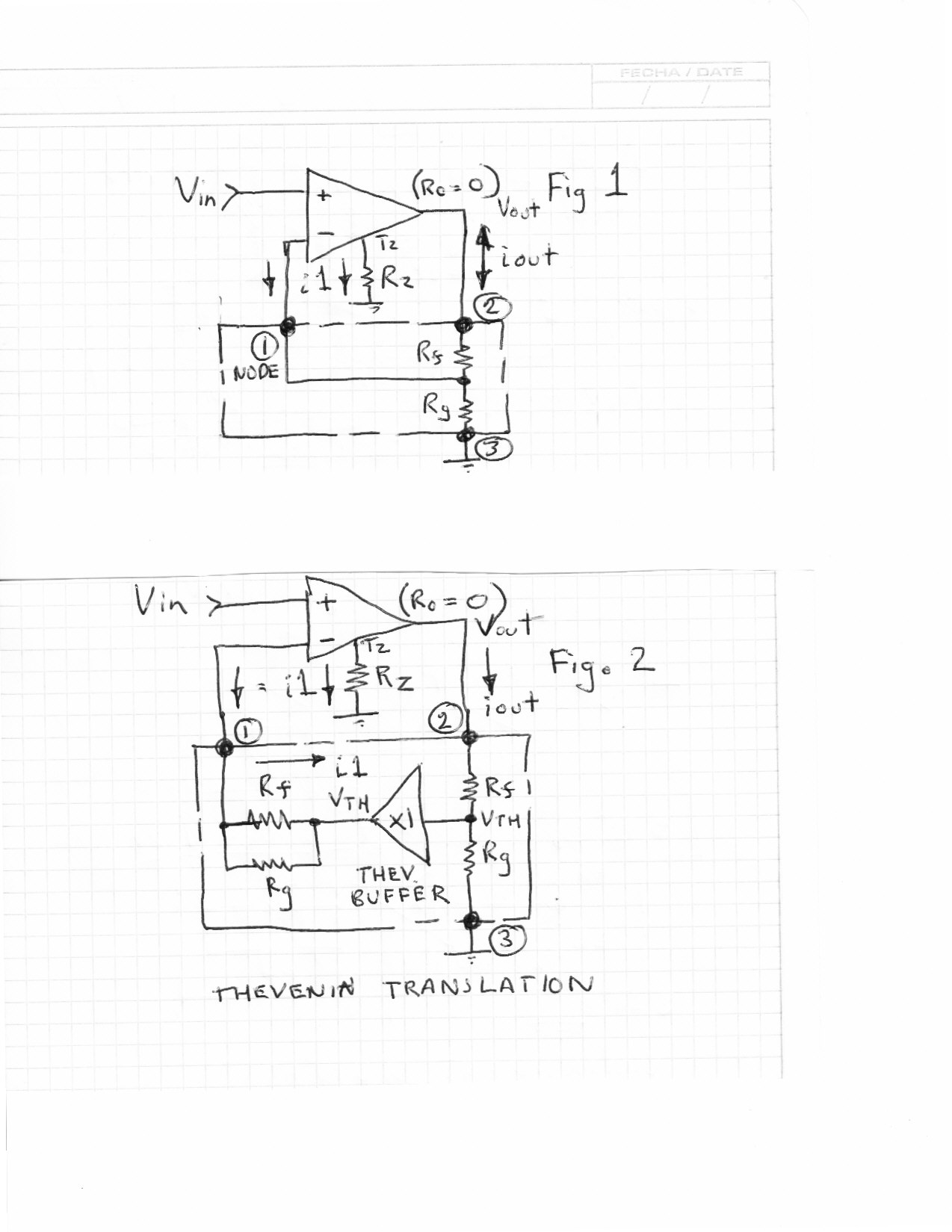

Thevenin translation
Below is a Thevenin translation of a simplistic Rf - Rg feedback network. This represents the foundation of the thought process behind several arguments presented in the past.
It is considered that much of the difficulty in comprehending the nature of a CFA results from the elusive relationship that the In- terminal has to an elusive voltage that must exist to support the functionality of the device. The Thevenin translation is intended to identify that elusive potential as V Thevenin.
Using the Thevenin translation it can easily determine the value of Vin necessary from selecting an arbitrary Vout, and specifying resistances at the Tz node and for Rf and Rg. These Vout and Vin values can then be applied to the simplistic non-translated Rf - Rg network to verify the summation of currents at the In- terminal and their current phase relationship.
Before presenting any further arguments, does anyone consider such translation as potentially useful to simplify their the understanding of a CFA.

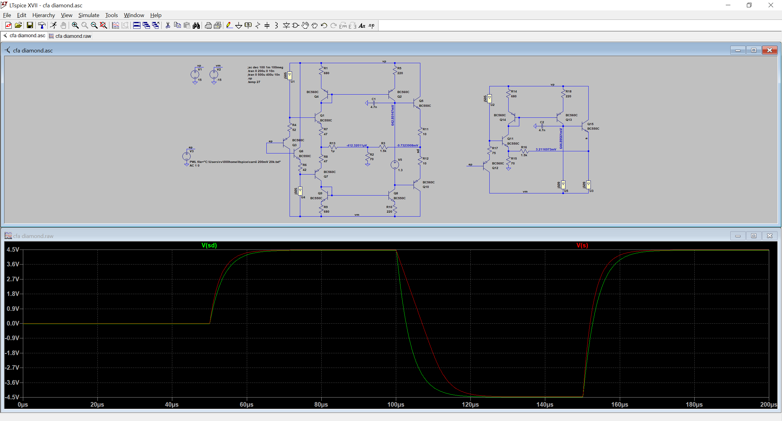

Attached is the respons of a single input device CFA and a Diamond CFA, in the same conditions.
It is clear that Diamond CFA shows COD effect and single input device doesn't. It works on one polarity, on the other one slew rate is limited by the transistors bias currents.

As the diamond topology controls the 2 currents polarities, it has COD effect. COD is a property of diamond or assimilated but not a CFA property.

I have considered making the very same argument. The input stage does not experience a difference between the two circuits. And now, we no longer have to deal with the argument that the input stage current flows only through Rg. Now the input stage current flows from the "new" output, Vth.
But the same current flowing from the output through the input stage will, I fear, still be ignored in favor of the observation that the transconductive portion of the input transistor current is a function of by vb - ve. For a few folks, for some reason, this excludes the possibility of any kind of feedback of any current. It is this assertion that needs to be at the forefront of further discussion between the two camps. But perhaps Hierfi's Thevenin equivalence will move us closer.
