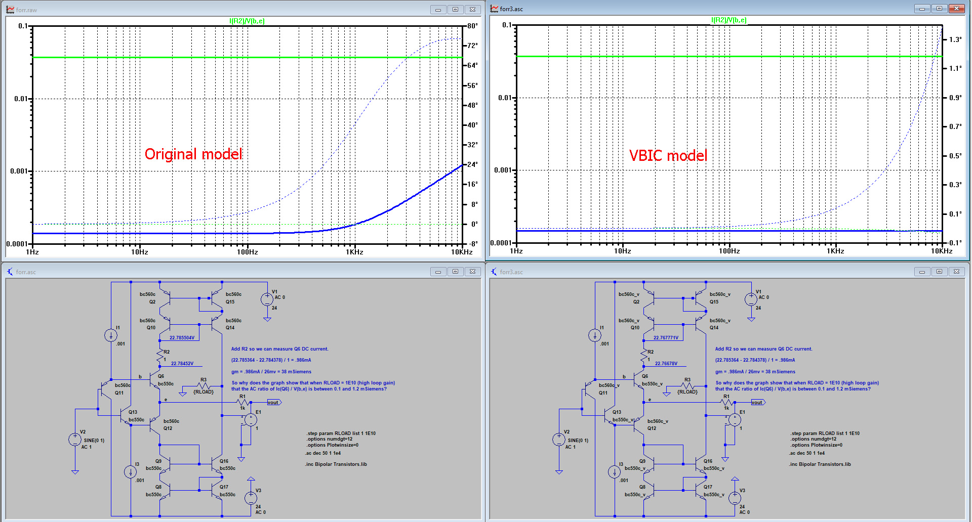

I have since found the VBIC's small spread is mainly determined by the choice of parameter 'mc' which is MJC in the GP (base-collector capacitance exponent). The attached plot shows the two plots with mc=0.75 (earlier BC550C_V was 0.25). I don't understand the theoretical basis why this capacitance parameter affects the Ic/Vbe in this way - charge based models are still a mystery to me. Perhaps someone can explain why it is so from the physics?
M is typically the grading coefficient, 0.75 seems nonphysical to me with the typical being .25 to .5 (it's been a long time but IIRC .5 is the higher limit). Taking data off of datasheets and fitting it I usually got around .33 or so (slope of 1/3 on a log plot). Not looking into it at length with m determining the Cj it would also give the charge in the depletion region and depending on doping levels the base width modulation with Vbc (Early effect).
EDIT - Yes m>0.5 is nonphysical.

Yes I did spend about an hour trying everything I could to see if it was anything else than the internal model. I was left with reducing the circuit to a single ended version (as you suggest) with one transistor and ideal blocks for the mirror and buffer, but not yet.
I was mainly using the large signal 'trans' version since I wasn't sure the AC simulation was right after what you mentioned. Did you try my 'trans' version? The currents seem good.
BTW Plotting Ic(Q6) with Vbe shows the slope (gm) does reduce as the mirror load resistance changes, and I can't see a reason why.this should be (other than what you have mentioned).

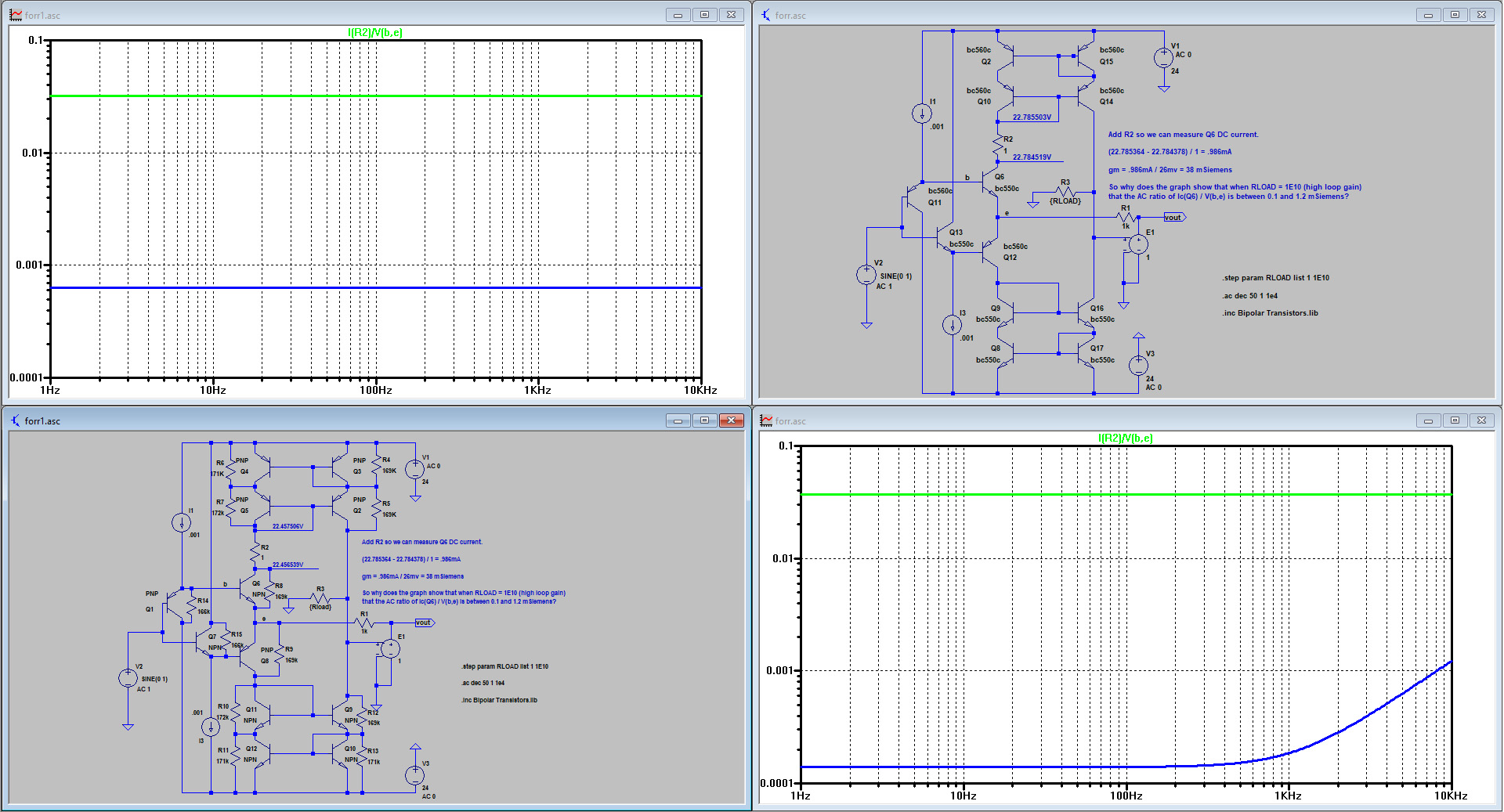

The anomaly I found in the GP model was specifically the ratio of Ic6/Vbe. When the Tz termination resistance was varied in your test circuit (Post 1872 AD844) Current Feedback Amplifiers, not only a semantic problem? you found a massive unexpected drop from 38mS to 0.15mS!! when this should not change much at all.because you are only altering the termination resistance of the output of the current mirrors and there should be negligible change in the DC bias.
I don't see how just measuring the Early effect resistance 'ro' relates to this anomaly. I think you would need to make the circuit you simulated and bench test it to find the ratio of Ic/Vbe for Q6 with AC signals.
As I demonstrated with the VBIC model in your circuit the ratio of Ic to Vbe was quite close to the expected constant gm value of 30-40mA/V at 1mA. and that over the wide range of Tz loading resistances.
You are right about having to do the Sim with AC signals.
That's why I went back to your link an compared this circuit diagram with one having generic NPN and PNP transistors having an infinite value for Ro.
By placing a resistor in parallel, I can investigate the effect of Ro, in this very case using 165K@1mA@1V for the BC550C/BC560C.
When the simulated Ro is infinite (not shown here), gm remains constant at 38mA/V independent of Rload.
But with an accurate calculated value for Ro in the the left part of the image below, results are becoming comparable but not for the full 100%.
Maybe I should make a model with variable Ro for accurately replacing a BC550C/BC560C with all other parameters comparable.

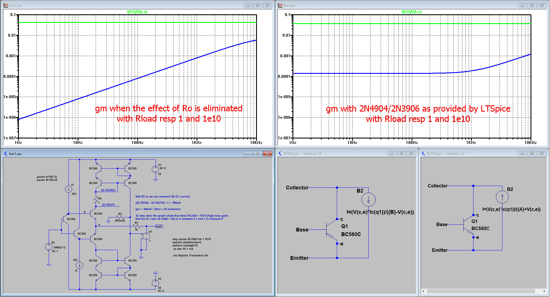

I have made another Sim where the effect Ro in the BC550C/BC560C model has been eliminated by placing a current source par. to Ro, generating an exact opposite current.
By meticulously tuning in finding the Early voltages A and B for both transistors, I get the image below.
I think now the effect of Ro has been eliminated, it becomes quite obvious that Ro is not the cause of measuring different values for gm at differen values for Rload.
Hans

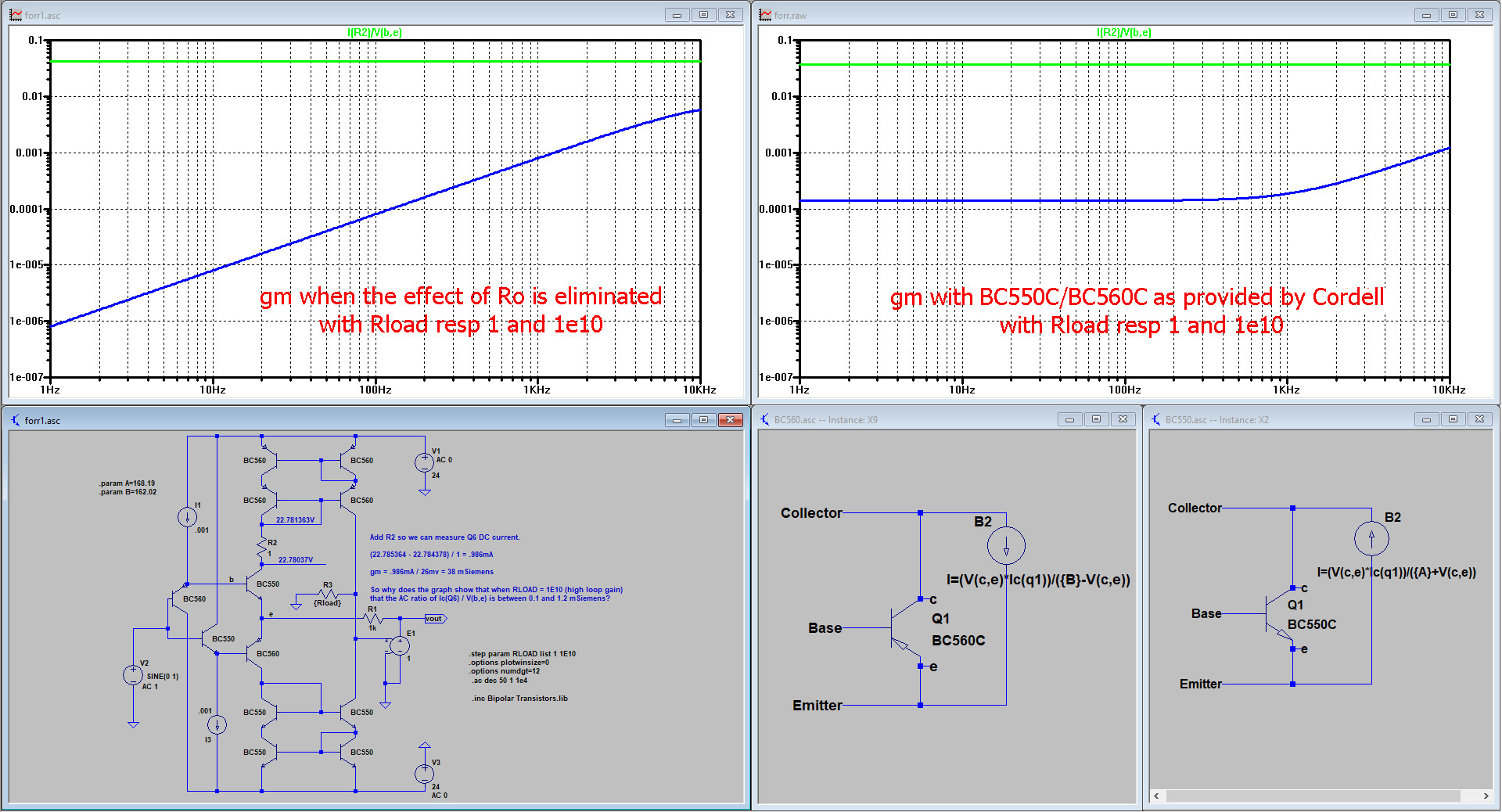

Hans

In the image belonging to the above posting, I have written 2N3904/2N3906.I have made another Sim where the effect Ro in the BC550C/BC560C model has been eliminated by placing a current source par. to Ro, generating an exact opposite current.
Hans
This should of course be BC550C/BC560C.
See corrected image below.
Hans
Sorry Chris,Without reviewing your results, please consider that there is nothing else in the Hybrid Pi model other than ro that could explain this phenomenon.
You would be right when the Hybrid Pi model was perfect, but be aware that this Hybrid Pi model is only a simplified model not containing all parameters.
After the contribution of Ro has been eliminated in my Sim, the effect on gm when using a large value for Rload has become even larger instead of smaller, exactly the opposite what should have happened when Ro had been the cause.
So at least within LTSpice there is a more complete Transistor model causing this effect.
And that's why I lost my believe in holding Ro responsible for causing this gm diminishing effect.
Also be aware that in your Sims where you noticed this effect for the first time, the "extra" contribution that LTSpice produces was also part of your result, making it impossible to validate your results.
Maybe it's not a bad idea after all to see what a VBIC model could make of all this.
Hans

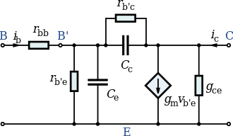

Hans, please discriminate between ic/vbe and gm. Even if the Early effect does not explain the phenomenon we are discussing, it does exist, and so gm = I(DC) / (kT / q)and ic/vbe are not the same thing.
Yes, Hybrid Pi does not explain everything, so there might be something else going on. But it is derived from the Ebers-Moll and Early equations/models. Attached is a more complete H-pi model. the text that goes along with its is:
Full hybrid-pi model
The full model introduces the virtual terminal, B', so that the base spreading resistance, rbb, (the bulk resistance between the base contact and the active region of the base under the emitter) and rb'e (representing the base current required to make up for recombination of minority carriers in the base region) can be represented separately. Ce is the diffusion capacitance representing minority carrier storage in the base. The feedback components, rb'c and Cc, are introduced to represent the Early effect.
So perhaps you are not compensating for the full effect. I know I haven't considered rb'c and Cc, although I expect that Cc's effect at 1kHz would be small.
