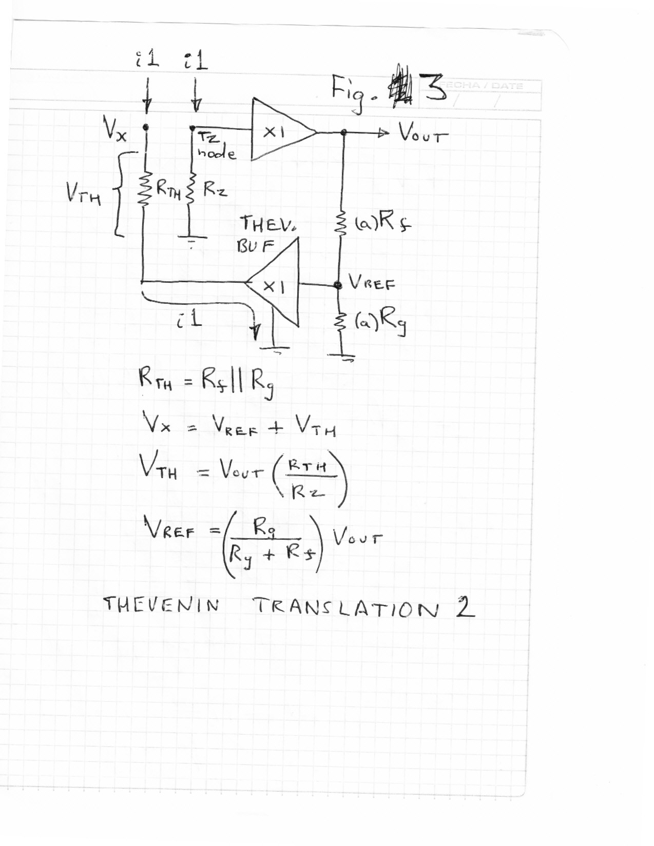

I thought you and Hans might find this interesting for whatever it is worth. It uses a Thevenin translation that in the first approximation is absent of an input network. The analysis is based upon a condition of balanced current mirrors as a means to predict the behaviour of the feedback loop. The formulas are derived from the translation as leading to several conclusions.
This predicts that an input network inserted into the current path, as to generate Vx will behave accordingly as the network causing the currents to occur. Hence in the first approximation the feedback network behaves in a specific manner as to thereafter be modified by characteristics of an input network.
The formulas also reveal that there exists a direct relationship of V Thevenin to Vout, as well as of V Ref to Vout. Hence V Ref and V Thev are related by some constant ratio. It can be realized that under circumstances whereupon an input network exists, Vin is being tracked by a virtual Thevenin buffer dynamically current limiting the amount of current passing through the Rf || Rg + Z(In-).
It is in the conceptual belief of a virtual tracking Thevenin buffer that gave rise to my earlier conclusion that the behaviour of a CFA is one of feedback current limiting.

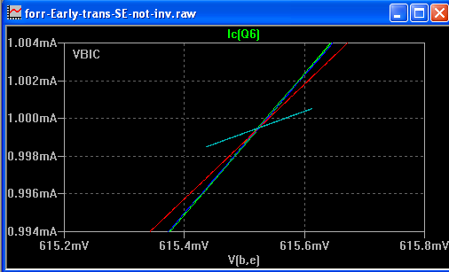

OK, no change in DC bias.
Isn't "the first step" the explanation for the change in Ic slope with respect the Vbe. So far we have:
The change of slope is visible in my previous post 2166 with a single ended version. This is a large signal simulation.
There is no change in slope if the signal is fed into the inverting input via a 1k resistor (or as a sinewave current injection of 1mA/V).
There is a difference between the VBIC an GP models with (near) identical parameters.
The VBIC parameter 'mc' changes the large signal LF gain (see below) as well as the HF part.

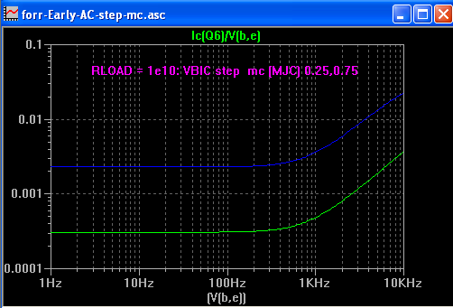

The changing capacitance question. I have plotted Ic6/Vbe6 with AC. See attached.
It is VBIC with 1e10 load and step 'mc' (MJC) from 0.25 to 0.75. Notice two things: the LF gain changes by a factor of 10, and the capacitance has changed by a factor of 10 (giving the same the HF transition frequency).
So the VBIC 'mc' parameter (for the b-c junction capacitance variation with Vbe) does appear to affect the LF gain in this circuit, not only the capacitance for HF. If 'mc' was purely a capacitance parameter then it would not affect the LF part. Mc appears to affect the DC equations (and seen in the AC plots) and it interacts with the Early effect.
