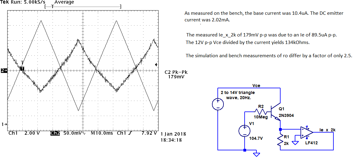

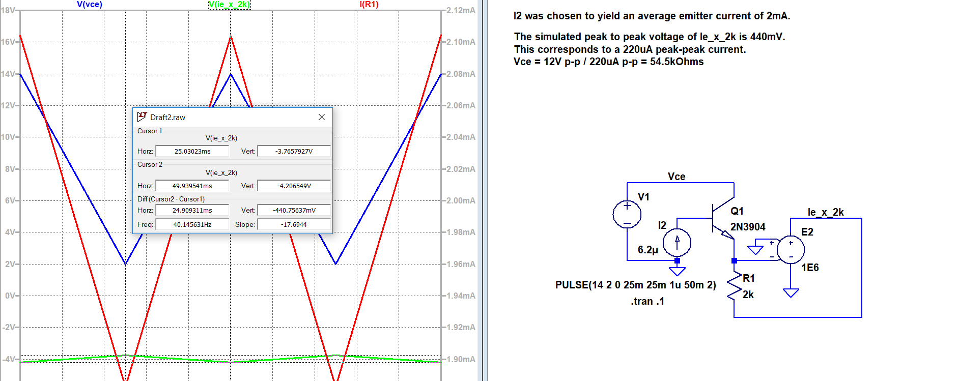

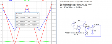

As threatened 🙂 I measured the Early resistance ro of a 2N3904 at Ie = 2mA on the bench and compared it to that predicted by an LTSpice sim. The results differed by a factor of 2.5 (134k measured vs. 54.5k simulated.)
I don't know the variations of ro from transistor to transistor, but this seems reasonably close. It would appear to be a confirmation of the sim I did showing the CFA gm and ro input transistor current contributions becoming almost equal at high at loop gains. I question whether it justifies disposing of the Gummel Poon models in favor of the VBIC versions, but I'd be interested in others' comments.

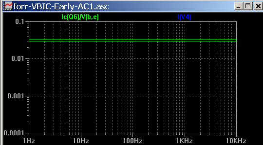

VBIC update

I don't see how just measuring the Early effect resistance 'ro' relates to this anomaly. I think you would need to make the circuit you simulated and bench test it to find the ratio of Ic/Vbe for Q6 with AC signals.
As I demonstrated with the VBIC model in your circuit the ratio of Ic to Vbe was quite close to the expected constant gm value of 30-40mA/V at 1mA. and that over the wide range of Tz loading resistances.
I have since found the VBIC's small spread is mainly determined by the choice of parameter 'mc' which is MJC in the GP (base-collector capacitance exponent). The attached plot shows the two plots with mc=0.75 (earlier BC550C_V was 0.25). I don't understand the theoretical basis why this capacitance parameter affects the Ic/Vbe in this way - charge based models are still a mystery to me. Perhaps someone can explain why it is so from the physics?

Chris,As threatened 🙂 I measured the Early resistance ro of a 2N3904 at Ie = 2mA .., I'd be interested in others' comments.
