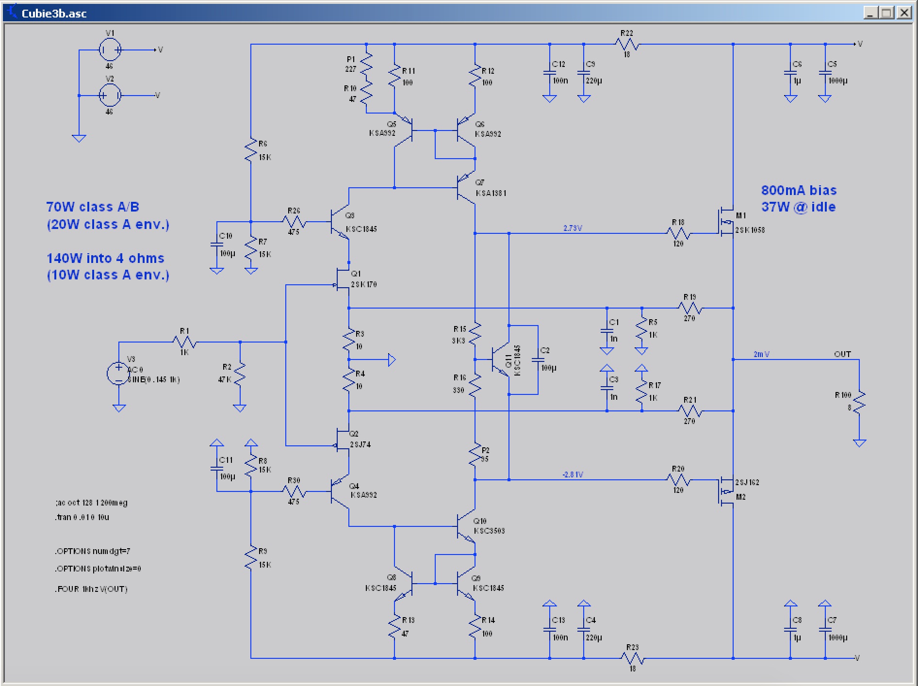

Hi Juma,
Thanks for sharing this design! Based on the success of my DIY HPA-1 (with a similar topology), I was thinking of building a Cubie3 in an Aleph O-style case.
I adjusted a few things to use the KSA/KSC parts I have on hand and to bump the rail voltages up a bit. I had to lower the current through the Vbe, and adjust the cascode bases a bit. I also lowered the gain slightly, but I'm not sure if this was because it was just too high for me to start with, or if my changes above increased it.
Since I'll have gobs of heatsink, I also upped the bias to the zero-temp-co value (800mA). The laterals probably deserve chunky copper heat-spreaders under them to get the heat out to the whole heatsink (each one will have its own side of the case).
Anyway, I don't think I did anything stupid, but I'm pretty new at the analog side of things so I could well have. One thing I did notice is that it goes into oscillation when over-driven (ie: 1.4V at the input). The unmodified schematic does this too, so maybe it's just my SPICE models or something?
Any comments appreciated.
Thanks,
Jeff.
Hi Prasi,
As I understand it paralleling output devices would require source resistors, and the lack of source resistors is likely a big factor in Cubie3's sound.
Note that 100W is at a Tc of 25ºC. Running at a more reasonable Tc of 60º derates them to about 70W. Note that we're well into class B here so we get to add two 70W to give us 140W.
Running them there continuously would no doubt give a rather unsatisfactory device lifetime. But music doesn't look like a sine wave, and I only need the 140W for transients; average will probably be closer to the class A envelope numbers (10 - 20W).
But they will be on flying leads, so they'll be easy enough to replace. 😉
Jeff.

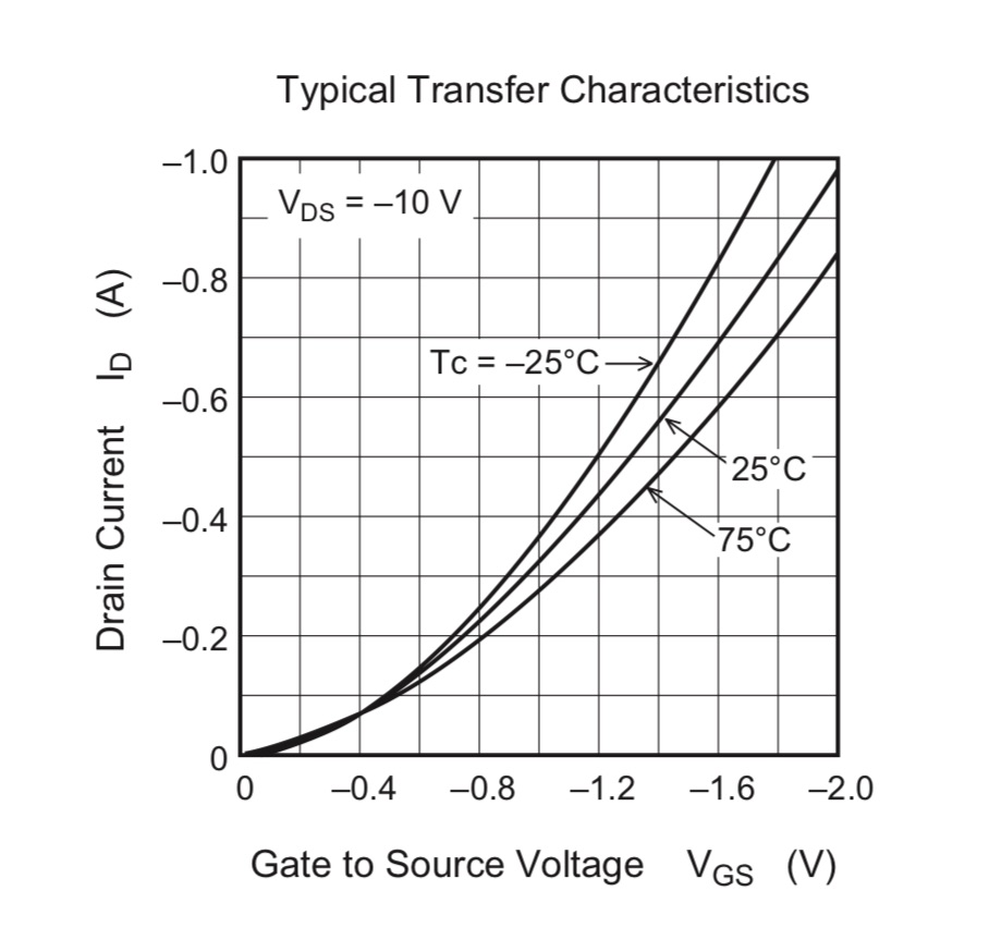

Sometimes you don't need source resistors if paralleling output devices. If you look at the old Halfler DH 220 it used a pair lightly matched of parallel 2sk135 , 2sj50 lateral mosfets I believe these devices were rated at 125v and have a negative tempiture coeficent above 100 ma I believe this would help ballence curents. And while the 2sj62 also has a negative temperature coeficent it doesn't come into play till the bias is above 600ma per device.
Adding a second pair of output devices hugely improves the class A performance. I lowered the bias to 700mA (for a 32W idle dissipation) and got 60W into 8ohms and 30W into 4 (with class B headroom of 160W).
Shouldn't need the copper heat-spreaders in this config (lower output per device and output spread over heatsink with more devices).
Another question: Juma indicates a max Vbe current of 4-5mA. What determines the sweet spot for this? (In other words, *why* a max of 4-5mA?)
And do I want to increase it to drive 2 pairs of output devices, or is the number still max of 4-5mA?
Thanks,
Jeff.
Jeff please stop misquoting me.
Vbe can only be a voltage, never a current.
Also, optimum is not a maximum.
Please read again carefully what I wrote.
I know of tens of successful builds of this amp and some of them are documented in the thread. And yet you claim it unstable although you don't understand the circuit, you don't know how the sim works, and you never built it. You didn't even bother to carefully read the thread.
This type of behaviour is exactly why I stopped publishing designs here and minimised my activity on this site.
a) I was using "Vbe" for short hand for what you called "The current through Q4,Q5,Q7,Q8", which I think was pretty clear.
b) You said "shouldn't be higher than 4-5mA" which in English is a maximum.
c) Now you're misquoting me. I didn't claim it was unstable; I said my SPICE sim showed oscillation and then asked for direction on whether that meant I messed something up or not.
d) I did read the whole thread.
e) If I don't understand how the circuit works I would have thought this was the place to come. Maybe not.
f) Of course I haven't built it yet. I'm still trying to understand it.
Jeff.
