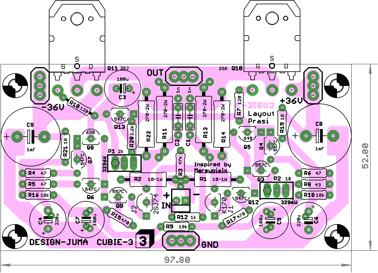

Can someone confirm these layouts are correct or not. I plan to etch some PC boards, my friend would love to build these amp. So he ask me etch a pair PC boards.
If someone built and test it one of these boards please let me know
I would love to use the correct layout otherwise it will be a waste.
By the way Prasi what is the actual size of the boards, I found out one is your design.
Thank you very much
Greetings to all 🙂
Hi Gabor,
The layout you attached is correct except for K170 orientation , it should be rotated by 180deg .
here is the correct layout. if you want i could post pdf and its sch. its not tested.

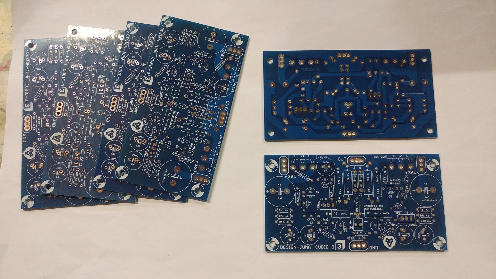

I've just received the set of 10 boards manufactured by Pcbway on the basis of the recent layout of Prasi. Take a look at the attached photo.
They are really well made and georgeously engineered!
My plans are to populate them and make the amp work in September/October and I'll report back my listening impressions.

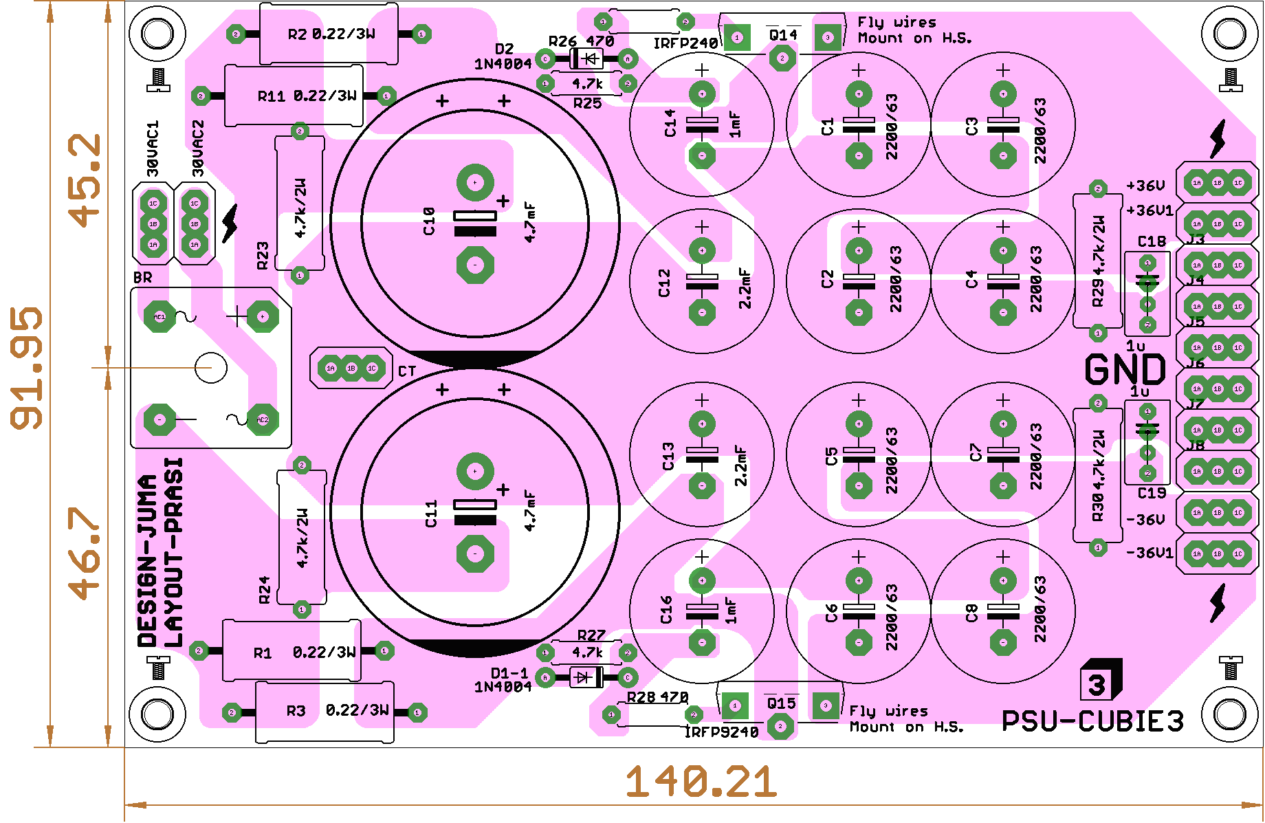

Hi Prasi,is it possible to post this for home etching?it seems i already have made a layout for this psu. here it is.🙂
- Cubie3
