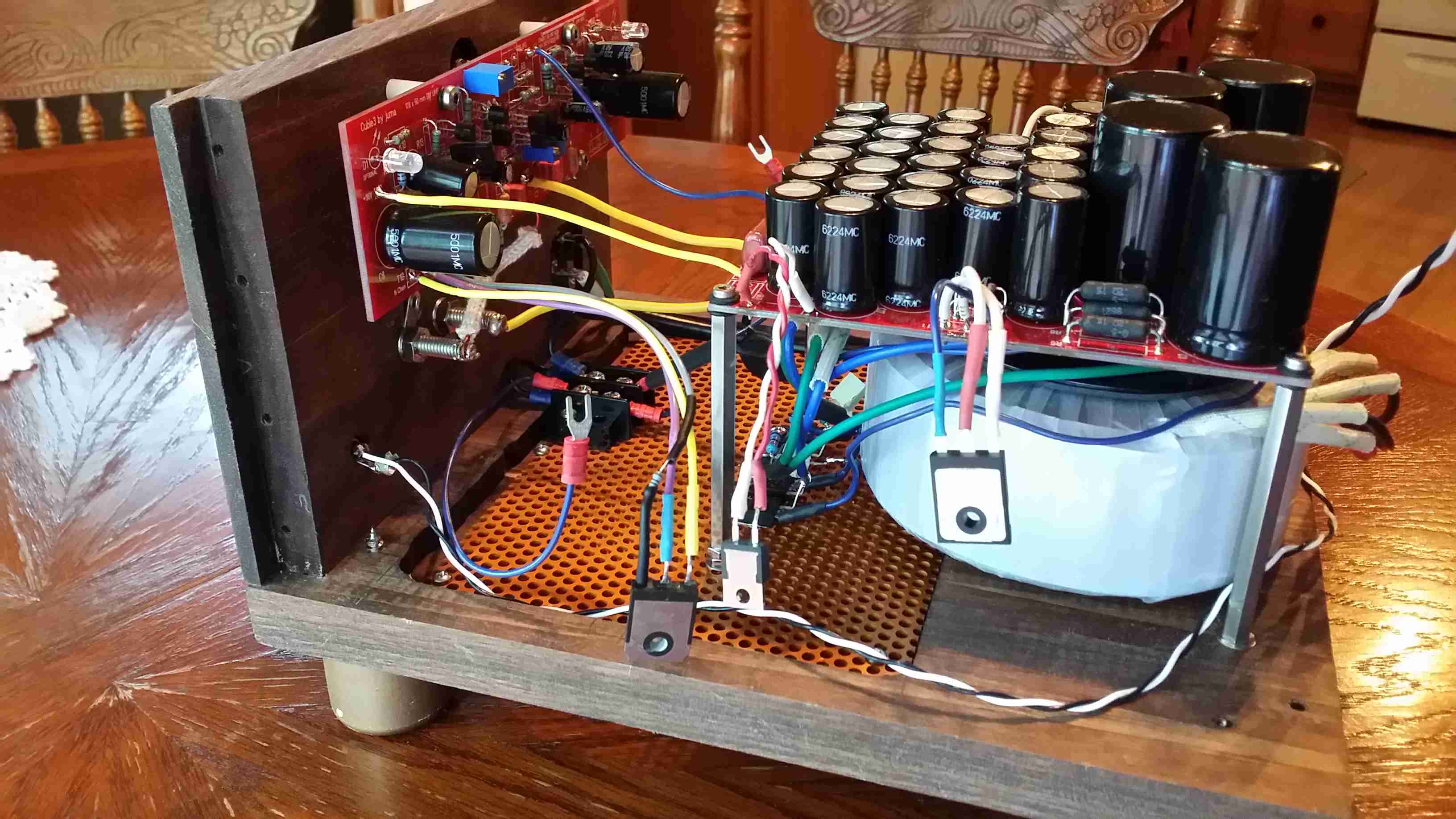

Cubie3 mono blocs

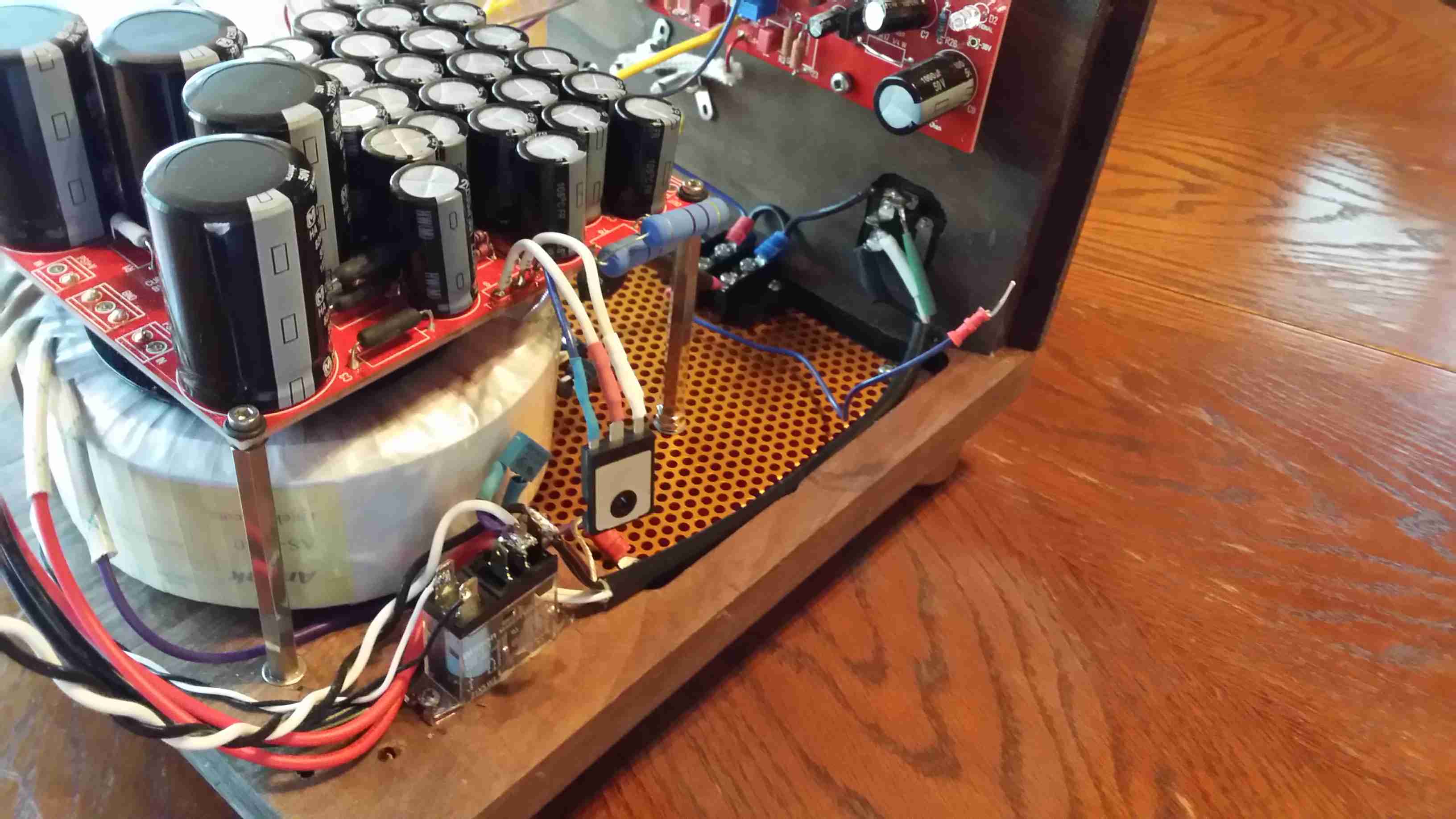

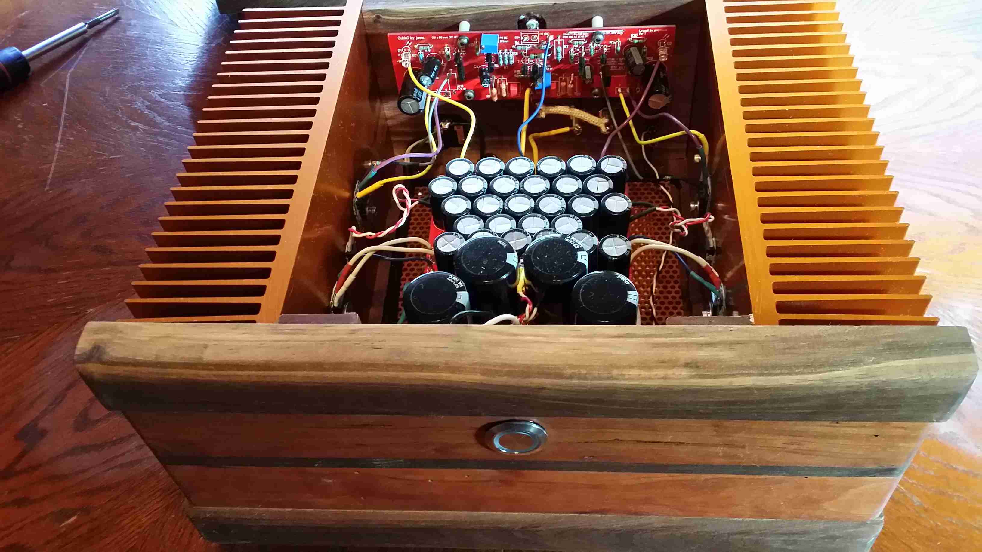

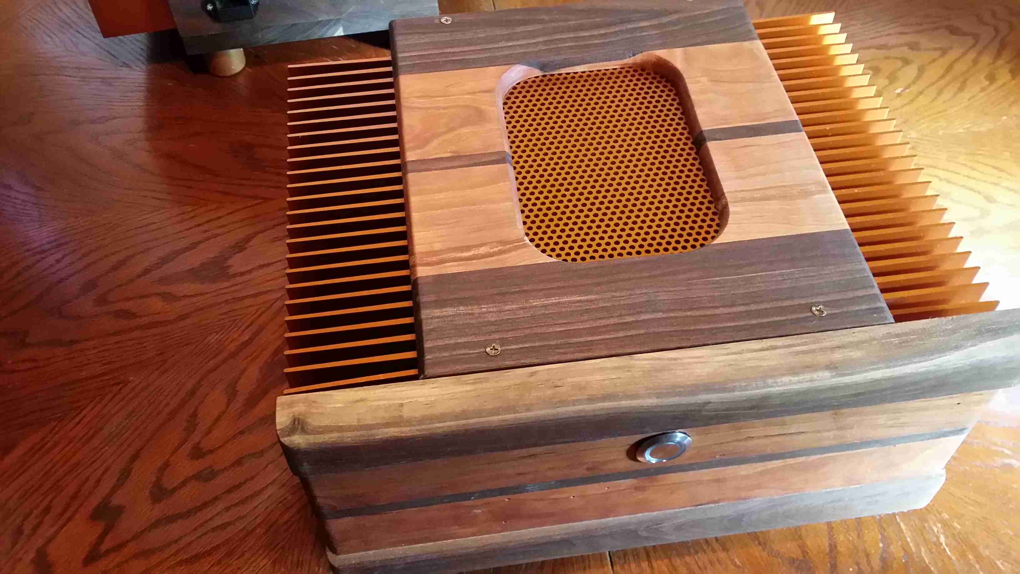

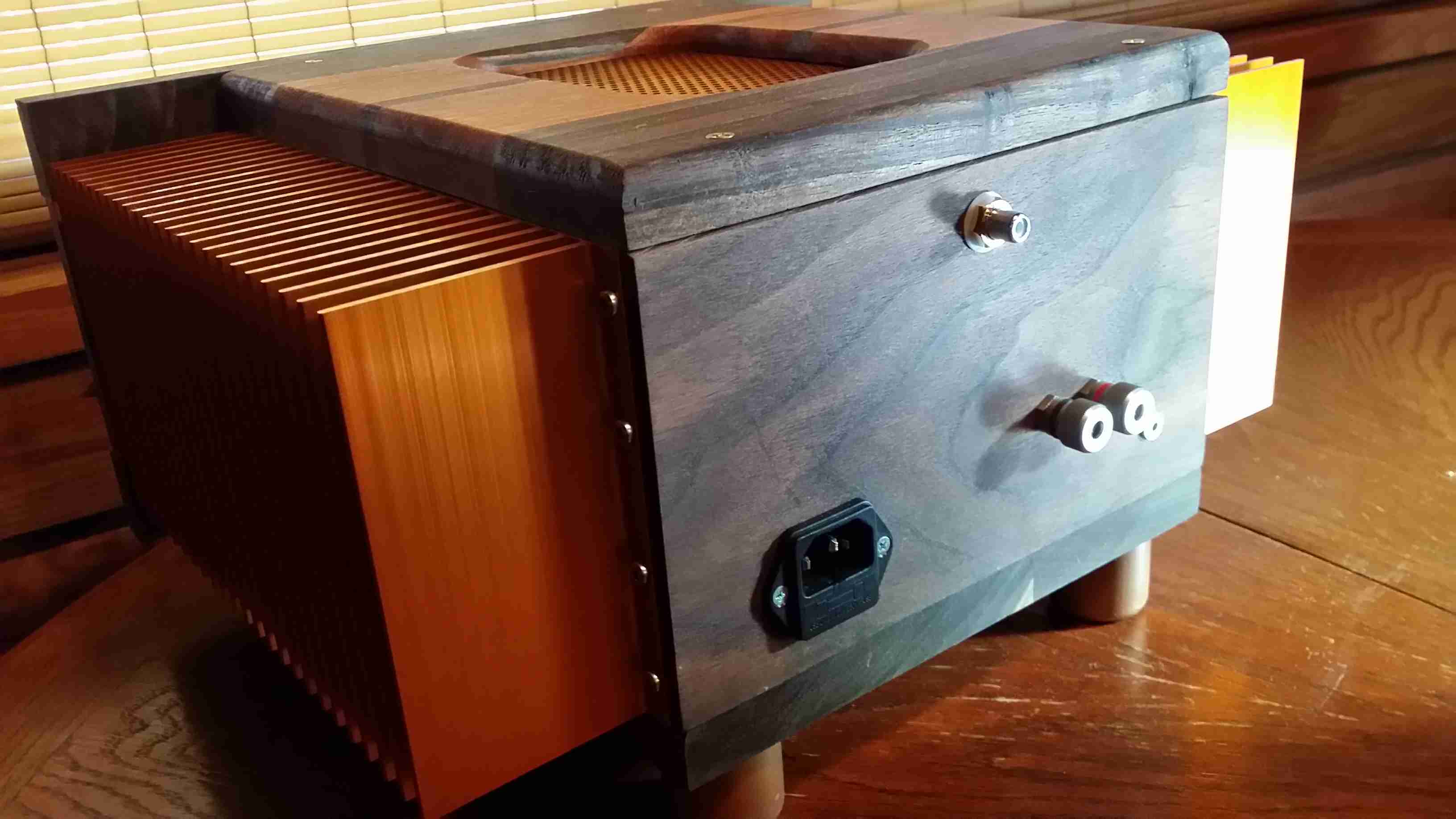

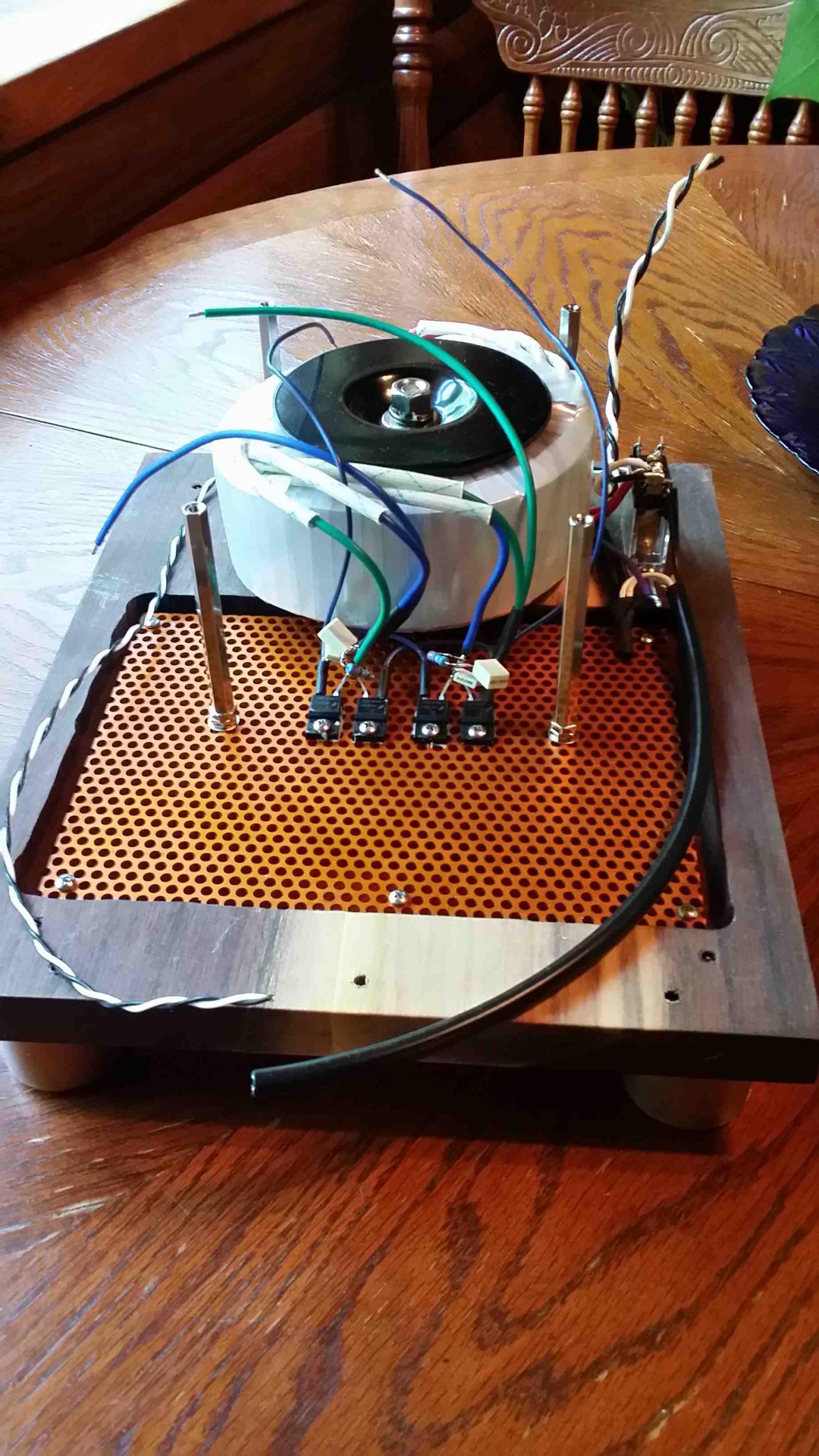

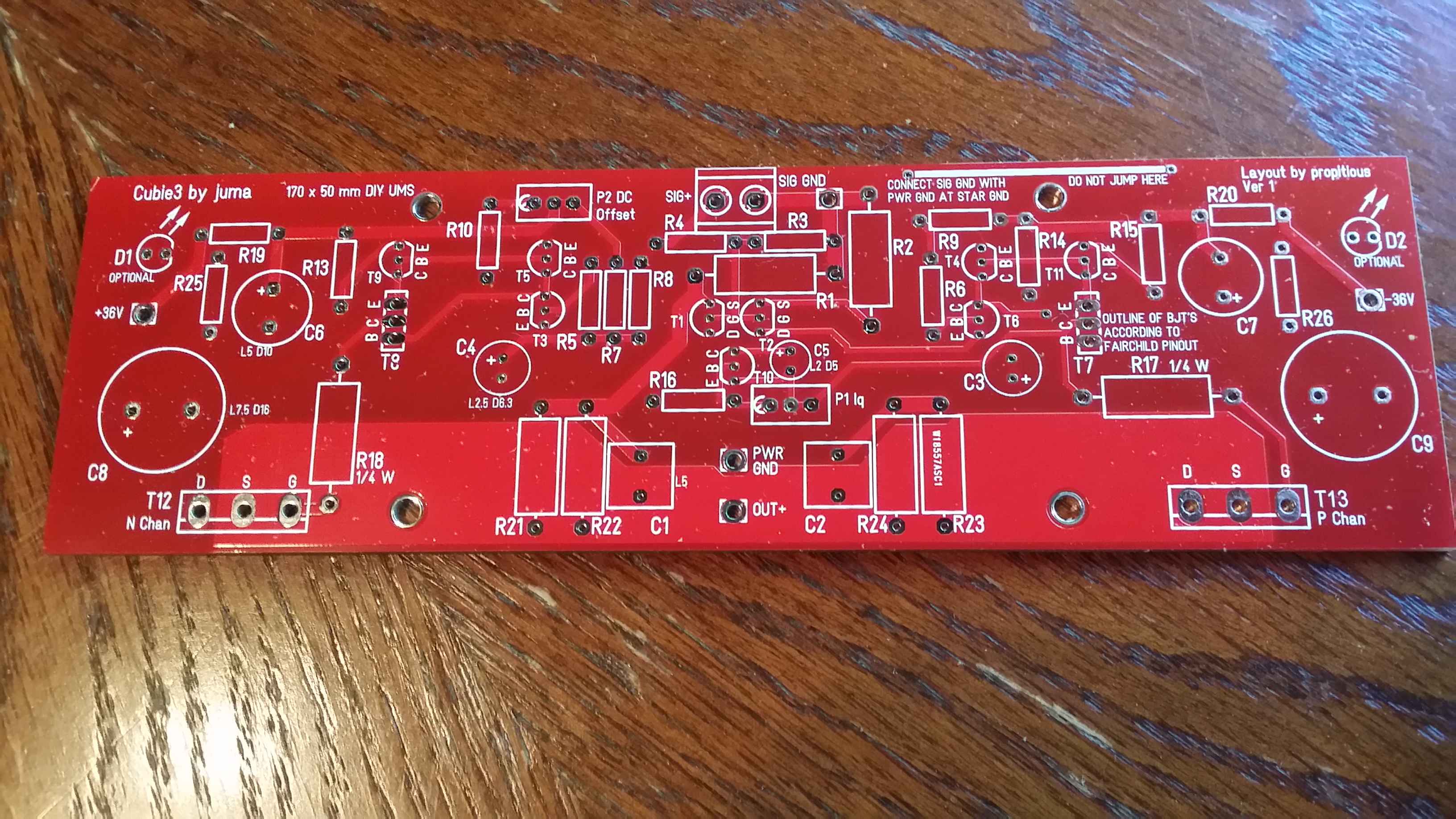

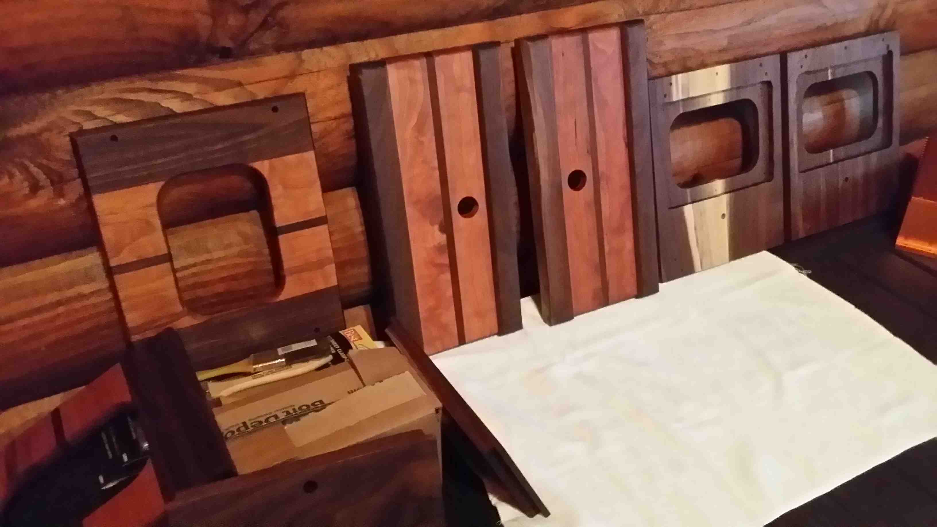

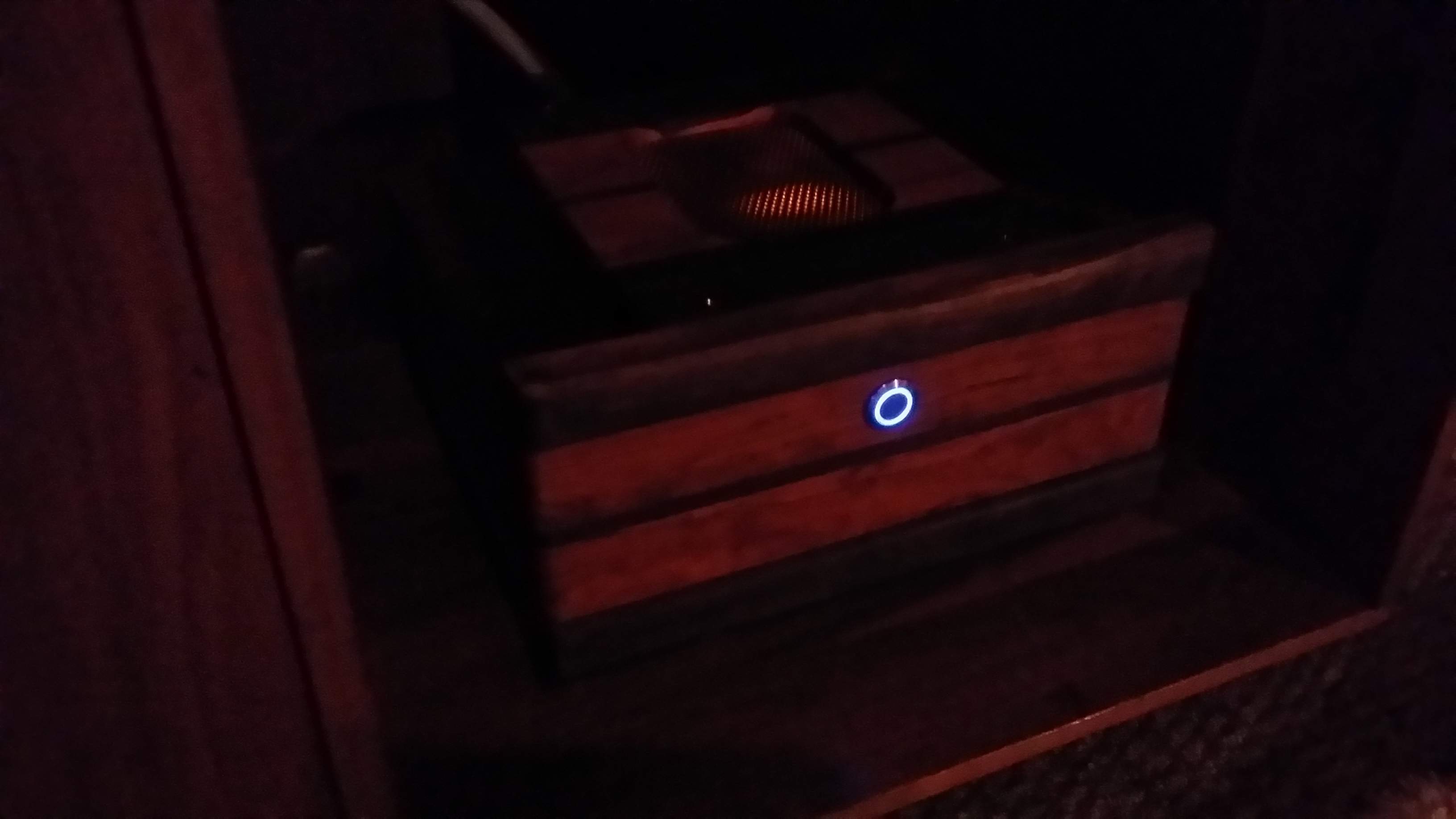

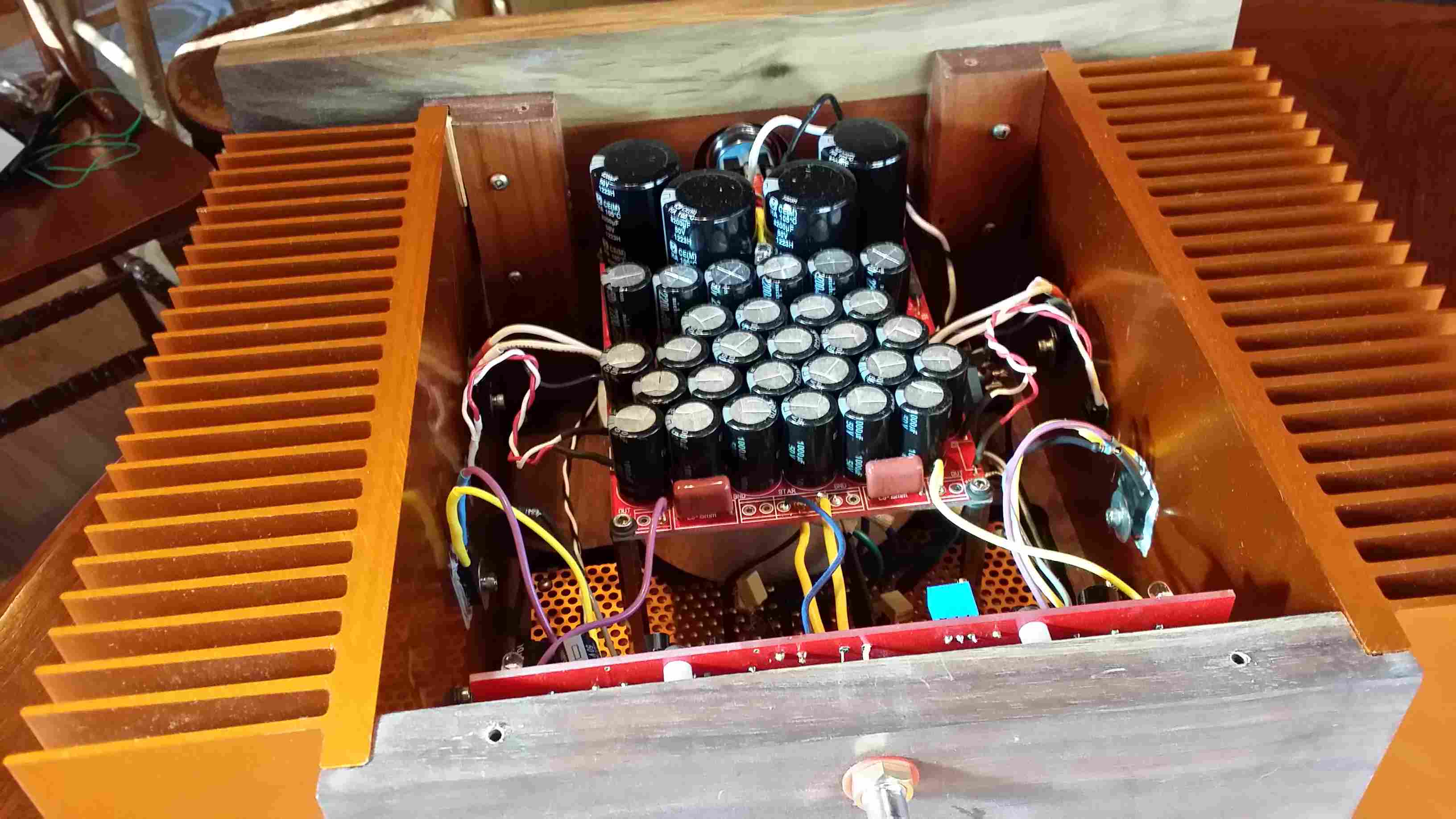

I wanted to build Cubie3 as two mono amps with a nice looking wood enclosure. This project took much longer and cost more than I intended (don't they all?) but I am extremely happy with the results. First, I got a friend to draw it up in his 3D CAD. I drew up a pcb using BD139, 140, as Juma suggested, so that it could do two pairs of LATFETS if wanted. Mine used one pair per channel. I made the pcb the size of an F5 pcb with diy UMS hole pattern, although I would mount it as a mono on the back panel. The heatsinks are HeatsinkUSA 10.08 at 5 inches high. I was going to go taller (it is named Cubie3 after all), but that cost more and 5 inches is plenty of cooling. I found an Anodizing company (Quick Turn Anodizing for those of you in the USA) who does cheap min batch price and used a pretty copper gold dye. A local woodshop glued up the walnut and cherry wood after doing router work. I assembled, drilled screw holes, then disassembled and applied Tung Oil. I drew up and had the cap multiplier pcb's made also. Xfrm is Antek 200VA, AS2230, just in case I would use 2 output pairs sometime. The relay with a 12V coil is so that the amps can be turned on with either a 12VDC outside signal from my preamp or the front round switch. One heatsink will have attached the IRFP240, a load resistor, the Hitachi LATFET and a ground wire.

The pcb's are 2 sided, 2 oz., and 2mm thick. After assembling, I set Iq at 1 A. The heatsinks do not get very hot, but I later lowered it to 890mA so that the LATFETS will not be too hot and live a long life. It still should stay in class A up to about 50 watts peak into 8ohms. In dim light the amber LED,s give a warm glow inside the amp. When I first powered it up, it sounded somewhat similar to my Aleph J, so I knew I was in for a real treat. The first thing I noticed is that it has more detail, more control, or as Juma says, finesse. Special thanks to Juma, Nelson Pass, of course for these ideas, and Teabag for help on getting the pcb's made.
The sound? After burning in for a couple of days I sat down for serious listening one evening. My wife says it best, but first a little background. Three months ago she asked, "What are you doing?" "Building an amp." "Don't you already have an amp?" Well, when you go and paint another oil painting, it is not like we have a bare spot on the wall that needs a painting." Then she said, "I guess you just always have to be building something or doing something." Anyway, after playing several songs that evening, she walked into the room and said, "It sounds more real; like they are really there playing." The next morning, she wrote me a note saying, "Thank you for all the hard work you did to provide such beautiful music for our home." Does that describe enough how the Cubie3 amps sound?

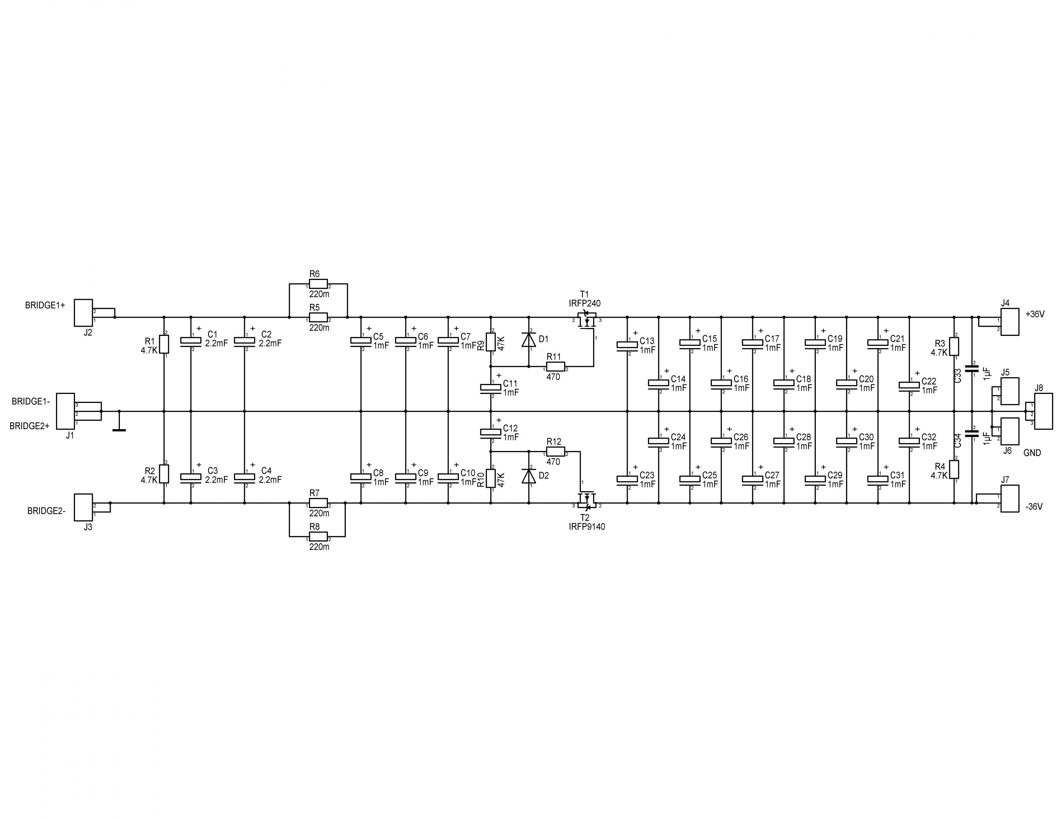

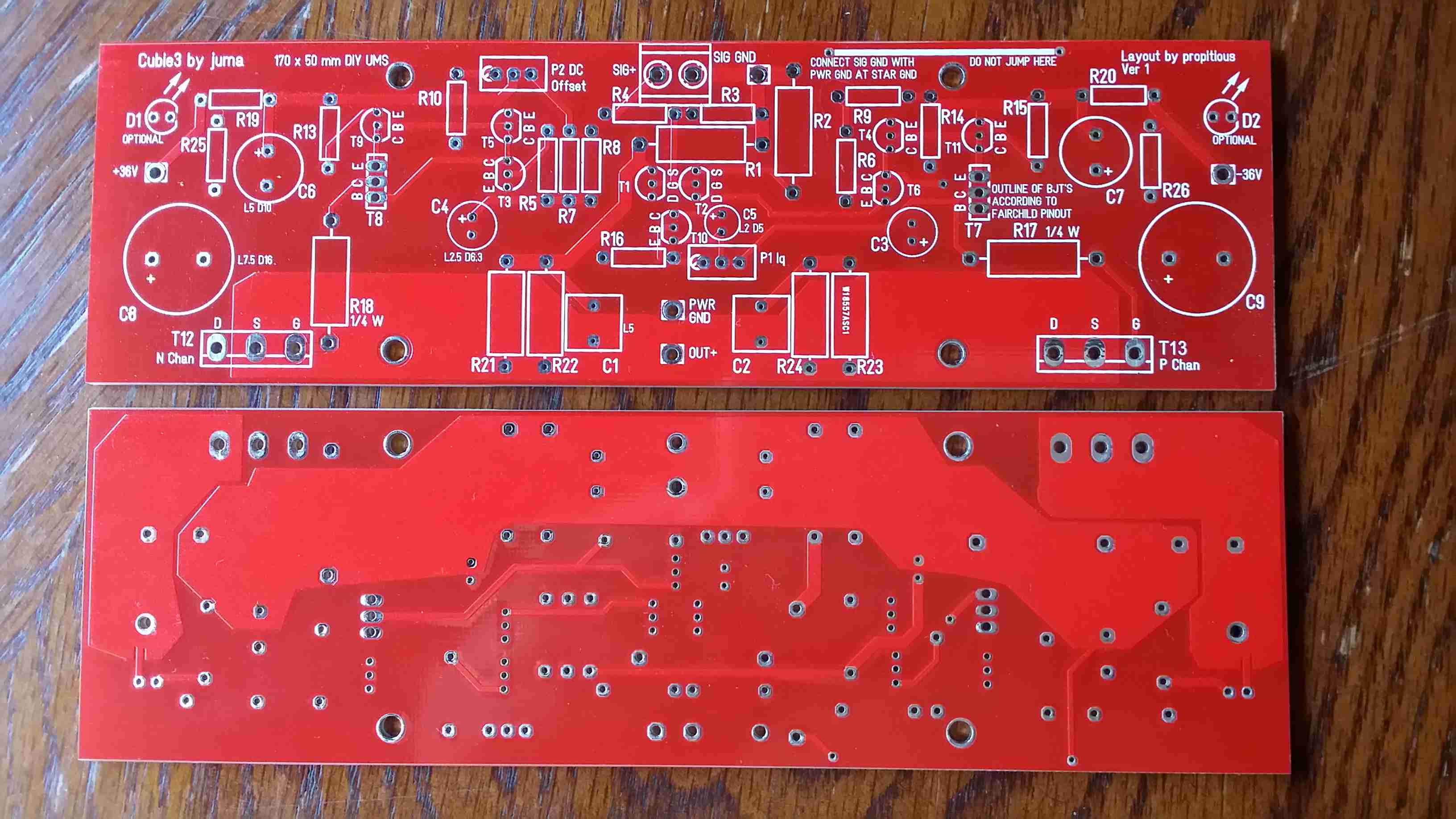

All that said, I will help anyone else enjoy this amp any way I can. If someone wants the drawing files, PM me and I will email them in pdf format. Too big to post except for the heat sinks, which I am attaching. On these I raised the holes 5mm and changed the dims to inches for a local machine shop to drill and tap holes. However, anyone with a diyAudio store 4U or 5U deluxe or just their heat sinks can use the pcb's that I made, which have a UMS hole pattern like the F5 pcb. I can also give the Gerber files, but I think the cheapest and easiest way for someone is to have a group buy. If I can get maybe 10 or more pairs sold, I could probably be able to sell them for about $25/pair for the amp pcb's and $18/ea for the PS cap multiplier pcb. One PS board with larger caps is plenty for a stereo Cubie3. They both are 2 layer, 2 oz copper and 2mm thick, very well made. Details and sizes are printed on the pcb's. The PS pcb has the D and S reversed for the IRFP9140, so you would just solder the wires to it to the correct place, but new pcb's will be have correct lettering there. I will explain more later. Let me know if I can help any other way.
