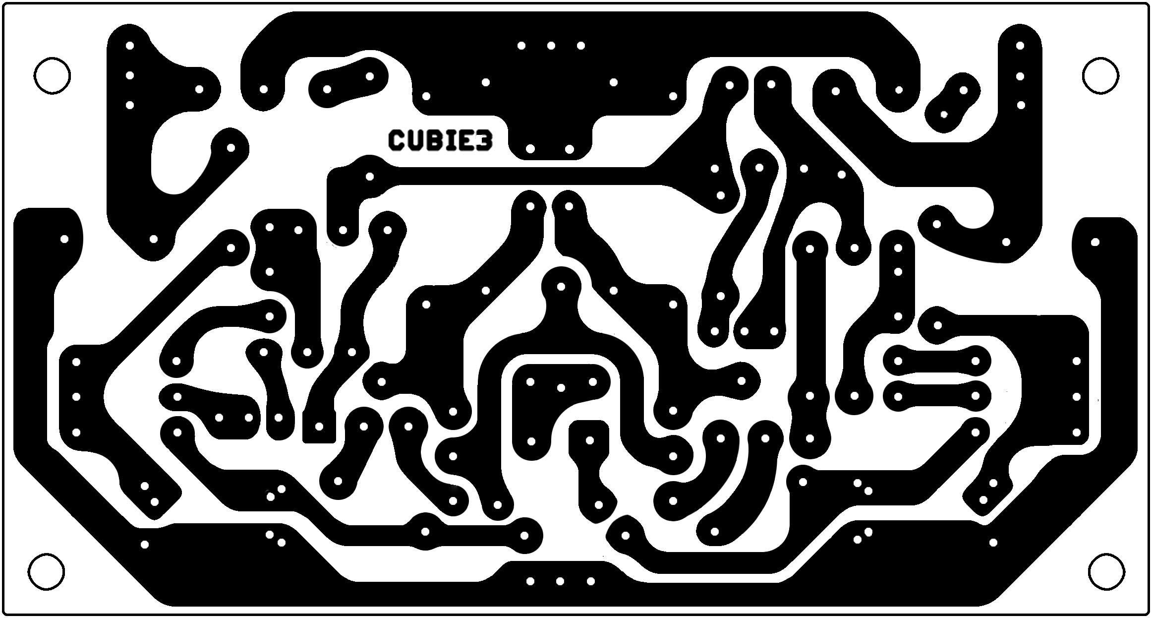

Cubie3

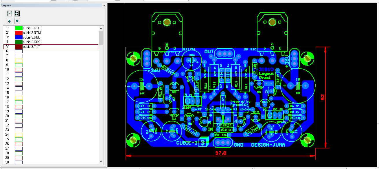

Is it possible for you to send me(or provide) the Gerbers?
I'd like to see how this sounds compared to the Cubie 2.
Thanks...
there you go..😀
reg
Prasi
  • cubie-3.zip
    cubie-3.zip

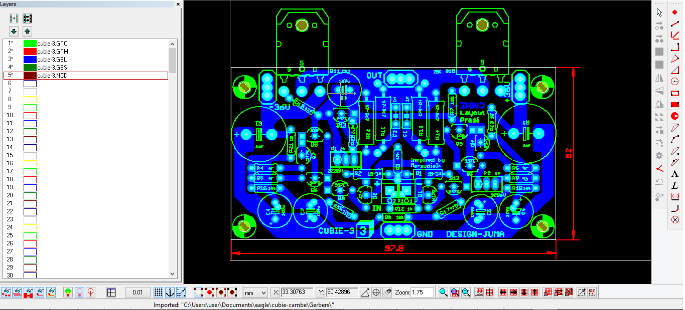

Thank you Prasi.
I was able to import everything into Sprint-Layout and everything looks good, except for the Excellon drill file.
The vias are above the board and really scattered out. Frustrating...I wish these files would be more standardized.
Why not use them as they are. board house would have no problems processing NCD and other gerbers posted.

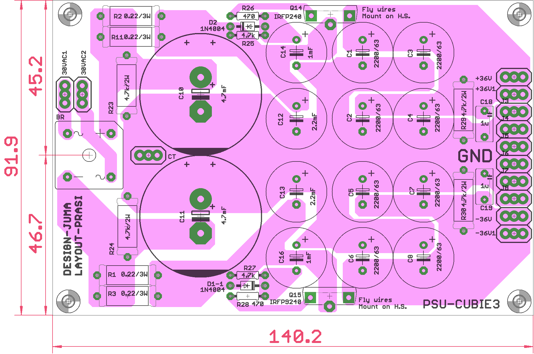

Amp is incomplete without PSU.😀 This is what I could come up with. I have no way of telling if it will fulfill the design requirements.
reg
Prasi
Juma,
1. Can this PSU be upscaled for +/- 56 V (obtained from ~40VAC-0-40VAC trafo that I have) for supplying to other stereo class AB amps other than capacitor voltage specs?
2. What would be DC o/p voltage in case of above 40 VAC trafo? I see that you have mentioned +/-36V from a 30VAC-0-30VAC trafo.
3.what are the advantages compared to simple rectifier+caps bulk PSU.?
reg
Prasi
Hi Prasi,
1. No. It would be too much for a single output pair. Further modifications would be needed in the front end/VAS too.
I used a cap multipler in the PSU (see post #1) hence the the +/-36V DC out of 2x30V AC because it sounds better to me than just a rectifier + caps.
You can try to regulate the PSU that you have down to +/-36V but I suppose it would be too impractical (too much heat developed in the PSU).
Hi Prasi,
Hi Juma,
Thank you for explanation.

I am attaching the pdfs of PSU Cubie-3 for builders. again, clearances >24 mils, 0.635mm thick annular pads. make a sharpie version, if you like😀.

drill.txt
Most board houses I've dealt with, like OSH Park, require drill files in text(.TXT) format.
May be a simple matter of renaming your .ncd file, but I would like to know why the drills don't display correctly in Sprint.
Hi Ammel68,
I have attached new gerbers, ones that have a drill file in txt format . see if this is what you require.
reg
Prasi
  • cubie-3.zip
    cubie-3.zip
