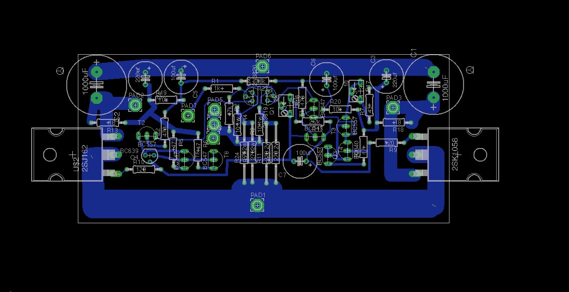

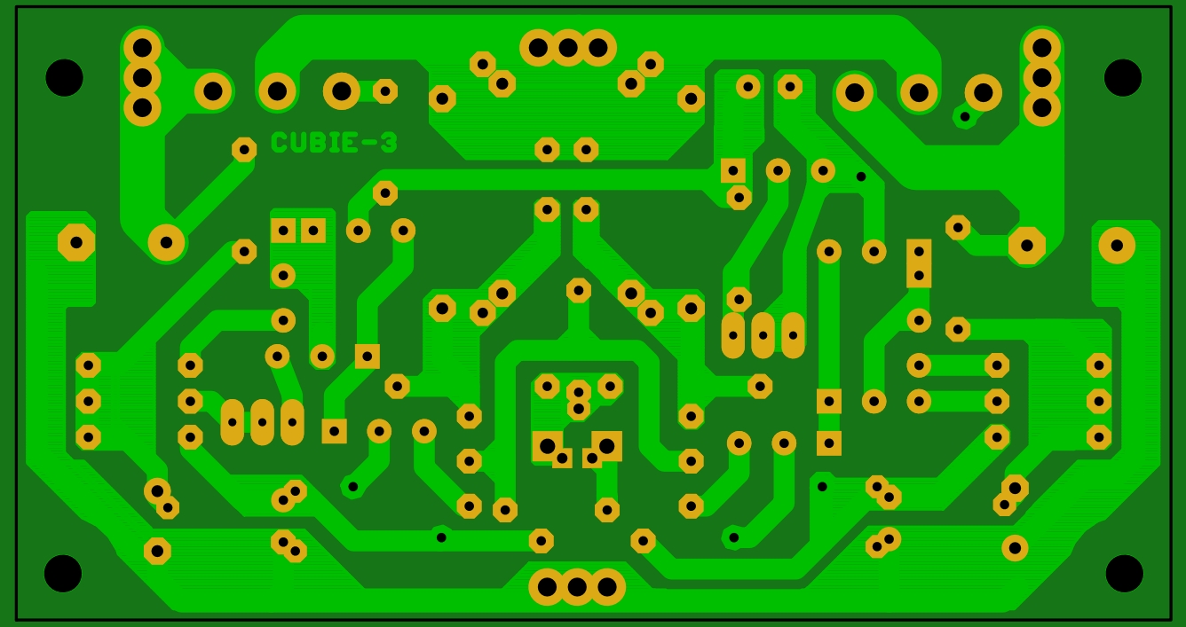

Looking at your bottom copper layer, parts of some of the wider traces look as though they're made up of a series of small traces stacked upon one another(or parallel to one another) as shown in the photo below.
Is that how you laid out some of the wider traces?
Thank you for the Gerbers and I learned something new.🙂

Actually thats how eagle CAD handles polygons and the visibility of lines is due to computer display (if you zoom in enough, the lines disappear). It doesnt create any problems when either doing diy etching or making professional PCBs (I have done both ways with earlier PCB's). If you are doing the PCB in sprint, make an appropriate polygon (or "zone" , I think its called) that encompasses the polygon copper area.

Prasi, you are correct.🙂
I traced over one area(or polygon) of your board after clicking on the "zone" option.
The one I did is on the left and there aren't any more lines.
It's good to know that the lines won't have any effect on board manufacturing, though.

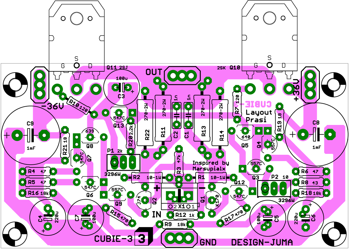

Can anybody scrutinize the layouts I've posted for a mistake. I rebuilt the amp on the new board, and I get approx. 1/2 amp current draw, but something starts smoking almost immediately and I unplug. Got immediate smoke on old board as well. Something is wrong, but I haven't been able to locate it. Has anyone built this successfully, with one of my layouts? Pretty discouraged, I guess.:cubist:

Thats bad luck. Dont be discouraged. Can you post a photo of your laterals? did you buy those from reputable/ confirmed source? Also did you use all trannies as per the orginal schematic ? or did you make any substitutions? My layout exactly confirms the schematic as I used eagle CAD, there I am quite confidant. However, I will recheck again, just to confirm the devices.

OK... re-Checked the devices used in eagle.
SK170/SJ74 are DGS (looking from flat side)
BC547/557 are CBE (looking from flat side)
BC639/40 are ECB (looking from flat side)
lats are GSD. (looking from print side)
(Left to right side ofcourse!)
So the layout and sch are consistent.so from my side everything looks ok.

... Something is wrong...
Are you aware that layout has 2 ground points (S-GND and P-GND) and that both should be connected to main ground ?
If not, the JFETs (and not only them) will burn.
Also, your k170 is the wrong way round (maybe some other components too, but it's hard to follow your layout (post #185) - too many collors and strange elements (X1). Good pictures of actual boards would be better.
Also, your k170 is the wrong way round (maybe some other components too, .
Good catch!, which I missed somehow. K170 needs to be rotated by 180deg. others are OK.
That strange element is an ordinary 2 pin terminal block with 5mm pitch🙂 + it has some additional pads 2.54mm pitch so that people can use whatever is handy.
Got home, flipped K170, still got smoke. Time to test the latfets.
It looks like the flipped K170 was introduced with the prasi revision. Not throwing stones, just sorting out the situation. On my original, the K170 is as it was on juma's layout. They both emit smoke at my house. On prasi based (larger) layouts, please flip the K170. Thanks. :cubist:
