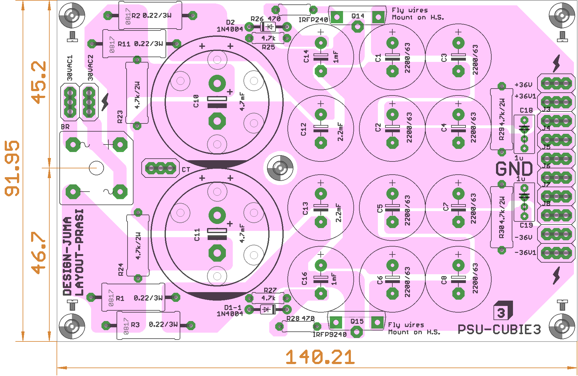

Hi Nicola,
Got your PCB's, they indeed look great and very tiny.
I wish you all the luck for your build. If you need any clarification on component packages, do let me know. I will be happy to help.
regards
Prasi

prasi: The CM layout you show in post #258 looks good. I would like to point out one thing to consider. It shows mounting a bridge rectifier like the Vishay GBPC-W. This will work fine if the user sets the current bias low. However, if a person wants to have an Iq of 1 A or more though it, this rectifier will get quite hot, in my experience. I do not like to mount things hot near any elko caps, which would shorten their life. With a higher Iq like this, the user might consider mounting the rectifier off board. Notice juma mounted his on the bottom plate in post #1. Or a person could use Schottkky diodes or some other diode with a low I F which would not get so hot.

Hi propitious,
One could mount the bridge rectifier anywhere one wishes and run wires, one could also populate the power resistors from bottom sides. it would work fine like Juma's original build in post #1. After all its diy. I could make a design with MUR1560 with dual rectifiers and all the conveniences thrown in, but might result in a larger PCB.
whatever works for the designer, should work for all.

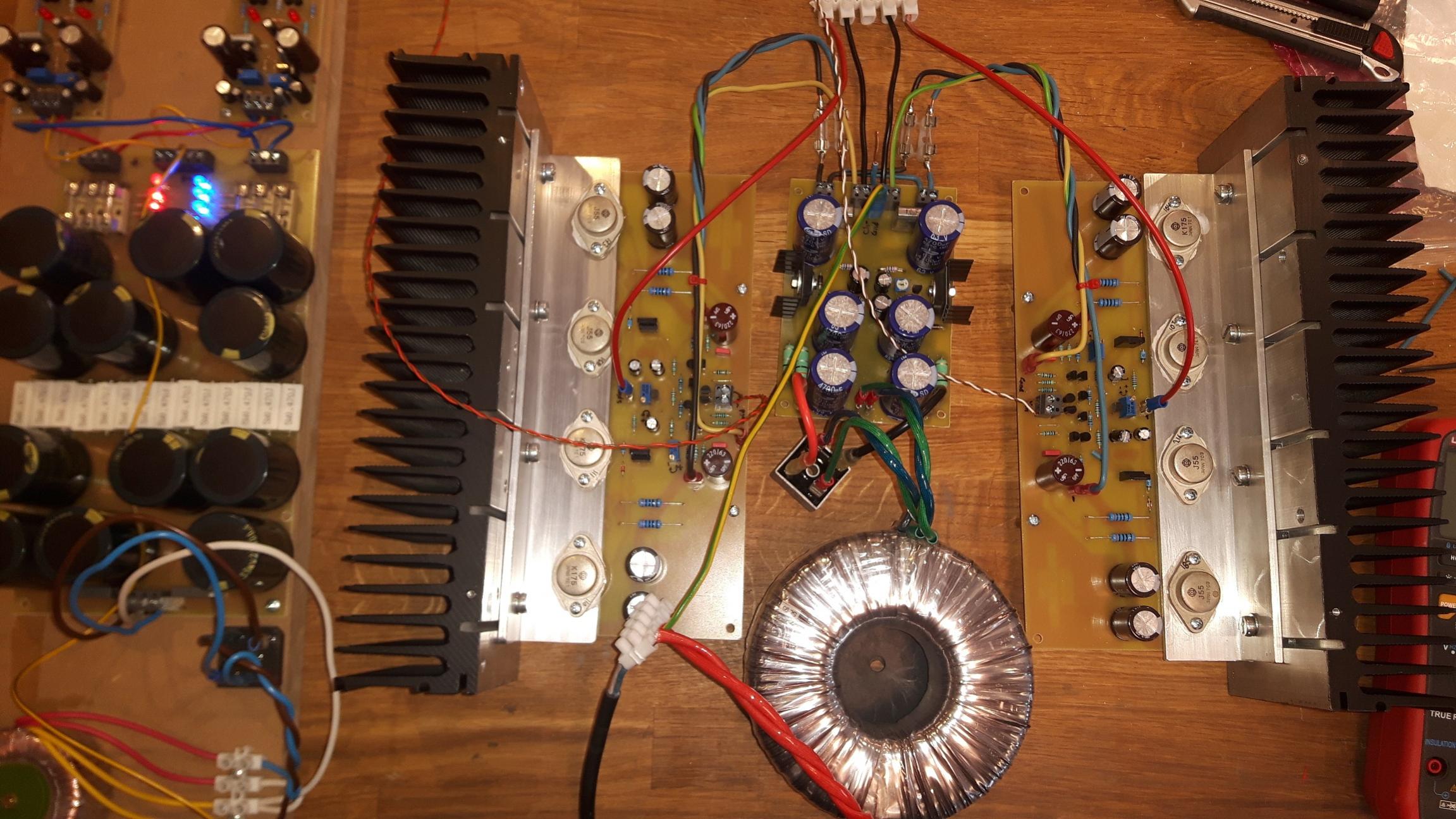

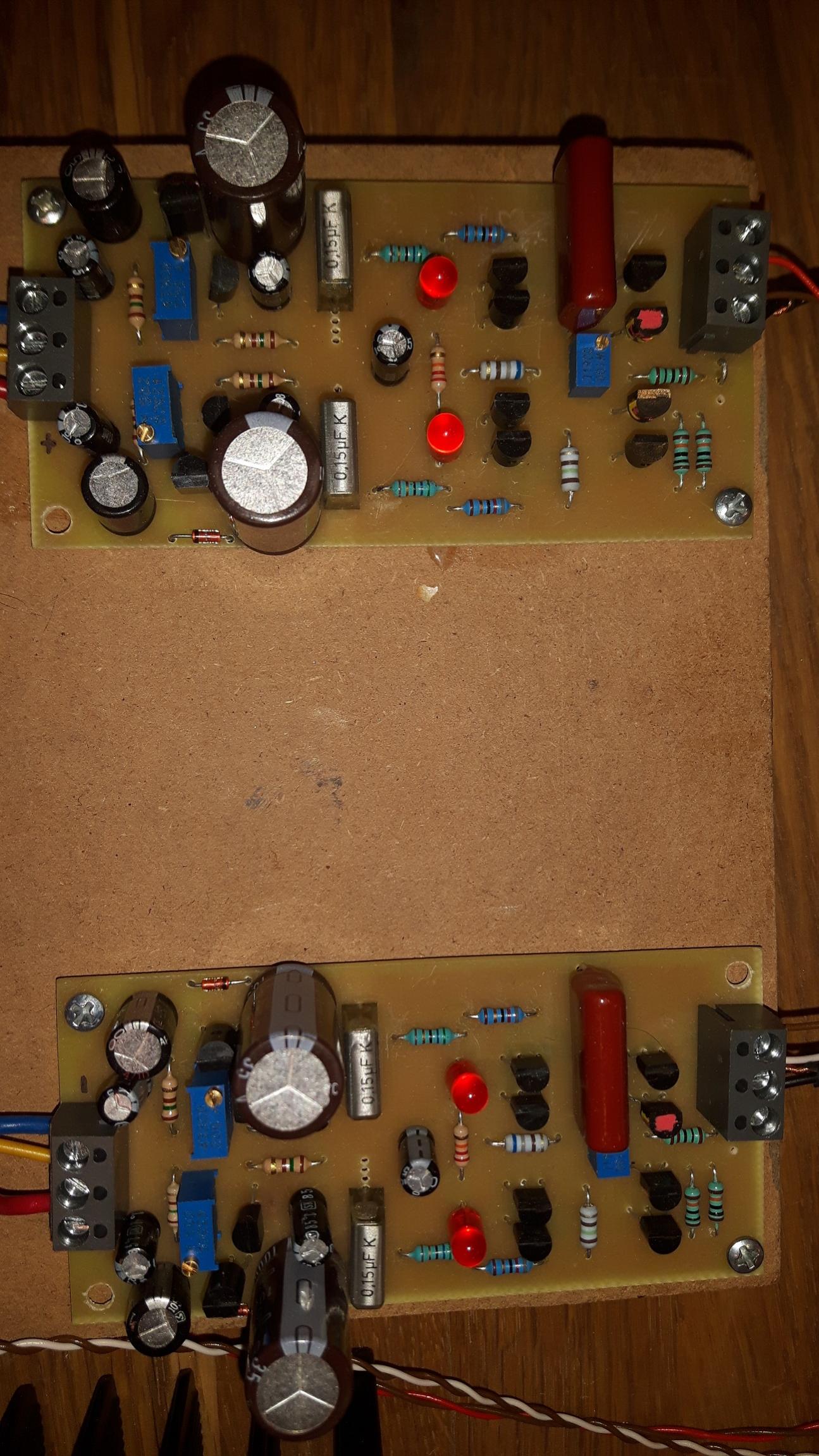

Cubie 3 Turbo
I'm testing a Cubie 3 with 46V rails.
So far it's sounds explendid 🙂
A bit high current (~8mA) on drivers, so the BC's runs att 45-50 celsius.
Drivers are 2SA1930 / 2SC5171.
Outputs are two pairs of 2SJ55 / 2SK175.
The preamps are Juma's. Complementary Jfet's cascoded with BC550/560.
Every has it's own regulator onboard.
Very low noice and low distortion.

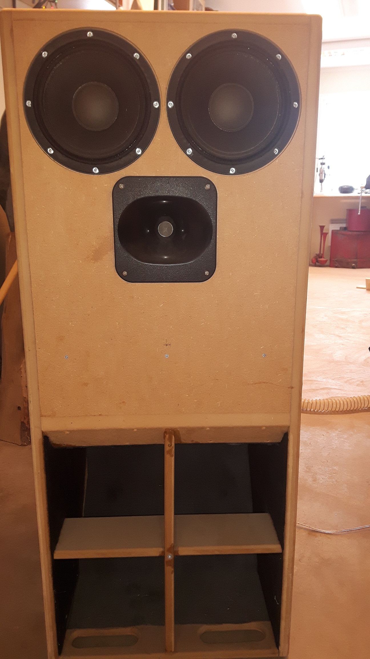

Speakers are BLH with Beyma 8G40's and CP380M on short horns.
/Figge

Hi Prasi,is it possible to post this for home etching?
Hi Thimios,
Completely forgot about your request... Here are the pdfs, whether they are still relevant?.
So sorry thimios.
regards
Prasi

Nice build Trollet,
except o/p, rails and drivers, did you change anything else from the schema?
Nice big PCB, reminds me of the JLH2003 PCB I did..
what is the bias you are running?
regards
Prasi
Well Prasi there's not much changes.
Jfets lies about 7 to 8 mA Idss.
The emitter resistors for drivers are 39R, maybe on the lower side. I did try KSA1220 and KSC2690 as drivers and it didn't work at all.
I don't really know why but guess it has something to do with saturation. Just swapped to the Toshibas instead and it worked fine.
Sometimes LTSPICE don't know what it's doing... Or is it me😀
I run at 300 mA bias now. The HS for regulators run at 40C but I plan to bolt them to a aluminium bottom plate so I guess they will manage a bit more. Output mosfets works at 28C so 5 or 600 mA may be plausible.
Only thing with PCB's is that a big toroid makes it tight to match width to 19 inch. Should have made them less slighter :blush:
Just waiting for some upc1237 now that I guess Trean from a Norway forgot when he dumped his "to do things" this night passing by 😕
