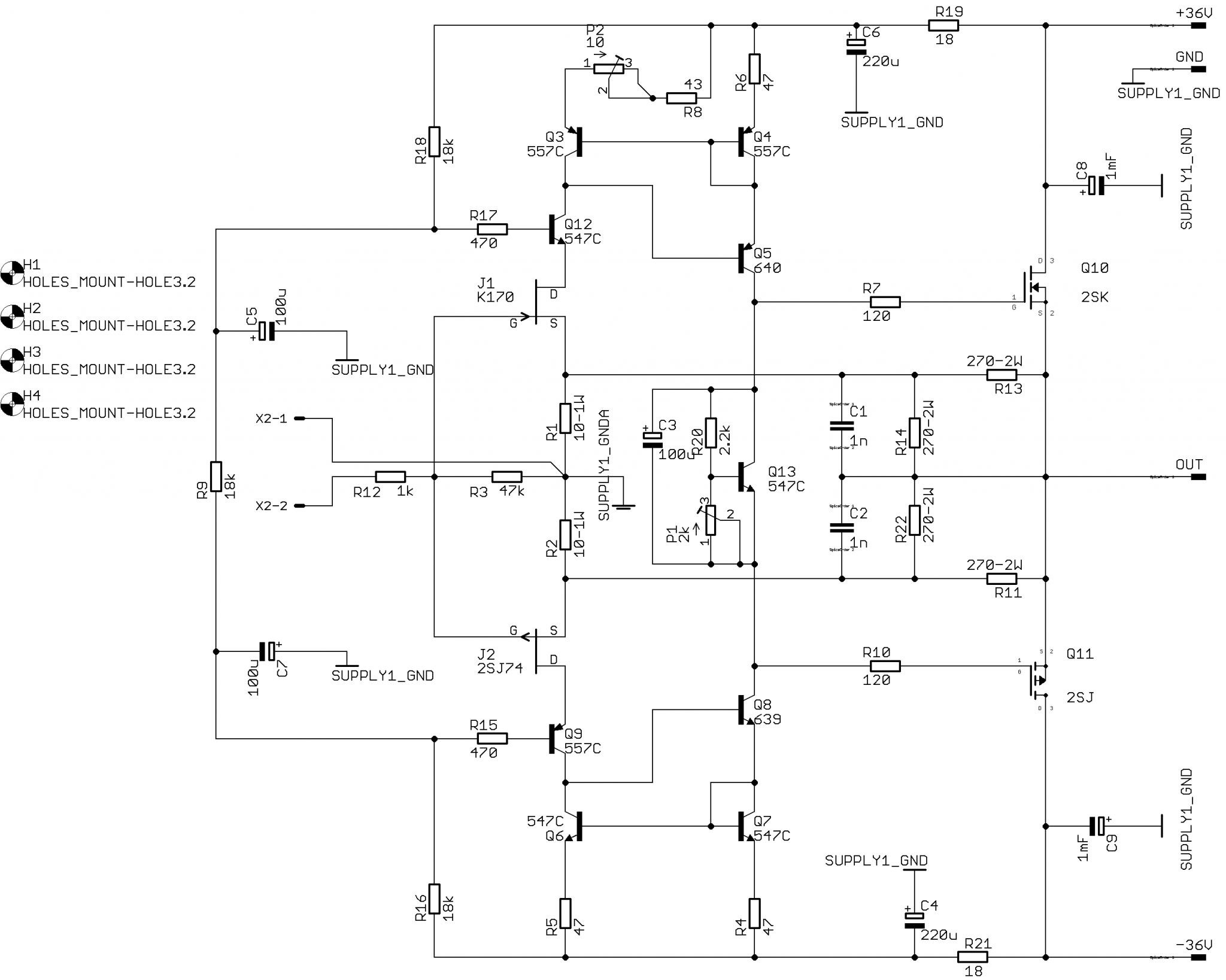

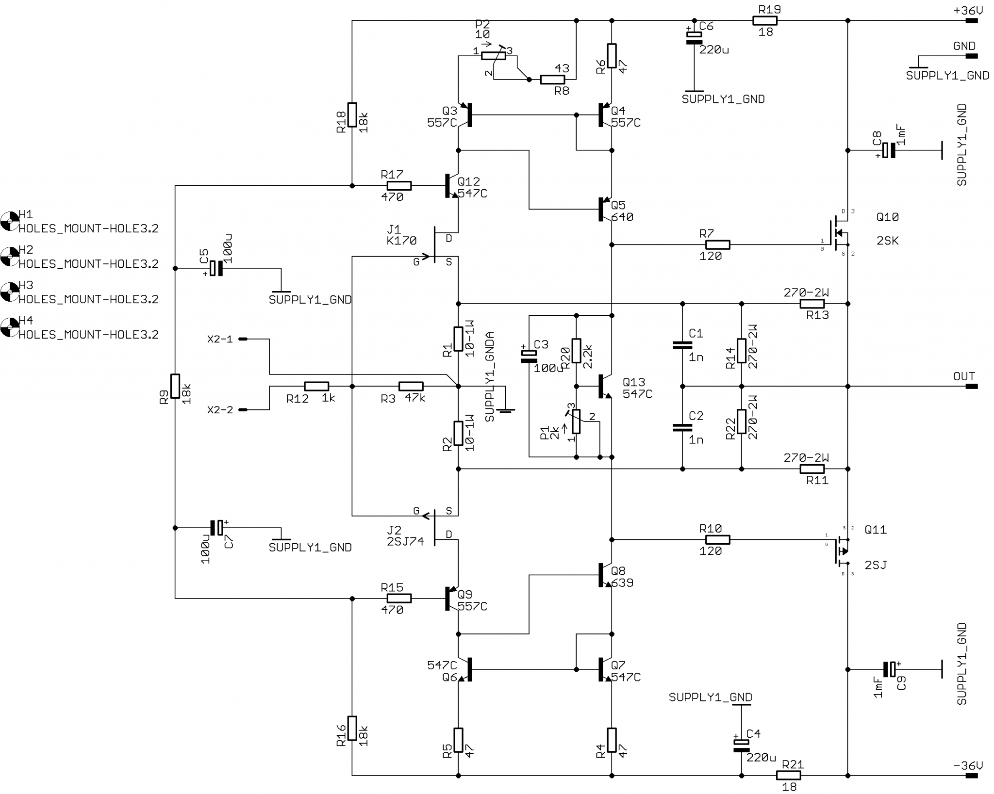

Anyway, I don't think I did anything stupid, but I'm pretty new at the analog side of things so I could well have. One thing I did notice is that it goes into oscillation when over-driven (ie: 1.4V at the input). The unmodified schematic does this too, so maybe it's just my SPICE models or something?
Any comments appreciated.
Thanks,
Jeff.
Jeff
You have wrongly connected C1, R5, C3, R17 to ground instead of output. Just look carefully at circuit in first post.
I just noticed the determination of current mirrors value based on ID (thus IDSS) of the first stage which is nice🙂
Fab
Oops, I did indeed. (I wondered why adjusting the feedback didn't do what I expected.)
Thanks @fab!
Thanks @fab!
With my error fixed distortion drops a bit, I was able to adjust the feedback voltage divider to a more reasonable 270/330, and when overdriven it just clips (no oscillation).
Sweet!
Sweet!

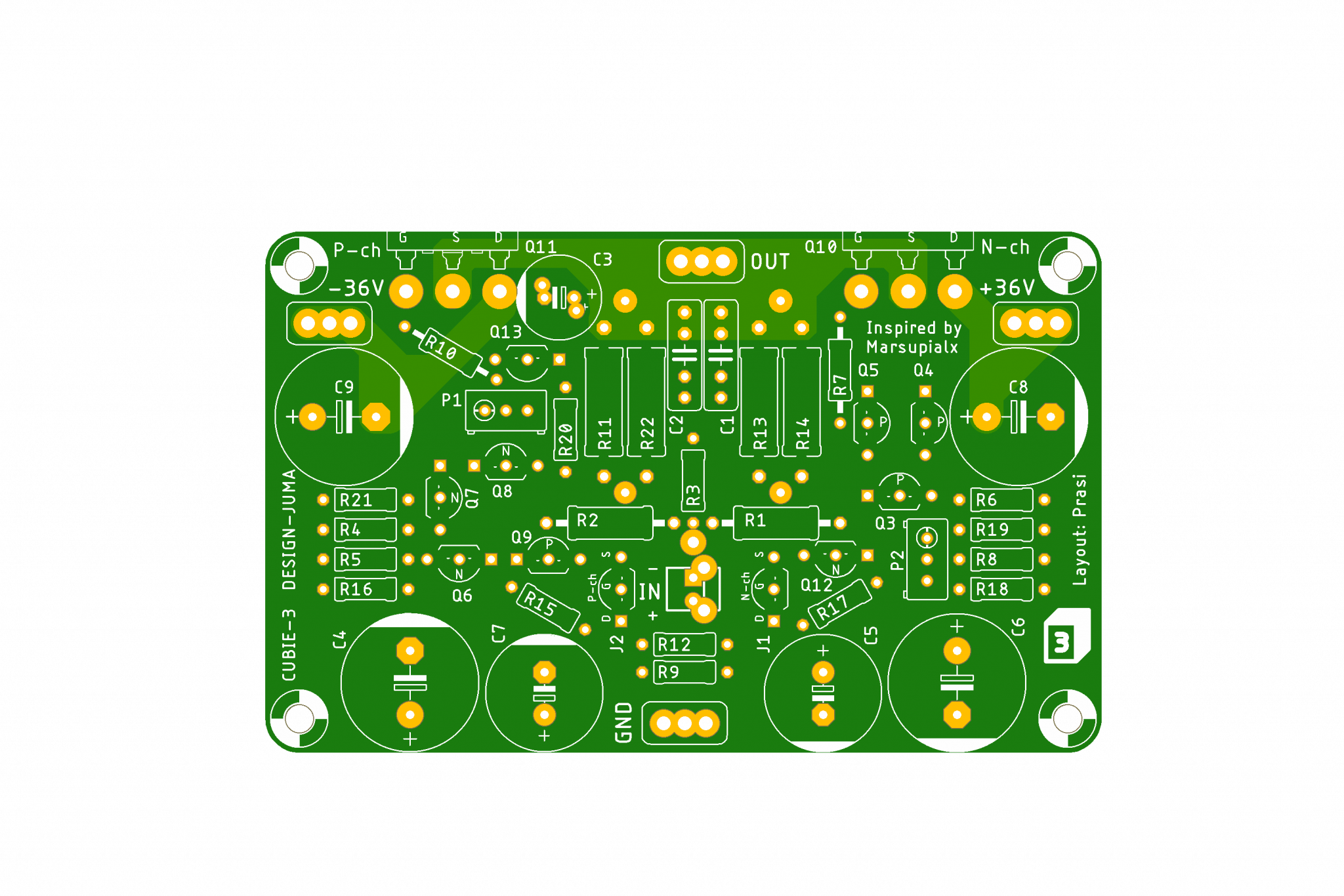

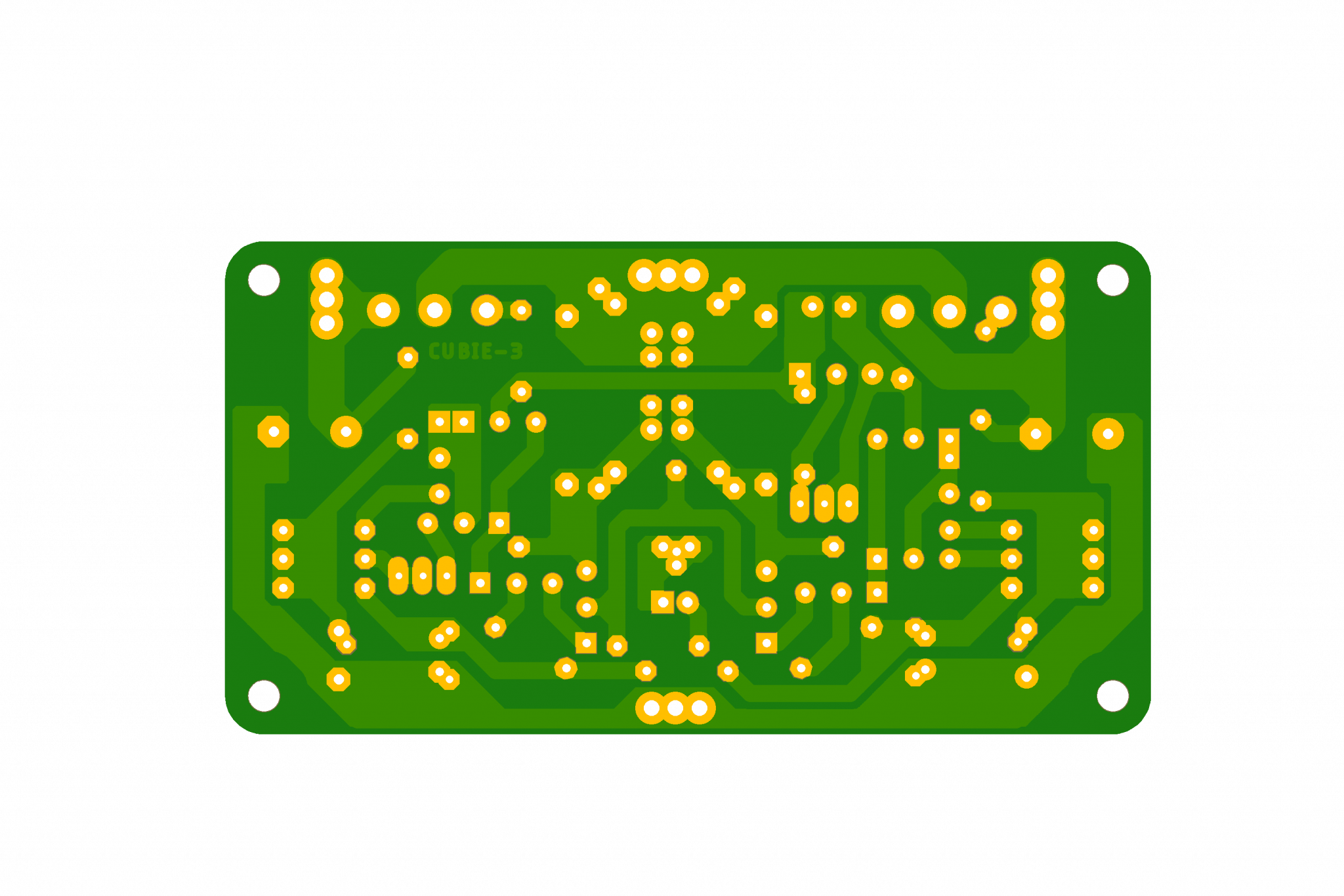

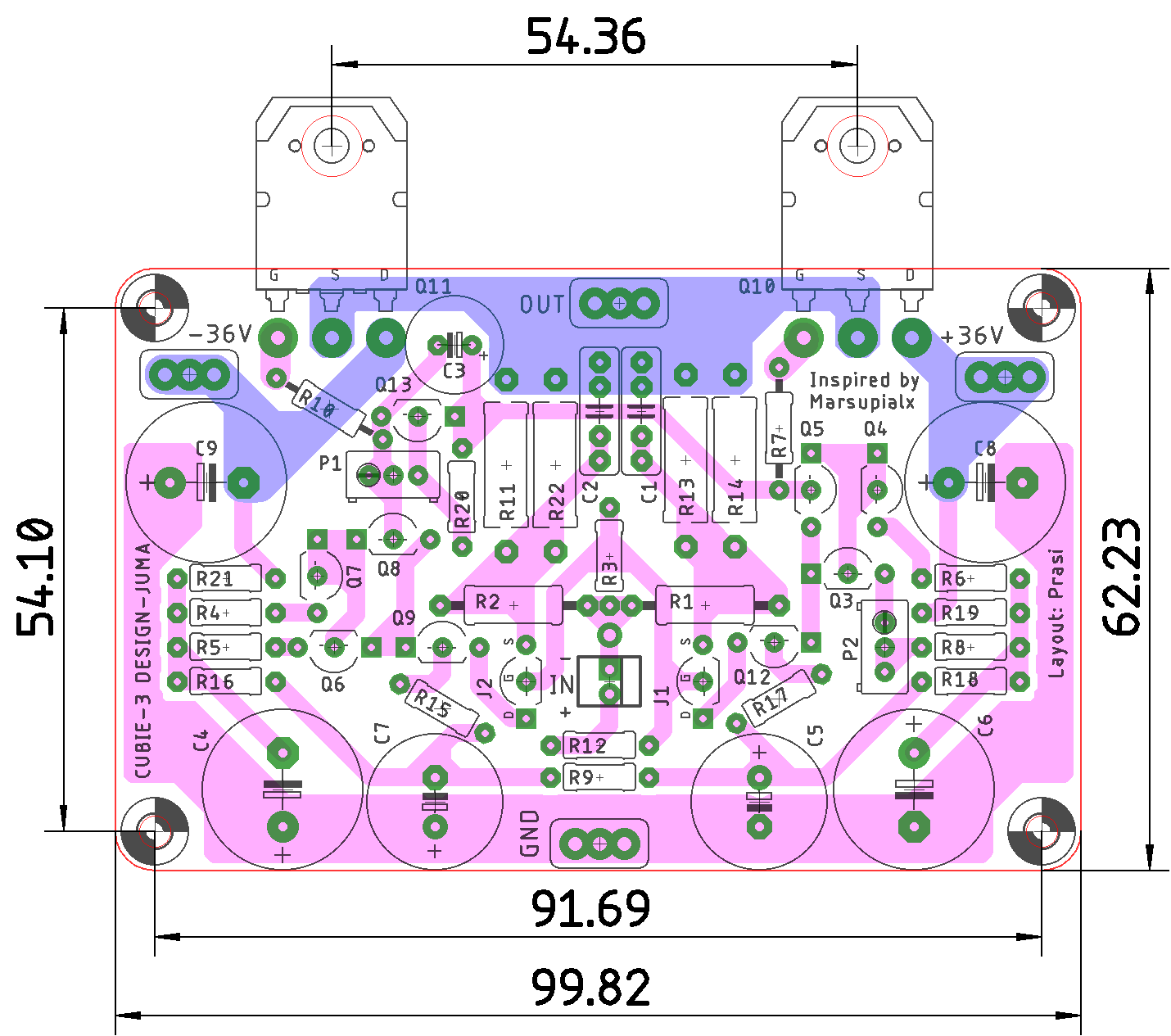

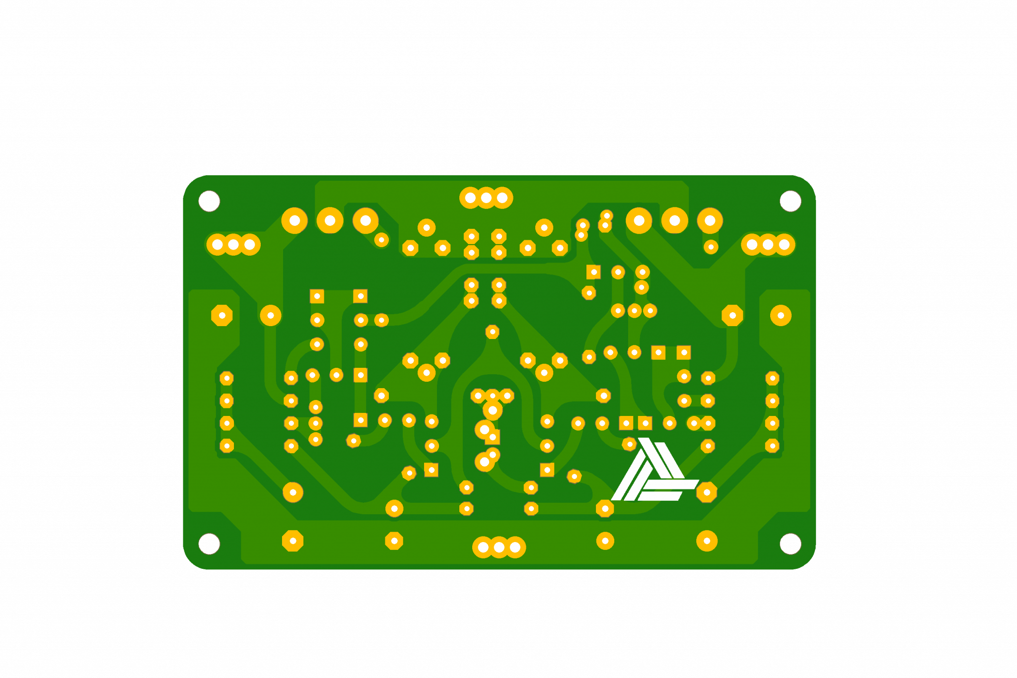

Here are the gerbers for the version with double sided pcb design, as requested by a member.Hi Gabor,
The layout you attached is correct except for K170 orientation , it should be rotated by 180deg .
here is the correct layout. if you want i could post pdf and its sch. its not tested.
A member has ordered/ going to produce double sided PCB's with re-inforced high current traces. You could contact him to get a pair for your friend. lot less hassle and a breeze to build with PCB.

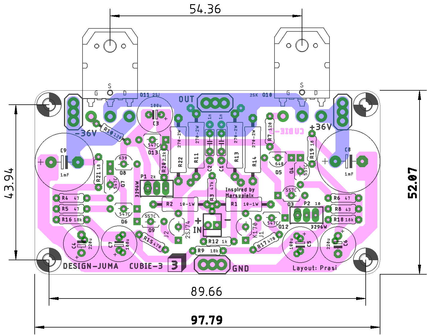

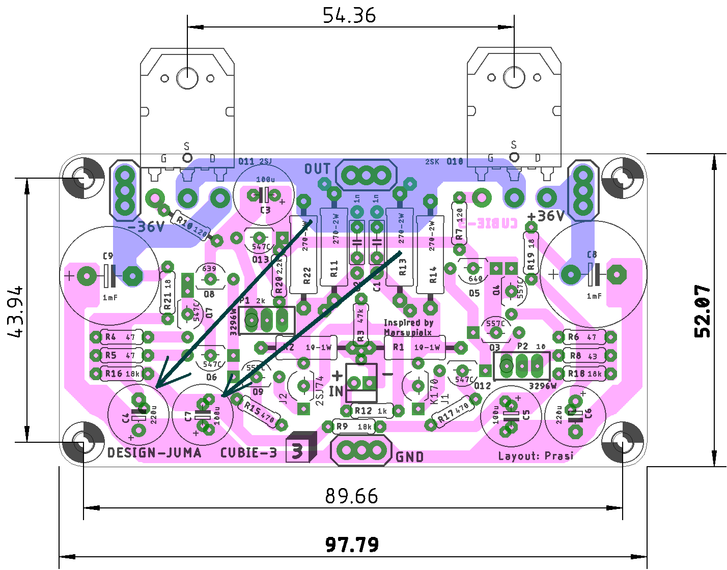

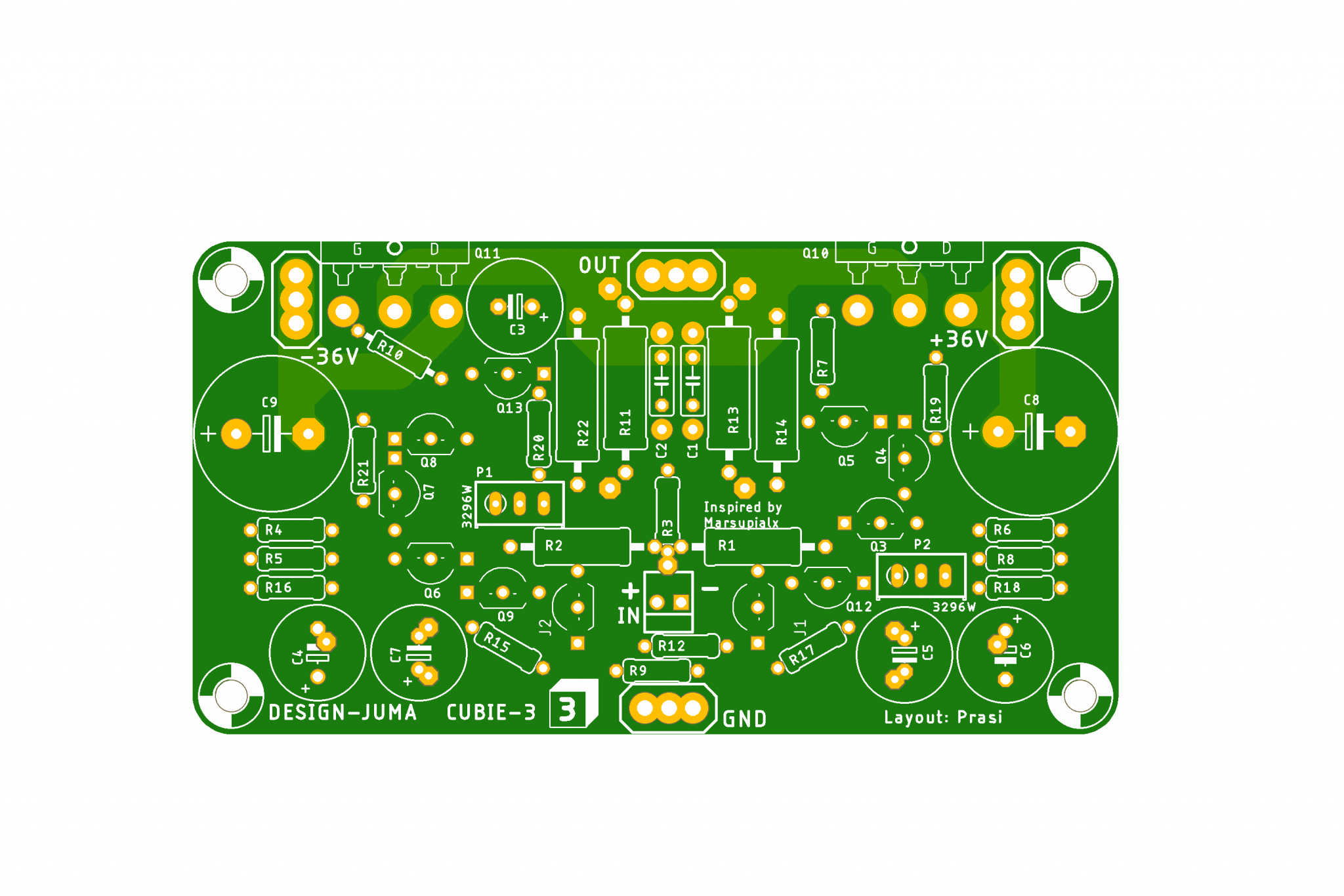

I have a question What is the voltage rating of the 100uF and 220uF (marked) capacitors? I have a lot of Silmic at hand but I can not install those because of their size. I ordered way back a lot of those Silmics they are just too big. At first I thought to make a home brew PCB so I can use use those caps I already have. The same time the home brew quality far behind your PCB. Maybe I can get some lower voltage good quality caps but smaller size. I have all the other components for the amp to test and finish her. Greetings
Hello Gabor,
I think they see full rail voltage , so need be 50V atleast. and the dia of caps is 10mm.
So I think you will have limited option .
Checking mouser, we seem to have 157 options, out of which audio grade are 8 numbers.
https://www.mouser.in/c/passive-com...20 uF&diameter=10 mm&voltage rating dc=50 VDC
regards
prasi

Hello Gabor,
I can do one thing, I can extend the sides a bit to accommodate your bigger caps. Tell me the size, are they 18mm dia?
And I can quickly post the DIY pdf version so that you can use the slimics that you already have.
Let me know if any other modification in size is required.. I can do it .

Prasi the 100uF Silmic has 13mm and the 220uF has 16mm footprint. I do not think that 100uF next to the 220 it has to be 50V, please take a look before the cap it has an 18K resister. Maybe 25V or even less, it would be great if someone could measure it.Hello Gabor,
regards
prasi
REMEMBER I already own a pair of your PC board, the black one but for future orders of course.

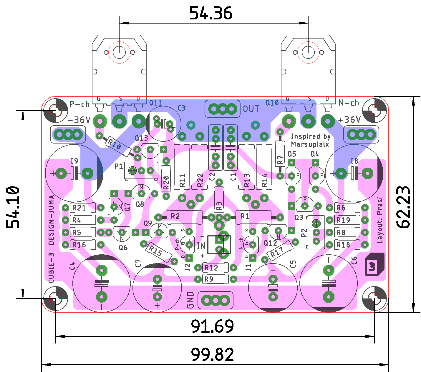

here are files including gerbers and diy pdfs

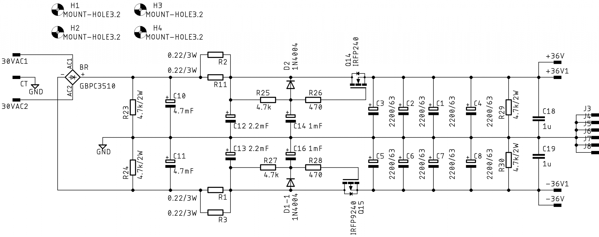

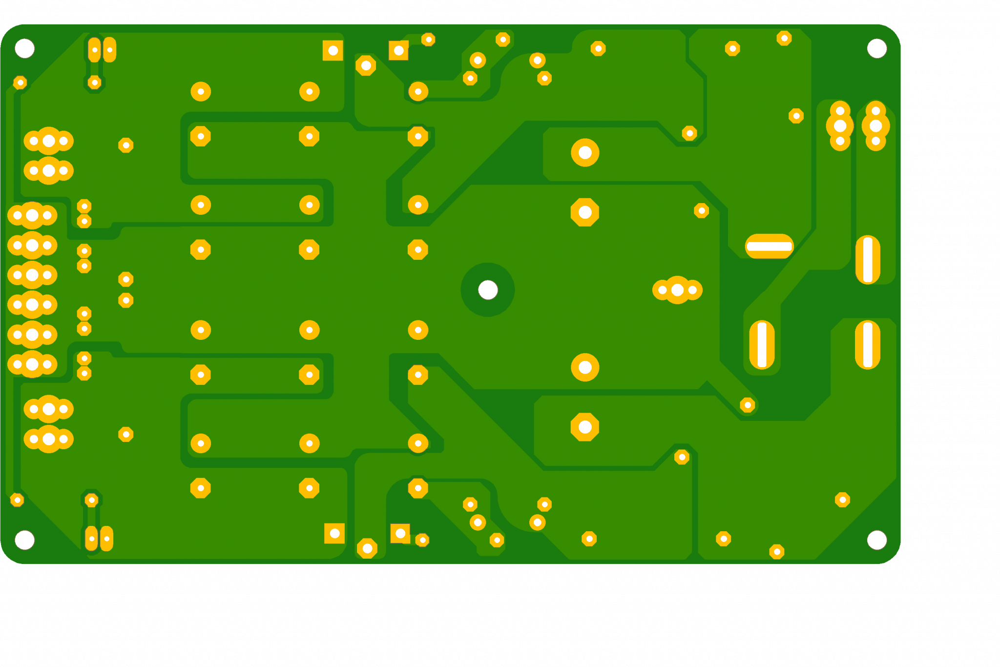

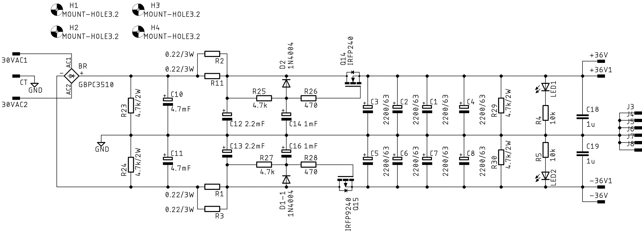

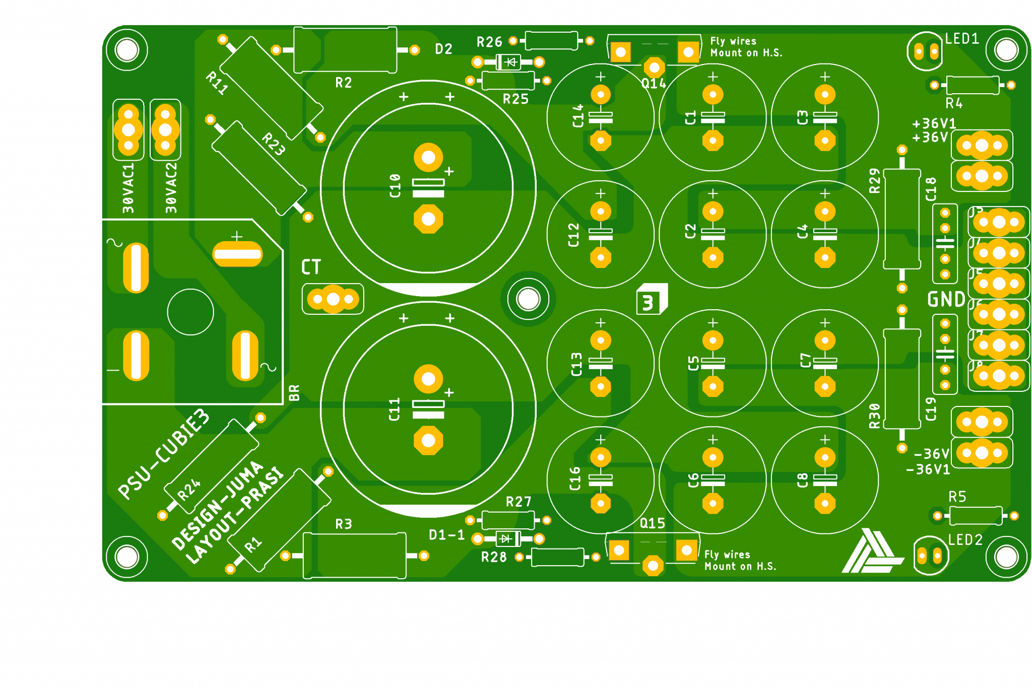

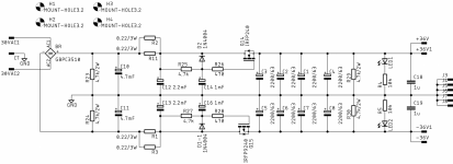

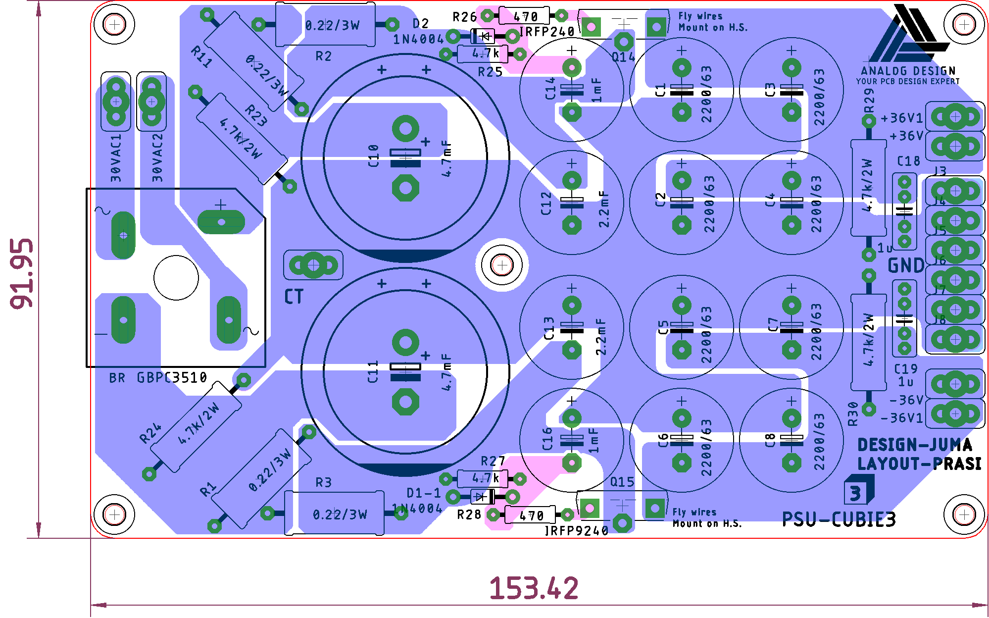

Hi prasi, thanks for the info on the amp pcb's for the Cubie 3. Back in 2018 at post #274 you show pdf's of the PSU board you did to suit this amp. Did you ever post the gerber's for this PSU pcb, if so where? If not can you post them here if you still have them thanks.
Gary..
Gary..

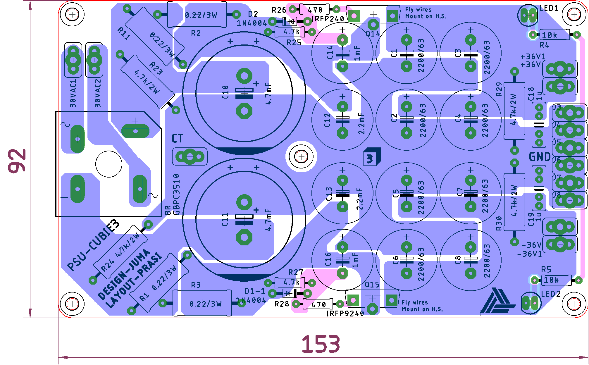

Hi Gary,
here is an improved version with GBPC3510 rectifier, on which you can place a heatsink also.
https://www.mouser.in/datasheet/2/596/SDS_ATS-X50300P-C1-R0-1385600.pdf
here are files for the PSU for Cubie-3.
