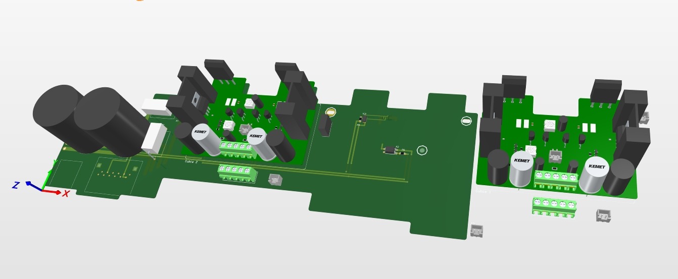

Cubie3
Thanks again juma, will report back.
Yes, the main pcb will have the circuit for the meters and ssr speaker protection.
Edit: and the connector for the headphones.

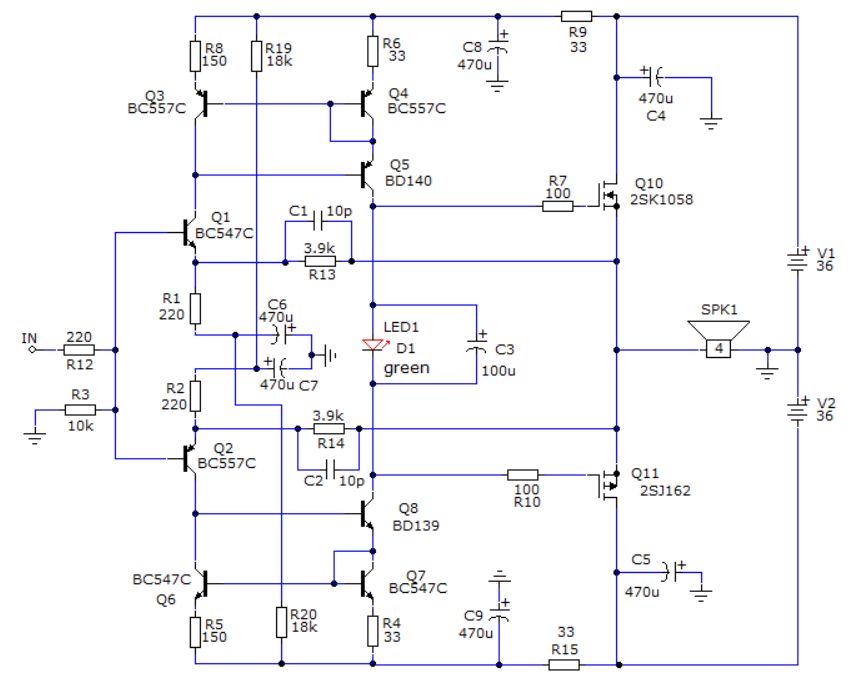

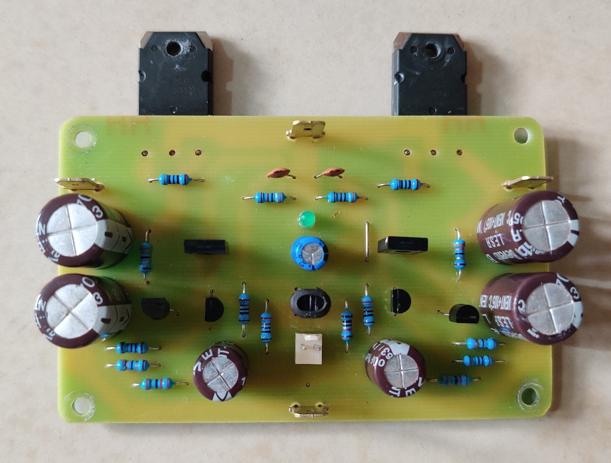

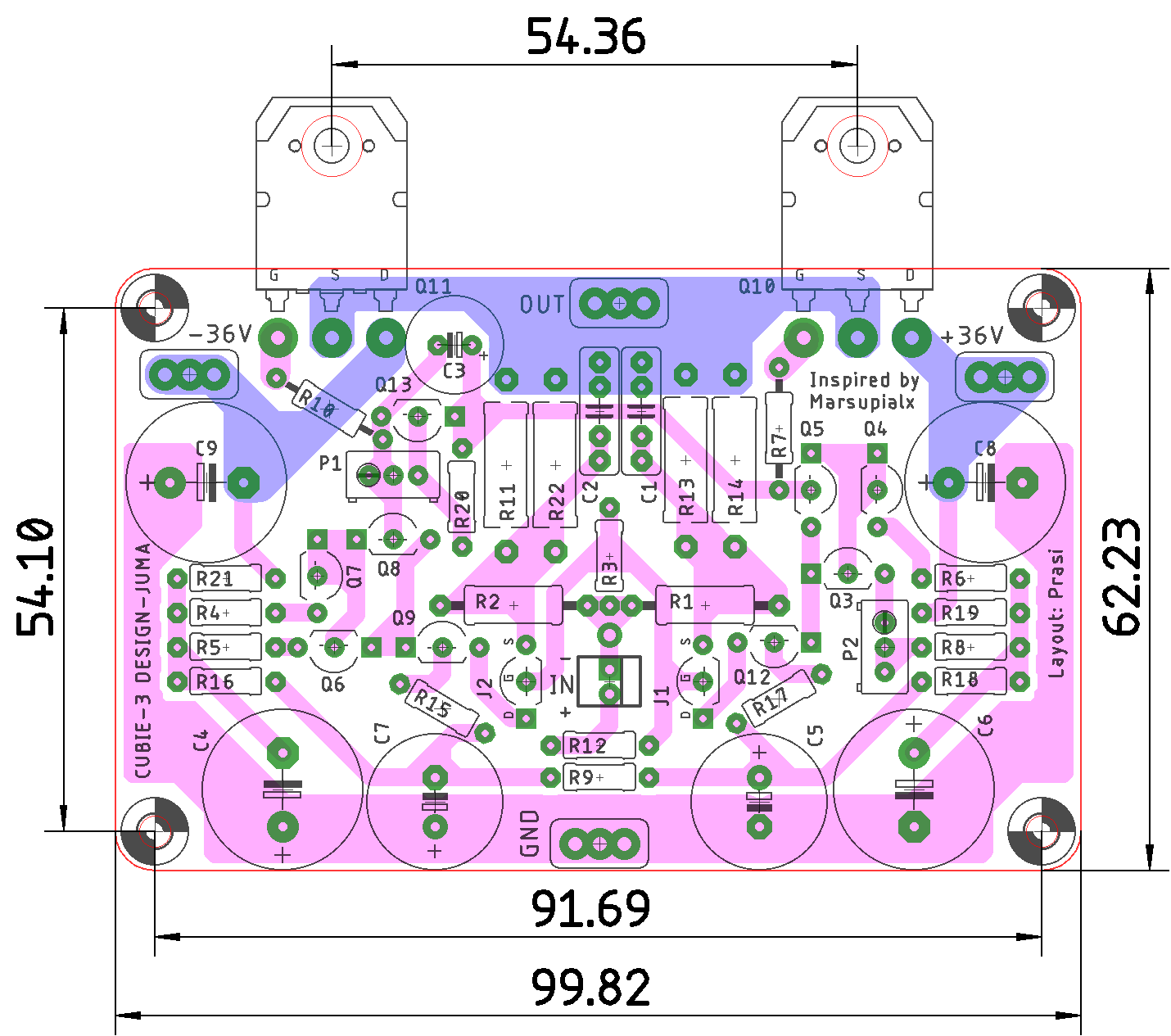

...DC offset is showing around 71mv after 30min of working ,is it normal ?...
DC offset up to 100mV is not a problem but if you want to make it lower, the easiest way to do it is to put a serial connection of 120R resistor+ 50R multiturn pot instead of R8 or R5 so you can adjust it.
Of course, there are other methods: transistors' thermal coupling and/or transistors' matching as well as adding a DC servo circuit etc... There are a lot of posts/threads on these subjects, be free to search the forum/net. :cheers:
Reactions: VishnuS

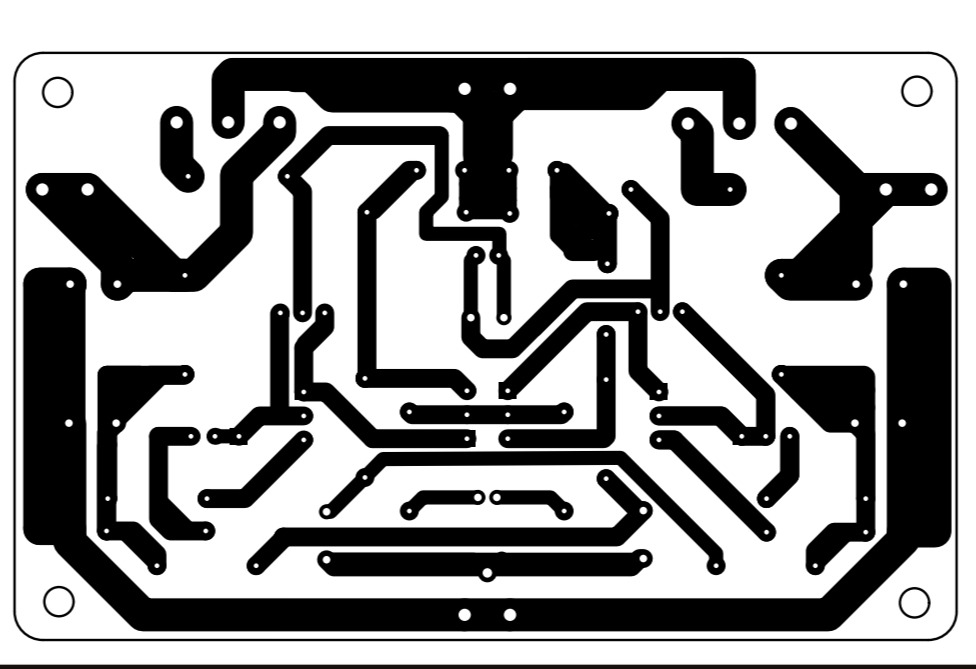

Since there are several solutions, it would be easier to offer the easiest solution if you would include more information of your layout, especially a photo. You will notice from post #1 that juma included a pot in series with a slightly smaller value of R8. If adding in a pot makes it too messy on your layout, then you could find it easy to parallel a resistor with R5 to bring the R8 to R5 leg slightly more negative. That is if the present offset is +71mV and not -71mV. Maybe try a resistor value between 2k2 and 3k3. Small steps are better than big jumps. After you see the amount of change you can use the formula for parallel resistance to calculate a better value resistor.
Would you also measure and post the amount of heat rise you have along with a photo of your heat sink? That may help others judge how much heat sink they need for this circuit. It looks like a very nice circuit that needs only low-cost, easy to obtain parts.

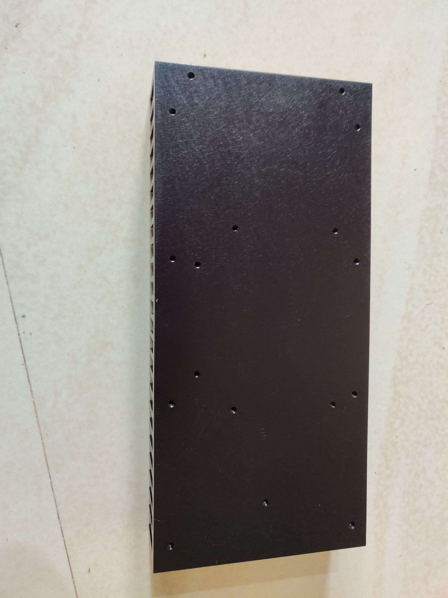

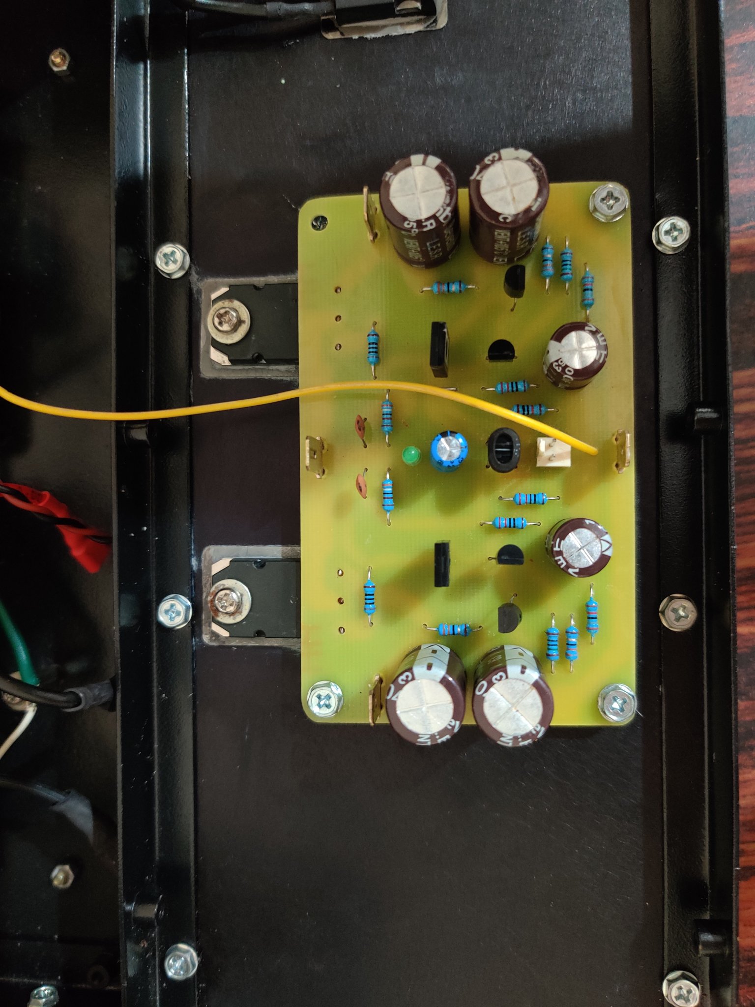

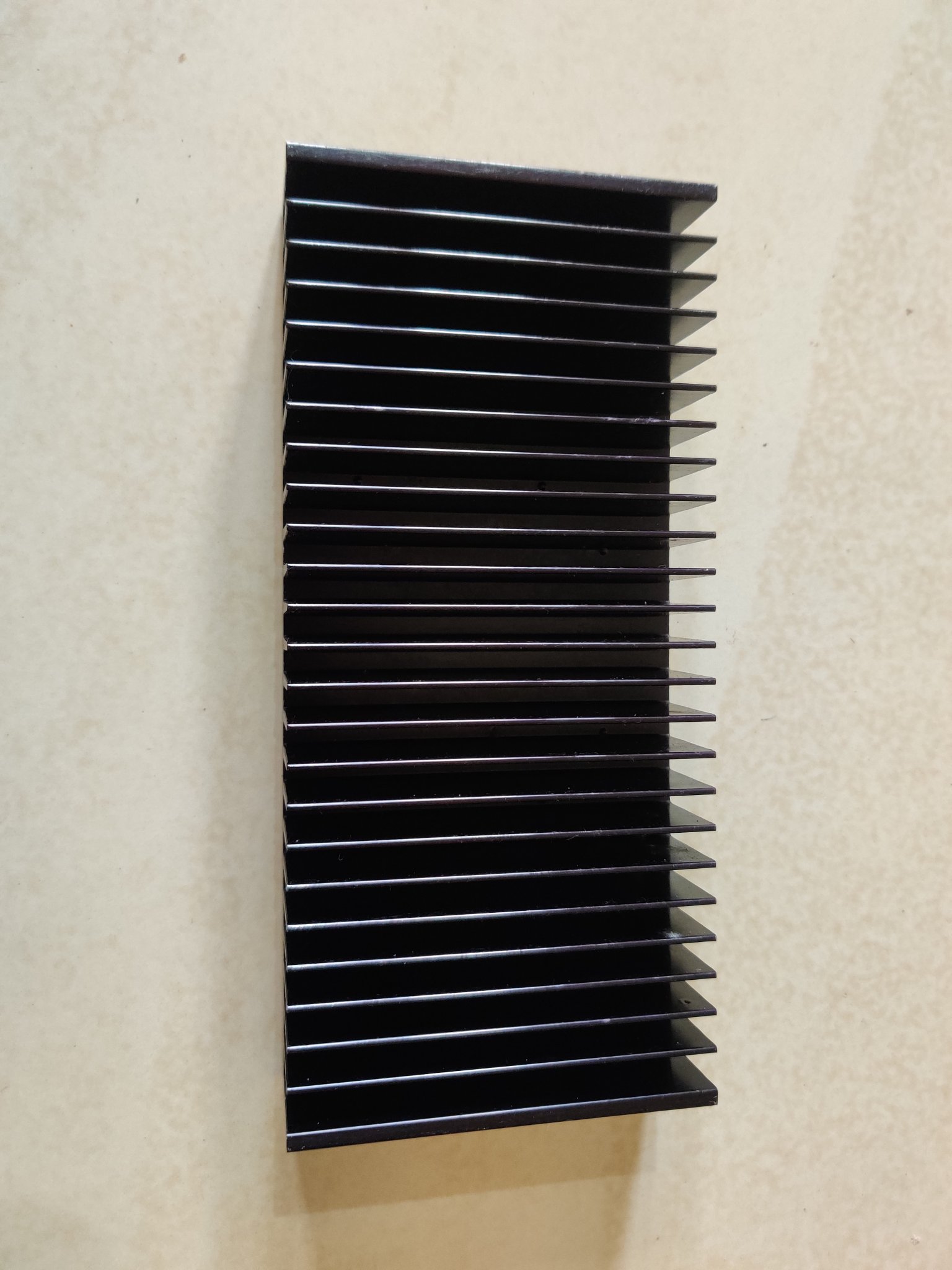

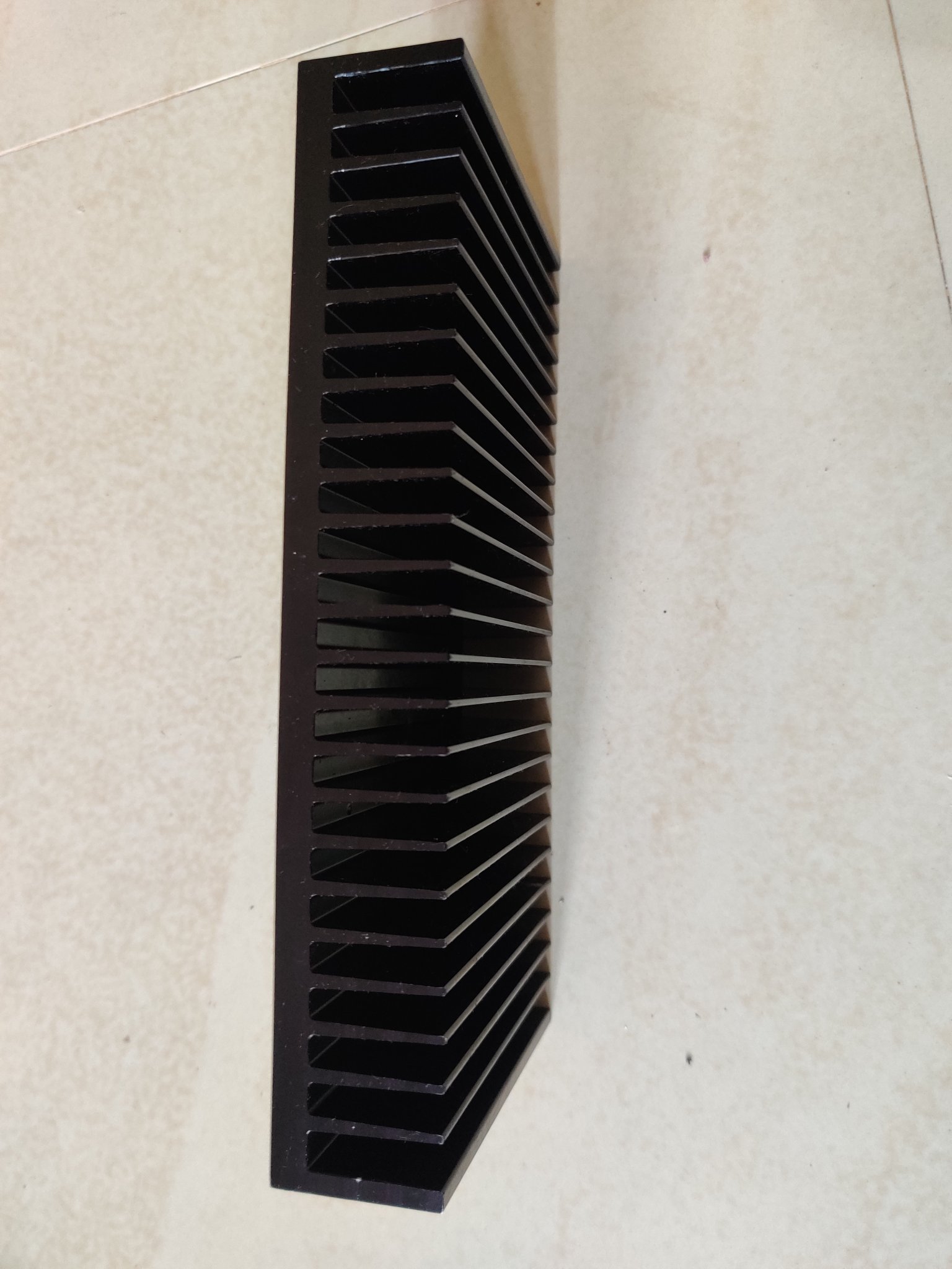

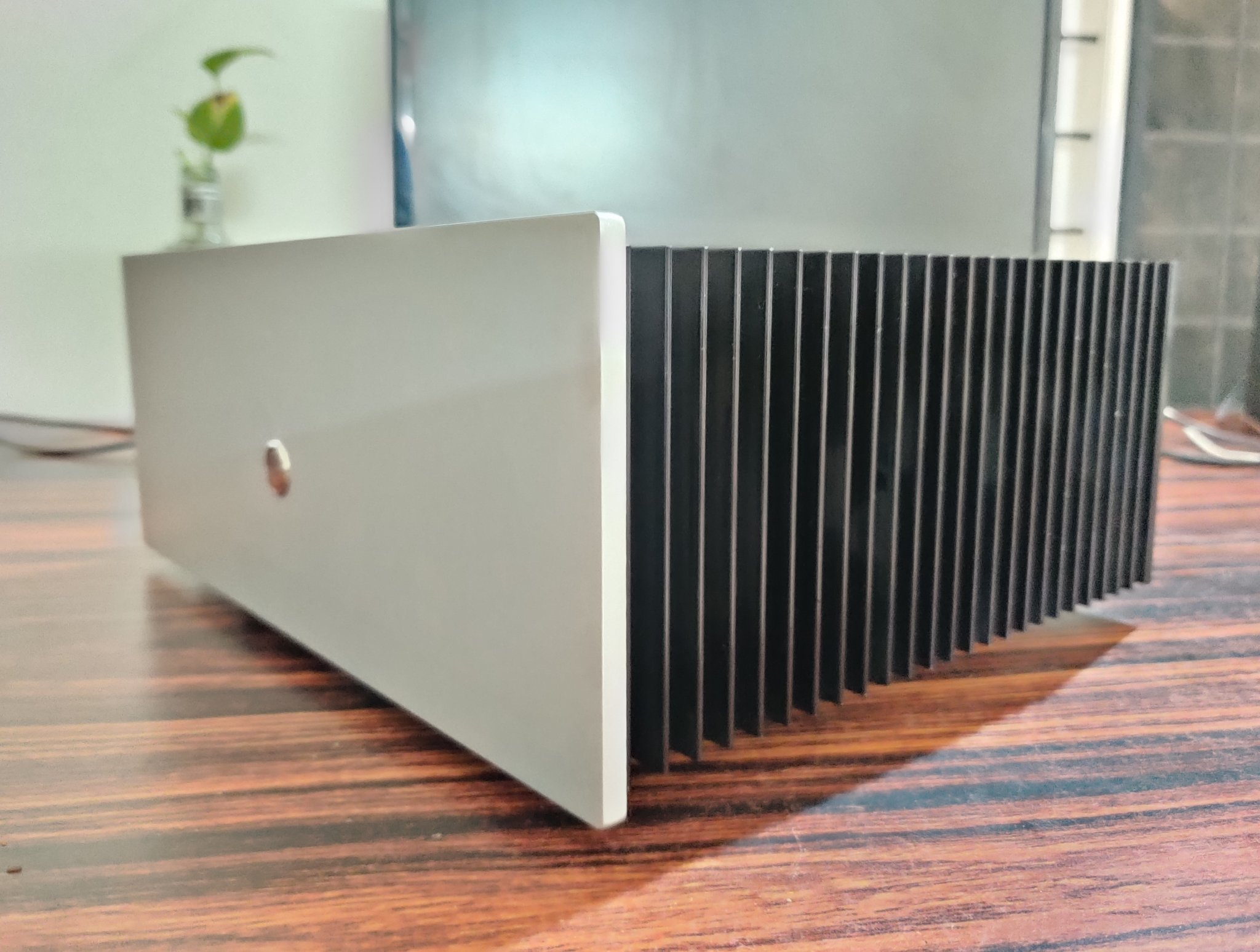

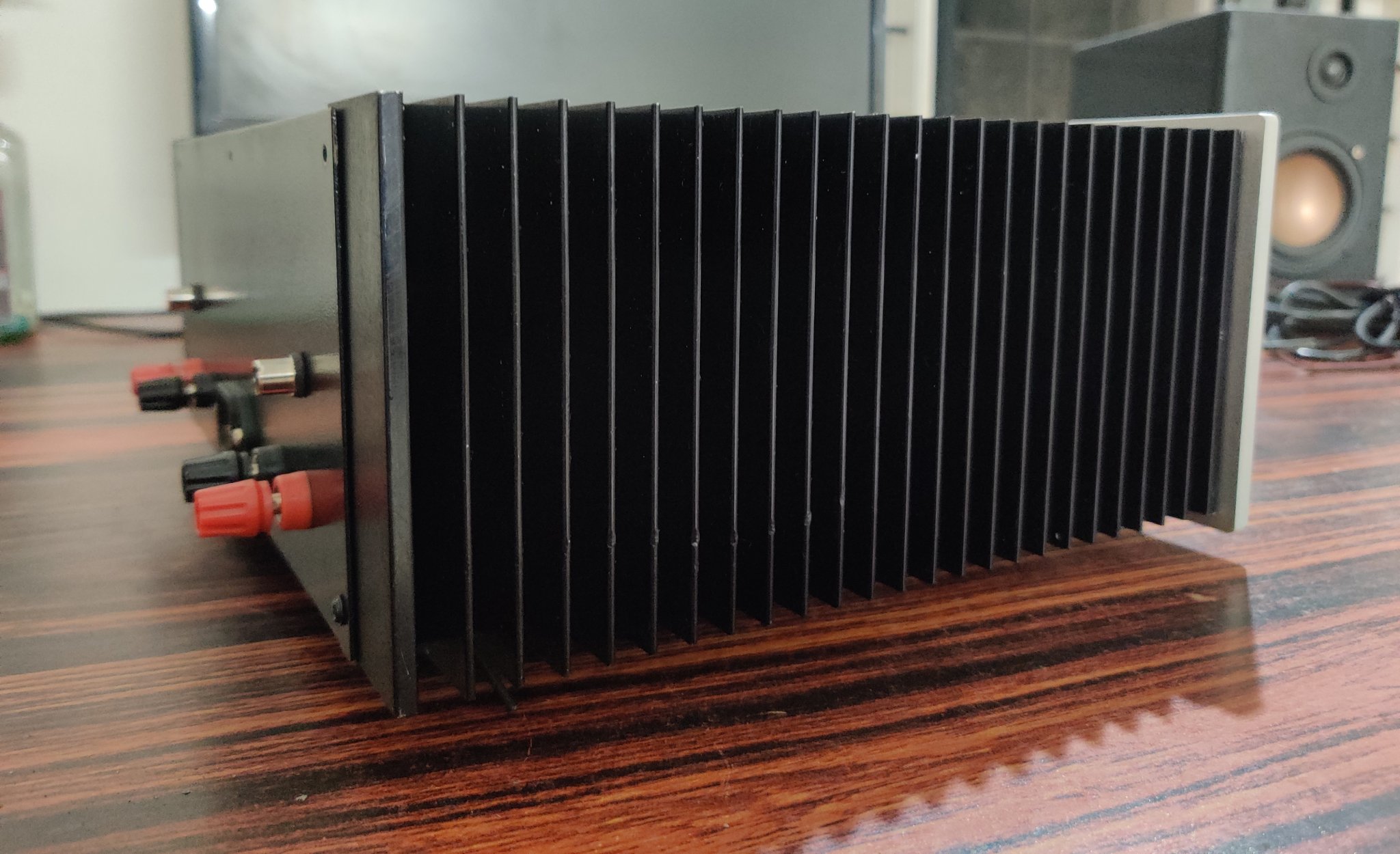

Currently, I don’t have anything to measure the temperature. After 3 hours of working, temperature of lateral mosfet is normal only.
I think below mentioned heatsink size is appropriate
Length-25cm Width-4cm Height-11.5cm
Please find the attached snap for reference

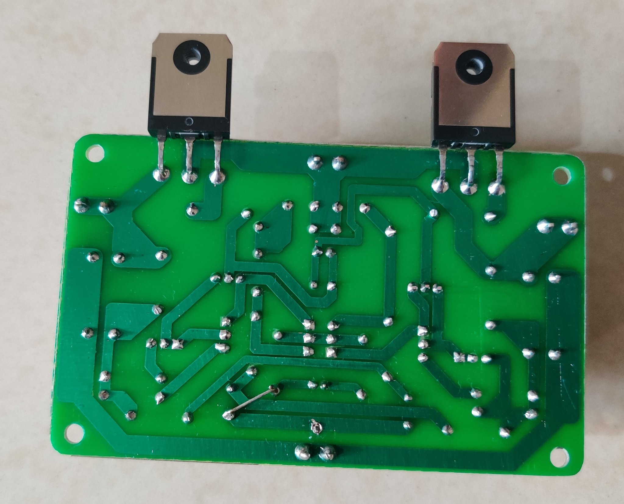

Sir, can i use 100ohm multiturn port?

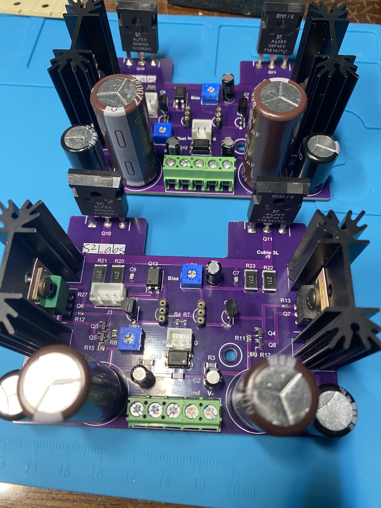

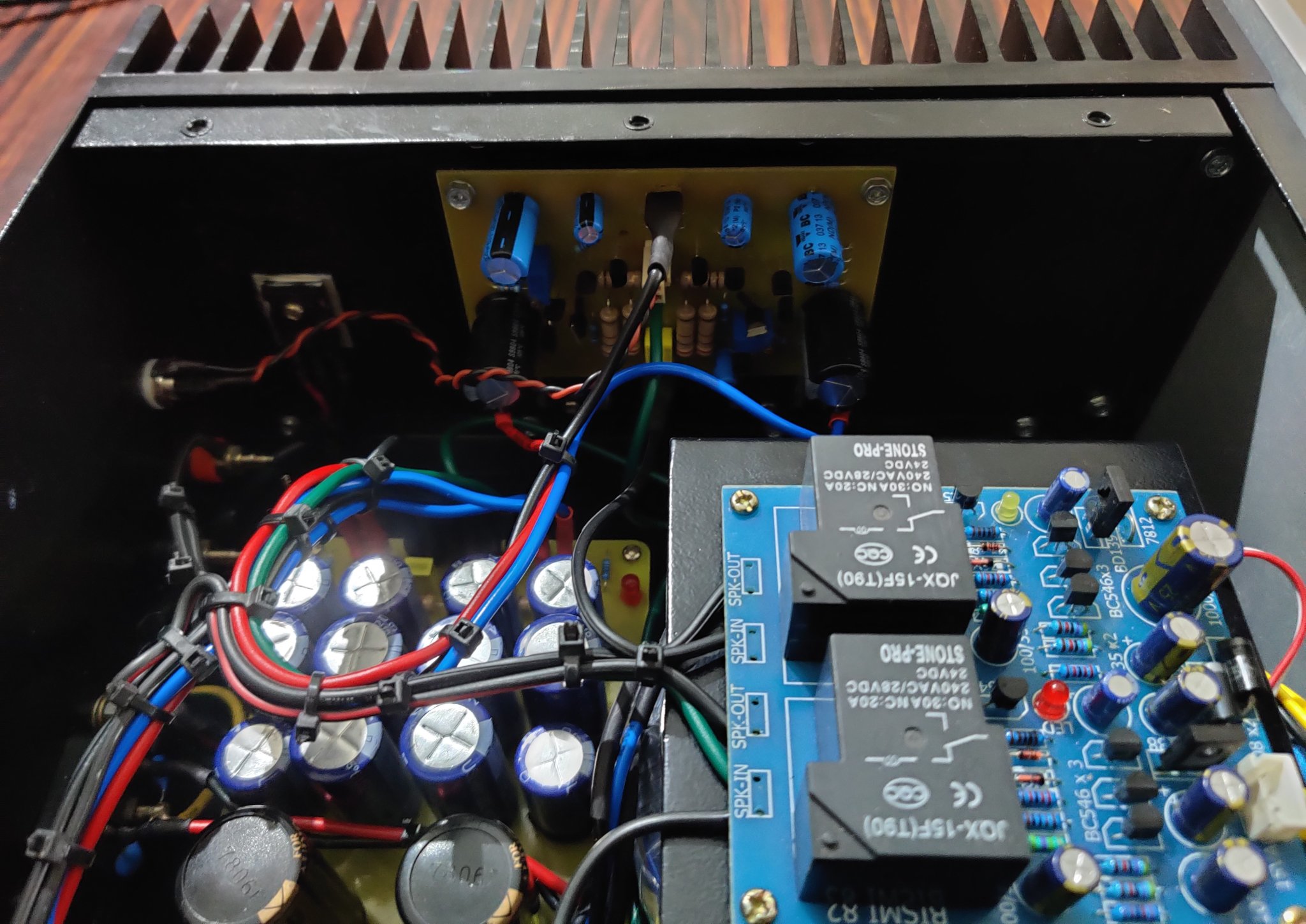

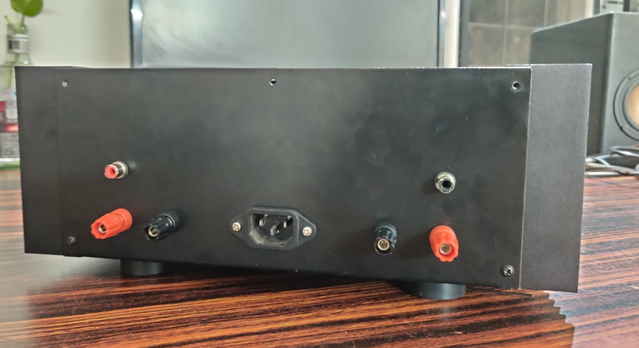

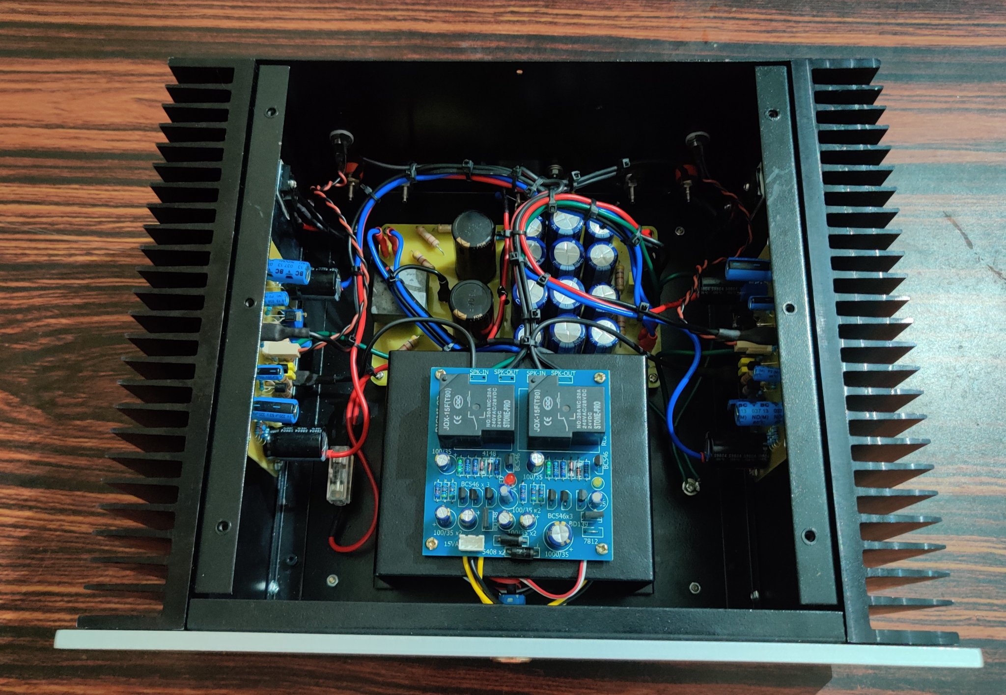

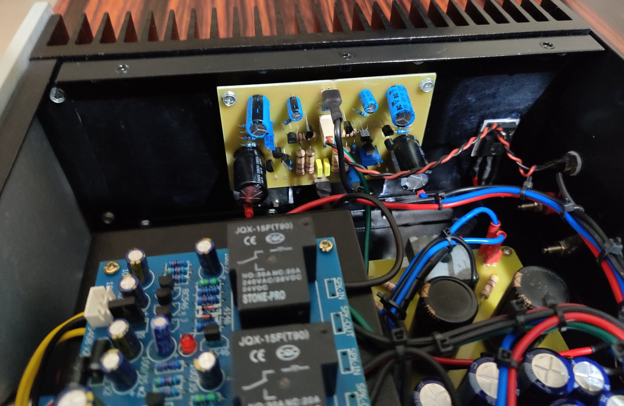

Completed the cubie3 JFET version with k246 & j103 JFETs
Sound is amazing 😱

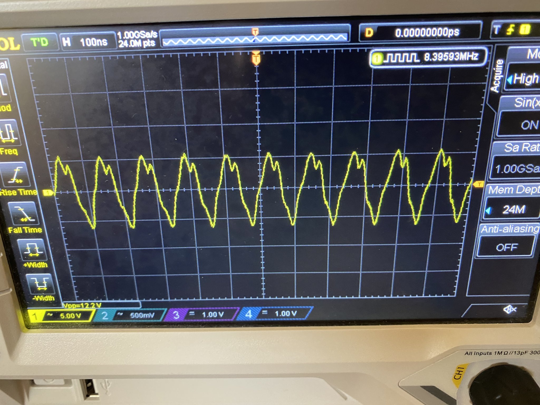

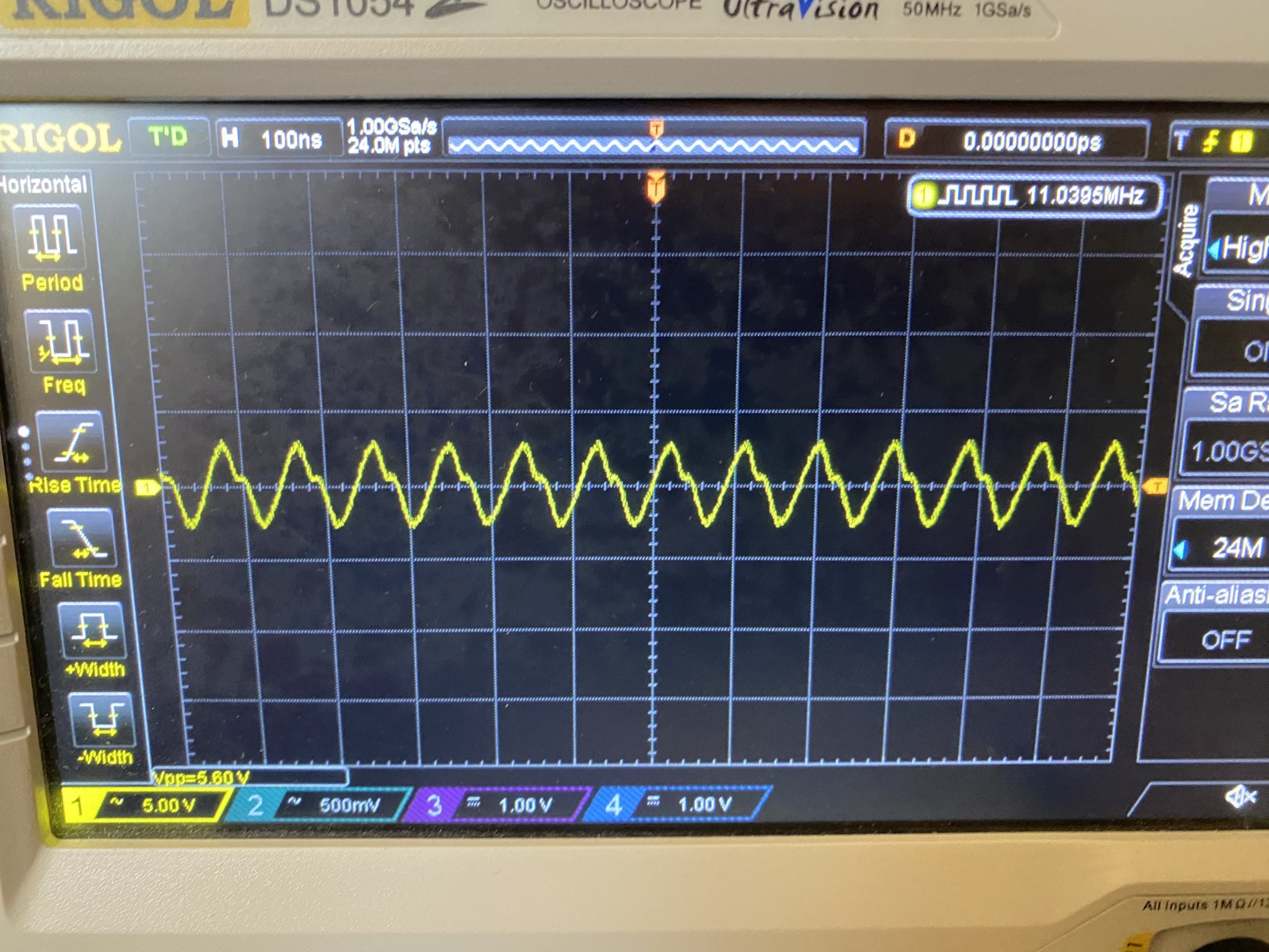

These days I finished my Cubie.
It uses 7ma jfets, j77 and k216 in the vas, 08n16v and 08p16v outputs.
I run the vas at 30ma.
When I increase the bias above 100ma the amp starts to oscillate.
If the input is not connected the oscillation is smaller
If I ac couple the input to a signal source I get this
Power comes from a 28vac dual secondary trafo
What could be the cause of this?
Seems I spoken too soon.
Yesterday I removed the gate resistors from the vas and set the bias fixed at 130ma for the each channel by replacing the pot with a fixed resistor.
Ran a couple of square waves and everything looked fine.
The front end runs at 5.5ma, the vas at 20ma and no sign of oscillation.
Today I placed back the pots to be able to set a higher bias and the oscillation appeared back.
When I increase the bias in the ops the mosfets in the vas go south and draw 50ma.
Any ideas what can I search for?
