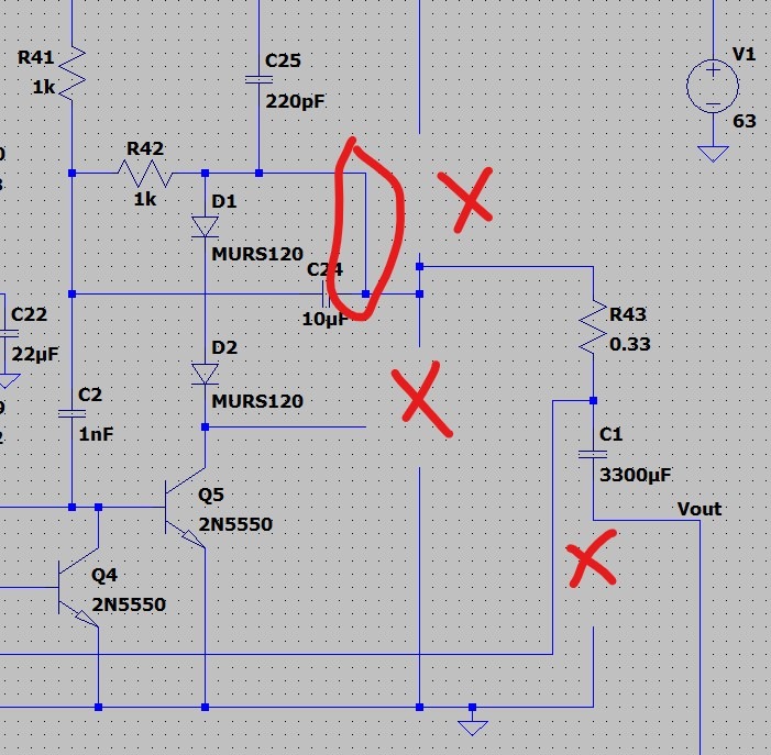

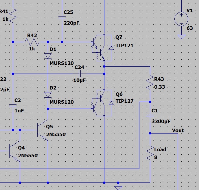

It might be worth you running the fault channel up with the outputs removed and with the base and emitter pads of either the NPN or PNP Darlington linked out. Obviously no load attached. Nothing bad should happen and I think it should all bias up and work with a reasonably correct midpoint.
You can test it with the scope 🙂 Its worth trying. Also make sure the diodes between the two bases are OK and not open circuit or intermitent. Maybe just replace them. They are not critical.

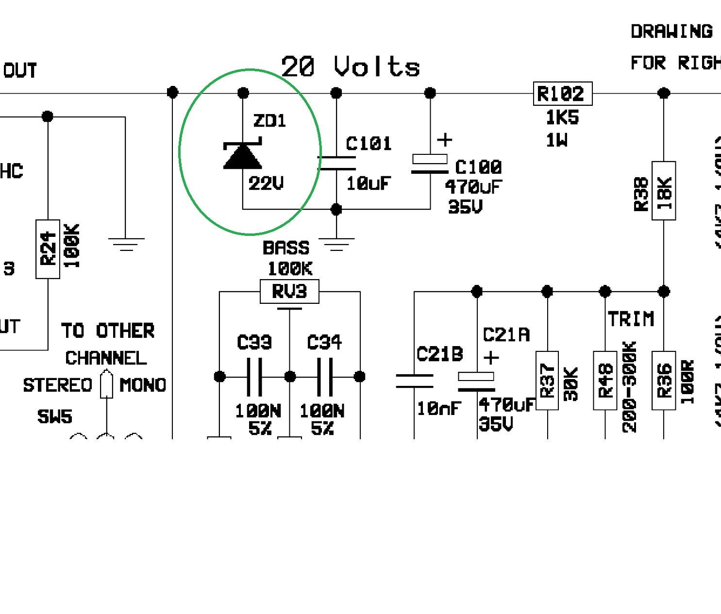

Yep one of the first things I checked forgot to mention that zener was knackered as well for some reason
Lol, what Zener would that be?
Those are just two ordinary diodes (1 amp). Its worth checking and maybe just replacing those and the two little drivers simply because anything could have happened with dodgy outputs. They could have taken a hit.

That one is just a shunt regulator for the preamp section. Any issues there should not effect the power amp at all because the audio stages are AC coupled. If its faulty (short) then the 1k5 feeding it might be stressed as it would see over 2 watts dissipation.

You need to approach it differently. Use the bulb tester and fit the fuse to one channel only and then fault find on that channel without removing the fuse. If you look at the circuit you will see there are only a couple of direct possible paths for current to flow.
So power it up and first measure the supply voltage. If its zero then you have a dead short somewhere. If its a few volts then you have a conductive path somewhere but not a short.
Favourite would be an issue with the mounting of the upper NPN output and a possible short to the heatsink. There are also two caps decoupling the rail. And that's it. There is nothing else that could conduct current. Obviously if both output transistors were short or were fitted in the wrong place (NPN for PNP etc) then that would do it.
So be logical. If you still can't find anything wrong then remove both transistors and see if the rail come up. Keep the fuse in at all times.

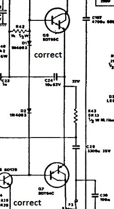

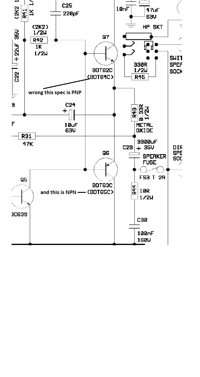

if you look at the section attatched(wrong) you will see the references are wrong for each transistor and this is what i was working to
now look at the one you provided, that im sure now is my version and you will see, although it isnt very clear, the transistors are reversed in the configuration and have the correct references on them
so i recon this is fixed
the components are reversed in the amp compared to the drawing

Well spotted 🙂 Service manuals often do have errors (unfortunately).

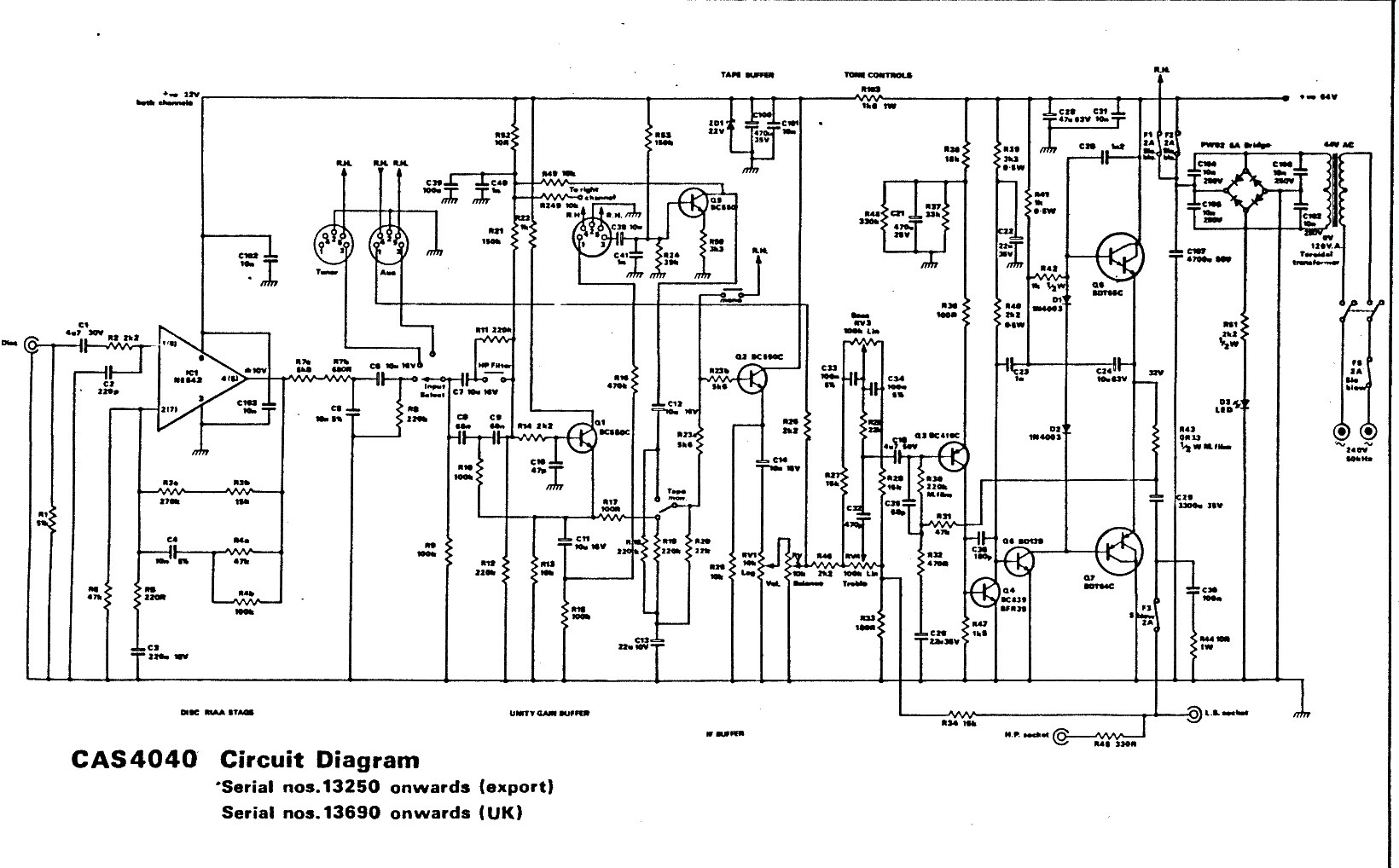

- Creek 4040
