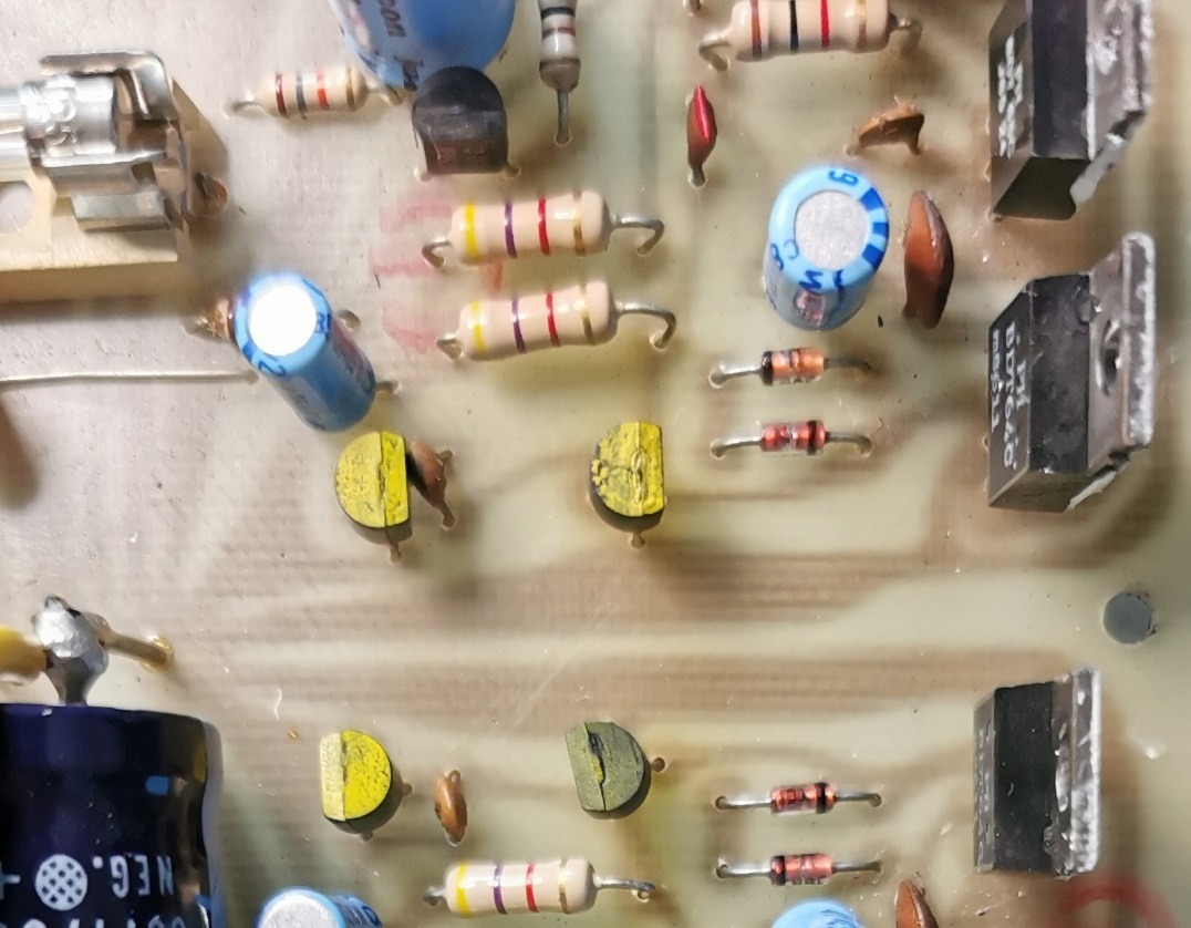

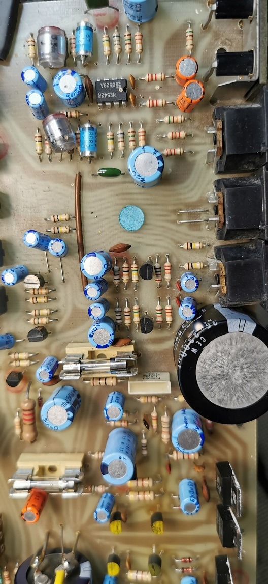

all finished.remember when i first got this what a wreck it was (pics 1 and 2) so just finished it today, given it a bit of an upgrade with the fixings and im not a master craftsman by any strech of the imagination but it looks alot better now, and also it sounds pretty good,if a little bright for my taste.

looking forward to getting it going, not sure how much its going to cost me though, all those old caps
I'm guessing the caps are axial types which are harder to get. Radials are fine if you can fit them neatly though.
For a view of the caps and what else is inside, there's an interesting retrospective review and internal pics of the similar Leak 30 plus here: https://www.hifinews.com/content/leak-stereo-30-plus-amplifier-page-2. I don't know why it starts at page 2 and it seems crazy to publish a review of a 50+ year old product in a news magazine but I guess that's a reflection of just how uninspiring and disconnected from the user, today's consumer audio products have become. It seems most, if not all the axial lead types would be quite easy to replace with radial lead caps. too. If actually fitted in the Leak 30, the large, upright clamp mounted cans might prove hard to match though.

so given the age, would you replace all the caps? regardless?I'm guessing the caps are axial types which are harder to get. Radials are fine if you can fit them neatly though.
I think I would yes.
Although I'm not always a fan of replacing all caps on sight I think in this case it makes sense. There is old and there is old... and this one is old. It may be that the smaller caps are the ones to have deteriorated the most but in any case a good percentage would need testing to determine if there was general deterioration. Its not just the value that changes, its the e.s.r. and 'goodness' of the cap that deteriorates. Its a bit like taking a twenty year old PP3 battery and finding it still reads 9v. It may well but just trying pulling any current from it. It would be like a 9v battery with a high value series resistor... useless. Similar happens with some caps.
