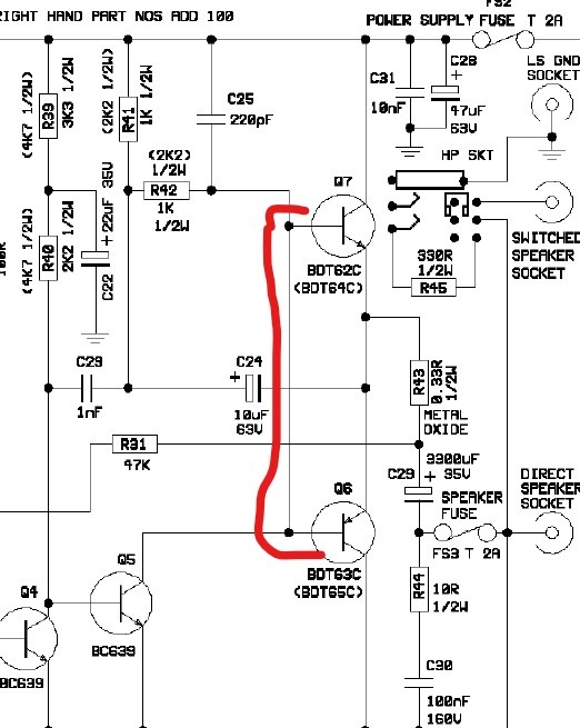

If the circuit really is as shown in the diagram and the base of the two outputs are connected together as here:
Then it is not possible for the outputs to conduct and pass current in themselves. In other words they run at zero bias all the time no matter what voltage you have on the base.
So you must check that without disturbing anything. With the amp ON there should be ZERO volts between the two base leads. With the amp OFF there should be zero ohms between the two base leads.
Be careful measuring with it on. We must prove this point before going further.

If the base's are joined no current can flow.
If they are not joined then whatever is in the middle is effectively a bias generator which generates a volt drop and which in turn allows the Darlingtons to conduct. So if not joined we need to know exactly what is there.
You also should be able to link the bases's together as a quick test. It should draw no current.

so i did as suggested
no continuity between the bases power off
linked the 2 bases out as suggested and something burned out in the middle of the amp, i heard it fizzle, so now i have to find out what that is before i go any further..

So the first thing you have to do is physically look why there is no continuity. The circuit shows there is. (I think I have seen versions with a diode or two between the base's so you need to check and draw what you have)so i did as suggested
That obviously should not happen. Even if there is a different version with a bias generator between the base's it should still be safe to link them.linked the 2 bases out as suggested and something burned out in the middle of the amp, i heard it fizzle, so now i have to find out what that is before i go any further..
We need to see a correct circuit diagram for what is there between the base's.

100%-def no continuity between the base's to the good channel output transistorsSo the first thing you have to do is physically look why there is no continuity. The circuit shows there is. (I think I have seen versions with a diode or two between the base's so you need to check and draw what you have)

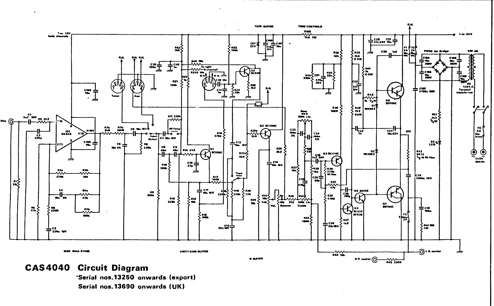

ive just traced it out and this looks about rightI think you have this version. Two diodes as a bias generator but these should be safe to link out.
It should be 100% OK with those diodes shorted (base's joined). Think the theory through. The output which is taken from the emitters does not go to anything that can draw significant current. The emitter voltage follows the base less the B-E drop. The base can safely be any voltage between 0 volts and supply. No current can flow if those base's are linked because the two transistors can not both turn on together.
Do a basic check with the amp off to see if you can read a short across the supply rail on that amp. So that is measuring from the collector of the upper NPN Darlington to ground. Do the measurement with the rail fuse removed so you do not get confusing results from the PSU.

so the difference is then there is no diode between b/c and would read as a dead short?, well thats how the diagram reads to meThat's not correct. Meter on 'Diode' and for the NPN Darlington and with the red lead on C and black on E it should read open. Reverse the leads and it will read. Red lead on base and black on emitter will read as will Red on base and black on collector.
The PNP should be opposite polarity wise.
- Creek 4040
