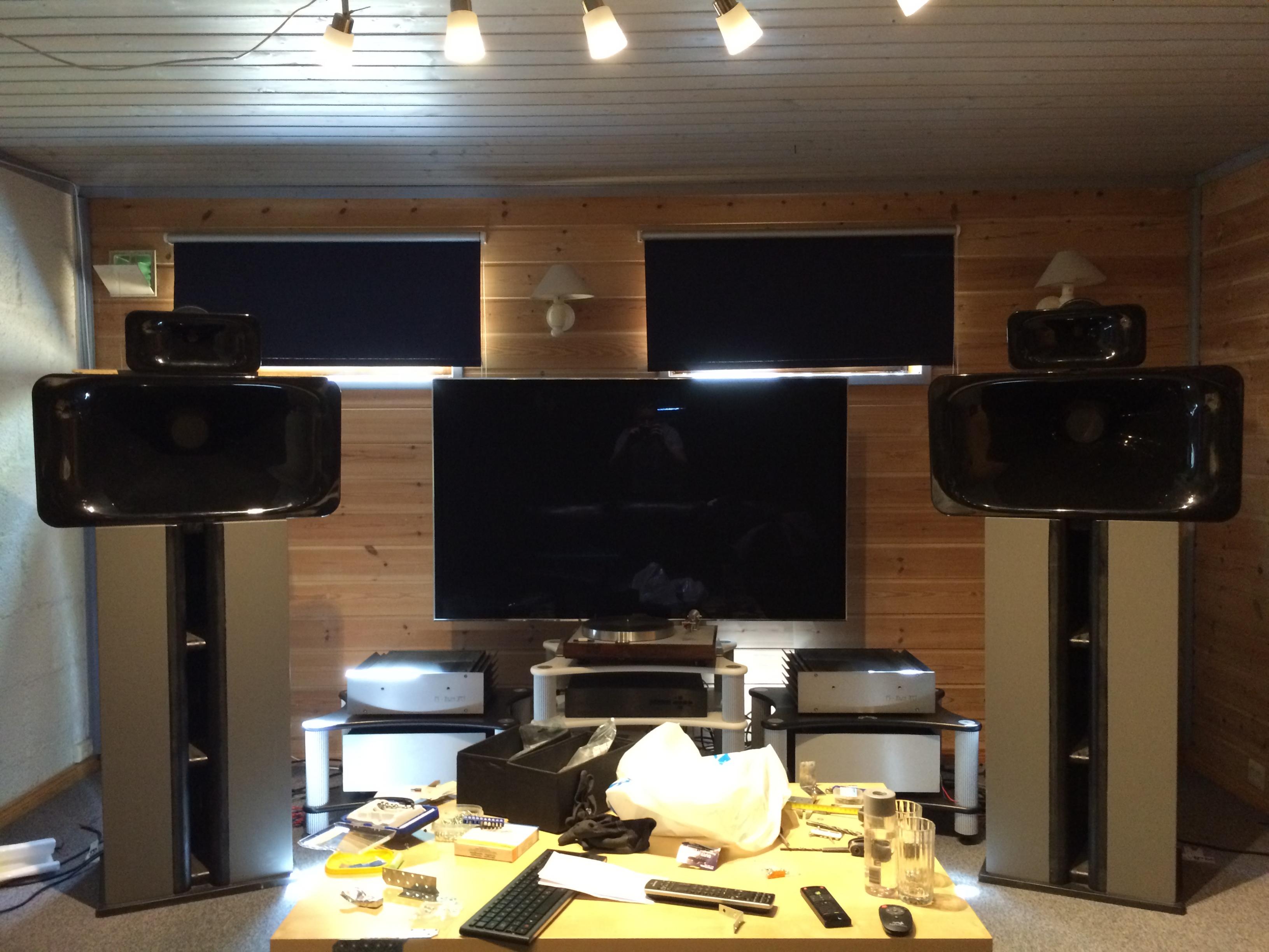

I have the closed back chamber JBL 2169H (CMCD-82H) with the original JBL phase plug in a big Seos horn with 4" exit myself and it's the best midrange I have ever heard. Crossed over at 250Hz and 2200Hz.
I would not use a cone driver without closed rear chamber and phase plug in a horn. The FR would be very limited upwards, I would probably need to cross over closer to 1000Hz. There is not without reason JBL mounted both a back chamber and phase plug on the 165H driver in the CMCD-61H concept. http://www.jblproservice.com/pdf/AE Series/AM4200,95-WH.pdf

SEOS 24-4 ? OR larger ?? Looks like 30 inch unit
Thought I would like to try a 6.5" unit to extend the response to 3000Hz. The PHL Audio 1500Nd-SQ looks VERY interesting: PHL Audio: Products ?*6.5 inch in
hello Jorg,
What is the exact SEOS model ? It appears to be much larger than 24 inches wide. Thanks !

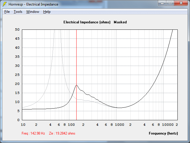

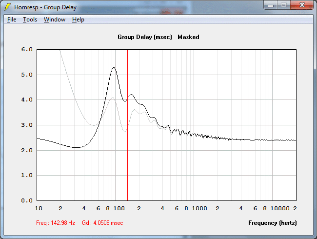

If he's building a hypex mid horn the back chamber can annul the throat reactance, tractrix, expo, or others is a no or crap shoot. Have you used the JBL CMCD? In what horn? What bandwith? They are pretty expensive at retail, I'm certain i could make a cone driver like the little 5" Faital out perform the CMCD 81, it actually is quite close with the edge going to the Faital in the top end with no phase plug or back chamber in a couple of my 4" horns.
A good seal is critical, and so I assume is not using soft fillers/cabinet resonances. This (hornresp) is how Jean-Michel suggests to do it, GD shown for interest as it seems to contribute to the 300+ crossover in this example. Romy suggests cabinet strength is the key.

hello Jorg,
The horn is Seos 24-4 and can be found on Auto-Tech's web site: horn-diy.pl
Tractrix horns cannot be annulled completely they are too short. I suppose the big mouth lip Lecleach are too short (depends on T - hypex will for sure) but never checked - not interested except maybe for treble. I use back chambers even if they don't let you tune to the flare/mouth because I don't like the back wave. These short horns don't load (turn on!) to the flare frequency that's why - too short - back chamber is sorta a waste
