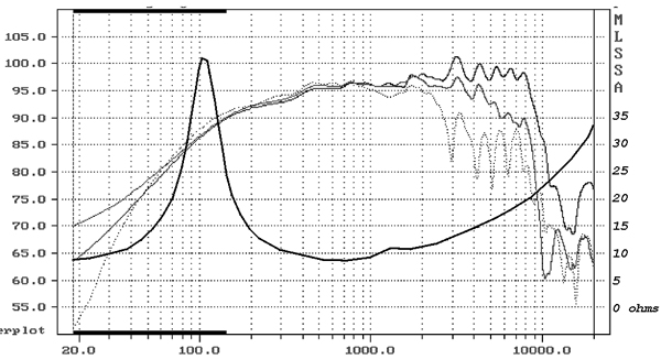

If I did not already have the drivers I do (PR 170zo), I would seriously consider these (listed below). At first glance it seems the response is tilted, BUT, that is exactly what we want for horn loading. A proper horn will "lift" the lower range of the response, AND with a larger throat, will decrease the load as the frequency inclines, thus smoothing the response. I would also be VERY tempted to run this mid range up much higher than 2.0 or 2.5K. The reason being, to insure MOST of the fundamentals AND associated harmonics emanate from as close to a point source as possible. Realizing it can be considered counter-intuitive, but as the crossover frequency increases, it's effects and localization actually diminishes and becomes less of a distraction.
High efficiency 6" cone midrange, ideally suited for three and
four way systems. Very smooth response from 400 Hz to 8 kHz.
An aluminum phase plug increases axial sensitivity and
controls high frequency dispersion.
p.s. If pattern flip is of a concern, then simply opt for the square mouth version of the Edgar- Tractrix
(but personally, I would choose the rectangular aspect ratio)
http://www.parts-express.com/pedocs/specs/294-650-bc-speakers-6pev13-specifications-44875.pdf

The B&C has a phase plug (bullet)
The PR 170zo has a phase plug bullet
The PR 170mo does not, and exhibits ragged response near the top of it's range. The best sounding cone driver type mid range units I have heard all
possessed phase plugs, either flat faced, or bullets.
I would cross to the TPL at somewhere between 5 & 6 kHz.

Hi Eldam,
Audax says 500-8K, but personally I would not be comfortable above 2k, and I really don't like 2 K crossover points. I prefer sealed for mid range, but at least one enthusiast has used the MO version in PAIRS per side, open baffle, claiming excellent results.
QUOTE from the spec page:
The PR170MO was specifically designed for high quality professional sound reinforcement systems. Its efficiency and power handling capacity are exceptional for a direct radiation transducer in its category. The flat foam suspension is coated with a cisco-elastic compund in order to minimize the standing waves and cone break up. It is ideally suited to cover the frequency range from 500Hz to 8kHz. This driver is recognized worldwide as the reference in prestigious professional applications.
You can try the PR170M0 in around 0.2 cubic foot sealed (F3 of 190Hz).
