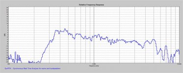

I only have the 12 ohm Faital, the phase plug in the B&C is small and probably doesn't do much in a horn and the Audax MO I'm tlking about has no phase plug. The 18 Sound driver in the graph might be good in a horn. I'll see if I can measure the Audax MO, Faital and B&C this weekend for comparison. If I do it will be in the big 180 flare Sierra Brooks tractrix horns throat set at 4"
Frequency response looks good, although the 12 Ohm displays a dip around 2kHz and from that point of view the 8Ohm looks better.
Also of note is neither this one nor the LE5 have phase plugs, vs the 6PEV and the PR170zo that do.
Do you happen to have measurements of the Faital Pro in a horn?

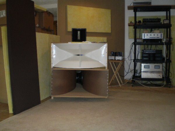

white whales ?
Bi-radial horns can be made to have constant directivity, Tractrix have a progressively narrowing pattern at higher frequencies.
Ah ! So, the EV HR-9040's I have must be bi-radial.
Thank you so much, this is good to know :)
Scott,
The EV HR-9040 has a hyperbolic-exponential throat connected to a conical main section, not technically a bi-radial, but does have constant horizontal directivity from 315 Hz to 16kHz. They have the classic Keele secondary expansion, which gets the low end response a bit closer to the "sacred" exponential radial horns the HR series broke away from, and prevents the midrange "waistbanding" a single section conical horn exhibits.
Keele's later JBL horns were dubbed bi-radial, no conic (straight sided) portions were used in those horns, and the expansion did not have the secondary "break" associated with his earlier Altec and EV designs. The bi-radial designs have more low end response for their size compared to the conical expansion.

Ah the size !
Btw, nice compact system Scott L ! I'm really looking Something compact like it looks on your photograph if your system...)
(Is it Rock wool panels here nad there in your room ? (just in case it is and not proof: to be avoid for health disease at long term or if children at home, lungs don't like it)

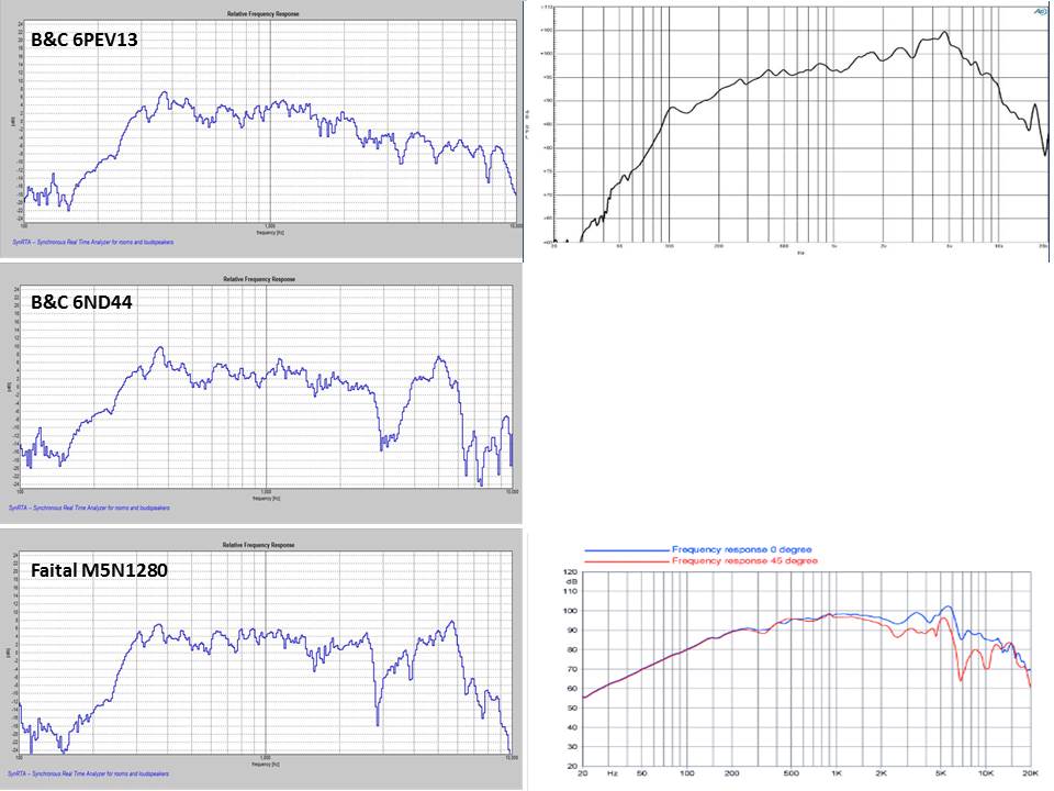

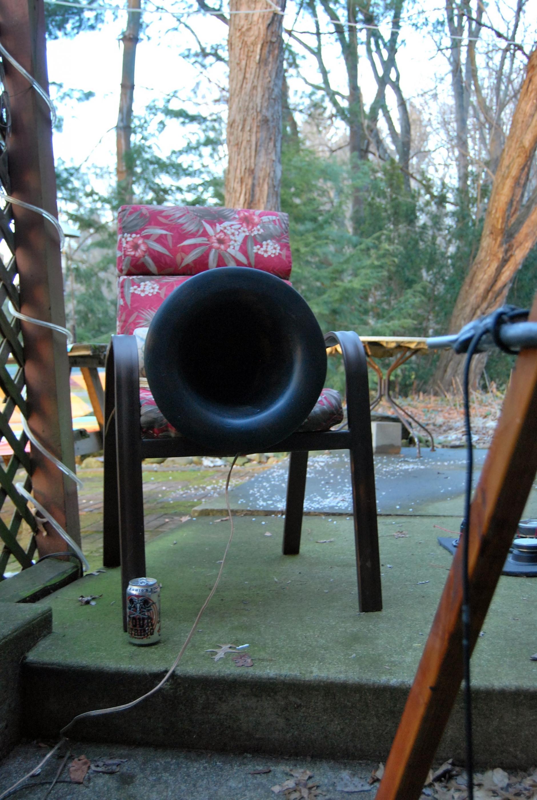

If you happen to get to measure these, which I sure hope you do :D, please also post pictures of the driver and horn used.
I was under the impression the Faital M5N12 had a closed carcass behind the cone, much like the JBL CMCDs, but found a picture that seems said carcass doesn't close behind the cone - only around the magnet. So the Faital needs an enclosure?

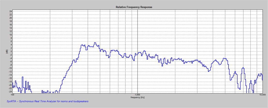

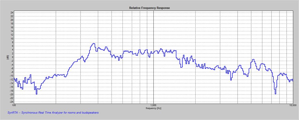

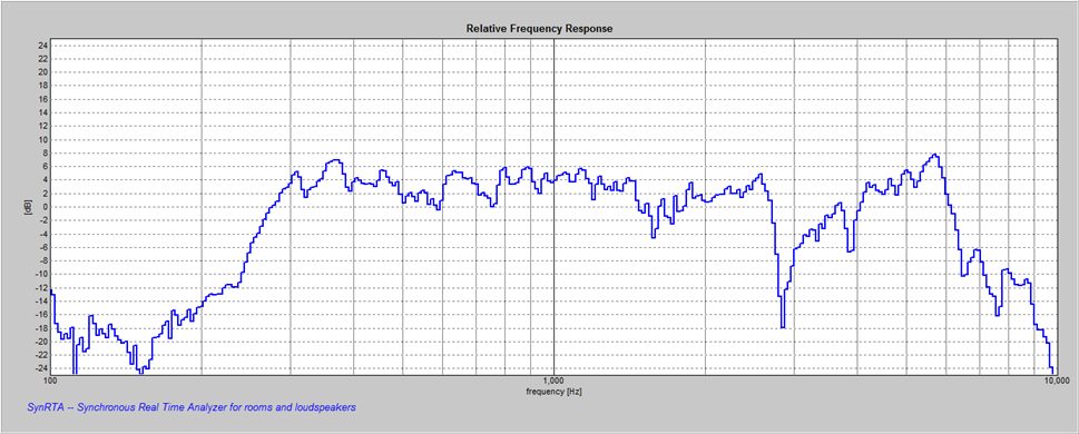

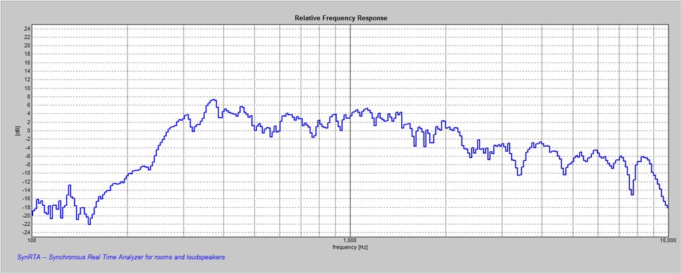

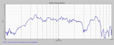

All open back about 4 feet 50 db scale 1/48 smoothing pink noise - none of these are true "midrange" to me because my definition is 160 to 1300 Hz, so upper midrange. Guess which one sounds best LOL
Audaz PR170MO
B&C 6PEV13
B&C 6nd44
Faital M5N1280
Cheap ebay 4" closed back

BIG THANK YOU for doing this!!!
Very interesting. I'm still processing. Hopefully you guys can help me with the takeaways.
You note all measurements were taken with drivers mounted with open back. Is this the best way to implement a cone+horn, or just because it was the only way to make comparable measurements? Naturally you didn't have a an enclosure for each driver.
The horn you used has conical shape? And the drop below 300Hz seen on all drivers is a factor from the horn, right?
Keeping in mind my intended range will be somewhere within 350/500 to 2000/2500Hz, with very steep digital xo:
  • They all seem suitable, but there are differences.
  • The cheap eBay 4" might be the best for the money, but I'll drop it.
  • The Audax seems the least able, but it is the MO version and not the ZO Scott mentioned.
  • I couldn't find references online to B&C 6ND44. From the picture it seems a B&C driver, but couldn't find it on their website. Thaought maybe it was an 18Sound 6NDA, but they don't show a 6NDA44.
  • The 6PEV13 and M5N12-80 both look good on the graph. My reading:
    • M5N12 is smoother in the 300-2000Hz range, with a dip in the 1500-1800Hz range. The sharp drop around 2600Hz correlates with the manufacturer's chart, I think. Shouldn't be a big deal for me if crossed at 2000Hz, right?
    • 6PEV13 would be advantageous if I wanted to cross over higher than 2500 Hz. Right?
And you like the sound of the M5N12-80 better than the rest, right?
I must admit the minimum impedance of the M5N12 at 8.8 ohm is appealing for use with a SET, vs 6 ohm for the 6PEV13.

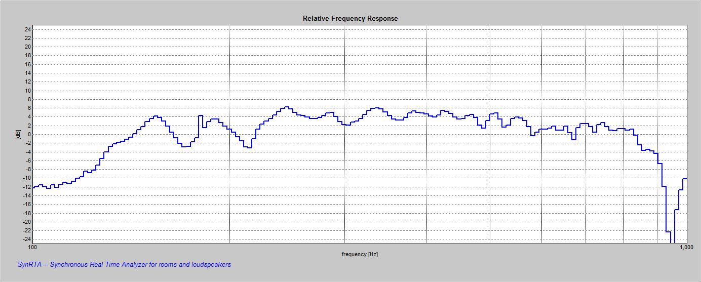

This the 8" B&C at 5 feet in room crossovers in place. 120 and 800. You need to be back double that or 10' and then the low mid snaps into full bloom :) 1/48 smoothing pink noise - they will go to around 1.2k
Is this the 8PE21? In a horn?
meaning given the xo you are applying? I thought these were good up higher. If 1.2kHz is as far as they can play with goood sound then I should drop them. 1.2k is too low a xo for my needs.
The Faital is more lively and is first choice provided the upper range can be attenuated in the crossover. The 6pev13 is the easiest to get the most of using first order networks. Nice upper midrange tone but not as realistic or alive as the Faital. The cheap 4" can sound great with the right high pass.. all the way out to the upper treble. lol
