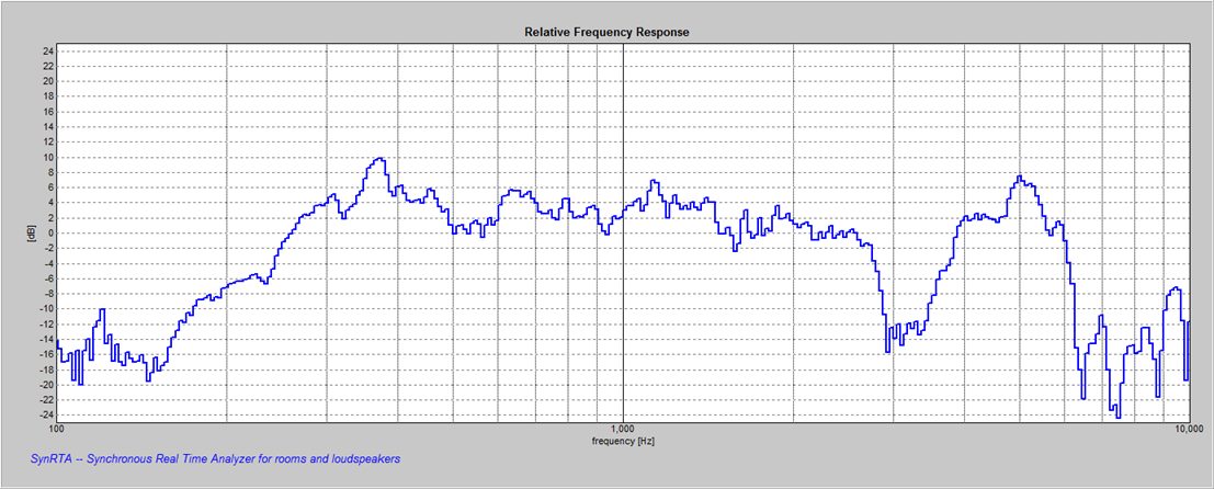

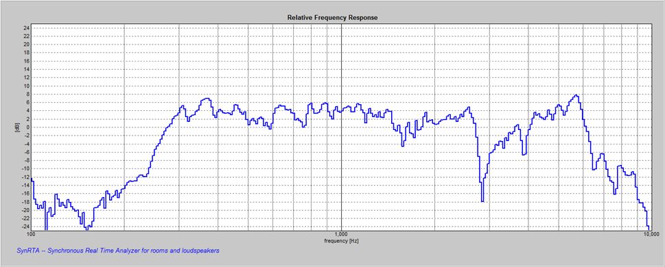

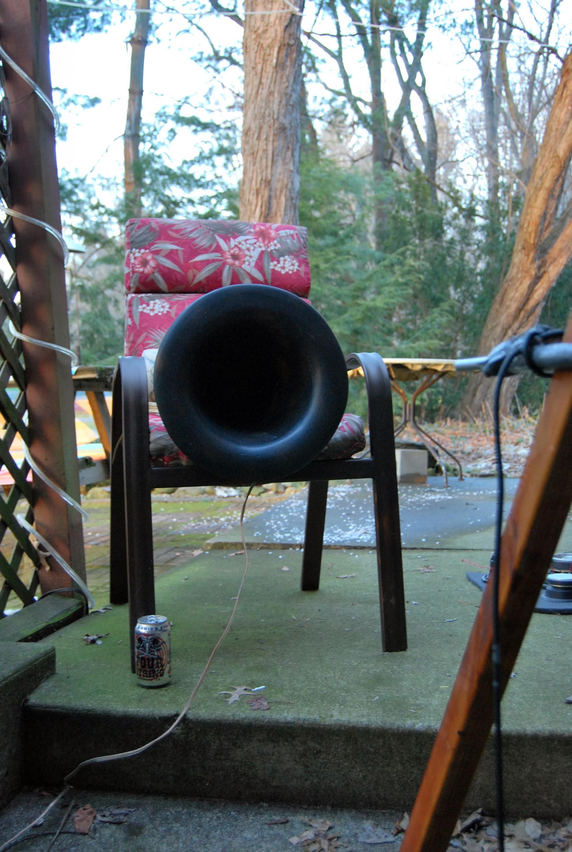

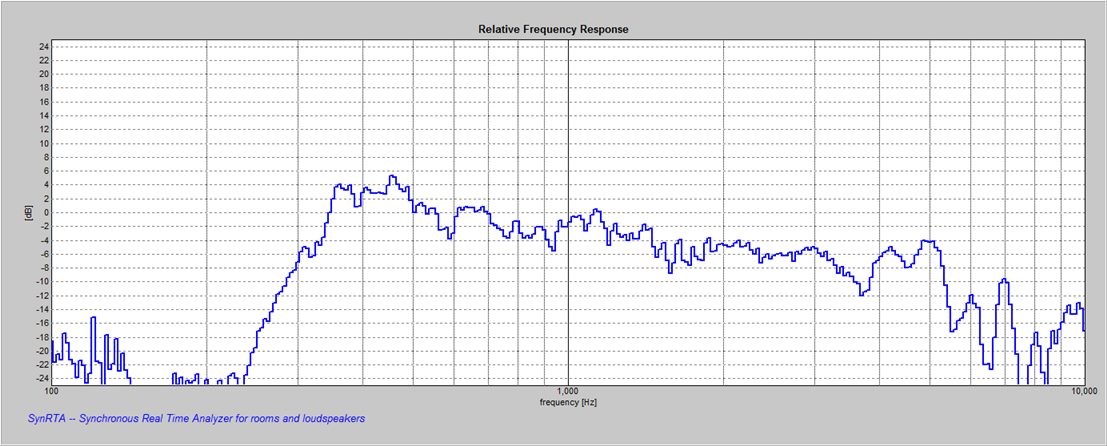

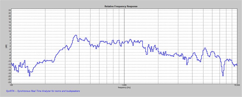

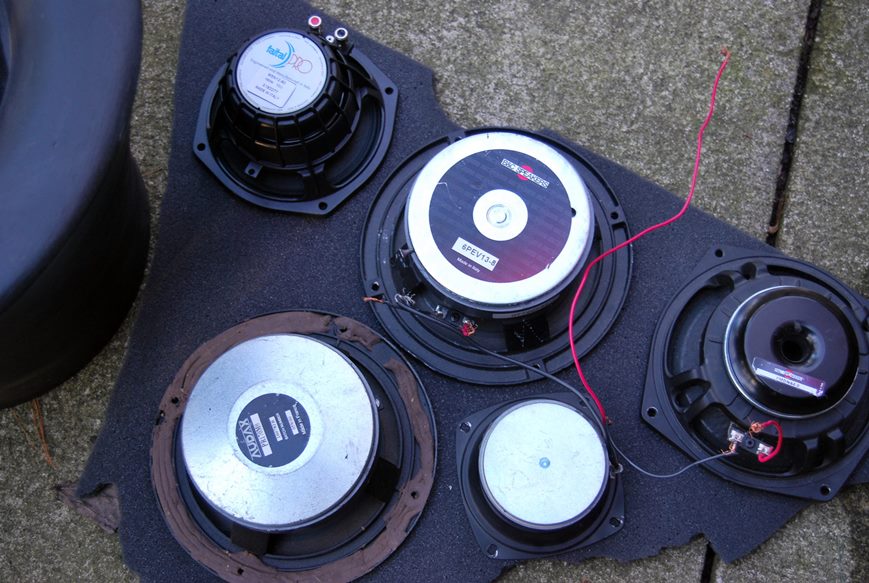

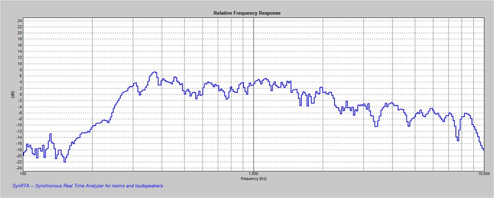

All open back about 4 feet 50 db scale 1/48 smoothing pink noise - none of these are true "midrange" to me because my definition is 160 to 1300 Hz, so upper midrange. Guess which one sounds best LOL
Audaz PR170MO
B&C 6PEV13
B&C 6nd44
Faital M5N1280
Cheap ebay 4" closed back

Some takeaways and questions from the [4] Small paper:
- It's not clear to me if his ultimate aim is for high-fidelity systems. He talks about the efficiency and power capacity tradeoff.
- It shows how critical the driver is in a cone driver + horn system. For whatever reason I was assuming the driver was critical, so good to have that confirmed.
- There is a tradeoff between hi frequency bandwidth and efficiency. This looks like a more critical factor for PA that for a 4-way hi-fi like I'm designing.
- The driver limits the horn system performance through EBP = fs/Qes
- If hi performance is required, the driver should provide high EBP values. He notes good drivers for sealed boxes should have EBP around 50Hz, and for vented boxes EBP of around 100Hz. For horns EBP should be higher.
- EBPs of all drivers in the short list from this thread have EBP above 300Hz, so they are all good from that point of view. All equally good? Dunno.
[*]Beyma 605Nd fs: 150, Qes: 0.32 => EBP=469Hz
[*]Faital Pro M5N12-80 fs: 180, Qes: 0.54 => EBP=333Hz- Faital Pro M5N8-80 fs: 180, Qes: 0.59 => EBP=305Hz
- B&C 6 PEV 13 fs: 126, Qes: 0.39 => EBP=323Hz
All these drivers seem suitable from this point of view, and the Beyma looks ahead of the pack.
