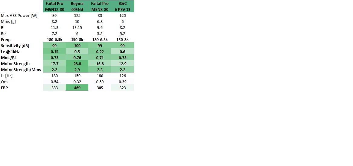

Please see the attached image. EBP correlates with motor strength (defined as Bl^2/Re) and motor strength/Mms.The more beef, the better.
Higher up, gossamer is good
The four drivers display significant motor strength. More beef, checked.
The four drivers have light cones (Mms). Gossamer, checked.
The Beyma has the heaviest cone of the 4, but a very strong motor, leading to the highest motor strength/Mms. But I have no references as to its actual performance in a horn...
Is this also valid if the range starts at 500Hz? Or were you referring to drivers reaching lower?A good bottom end performance is the key to the kingdom. A strong driver motor and sufficient volume displacement are most important here.
N.B., EBP for this driver is 416 Hz. The more 'beef' the better.
