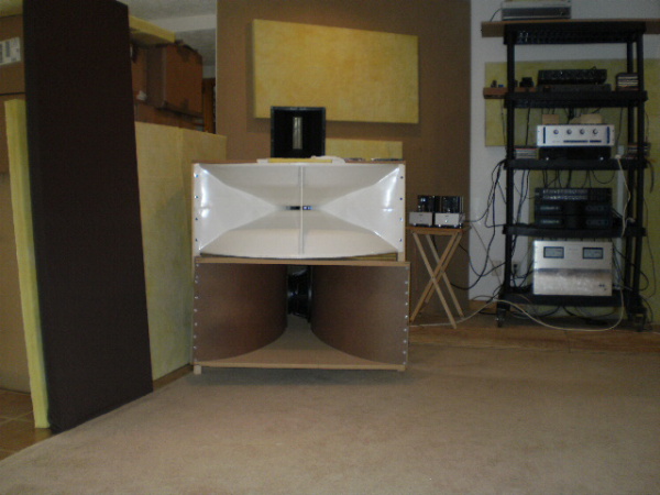

Maybe it will do that but the 170MO is good 400-1200 in a 180hz tractrix horn. What you don't want to do is "push" a driver down in a horn. YMMV
I used SABA greencone also. Great little drivers, but... not as good as compression drivers. The Avantgarde Duo sounds great, if that is what you are trying to make. But many don't like the 350Hz crossover point. I was comparing it to the ATC SCM100 and the ATC won in the midrange. Not at treble, although in retrospect, none of them has a very good tweeter. However, the DUO was very fun to listen to.
Just one in a series of MANY missions (cone mid v1.0)
Yes, Gentlemen, I agree it's a bit of a "push". I have been wanting to use these drivers for a very long time now. I even had plans to mate them with a "helper"

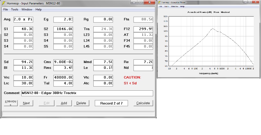

OK, I'm going to expose my inabilities.... Attached is a...well...attempt to simulate the M5N12 in the Edgar Midrange Tractrix. Obviously something's very wrong. But what is it?
BTW, the huge rear chamber was an attempt to simulate no chamber. It might need to be larger.
Help!

I suppose the throat chamber looks larger than it needs to be, you could set it to zero?Obviously something's very wrong. But what is it?
edit: I would also either mask rear chamber resonances, or just set Lrc to some small value.

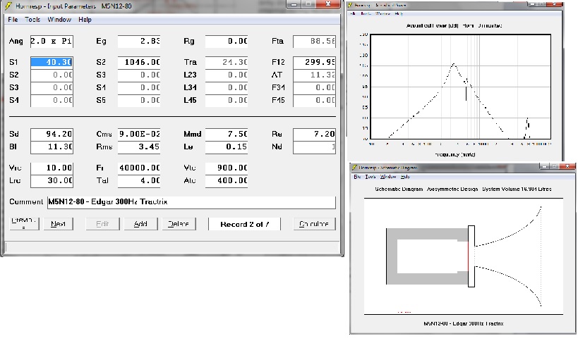

Thank you!
The simulation below is the same as original, except Vtc=Atc=0, and rear chamber resonances were suppressed when processing.
Looks better. But not good yet. What next?
