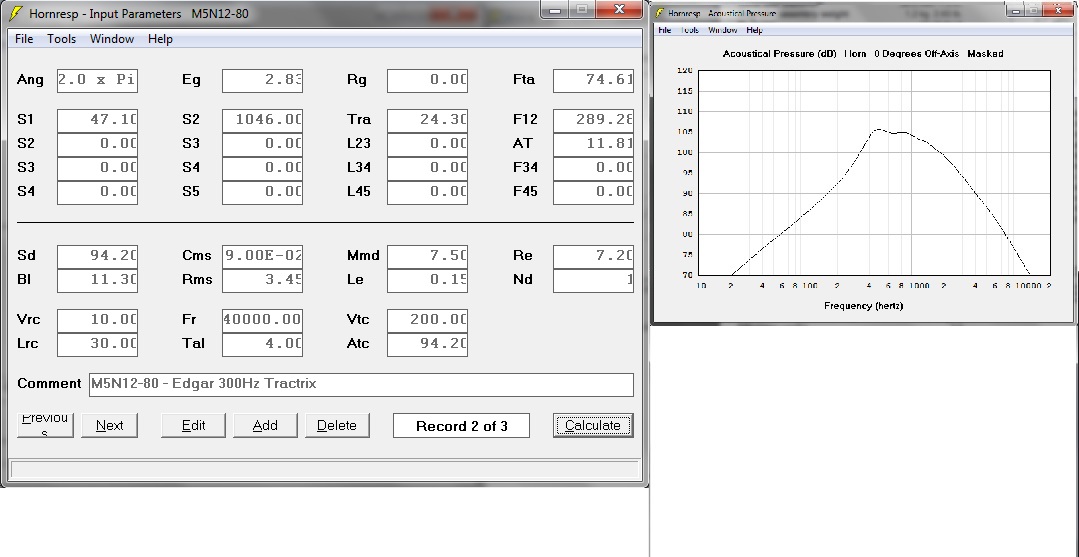

SPL is found under Tools>Directivity>
Attached is the same simulation, with plots for Tools>Directivity>0 degree off axis response. That looks good to me. What do you think?
Considering the "Warning S1<Sd". I guess S1 should be same or larger than Sd. Any best practice to consider?

A 2/1 compression ratio (Sd/S1) is fairly conservative. Higher compression ratios increase efficiency, but put more pressure on the cone which can lead to higher distortion and even cone buckling at high drive levels if taken too far. A lower compression ratio will give a bit wider dispersion, you can "see" the cone further off axis.Attached is the same simulation, with plots for Tools>Directivity>0 degree off axis response. That looks good to me. What do you think?
Nothing wrong with S1 smaller than Sd, but Vtc (volume of throat chamber) should be estimated for an accurate simulation. Hornresp assumes a flat piston, while speakers are generally cone shaped, the volume of the cone when S1 is smaller than Sd should be included as Vtc, plus any spacer depth required to eliminate the cone surround hitting the baffle.
Hornresp has a cone volume estimator, the Vtc would be at minimum the volume of the depth of the cone if S1 is smaller than Sd.

Attached is an updated simulation with a 2:1 Sd:S1 (changed S1 to 47.2).
Using the volume estimator, but not having the driver with me to take measurements, I estimated dimensions and came up with a 200cm3 Vtc. So I want to strive for a Vtc as low as possible.
Estimating Atc brought me to a confusion about the definition of Sd. I believe Sd is the cone area plus dust cap area. Like if we cut the cone out of the driver, lay it flat on a table and measure that surface. So Sd has to be larger than Atc. But when I estimate Atc (as the size of the throat = size of the cone, perpendicular to the driver axis) I get larger figure for Atc than Sd...Could you please explain?
BTW, I also estimated Atc for another driver and also came up higher than Sd. Must be a misunderstanding on my part.
Increasing Vtc and Atc (larger than 0) worsened the simulated frequency response. Maybe I should compensate by increasing the Sd:S1 ratio to 3:1?
