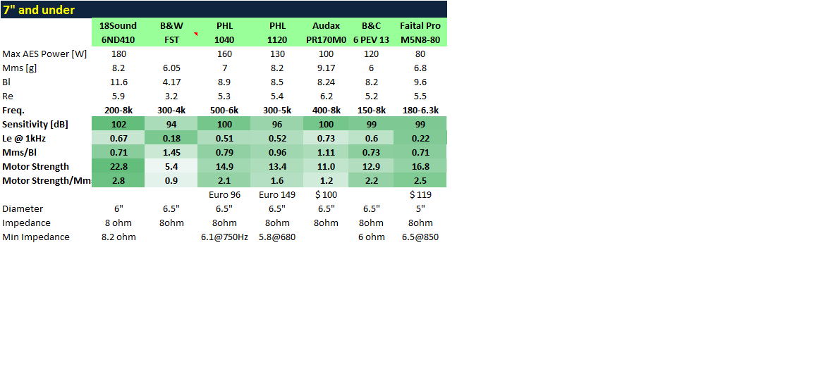

FWIW, below is a table with the better looking 5-6.5" drivers. I have a similar one for 8". The darker the shading the better.
