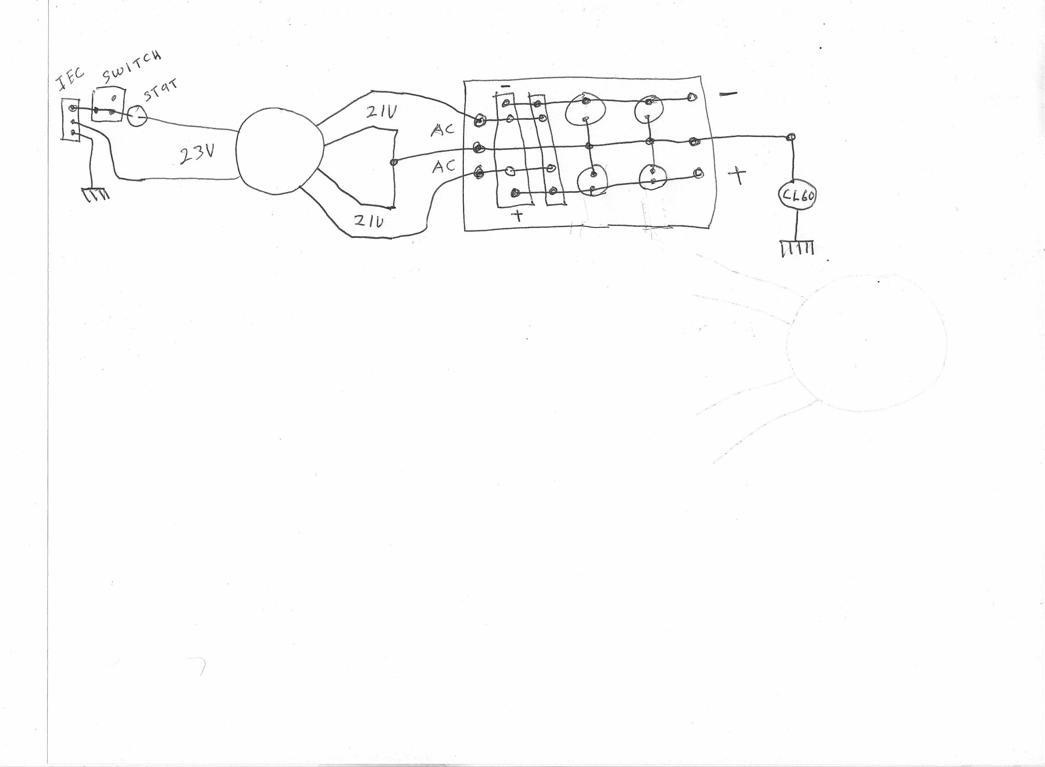

Complete Novice Needs Help
Trying to attach a sketch.
Scribbled 23v instead of 230v.

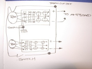

Ok , Bill ,
this is what I have done . I have 1 thermistor between everything and the chassis ground.
I will order the correct CL 60 in the morning .
From your sketch the thermistor is on the DC ground - correct ? and there is 1 on each
channel ?
Should I remove the thermistor I have already ?
I have my windings as per this drawing ? I should wire them as you have drawn. One end of my secondary to the + and the other end to the - ..... I have wired 1 SEC to the + and the other SEC to the - ...
I hope your eyes are rolling back in your head and theres a smile on your face LOL
thanks for your patience and kindness
Rich
PS, the bottom transfo should be drawn into the circuit - It is 3am here 🙂

Thanks Andrew
I followed Bills drawing - everything measures good up to the AC side of the PSU @ 23 v AC with a .1 difference between transfo output .
The DC side measures 62 with a .2 difference between channels ... this measurement is taken across + and -
The led lights up ,but have disconnected the amp boards till I check the DC value .
Any ideas .... I did find a short in the pcb at the weekend ,but have managed to get it sorted out ... I WILL NOT BUY CHINESE BOARDS AGAIN 🙂
Rich

Sorry, I just got my internet service back an hour ago. We were down since last night.

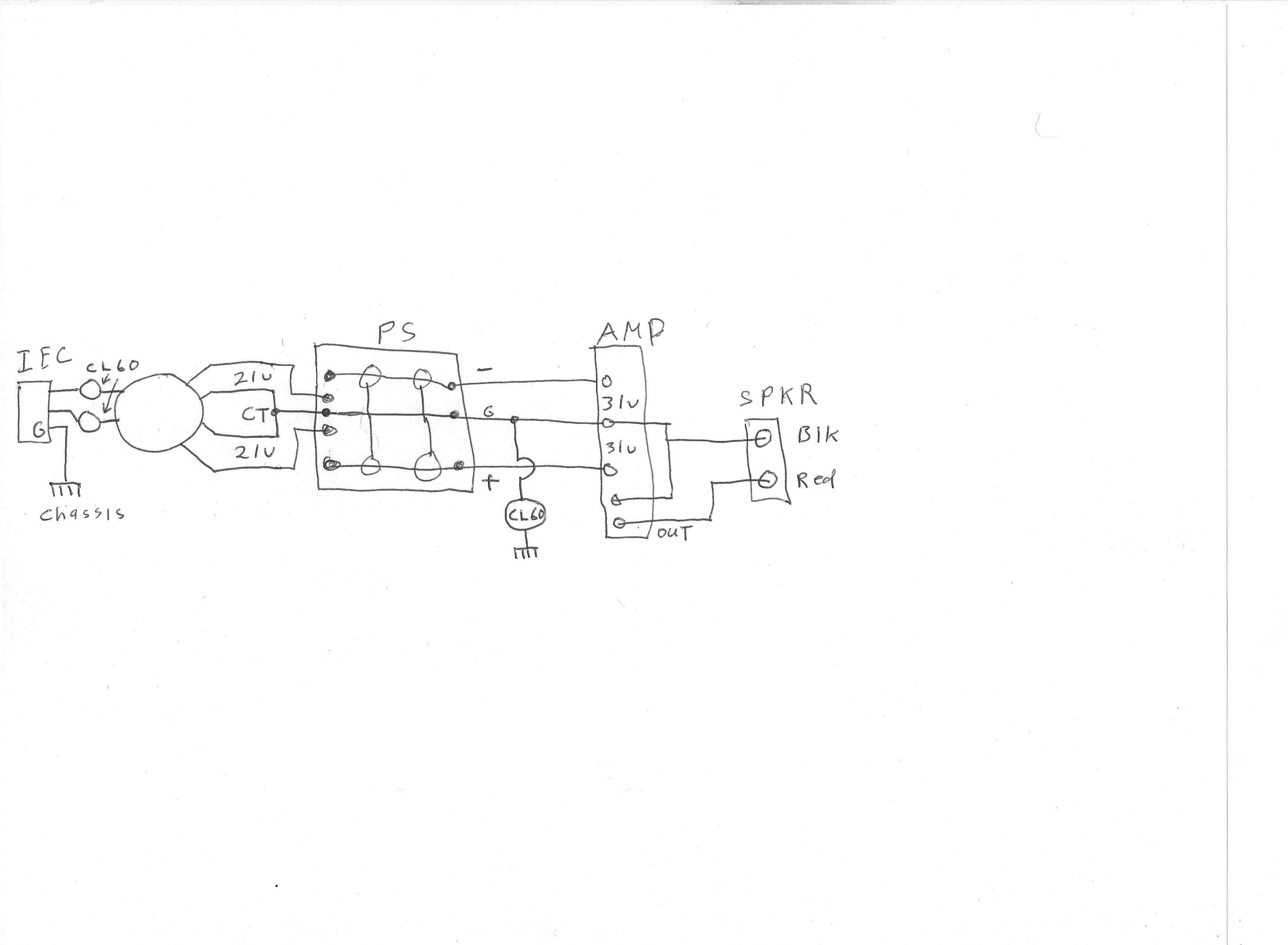

The chassis should be directly connected to the IEC ground lug for safety, and a CL60 from the PS grounds to the chassis or ground lug. 2 more CL60s could be used in series with the feed to the 2 trafo primaries, 1 on each leg from the IEC connector.
Your DC voltages should be 31v to ground from each side, naturally + and -.
Sounds like you're ready to proceed with the amp boards. If you have 2 meters I would use 1 across the output and 1 across a source resistor. I would do 1 channel at a time, and keep an eye on the heatsink temps.
You are running a bit higher rails than normal, but you should be ok. The voltage will pull down some with the load from the amp boards.

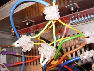

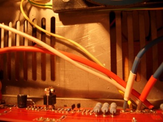

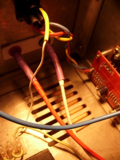

Amp wiring .
Zen, Bill ,
the yellow goes to chassis ground , red and white to speaker terminal, the clear teflon to PS .....
the other photo shows the thermistor on each ground back to chassis .
thanks , Rich

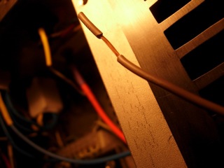

Change wire !

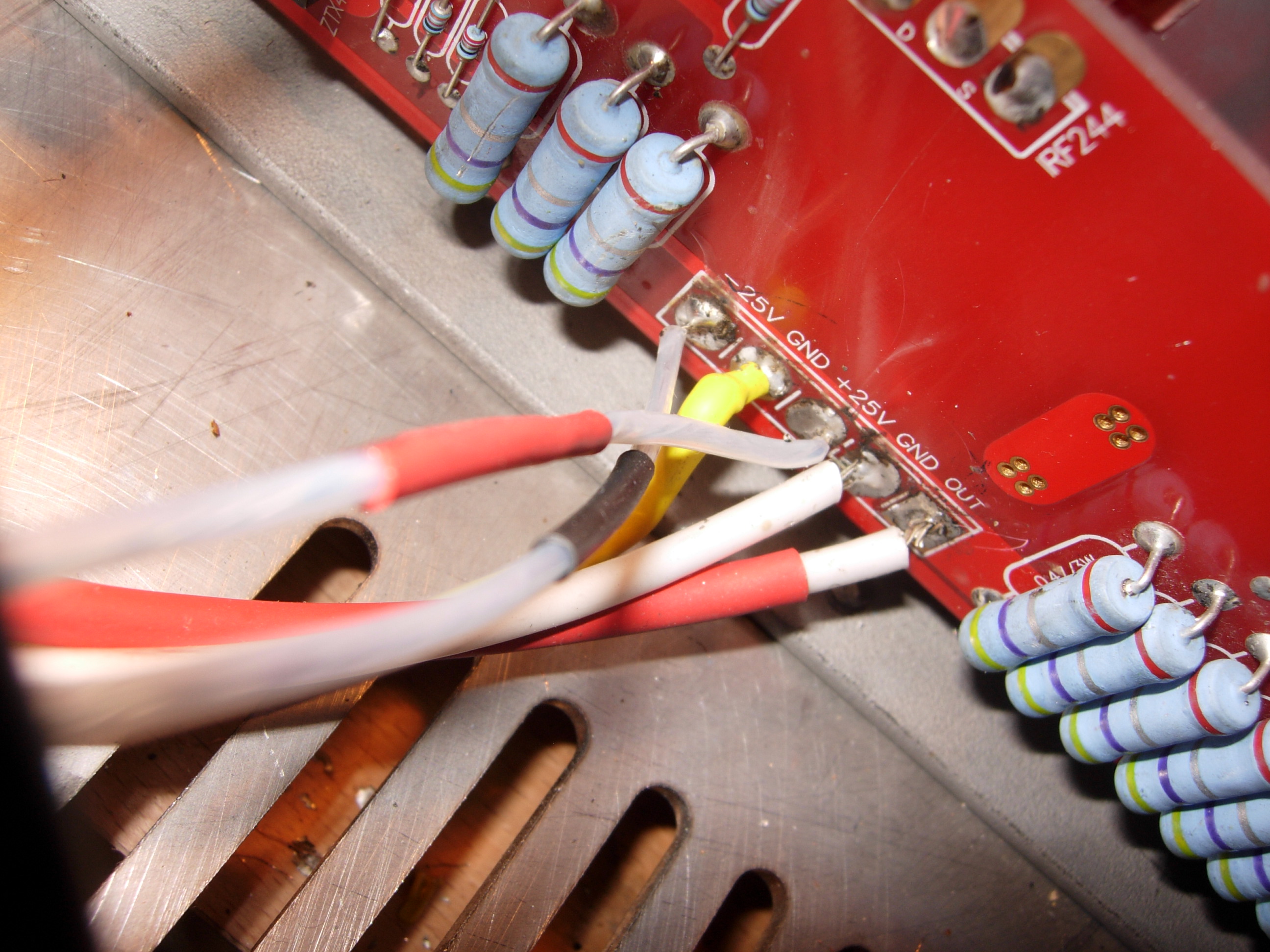

Hi Zen ,
I changed the wire as suggested . Do you mean the ground in this photo....
from the amp board back to the PSU ?
Rich
PS heatsinks still cold !

GND wire from PSU to pcb can be fairly thin , but all other wires must have decent dia
so - wires from PSU to pcb - + , gnd , -
from pcb to pos lsp terminal -
from PSU to neg spk terminal
now - tell us - what's input fashion ?
unbalanced ( RCA ) , balanced (XLR) or both ?
don't be shy with pictures ; we are working with them as much with your descriptions , or even more

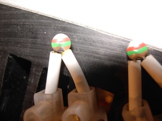

Hi Bill ,
Is the 1.8k thermistor the wrong value ? am I to remove them from between the PSU pcb and the ground ? place them infront of the transfo feed ?
If I remove the ground from the amp board to the chassis I have no direct ground from ,either the PSU pcb or the amp board pcb .... ?
Pics for Zen , the input is balanced only

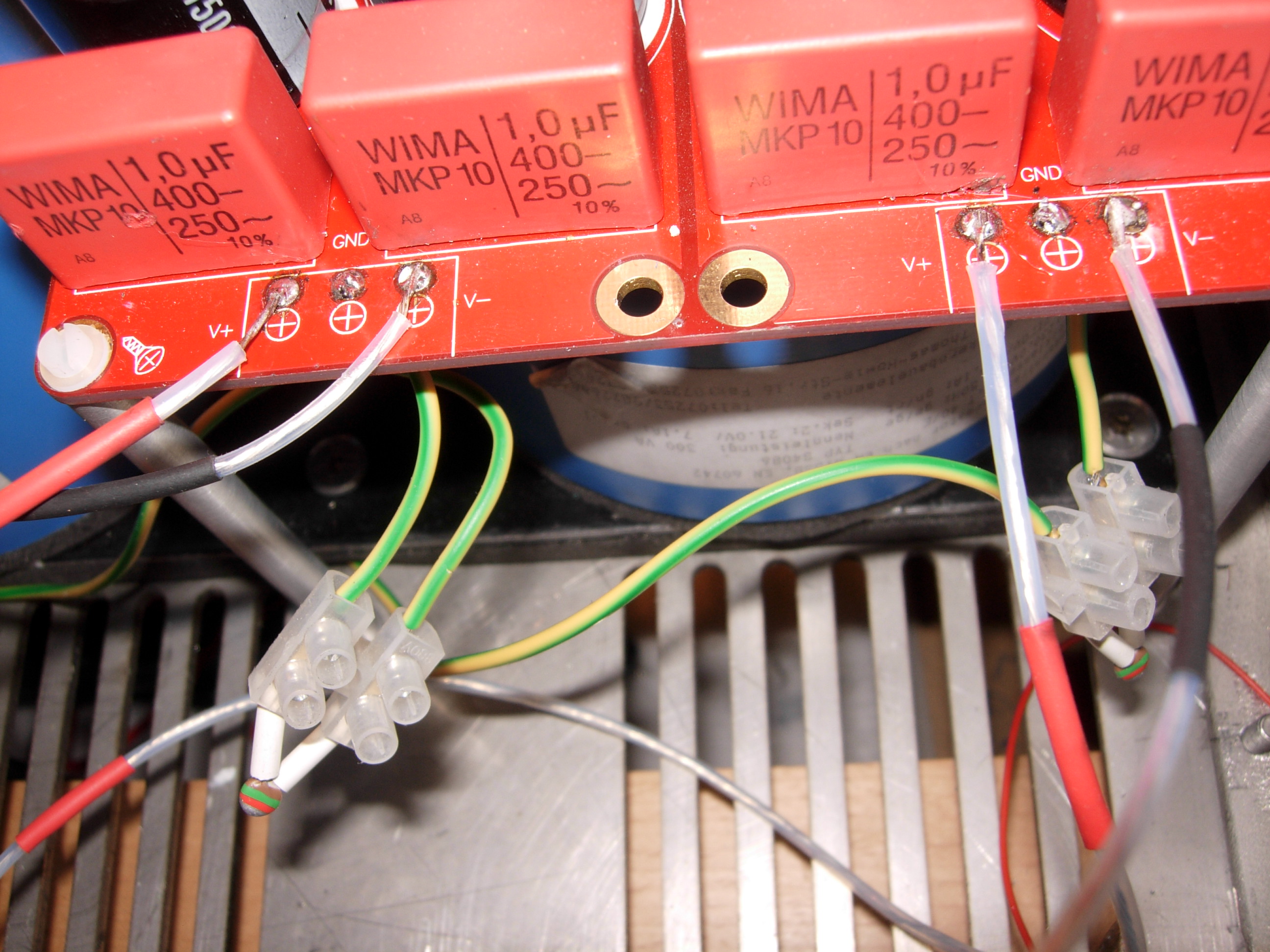

FLASH ooopS !
put the NTC before the transfo and ..... see pic - took them out completely .... Wired ground between amp board and power supply .... put NTC back across IEC chassis ground ... STILL NO HEAT
Do you have the trafo center tap hooked to the PS ground? It won't work without it.
Those thermisters are so high in resistance that they really aren't providing any protection, but that is not the problem with the amp unless you somehow have them in the return path from the amp boards to the PS.
You definitely cannot use your 1.8Ks on the trafo primaries. CL60s are 10 ohms cold and rated at 5A. They should be used for the surge limiters and the ground isolation.
The chassis should be directly connected to the IEC ground lug.
