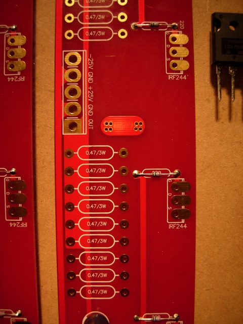

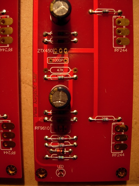

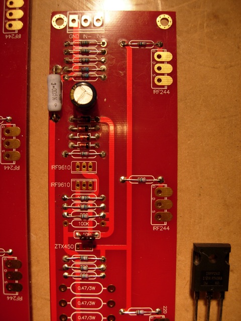

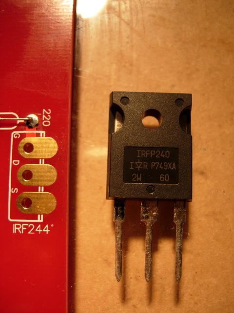

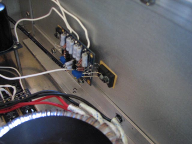

Dont lose confidence now, it really is a fairly straight forward build. Look at my posts when I was building it, If I made it through you will too! It was my first real SS build. What kind of fets do you have? Any pics? I'll be glad to post pics of what I've got. Keep on building!😀

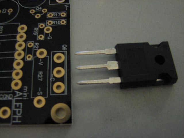

Here's a pic of some fets I got from member Blues, another shot of them beside the tiny Paul Daniels boards for the F-5, and finally a closeup of the pad on the Daniels board. Hope this helps.
Whoops, that's for the F-5. I'm also building an Aleph mini. If it really trips my trigger, I've got the boards for the 30 or 60. doesnt appear any worse than the F-5, plenty of support here.
Russellc

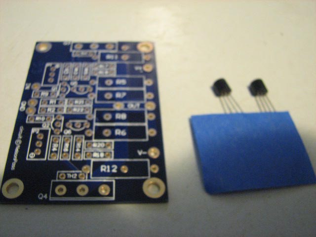

Hi Russell ,

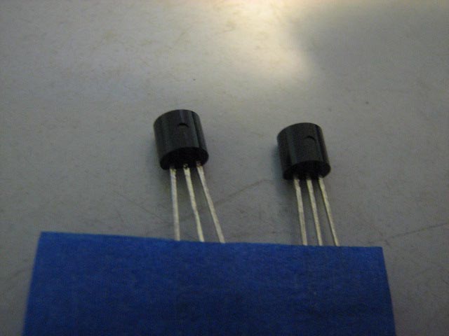

DiodesZetex | Semiconductors | Discretes | General Purpose Transistor | NPN Small Signal |ZTX450
this is what I got ....

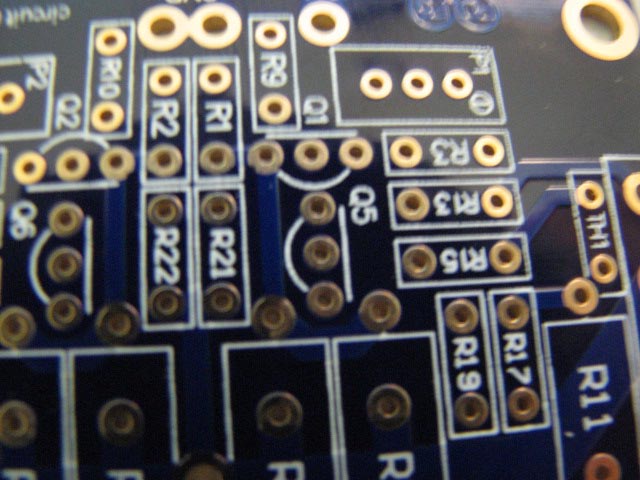

except the holes on the pcb are 3mm centres . I can't find anything to fit properly ... Is the pcb wrong ?

Russell ,
this is what I have !
It looks like it fits, pin spacing appears to be the same, or is it just the pic?
Do you mean that the three pins match the 3 holes, but the fet isnt oriented correctly?
If so, of course the pins can be bent to suit, again a pic of the f-5, with pins bent at 90 degrees:
Dont be afraid to bend the pins a little, but watch stress and strain on those joints, particularly when tightening them down. Also, there is nothing wrong with attaching them from short wires going from the mosfet to the board.
Looking at your pics again, it does appear the holes are not quite wide enough for the fets pins.....wires should fix that. Remember, those fets are very sensitive to static.
Russellc.
Russellc.

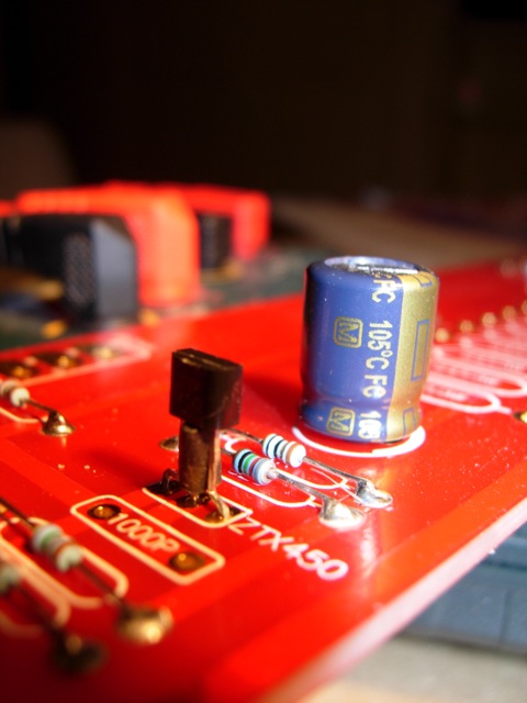

is this ok ?
Looks good...is that tape or something wrapped around the center leg?
If they arent touching I wouldnt worry about it, tape (if that's what it is) may be conductive. Or maybe I just cant see! Appears you've just spraddled the legs out on the sides to fit the holes. Should be fine, I just dont know what the "tape" is!
Russellc
Ok I'll remove it ... thanks
As long as the legs dont touch it shouldnt be a problem.
