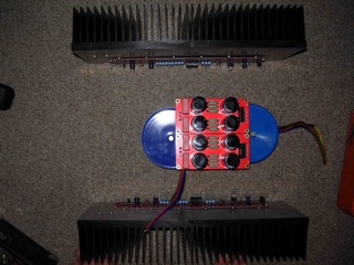

Internal Layout ?
Hi folks,
I'm looking for suggestions on the internal layout of the amp .
I thought this might be ok . Bearing in mind the objective being as much distance as possible between power and audio signal ....
Please advise .
I'm off to laser cutters tomorrow so I would love to get panel dims confirmed asap .
thanks, not a novice anymore , just a funny colour green
Rich

It's hard to get a sense of the layout size, what are your heatsink dimensions? Just at a glance it looks to be fine.
I hope you have flattened and polished the heatsink areas where the fets are mounted, it is quite important. A fine mill file will reveal how unflat they really are.
Don't forget to include some venting in your top and bottom panels.
Lookin good!
Lookin good!
