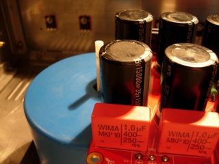

Just to tie off my power supply PCB enquiry (post 48), I got my boards from chipamp.com and they are a thing of beauty - gold plated holes on a black board. I've attached a photo, I hope it attaches ok.
The board is dual polarity, has space for 6 big caps, two snubber caps, resistors to place between capacitor stages and drain resistors. Size is 88x202 mm^2, 8 inches x 3.5 inches.

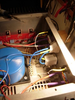

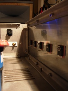

Quick Visual Update .
This is the easy part ..... for me at-least . I have always learned from watching. Reading about this electrical stuff makes my brain hurt 🙁

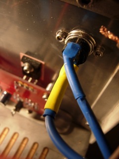

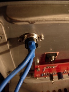

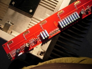

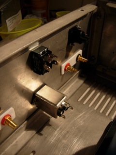

Audio signal wiring ?
Hi Gents ,
I need help with the wiring please ...
Bottom left hand side ..... IN ... is this the signal from my XLR ?
Middle centre , this must be the input from the PSU and the output to the binding post .... which is which ?
thank you for your patience , Rich

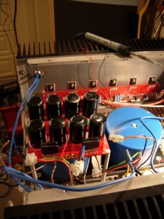

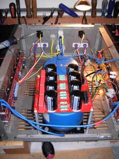

5 fuses WTF ?
Hi Gents,
now Im completely frustrated .... I have blown 5 fuses , checked ,double checked , triple checked .
I had no problems when using one transfo for testing ,but as soon as I add the other ..... fizz ,boom , bah , bollocks .....
Is there anyone in London that can spare the experience and time to pull this amp back from the skip ?
Rich
You gotta give us a lot more info.
Are you using dual supplies, one for each channel, or did you parallel the secondaries.
How big are the trafos and how big are the fuses.
Did you use CL60s for turn on surge.
Can you make a sketch of the PS wiring.
You should disconnect the amp boards until you get the PS sorted.
you should use a mains light bulb tester to save the cost of the fuses and to allow you to take some voltage measurements of the faulty equipment without damaging any components.

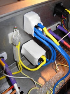

OK !
Andy , Bill thanks for the help !
Just bought 5 more and blew 4 left 🙂
I tried with transfo wired together ... nothing else -it blew
IEC (fused) wired to toggle switch . From top of toggle wire goes to thermal cut
off , to next thermal cut off and then to yellow transfo mains and back to toggle .
The 2 transfo are wired as per info on side ..... Sec 1 ,red and green blue and brown .... on both

If each trafo works hooked up alone, and it blows fuses when both are connected then the fuses are too small, I would think, unless you have a bad wiring mistake.
The turn on surge of 2 trafos can be pretty substantial, that's why the CL60 thermisters are generally used, one on each leg for 240V. 3 or 4A slow blow fuse would be the minimum, what are you using?
It would be helpful to sketch your PS and post it. Just looking at that might help you.
As Andrew said, a lightbulb in series with the power cord is a handy item in these cases. I made up a short cord with two outlets in series so I can plug a lamp in one and an amp in the other.

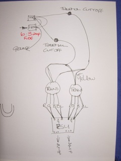

Hi Bill ,
Ill pick up a light fitting in the morning .... heres a sketch
BTW there is a thermistor between the AC inlet and the chassis ground .... the fuse is 6.3 amp !
Hi Rich
your sketch is a little hard to read, but it looks as if the fuse is across the two input AC lines(??) Am I reading this right? That arrangement would immediately blow the fuse, it should go live connector - fuse - transformer primary wire - second primary wire - neutral connector. Sorry if I misread.
Steve
From what I can see of your PS boards they are using 2 small bridges in parallel instead of 1 big one. Can you confirm that? If that is the case you need to do a little more wiring. Regardless of that, the secondaries are directly shorted anyway.
Remove all the trafo secondary leads from the boards and separate them.
On each trafo, find the pairs that measure 21v, tape them or put wire nuts on the ends, and tape them together.
On one trafo, connect one wire from each pair together, then measure across the 2 remaining wires. If you measure 42v or so then you have the correct wires connected together. That is your center tap that goes to the board ground. If you have close to 0v across the 2 wires instead of 42v then the secondaries are out of phase and you must reverse the wires of one of the secondaries. Don't hook up the boards until you have this sorted out.
