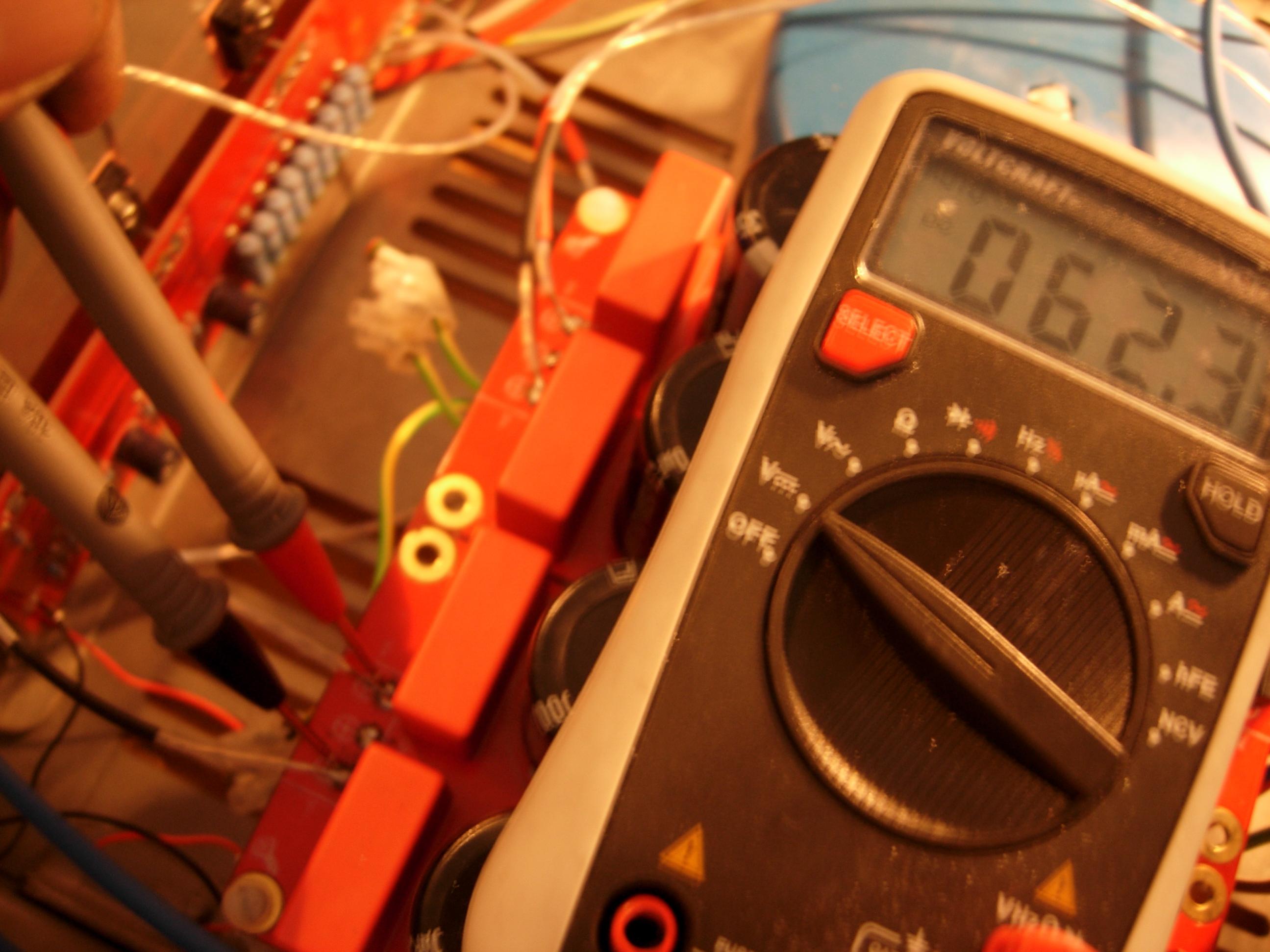

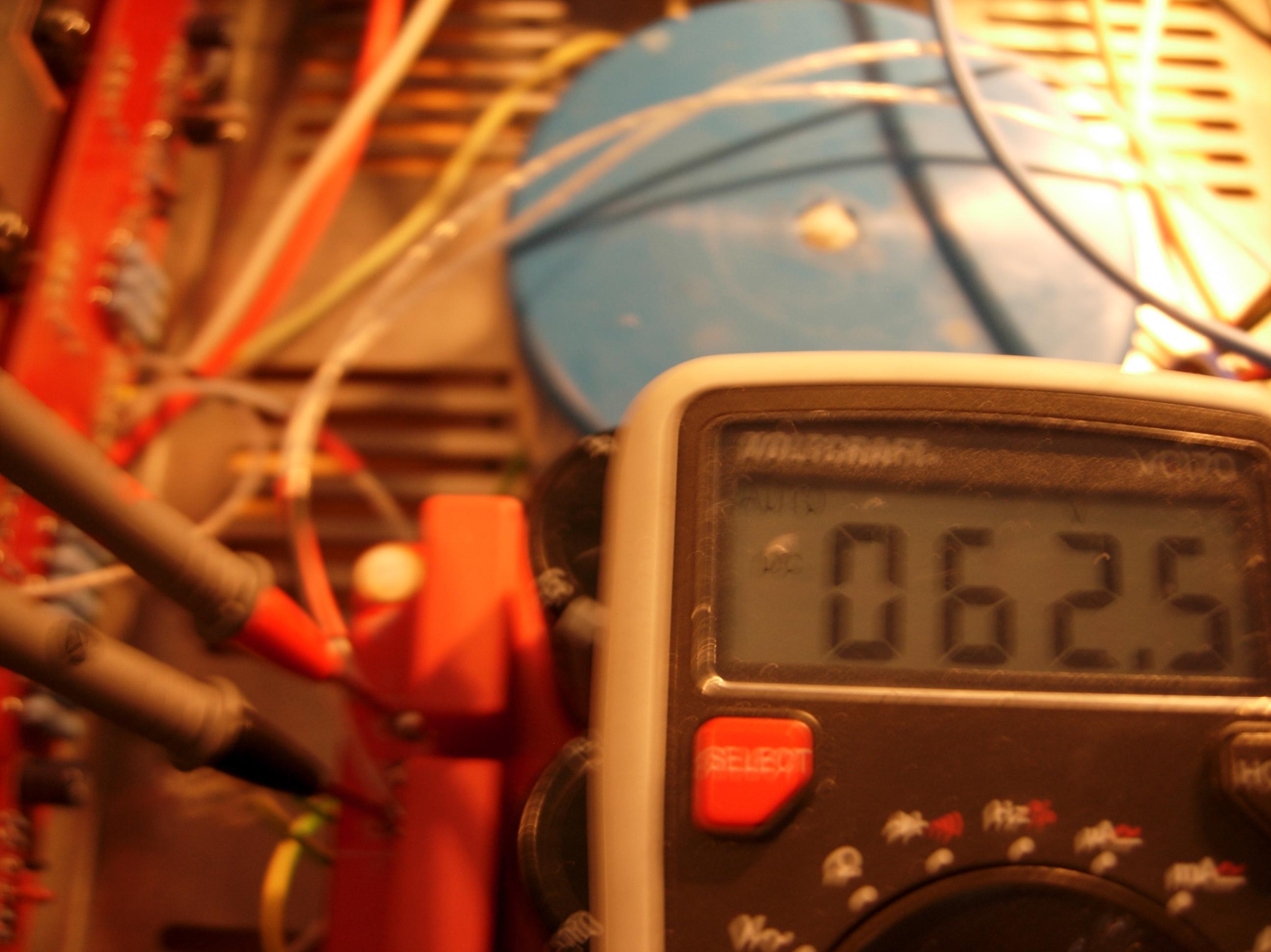

readings ...

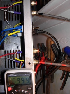

I think you misunderstood. We are looking for DC at the output of each amp where a spkr would be hooked up, that is the offset. The amp is supposed to be balanced so that there is only millivolts at the spkr hookup. If one set of fets is turned off, as you have, the offset will be very high.
I think I see your problem. On the amp board pic in a previous post it seems you have the 2 9610s bolted together with no insulation between them. That bypasses the resistor that supplies voltage to the fet gates. They must be electrically isolated from each other. The tabs on the 9610s are hooked to the drains internally.

I think I see your problem...........the 2 9610s bolted together with no insulation between them.
the To220 package has an exposed tab for the bolted connection.
Most of the other packages have an insulated bolted connection, eg. To126, To247, To264.
The back face of all of these have a heatsink interface that is electrically connected to the middle pin of the BJT and FET.
