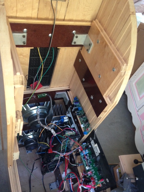

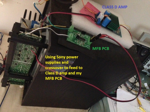

Gnobuddy's post on this SMD prompted me to post an update on my Sony MFB project. In brief for those still interested, here is what I have done since last January?'s post.
Through a series of baby steps, working backwards from a defunct pair of Genesis subwoofers + I purchased several cheapo ($25) Chinese class D amp (actually turned out to be pretty decent!) to work with the genesis servo preamp circuit. I powered this class d amp from the +/- 53V of the sony amp power supply...totally lucked out on the voltage there. as it is near the max for the Class D amps
Then after several months...I figured out how to use some software to design pcb boards and started having them made in China. I started off with making the piezo->buffer -> integrator/low pass filter -> mixer. I was going to use the low pass filter from the sony sub to run into my circuit at the point of the mixer. I was going to try the Chinese Class D amp or maybe the Sony amp to power the sub with the servo circuit. After thousands of iterations, I may have something promising but I don't think I can use the sony preamp part feeding directly into my little servo PCB - it works okay with pure tones and with the woofer in the sony box (with port plugged) but with music in the open baffle I think some higher frequencies are getting through an distorting the sound - i.e. sounds worse with the servo (MFB piezo).
I thought I had it working Sony Preamp->my servo circuit->back into Sony Amp->to Sony woofer with piezo mounted (see attached pic) and + feedback sounded good...even in the Sony box.
I did my R&D with the woofer in the Sony box but when I translated to open baffle setup is when I ran into problem. I thought maybe low pass filter was not enough or phase shift wasn't compatible...I don't know so I purchased a cheap Chinese subwoofer crossover filter + the class D amp + power from sony power supply plus +/-14v power supply from sony to run my servo circuit, I have something that is functional.
The trickiest part it so mount the piezo with just the right amount of area over the fulcrum to get the right amount of bending to get the output to match what is needed for feedback in the circuit. A lot of this has finally come together in my mind the past few weeks so I am excited about the hope of getting something finalized.
Thanks to Gnobuddy, Bolserst, Steph_tsf, Bentoronto and others for all their input.

Here is the rear of one of the open baffles with a pair of sony woofers mounted...Two Sony amps + various renditions of pcb boards (8 revisions at least!). this set up is a lot more complicated than what I was envisioning when I first started...LOL
One big disappointment...how noisy my cabinets are at moderate volumes :-( but seems to be diminished with servo (accelerometer plugged in (vs accelerometer not plugged in to PCB)

Thanks for the suggestion Ben. I may be able to try that test. I do not have ideal set up / space really for testing...and that I try to transpose what I find at the 'workspace' where the scope, power and OEM Sony box and woofer are to the cramped and precariously place boards, wires and open baffle system makes things a bit complicated. Right now, just using ears.
With open baffle set up, I occasionally get some large swings of the woofer say around 2-5 Hz on top of the music if I push things just a bit...I think it may be clipping..not of the amp but of the preamplifier but not sure.
Next I want to move the class D amp in place of the Sony amp but want to use the +/-53V of the sony power supply to power the class D and I dread taking the open baffle speakers apart to be able to get at the sony amps.
Hopefully more to come....
