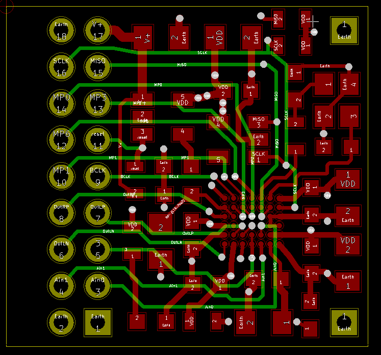

The Grimm sub runs with 30db feedback, this is only possible with a low latency dsp in the feedback loop (adau1772). This dsp has a new brother which runs 768K samplerate. But it is a 0,5 pitch BGA and I designed a small 4 layer board for it, will be in tomorrow:
attachment.php
It is 2x2cm.....

Ah, "the plot thickens".... Thanks for update.
My earlier disparaging remarks about DSP speed should have been limited to general purpose DSP boxes. Fast, purpose-built DSP is exactly what is needed, but not usually in the DIY realm of design or cost. Having said that, I recently bought a Raspberry Pi and started learning about system and if it could work for MF. Anybody have thoughts?
But what I'd really like to know is what tricks does the ds23man DSP perform? Esp, how does it tailor the feedback loop (such as bandwidth limitation and phase finagle within the passband) so that you can achieve 30 dB feedback without howl back?

It is no trick...
It would be really nice if you would describe the manner in which the DSP is employed to modify the feedback loop as to passband, phase adjustment, timing, or whatever other functions (AKA "tricks") it performs.
With speakers, very challenging to achieve high levels of feedback correction due to the wonky characteristics of subs. (Which is why MF is so applicable for subs.) And which is why DSP could be very valuable in wrangling the feedback loop.
Or do you consider that proprietary information?

… what I'd really like to know is what tricks does the ds23man DSP perform? Esp, how does it tailor the feedback loop (such as bandwidth limitation and phase finagle within the passband) so that you can achieve 30 dB feedback without howl back?
A plot showing the feedback loop tailoring is provided in Fig 16 of white paper #6 along with description in the text as to why each adjustment was made. It looks like a localized boost in the loop gain just above resonance in combination with the traditional integrator circuit is what was used to achieve the 30dB loop gain figure. Phase margins of 45deg at LF and HF indicates very good stability. Note that there is no tailoring of phase with FIR filters as that would involve way too much latency. Since all of the tailoring is minimum-phase the corrections shown could be performed with analog filters. Although looking at the complexity, DSP is much more convenient.
