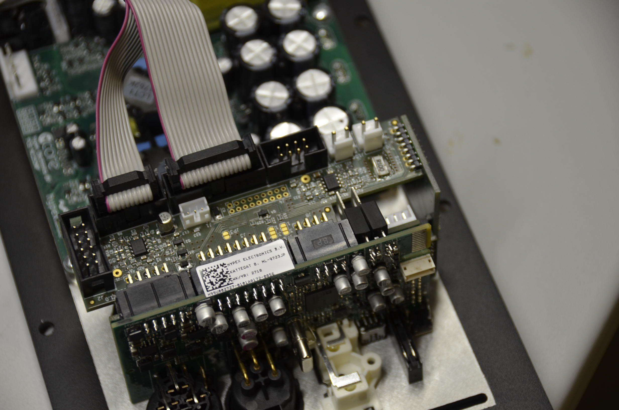

Plug in PCB for the Fusion plate amp with a very low latency dsp in the mfbfeedback chain and current control...
We achieve 30db feedback levels!
Interesting! What are the component Part numbers required to assemble a system? What is the process for tuning the feedback loop?

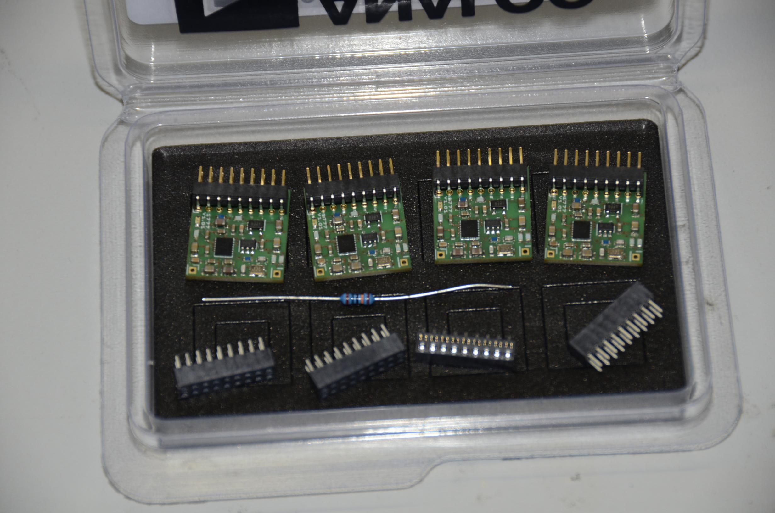

The plugin mfb dsp board with ADAU1777:
Does this plug into any Hypex plate amplifier? Is it programmed with Hypex tools or the AD tool SigmaStudio or ??? Do you provide any guidance on its use?
This is a project which a do with Rob Munnig Schmidt.
All processing ( also the summing stage) is done in dsp, input signal is straight from a I2S output from the Fusion DSP.
Programming is done in Sigmastudio and to create a loopcurve you will need a testbox where you can measure in open and closed loop.

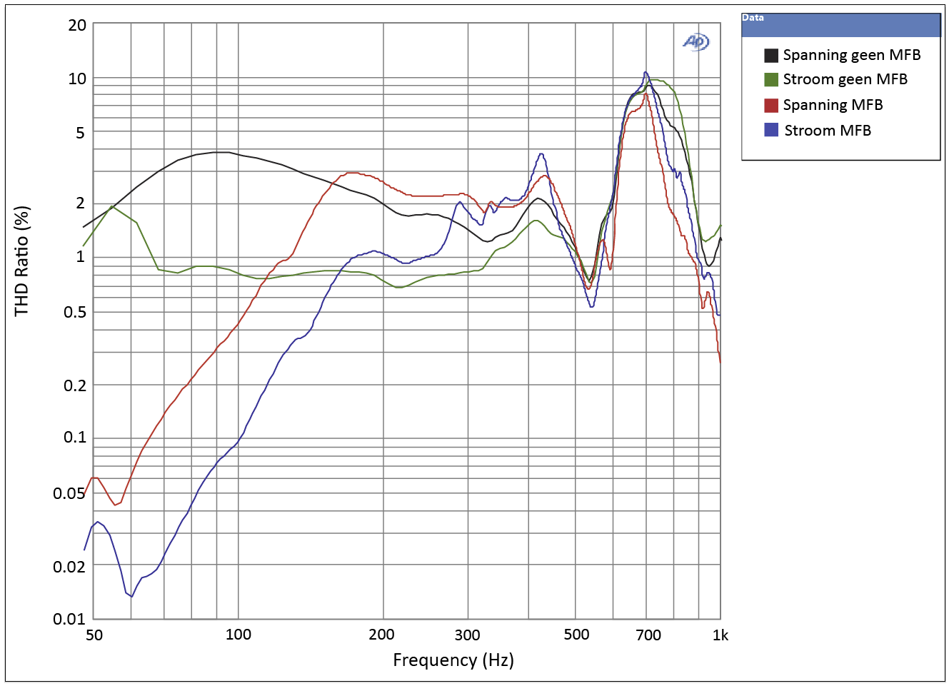

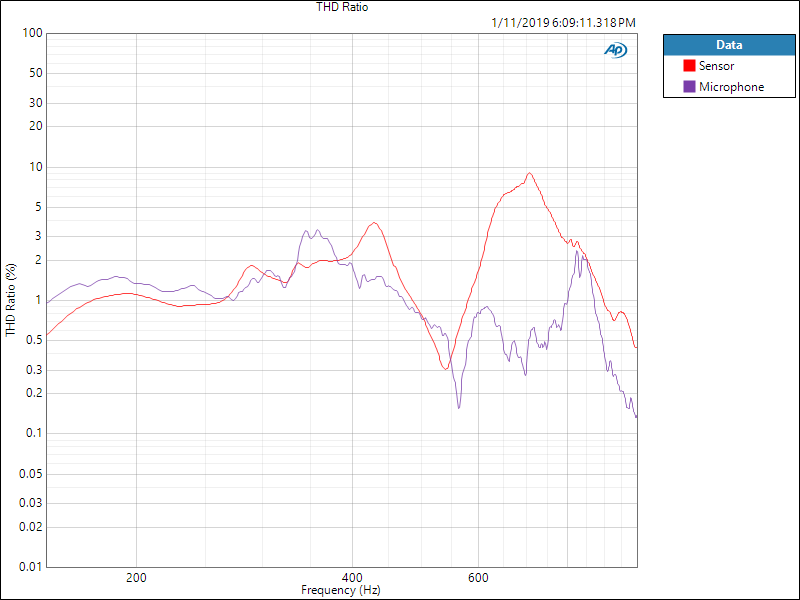

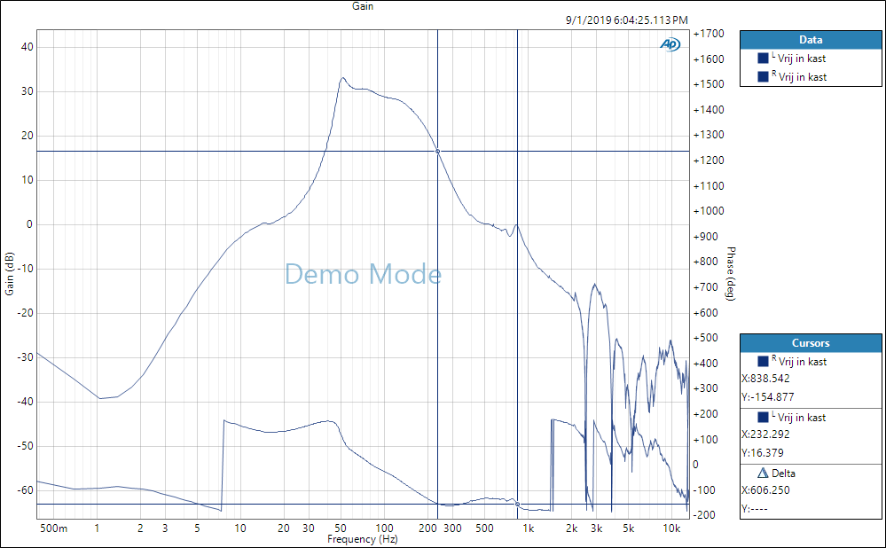

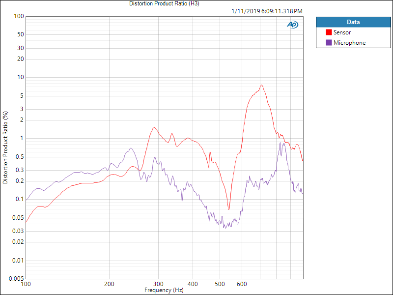

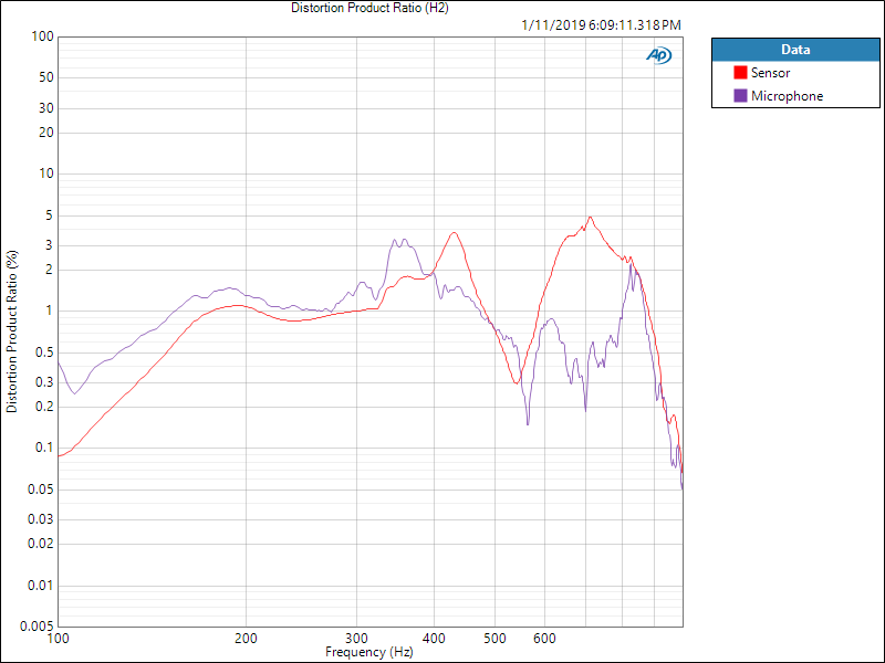

Some measurements from the Fusion MFB controler.
These are done with the SEAS L26RO4Y with a production fault which leads to higher distortion levels.
Open loop gain:
Distortion taken from the sensor (100db spl):
Legenda from top to bottom
Voltage amp no MFB
Current amp no MFB
Voltage amp MFB
Current amp MFB
Total THD sensor / mic at 100db spl:
2th harmonic
3th harmonic
Mic measurements were done above 100Hz only because the small room.
Open loop gain:
Voltage amp no MFB
Current amp no MFB
Voltage amp MFB
Current amp MFB
2th harmonic
3th harmonic

Very interesting, Hans! Thanks for sharing.
There is pretty good agreement between the measurements using the accelerometer and the microphone at lower frequencies as I would expect.
Is the problem with the driver the reason you didn't measure HD to lower frequencies?

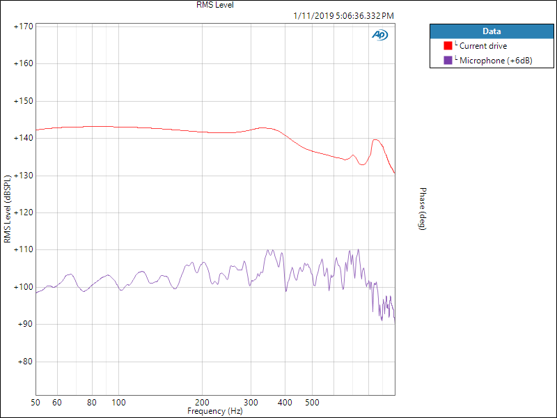

Ok, now for the promised levity…measurements of the Sony SA-W2500 “subwoofer”
Attachment #1: Here is measurements of port, piston, & summation made straight from the test computer, no EQ, no MFB, just woofer + box response. The port response looks more like what I’d expect to see from a 4th order bandpass design. I re-measured it 3 times thinking it must be wrong. Has anybody else seen anything like this before?
Attachment #2: I measured T/S parameters and modeled the response which, surprise surprise, matches the measurements. Yes, you are reading that correctly Sony is using a woofer with a Qts=1.2 in a ported box. Thank goodness for EQ 😉
Attachment #3: Here is a comparison of response as implemented with EQ, LP filter turned to its highest setting, and with/without MFB. You can see that the MFB loop gain is so low (~3dB) it might as well not even be there.
