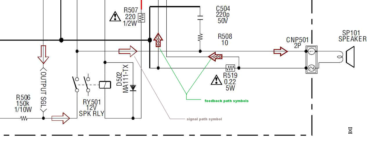

Post #1: "...It seems to have the kind of voice-coil bobbin sensor coil (tactically massaged) that I believe is best way to get feedback signal...."
It looks like the "feedback signal" is a voltage from a small value resistor in the ground line of the speaker drive (also, it seems to be a vented design). I found the schematic here: http://www.diyaudio.com/forums/solid-state/229841-sa-w2500-sub-blowing-fuse.html . I'll attach a detailed view:
So they are in fact measuring the back emf output and using that signal for correction. If that is the case you should be able to substitute any speaker into the equation but that is counting on there not being any other specific correction filter for this exact speaker in that box.

Thanks to all for largely sensible discussion.
Before starting the thread here, I read a thread at an A/V forum that quoted a discussion that seemed to me to indicate a special coil on the VC. That is a sensible approach for Sony/consumer in the various ways that matter to a consumer business. Extra coil, current feedback, or Wheatstone Bridge, can be very cheap to implement in a powered speaker and the benefits of MF are very impressive. Sorry if wrong and I mis-posted. As I said before, one of the R&D goals of MF is to produce great bass from small boxes.
I can't read the schematic kindly supplied by tb46 and MF schematics can be deceiving (sometimes intentionally so). But using what is essentially current feedback to simulate motion feedback is an old and quite useful approach (although I used a Wheatstone Bridge in the MF amps I built). A mega-bit copy would be nice or using PMs to get them from you. BTW, some of the first Kenwood super-amps had trick connections that, in effect, used the speaker wires for current feedback... as did a number of amps in ancient times when narrow bandwidths made feedback a less perilous undertaking than today.

tb46 kindly sent me detailed information. Thank you.
No question, there is a tube running from the back, as in theAnonymous1's photo, to near the front. Ported box it is... but not sure if it is a traditional tuning or set low, kind of like a "small leak" design which is a very good sub design.
Yes, motional (current) feedback from across a .22-ohm resistor in the negative leg (as tb46 already said in his post) which is fed differentially through some frequency adjustment, to an op-amp just for the purpose. I'm not sure if this is as a bridge or not.
