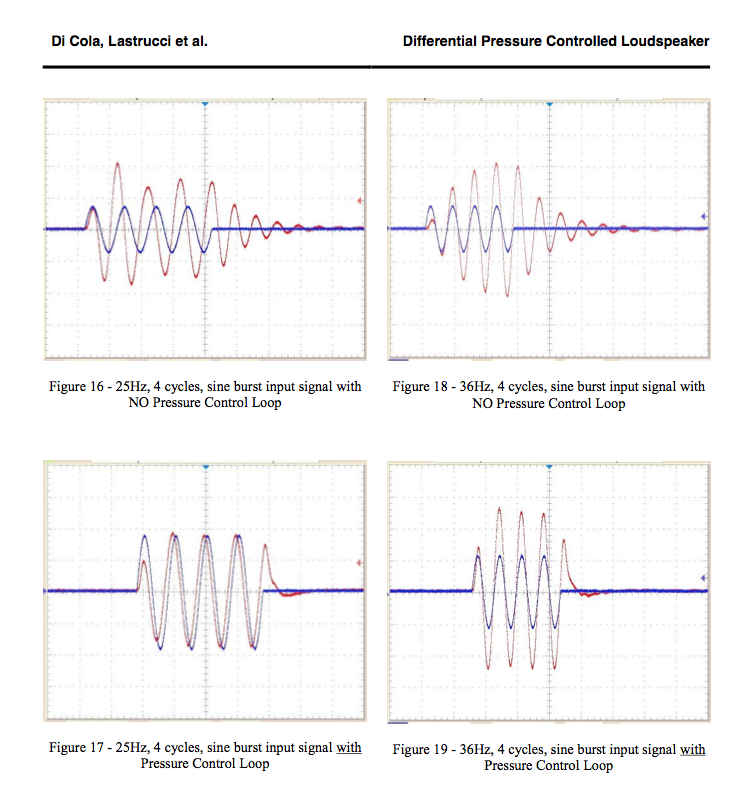

Thanks for link. Interesting pressure tranducer... something like the technology for air mass measurement in automobile fuel-injection throttle bodies.
Anybody who looks at those fabulous tone-burst traces (pages 12-23 from the link) has to shout, "I gotta have a motional feedback woofer." There is no other way to control a woofer cone like that.
Ben
OK... let me comment on the article link from Weltersys.
There are two components to the article (not written in English clear enough for my full grasp). The first has to do DSP modeling of something or other - looks interesting but over my head. This relates, I think, to shaping the input signal to the driver.
The second has to do with MF using a transducer that compares pressure (1) inside the cabinet with that (2) near the front of the driver, as I understand it. They claim their system can be used with any driver; they use an 18 inch driver in a BR cabinet for testing in the article.
Mic results with a four-cycle tone burst at 5 frequencies associated with the BR tuning are shown. The astonishing results are similar to my own tests years ago. As I said before, one look at the improvement due to MF and a serious fan of woofing will want to rush to DIY. I'd like to see anybody seriously deny those results look immensely impressive.
I was wrong to say MF in a BR environment is an oxymoron - it really is only half-peculiar. As the traces show, there are monumental improvements to a tone burst response as far as listening-by-eyeball can reveal. No doubt this improvement would be a great leap forward in any acoustic system including OB (freq corrected in the usual ways) and BR (which is ordinarily beyond easy correction).
The problem for me in attempting BR using voice-coil based MF is that the sound output as you pass through the broad resonant frequency region is that there is an orderly but convoluted relation between speaker sound output and cone motion. That is because at some frequencies, the port adds to sound (upper bump) or subtracts from sound (lower bump) or just holds the cone steady so it doesn't go booooom too much (system resonance). Go figure.
What is especially peculiar to me, pending learning more from this forum, is how you can take the dramatic changes in pressure inside a BR as you pass through the hills-and-valleys of resonance of a BR (as described above) and make the speaker output uniform? I think it is fair to say they authors are "shy" about the freq curve.
While we all know about the output of a BR box (as described above), I have little knowledge of what the pressures inside the box are doing.... let alone how the comparison of front versus interior pressures can lead to a flat response.
On the other hand, it is easy enough to understand how any kind of MF gizmo can result in the fabulous tone-burst results shown in the article, even in a BR cabinet.

Ben,
Some excerpts from the IPAL literature:
"At first it could to be noted, in fact, that one of the most important advantages of using a switching amplifier stage, usually referred as “Class D” amplifier, is the ability of this kind of power amplifier to manage any kind of Voltage to Current relation at its output, up to the full quadrature between them, practically managing a fully reactive load without any problem. Moreover, where the load is very reactive, the power that is bounced back from the loudspeaker to the amplifier output, in Class D operation, it could be easily recovered and recycled into the power supply rails. This kind of situation would be not possible to be managed by a traditional analog output stage instead, because the power dissipation would be extremely high in that case.
“ZERO LATENCY” DSP
An innovative architecture that ensures an astonishing 10us (microseconds) latency on the critical feedback paths allows “analog type” feedback approach with the flexibility of a DSP core."
I suspect an important part of what is only given a sideways mention in the white paper is that the entire signal can be delayed, then re-arranged as needed to comply with the original waveform. The "zero latency" is only a virtual latency, a pre-delay allows the system to "look forward" in relative time and perform the required adjustments.
Neither Class D amplifiers or the DSP horsepower to manage at the level of the IPAL were available until relatively recently.
Although all this makes for sine wave traces that look quite impressive, it should be noted that the transducers used in the IPAL are quite impressive on their own.
All the processing improves on a very good platform that in a home environment would be operating in it's linear range to start with.
Using high quality high excursion transducers in sealed enclosures with proper amplification and EQ one can see impressive duplication of sine wave traces at amplitudes up to the linear operating range, plenty of SPL to cause structural damage.
Using bass reflex or horn or tuned pipe enclosures, excursion and power demands can be lessened, providing more SPL in the linear operating range of a transducer.
When subs are time and phase aligned at the crossover point, the upper impulse response of any properly designed system will provide "punch", or "Pace, Rhythm And Timing" for the prats.
The fact that alternative systems may not track the original waveform exactly below the crossover point is largely academic in any room small relative to the wavelength produced, that is most domestic listening rooms, as the room response will mess up any "perfect" reproduction.
Current pricing of class D amps and DSP could easily allow low cost, non (or minimally) adjustable low cost versions of the IPAL technology.
Unfortunately, good high excursion transducers will never be as cheap as electronics, the tendency will be to "fix" cheap transducers with electronic "solutions".
While impressed with the IPAL technology, I would prefer to invest my money in good transducers and reasonably priced DSP rather than it, more bang for the buck.

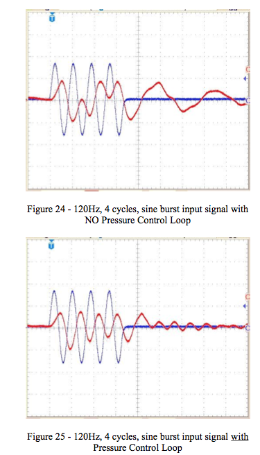

You will be waiting a long time for me to post any tone burst pictures, I have survived for 56 years without an o-scope and it is not on my shopping list any more than a motional feedback system seems to be on yours 😉.
Interestingly, the Ipal seems to have the least positive effect in the 120 Hz range, the place where the speaker response is not subject to the resonant behavior that you seem to abhor in principle.
That frequency range is typically the most critical to integration between the sub and top cabinet, but as the excursion is least there, motional feedback has the least potential to fix problems.
Oh well, the lower, more non-critical frequencies look great 🙄.
Art
Art
