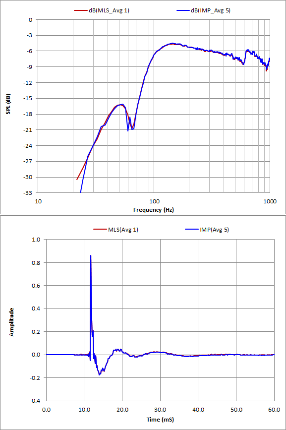

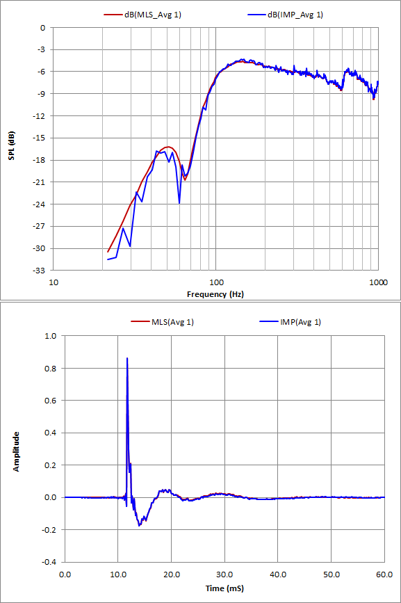

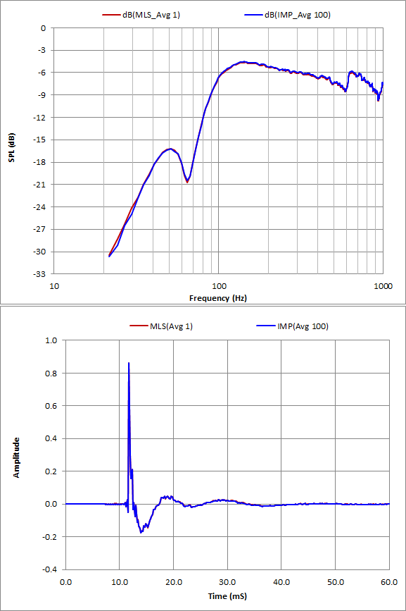

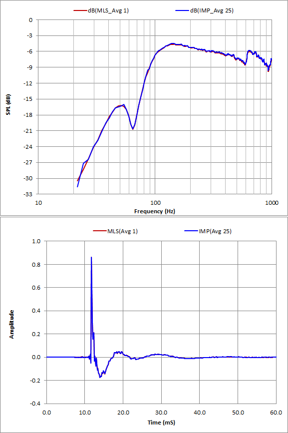

Exactly, and this is why we measure....1) They never are…
REW measures how a woofer actually responds to the input signals at the time of measurement, not how a manufacturer or some modeling program says it should….or how it behaved at a lower volume level 5 minutes earlier...or 6 months ago on a really cold day.

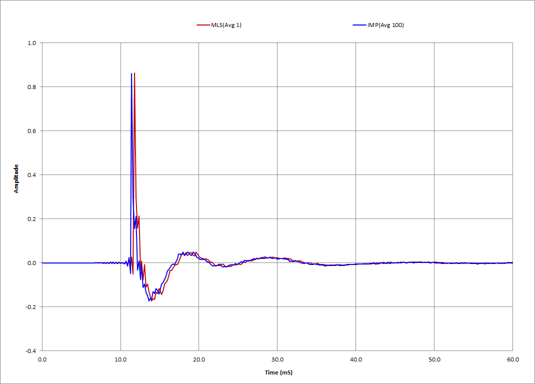

I had no intention of spending any time providing an example of old vs new measurement methods. Generally when somebody brings forward a claim to a time tested method or theory the burden of proof is on that somebody, not the rest of the community.
But…last weekend I was visiting an old friend who happens to still be using one of Bill Walso’s early measurement systems that could use both old(impulse) and new(MLS) test signals to measure loudspeakers. I must admit to a feeling of nostalgia as I heard the “tick tick tick” sounds coming from the vented bookshelf speaker under development. So, I asked if I could grab a few measurements of the near field response of the woofer using both methods with levels matched as best I could.
Here are the results with no smoothing or any other data manipulation:
Attachment #1 thru #6: These are impulse and frequency response comparisons between a single MLS data capture(red curve) and 1, 5, 10, 25, & 100 impulses(blue curve). You can see that it only takes a few averages to clean up the majority of the HF noise, but LF noise remains a problem even with 100 impulses averaged...which takes the better part of 2 minutes to acquire. This is because all the HF information is contained in the first few mS while the LF information is spread out over the rest of the 50mS time window where there is much more opportunity for noise intrusion and the signal is of lower amplitude.
Attachment #7: A zoom in on the impulse comparison.
Attachment #8: A zoom in on the impulse comparison with curves shifted to more easily see that there aren’t any missing features in the MLS version of the impulse response.
For those who have no clue what I mean by “tick tick tick”, I have attached a cell phone capture of the impulse test in progress.
This is the sound of State-of-the-Art loudspeaker testing from the 80s.

If there's a chance that I understand Bolserst's traces, it establishes that collecting audio data by sweeps or by impulses are about as perfect as anyone could want since they exactly duplicate one another.
I gather that one method uses an impulse stimulus and the other a frequency sweep. The impulse method can produce a freq response almost perfectly duplicating the sweep method's sweep curve and the sweep method can produce an impulse profile almost perfectly duplicating the impulse method's impulse trace.
Since I am used to seeing nothing but messy real-world data when I collect it*, it looks to me like a great achievement to match that precisely for both methods - and even in just a single run of each.
Do I have that right?
(Of course, I may never understand why REW shows the impulse starting before zero time?)

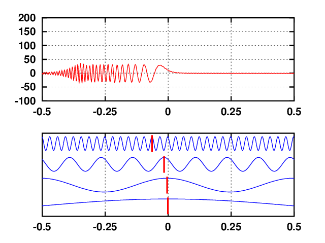

It’s probably not that important, but it still sounds like you are under the impression that the sweep method determines a frequency response and then from that the impulse response is calculated. That would be how a gated sinewave method works to determine the impulse response, but not the swept sine method. As described in post#698, the swept sine wave directly determines the impulse response by convolution with the reversed time signal. Then, from the impulse response, the frequency response can be calculated.…I gather that one method uses an impulse stimulus and the other a frequency sweep. The impulse method can produce a freq response almost perfectly duplicating the sweep method's sweep curve and the sweep method can produce an impulse profile almost perfectly duplicating the impulse method's impulse trace…
It’s actually rather fascinating to me how similar the impulse and swept sine signals are to each other. Both contain all frequencies at the same magnitude. The only difference is that the impulse signal has all frequencies at the same phase, and the swept sine has phase varied with frequency. The convolution with the reversed time signal “reverses” the phase warping, lining all the phases back up to get the impulse. Wiki has a nice animation showing that about 2/3rd the way down the page here:
https://en.wikipedia.org/wiki/Chirp
For convenience, I attached the animated gif below.
The DSP book I mentioned also has some information on this type of signal and a brief description of why it was/is important for radar and sonar due to its improvement in S/N ratio while retaining the time resolution of the returned impulse. Chirp Signals

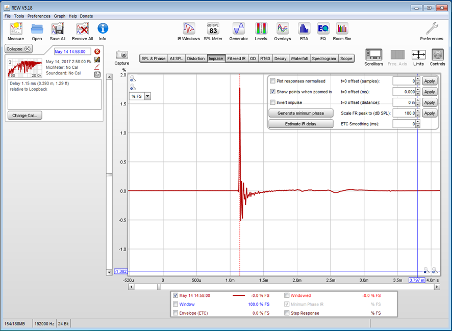

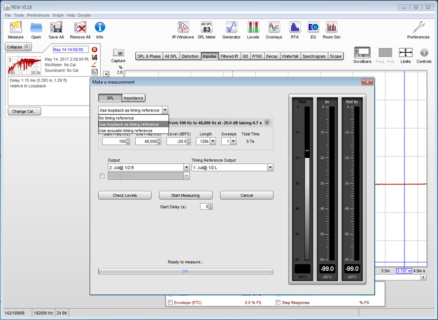

Probably because you have selected option to align peak of impulse at time zero. This results in removing all delay from the phase response.Of course, I may never understand why REW shows the impulse starting before zero time?
Check on the “Analysis” tab of the “Preferences” window…don’t forget to scroll thru the help menu at the bottom of the window for details on the options.
If you are interested in quantifying and retaining the “time of flight” in your measurements, the easiest way is by using the other channel of your measurement system as a loop back timing reference. Then when you take measurements you will see the impulse offset in time consistent with the mic distance from the acoustic source. REW even calculates this distance for you and gives you many options in the controls sub-window to manipulate or remove this delay. Depending on the version of REW you are using you may also have the option to select the timing reference from the measurement window right before performing the sweep. Of course with time of flight included, the plotted phase response will "wrap up" at higher frequencies due to the delay.

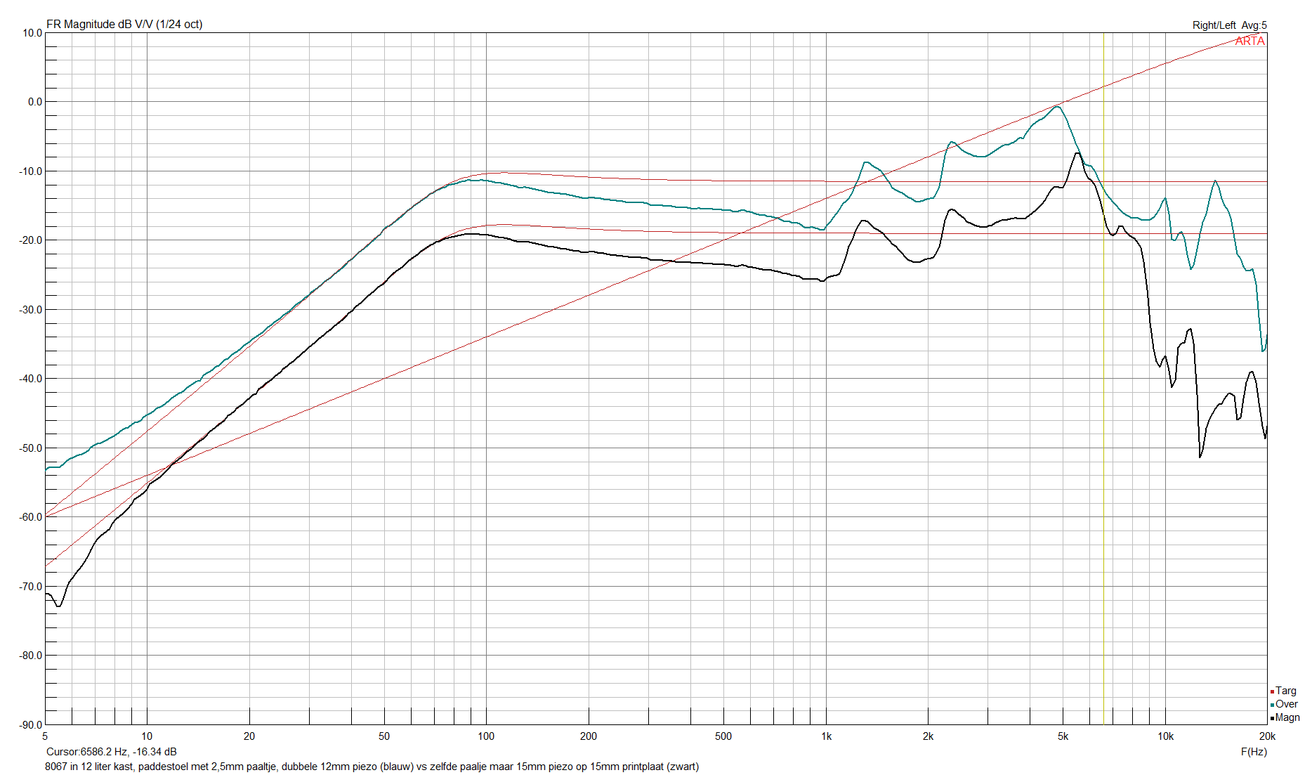

The StarBass dev is done in close coöperation with the folks over at mfblabs.nl where lots of interesting mfb sensor R&D can be found and where the StarBass IV proto measurements will also be made available. Mfblabs is a non commercial site run by Hans Mons, the former Philips mfb dev lead. Its forum requires registration and is mostly in the dutch language but english posts are accepted as well.
Attached a sample fr graph of a paddo accelerometer done by René over at mfblabs.
Thanks again.Attached a sample fr graph of a paddo accelerometer done by René over at mfblabs.
That is an impressive graph. Its shows (I am guessing here) the accelerometer output matches some criterion output across the band that matters in MF (that is, the range of piston motion).
Good as it looks, that may be too gross a demonstration.
I wonder if the requirement for an accelerometer is to achieve a level of accuracy like the THD that is itself a fraction of the speaker THD. As is conventional in feedback thinking, the character of the feedback becomes the nature of the loop.
Ben
Yup, the accelerometer response should mimic the driver's sonic output as close as possible.Its shows (I am guessing here) the accelerometer output matches some criterion output across the band that matters in MF (that is, the range of piston motion).

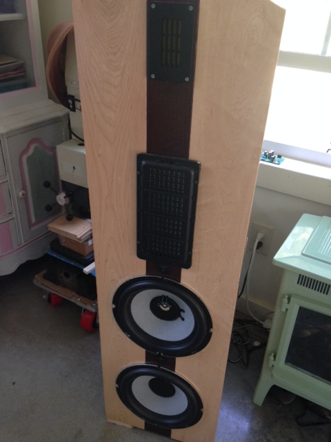

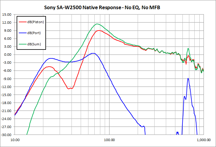

SONY MFB Piezo Servo Update Pictoral
It has been a while since I have posted on DIYaudio but thought I would give a brief update of my progress on attempting to use a piezo disk mounted to Sony woofer + circuit to buffer, integrate and mix with preamp signal.
Taking woofers out of original box and putting in another larger open box - not my best work but using scraps and a hand saw and a miter saw just to get shape roughed in.
more pics and posts below......

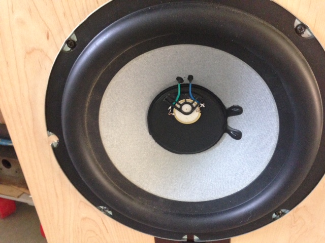

SONY MFB Piezo Servo Update Pictoral 2
Close up of Sony woofer with piezo attached to dust cover.
Some may cringe at the though of me mounting the piezo this way, but base on my intuition and feel (the dust cover is flat and thick and does not flex with this little weight on plus my mounting hardware surface is large and spread out over a large area. Sine wave outputs look real good.
