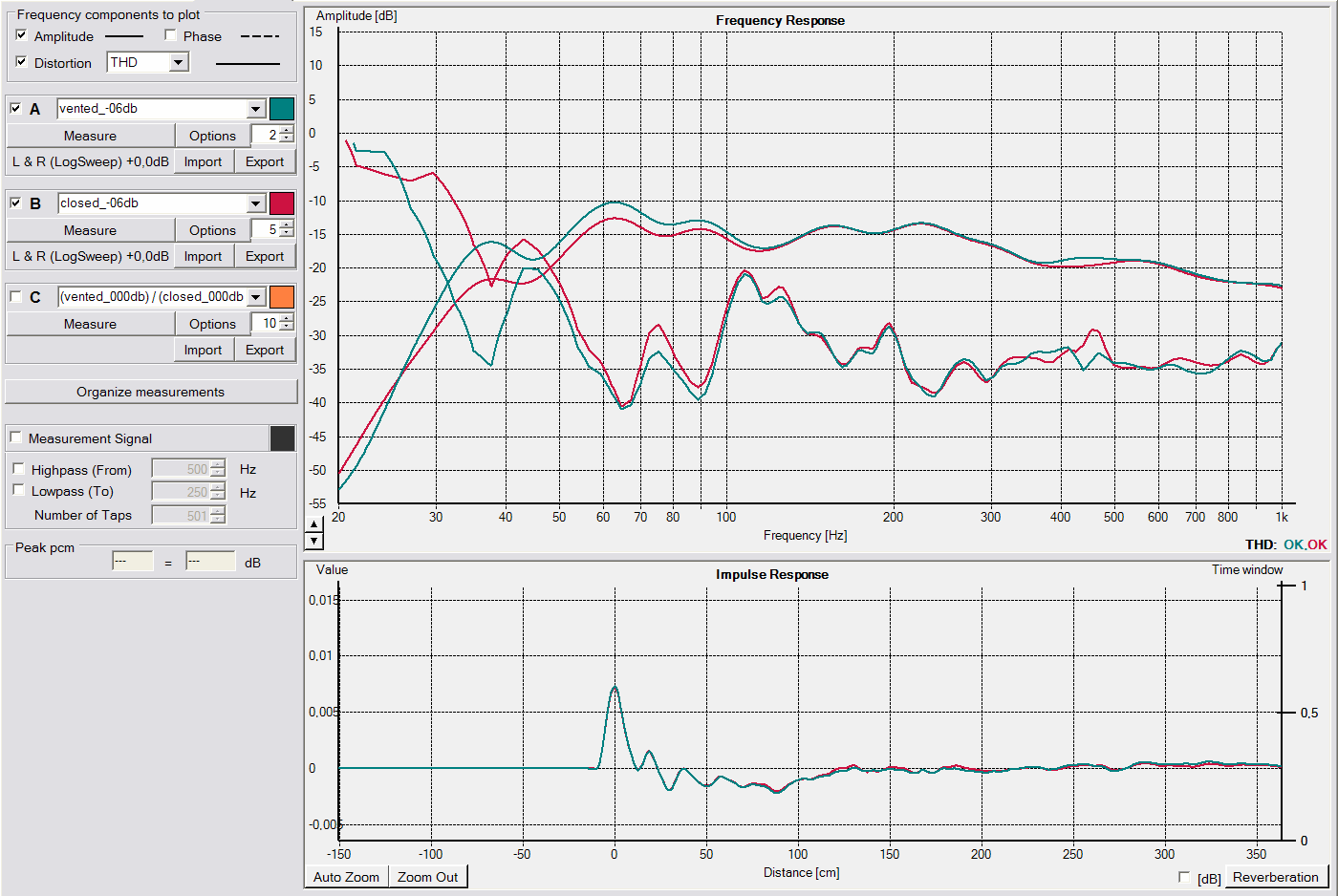

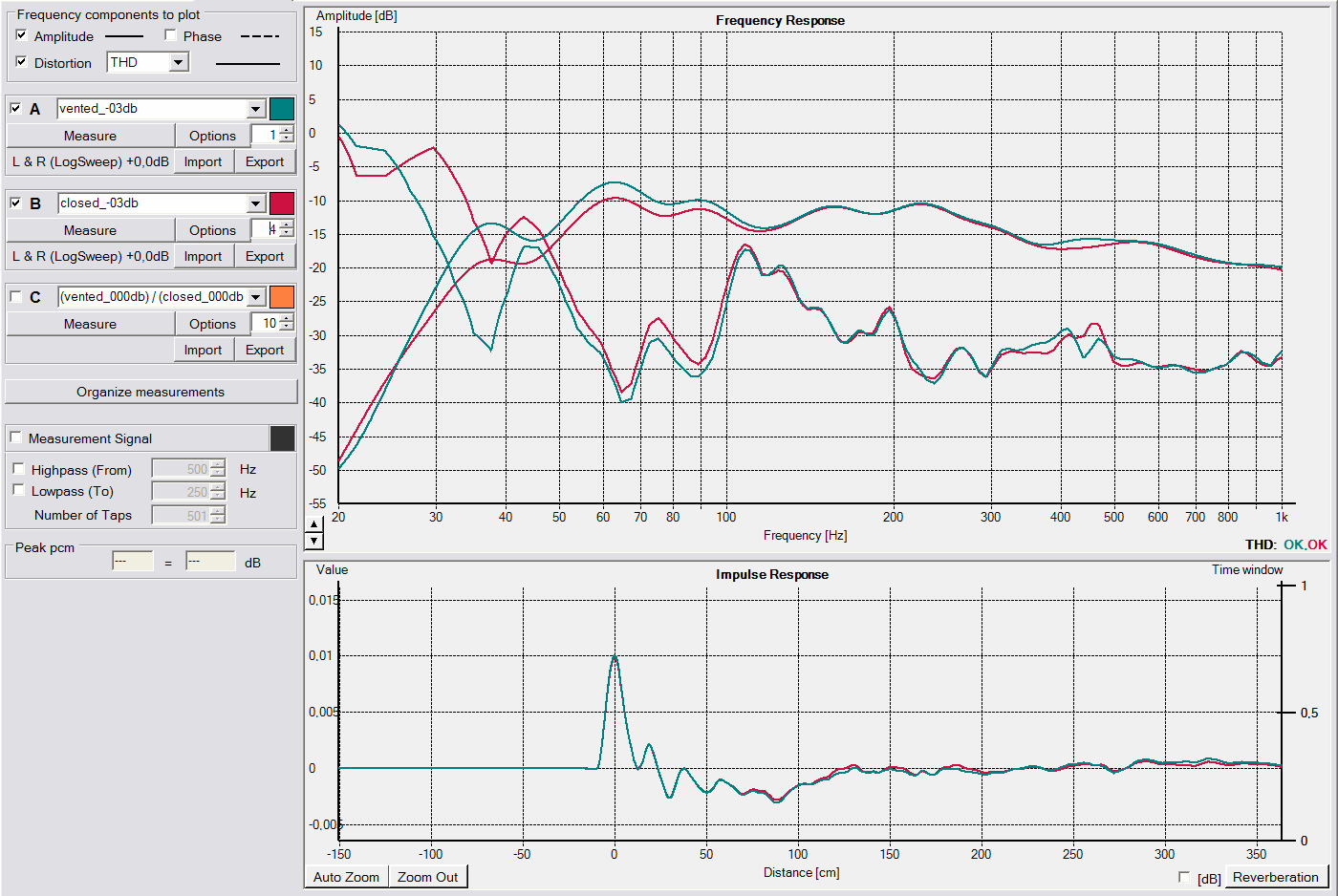

These measurements done by me have also been posted in a german forum in 2014:
aktives-hoeren.de • Thema anzeigen - Subwoofer - sensorgeregelt/geschlossen vs. Bassreflex
The setting:
The same driver has been mounted in a BR enclosure and in the same enclosure but with port sealed, which then makes up the CB variant. Base level in sound pressure of 0 dB has been defined at 100% THD of the closed box variant at 30Hz.
Figure 1: THD from 2nd to 10th harmonic and noise at level -6dB: BR(green) vs. CB(red)
Figure 2: THD from 2nd to 10th harmonic and noise at level -3dB: BR(green) vs. CB(red)

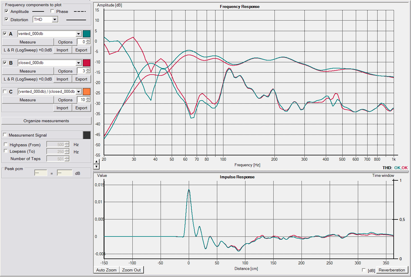

Figure 3: THD from 2nd to 10th harmonic and noise at level -0dB: BR(green) vs. CB(red)
The (absolute) level of the harmonic distortion is about 12 to 14 db lower in the BR variant in a wide range around 35 Hz. When accounting for the relative increase in sound pressure with the BR System at LF, the relative decrease in THD is even higher ...
At large excursions there will also be an effect on FM distortion (Doppler distortion) too, which tends to be audible with music programme, if excursion is high and the driver is operated e.g. up to the midrange in a 2-way System.

Again Klaus,
i am sorry to present plain data saying otherwise:
(Figure 1 below)

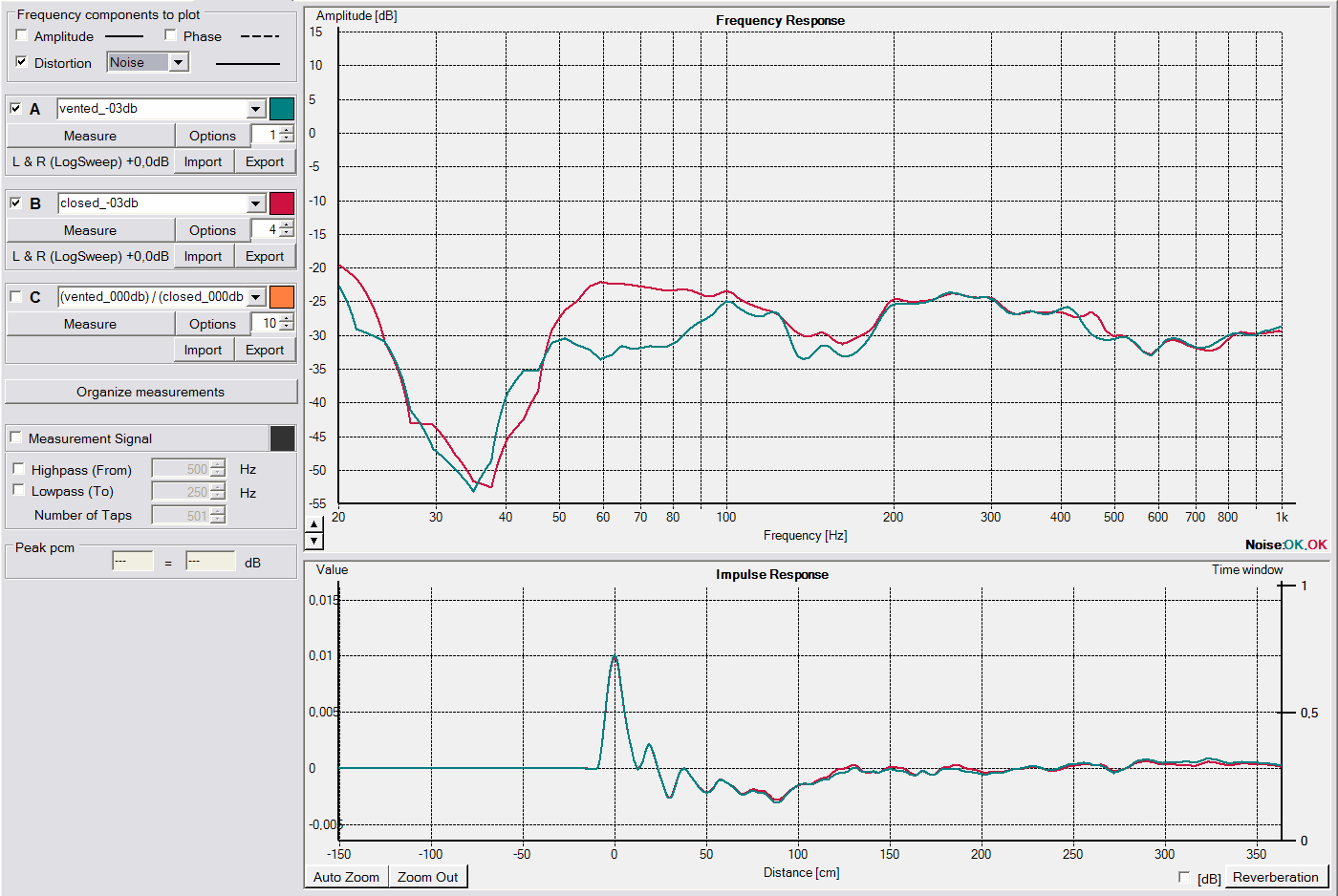

Even when extracting "noise only" the BR variant (red) produces less noise in the low to mid bass range (here: 30 to 100Hz) than the CB variant (green).
This comparison has been made at the -3db setting described above:
When furthermore accounting for the fact, that the output of the BR variant is about 5dB higher than the CB around 35Hz, while we compare "absolute" noise levels in this diagram here, than the BR clearly outperforms the CB even in S/N ratio from lower to mid bass frequencies.
And btw:
The port area used here is just "fairly dimensioned" having about 15% of the cone area. There has not even been extensive rounding of the edges of the port or further aerodynamical optimization.
In dimensioning and designing ports even better, there is also a further decrease in noise and and harmonic distortion, which makes the difference to CB even more obvious.
The examples you might rely on - which you unfortunately don't report to detail or even prove here by measurement - may (very likely due to my experience) arise from very poorly dimensioned designs.
But those, as i stated earlier, should not be (mis-) used to make comparisons due to any technology.
