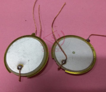

I grabbed one out of the junk-box, and it worked just fine.Any suggestions on what properties I should select - light weight, ~20mm diameter, highest capacitance, high or low frequency resonance?
AB2025B PUI Audio, Inc. | Audio Products | DigiKey
If you have a choice, higher capacitance makes things a bit simpler, light weight is definitely good, and high self-resonance frequency is definitely good. You want the self-resonance frequency of the piezo well above the frequency of the first speaker cone break-up mode, at a minimum.
-Gnobuddy
There have been several references to piezo distortion on this thread. Is there any experimental evidence that this is, in fact, an issue? If so, do we know why there was piezo distortion in those cases?Distortion. Why is this key parameter getting lost sight of?
I know for a fact that piezo distortion was not a factor in the one and only MFB system I designed and built. The fact that closed loop distortion fell by nearly the same factor as loop gain, when negative feedback was applied, tells me the feedback was working just about perfectly; ergo, the piezo was producing a nearly perfect feedback signal.
As I mentioned previously, I supported the piezo all around it's circumference, and did not add any additional mass to it. The piezo was therefore very stiff, with a self resonant frequency of several kHz (I think it was up around 5 kHz, but am not sure after all these years). A stiff piezo will deflect very little, which is going to have the side effect that it will also be very linear.
There is another way of looking at this: woofers are quite horribly non-linear. When I measured one, I was quite shocked to find that it wasn't hard to get 20% third harmonic distortion out of one, if you drove it near or below its resonance frequency, a regime where the extremely non-linear spider and surround control cone motion.
That absurdly high woofer distortion, in turn, means that as long as the piezo produces much less than 20% THD, it will improve the performance of an MFB woofer. Not a very high standard to beat!

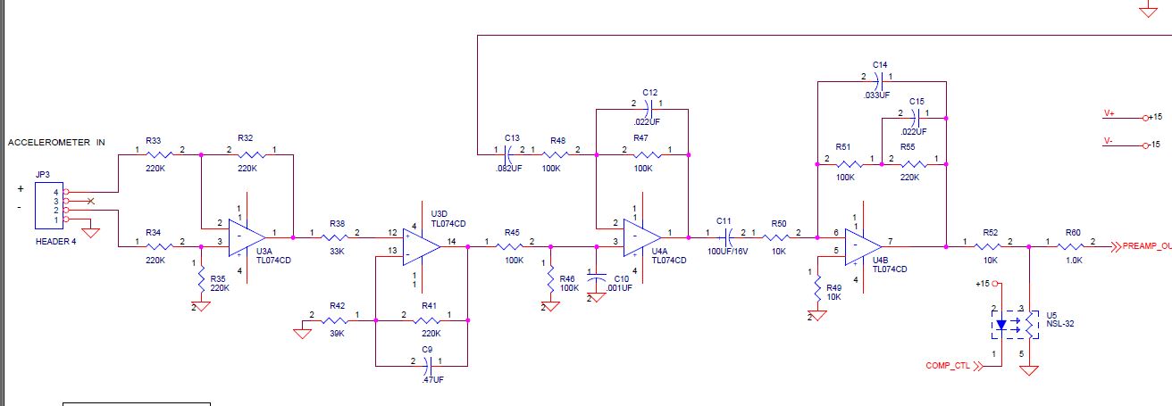

Let's say the Genesis bimorph piezo capacitance is 42 nF. Knowing it gets loaded by a 440 k resistance (see U3A arrangement as balanced amplifier), this determines a highpass filter at approx 8.5 Hz.Not sure if you caught the logic, but my comment was based on the 440K input impedance. If their (Genesis) piezo didn’t have higher capacitance it would be adding significant phase lead below 30Hz making LF stability an issue. The higher capacitance, and louder sound you mentioned all seem to point to the Genesis piezo as being a bimorph, or dual layer piezo as is commonly used for piezo tweeters.
A MFB signal equalizer (bass boost) is thus required, in the form of U3D that's acting as progressive bass booster (integrator) below 8.5 Hz, and voltage follower (0 dB gain) above 8.5 Hz. The integrator time constant is defined by C9 (470 nF) and R42 (39 k), equal to 18 ms roughly. The U3D integrator provides thus a 3 dB boost at the frequency (8.5 Hz roughly) where C8 reactance module equals R42 resistance.
Such progressive amplification increase below 8.5 Hz truly compensates the piezo loading 8.5 Hz highpass filter.
Problem with "true" integrators, is that they exhibit an infinite gain at 0 Hz (DC).
For overcoming this, the U3D feedback network features R41 (220 k) as extra-resistor, transforming U3D into a "leaking" integrator, determining a quasi-DC frequency below which the amplification doesn't rise anymore.
Considering R41 (220 k) and R42 (39 k), the amplification coefficient for the DC is approx 7. The DC gain is thus approx 16 dB, to be considered as limit for avoiding U3D opamp output coming close to the supply rails, in case there is subsonic content in the audio signal. Think about playing a vinyl disc using a DC-coupled RIAA preamp and a DC-coupled control preamplifier. This is not a joke, as the targeted audience for Genesis systems are audiophile people paying a lot of money for everything that's relating to audio, including vinyl discs, RIAA preamps and control preamplifiers.
Considering C9 (470 nF) and R41 (220 k), the U3D "leaking" integrator stops working as integrator below the frequency (1.5 Hz roughly) at which C9 reactance module equals R42 resistance.
Below 1.5 Hz, the system cannot base on the MFB signal anymore, that's exhibiting some considerable phase "up" that would ruin the loop stability. The phase "up" is 45 degree at 1.5 Hz. The phase "up" is 90 degree for DC.
For guaranteeing the stability of the system at DC and in the subsonic frequencies, a rule of thumb is to ensure that at 4 times the MFB signal low frequency limit (4 times 1.5 Hz equals 6 Hz), half of the feedback comes from the power amplifier voltage output, and half of the feedback comes from the MFB signal.

Most MFB system base on conventional power amplifiers exhibiting a flat gain from 3 Hz to 300 kHz. It gets difficult for the MFB to become truly dominant from 12 Hz to 300 Hz, as the power amplifier embeds a parasitic "always on" voltage feedback, always interfering with the MFB.
A quick fix consists of placing an equalizer/amplifier/mixer inside the feedback loop, just before the conventional power amplifier.
The Genesis does so thanks to U4B. The aim of U4B is to provide the x10 open-loop amplification supplement that the MFB is requiring (R50, R51), along with some progressive extra-gain in the deep bass below 72 Hz (C15, R51) till 32 Hz (C15, R55) where the amplification coefficient reaches a value of x32 for the DC.
Knowing that amplifying the DC by such coefficient can be dangerous, Genesis decided to introduce a large coupling capacitor (C11) attenuating the frequencies below 0.16 Hz (R50). Unfortunately, this introduces another parasitic highpass in the chain (we don't deal with the potential issue here).
Anyway, the 32 Hz to 72 Hz equalization tries to impose more MFB from 32 Hz to 72 Hz in order to somewhat improve the MFB dominance at such frequencies.

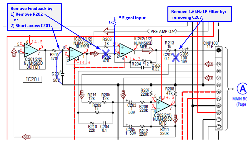

Thank you for the guidance and link to the other piezos.
I was originally thinking to use the sony filters in situ so I would only have to concern myself with the piezo behavior in the ~ 20-200Hz range and not much output above that as filtered in preamp before getting to the mixer. So I was going to focus my efforts on trying to get the amplitude and phase match - at least within +/- 179 degress from the piezo output to the input right before the mixer - seems do-able?

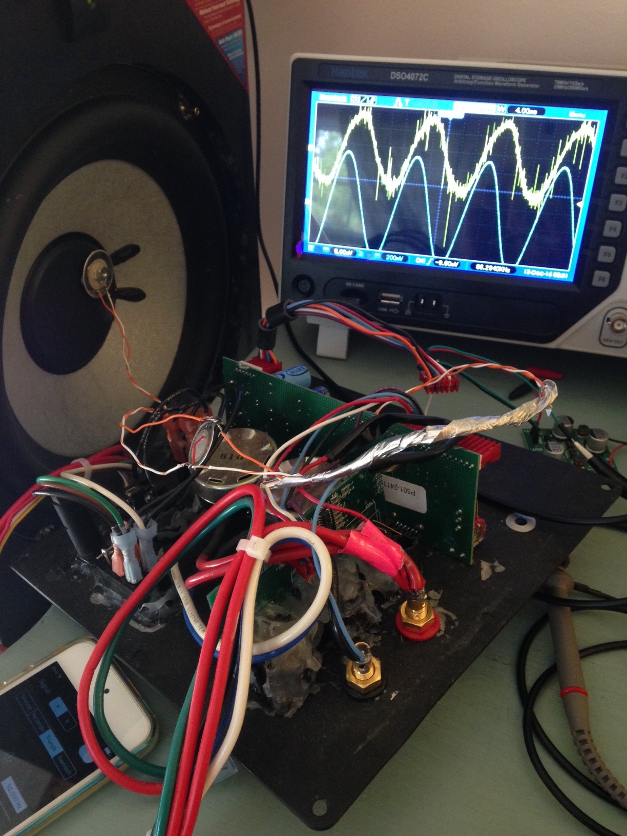

Please see next post below - I tried something, probably a lateral move but helped my understanding of what is going on.

Thank you for the in depth explanation! Could I ask you to elaborate on what U3A is doing? I look at this U3A circuit as a buffer / differential amplifier with a gain of -1? - so if the piezo sine wave output is say +/- 1V AC, the output from U3A should also be +/- 1V AC? But, isnt the positive leg of the piezo being simultaneously cancelled by the negative leg going into this op amp? The reason I ask , I thought I emulated this op amp circuit but am getting great attenuation - either I have the piezo hooked up wrong / [not sure I understand the 4 pin jumper as only two wires coming out of the piezo] or I messed up this simple op amp circuit - any further clarification greatly appreciated.
Next - I have the remnants of a blown Genesis amp, but I figured, the preamp circuit is probably okay. {This timing of this post is fortuitous with Steph_tsf's above post}. Anyhow, I dont know how I did it, but I somehow rigged it / got +/- 12V power to it (the preamp of Genesis) up so I can run the Sony piezo output through the Genesis MFB circuit (BLUE trace) and compare it to the signal going into the Sony mixer op amp (from IC104 1/2) (noisy YELLOW trace). Please see attached pic. I note a strong signal from the piezo after being conditioned by the Genesis preamp (not being attenuated like my lame circuit); I also note the phase shift problem still evident. Basically, this is looking at the circuit I would like to make (already made by Genesis and being tested here) that I would like to superimpose in the Sony MFB circuit - which to me looks like they share a lot of similarities. Side note - the conditioned output from the piezo looks better than the input signal - Lol!
Unfortunately, that's not true. If the MFB servo loop is oscillating wildly at 2 kHz, it doesn't matter whether the music is being low-pass filtered at 200 Hz or not!...so I would only have to concern myself with the piezo behavior in the ~ 20-200Hz range and not much output above that as filtered in preamp before getting to the mixer.
I'll repeat again, to ensure that the servo is stable, it is necessary to have the piezo/woofer transfer function (amplitude and phase) from around 10 Hz to around 5 kHz.
This has nothing whatsoever to do with various things you've mentioned - testing at low volume, lowpass filtering of the incoming audio signal, et cetera. None of those things has any helpful effect on servo loop stability.
It might help to remember that a system with a feedback loop generates its own input - the feedback signal itself. If things go wrong with the feedback, it will take off and howl (oscillate) due to the feedback signal itself acting as input. It doesn't matter what or whether any other audio signal is also being fed into the amp - it will howl, regardless.
The only way to keep it from howling is to know in advance what that feedback signal is going to look like, and design the servo in such a way that it remains stable with that known (feedback) signal.
In other words, you need the speaker/piezo transfer function, both gain and phase. And you need it over the entire range of frequencies where the servo amplifier might oscillate - not the range of frequencies you ultimately hope to feed into the subwoofer.
Without this speaker/piezo transfer function measurement, everything is just a blind shot in the dark. Running blind like that, I can throw together a simple design incorporating an integrator in the forward path, a charge-mode piezo preamp with switchable phase inversion, a mixer stage, and a pot that lets you dial in the amount of negative feedback.
You could then hook it up to your speaker and piezo, and it will almost certainly work, after a fashion. But it will provide very little MFB action, and will definitely take off and howl if you turn up the feedback too far. And that could be a quite unpleasant (and potentially expensive) experience.
If you intend to proceed with the project, there is really no good way around needing that 10 Hz - 5 kHz gain and phase sweep!
