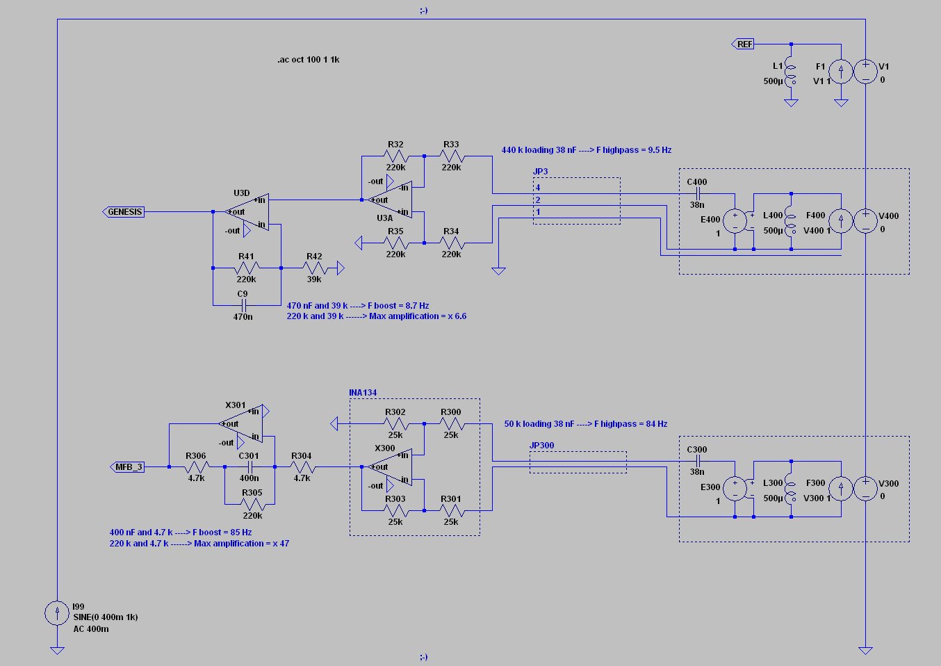

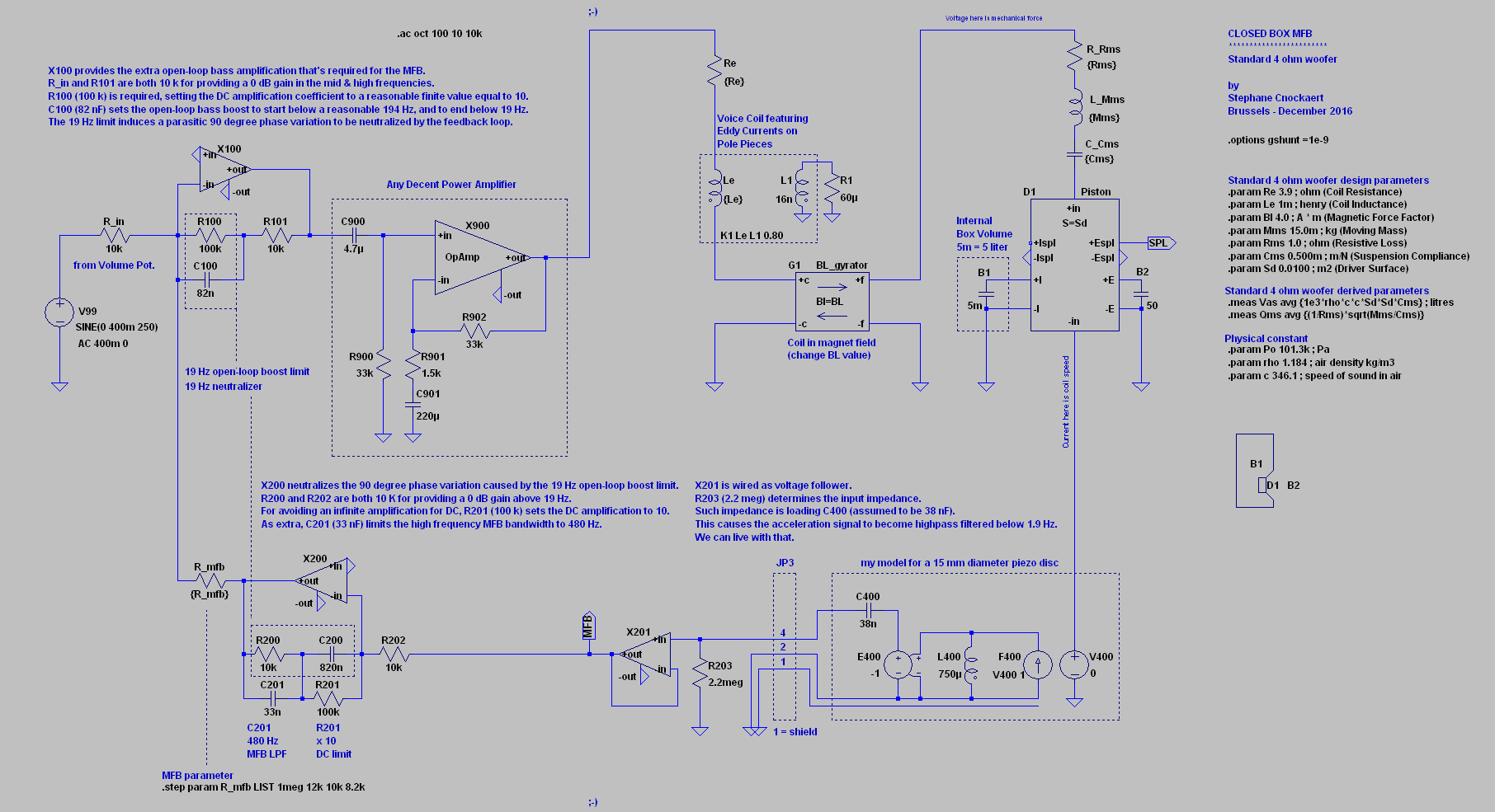

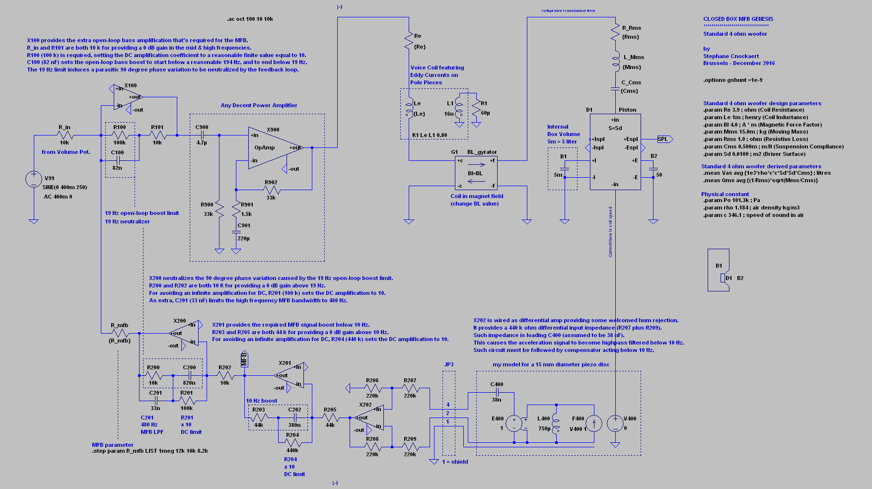

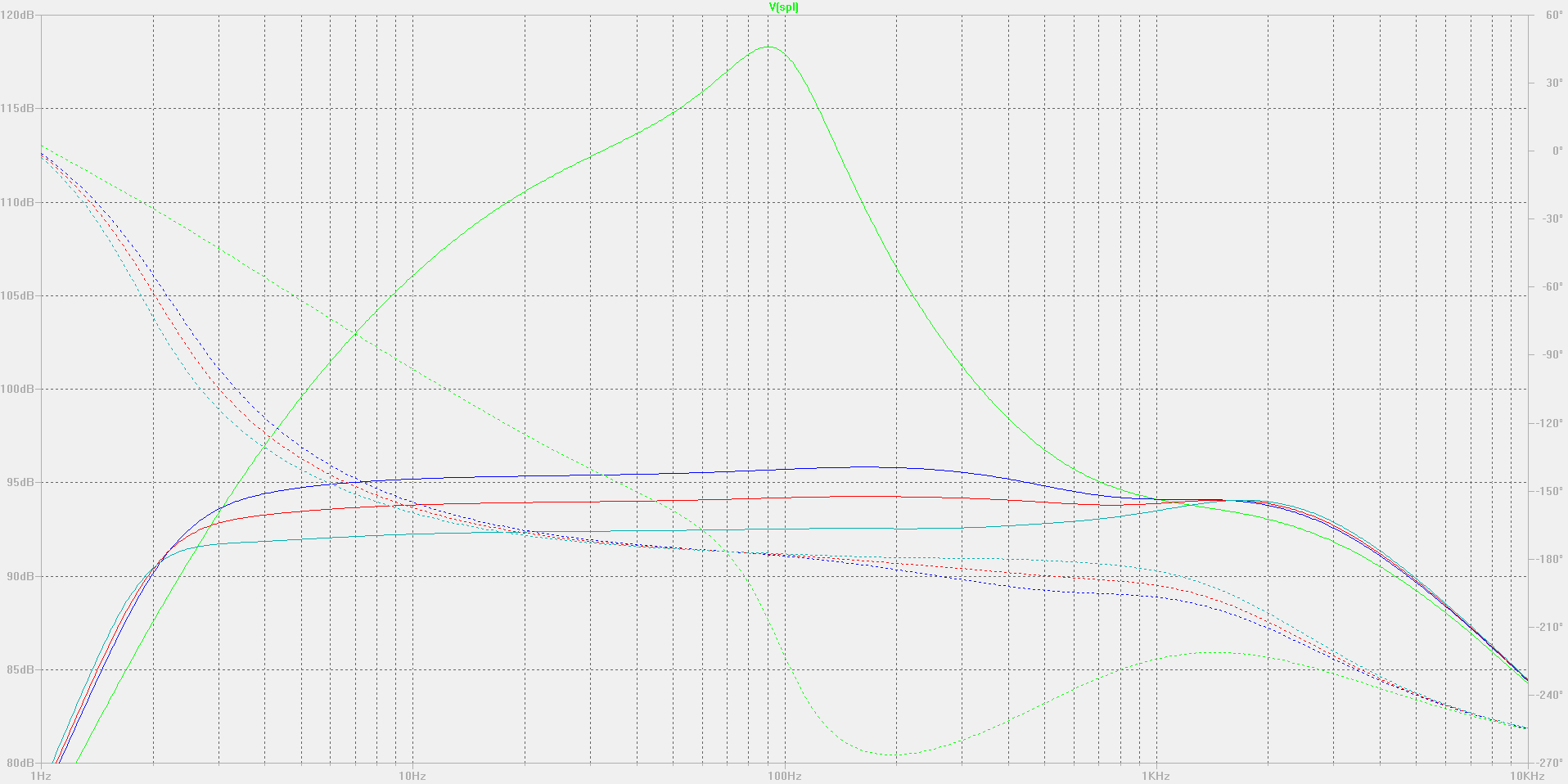

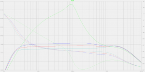

I'm attaching two commented schematics and simulations. I am in search of somebody willing to confront this to the real world. A difficulty is to firmly hook the 15 mm piezo disc without obstructing the pole piece ventilation, and without reducing the Xmax.
Closed Box MFB Genesis (standard 4 ohm woofer) (schema).png111.8 KB · Views: 217
Closed Box MFB Genesis (standard 4 ohm woofer) (curves).png28.3 KB · Views: 121

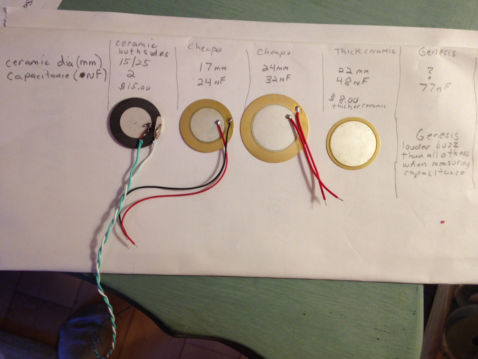

Please see attached photo - I measured the capacitance of a few different piezos, and the one in my Genesis speakers. I must invoke not the Heisenberg's uncertainty principle but something closely related- the observer effect - I am guessing the capacitance values are off a bit due to the process of measuring it (and hearing a buzz while measuring), so values below are approximations.
Left to right -
1. Ceramic 15/25mm on both sides of the disc, and thick (i think these were $15 each); 2nF [mfg. rating: Static capacitance Cs: 1900pF±15%@ 1kHz]
2. 17mm diameter ceramic (cheapo); 24 nF
3. 24mm diameter ceramic (cheapo); 32 nF
4. 22mm diameter thicker ceramic ($8 each); measured 48 nF [ mfg. ratings: Static capacitance Cs: 54nF±15%@1kHz]
5. Genesis measured but not seen, louder sound than all the others when measuring - 77nF.
Bolserst, I am duly impressed with your prediction of the Genesis piezo capacitance being much higher than the one I was using (18nf) - the capacitance of the piezo in the Genesis speaker is 77nF - round of applause for bolserst.
So, this makes me wonder about the size / type of piezo inside the Genesis - how to deduce based on these values and this picture? This diameter looks smaller than 25mm compared to voice coil....unless their woofers have large voice coil (doubt it). Greater thickness? Not legitimate pic or a woofer piezo that has been repaired?

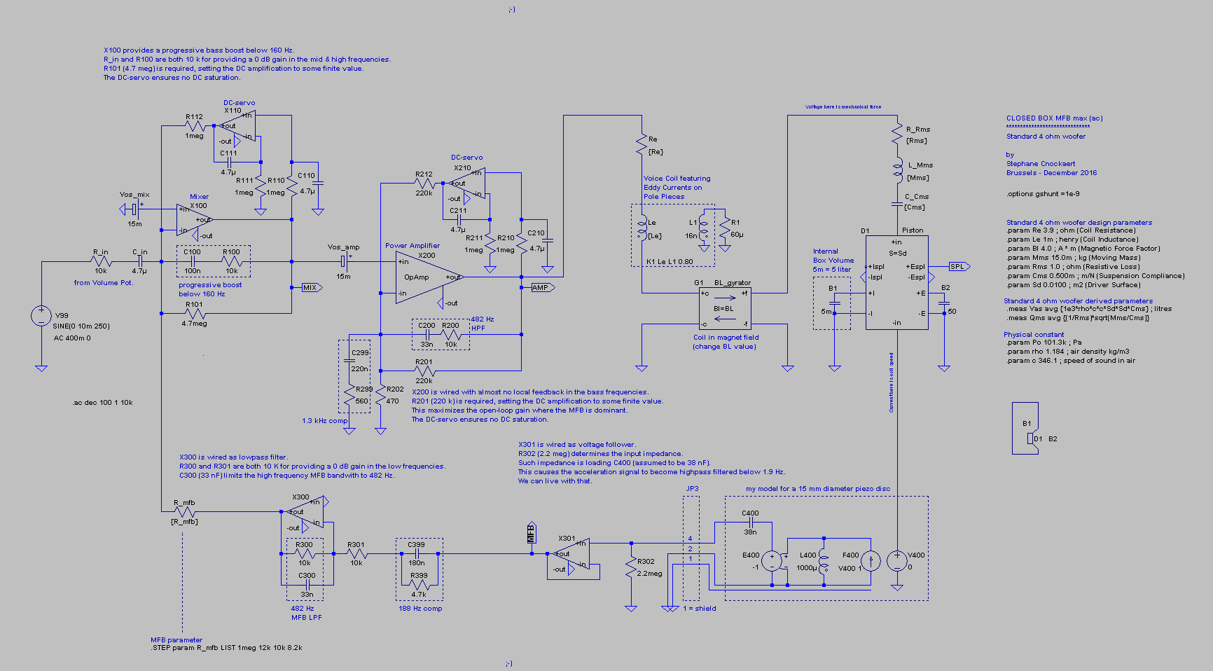

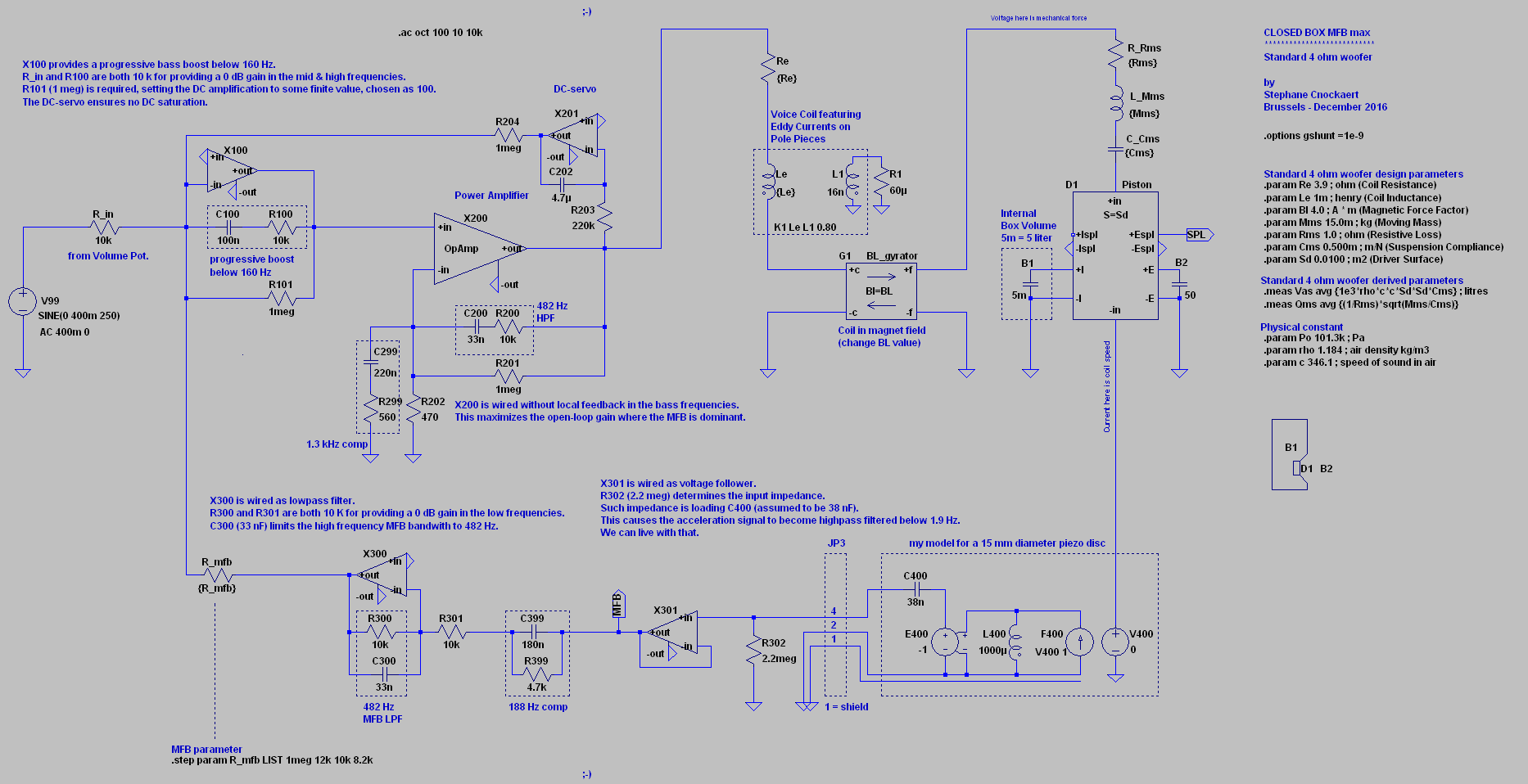

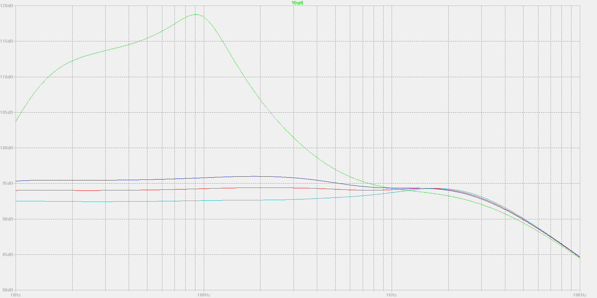

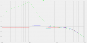

Please tell me your opinion about the attached circuit. The DC-servo is there for stabilizing two amplifiers in series. Hooking the DC-servo this unconventional way solves a major MFB instability issue in the subsonic domain.
Please notice the mixer and the power amplifier, exhibiting plain normal amplification coefficients above 1 kHz. This ensures stability in the high frequencies.
Please notice the power amplifier having no local feedback in the bass frequencies. This maximizes the open-loop gain in the bass frequencies, where the MFB is dominant.
Please notice the mixer providing a progressive bass boost below 160 Hz, ending up with a x100 amplification at 16 Hz. This again maximizes the open-loop gain in the bass frequencies, where the MFB is dominant.
The MFB is dominant below 482 Hz.
There is at least 18 dB of motional feedback from 20 Hz to 145 Hz.
The motional feedback culminates at 24 dB at 90 Hz.
The motional feedback is only 3 dB at 482 Hz, at which point it blends equally with the conventional voltage feedback.
The conventional voltage feedback gets dominant past 482 Hz.
The resulting system frequency response extends from 7 Hz to 3000 Hz.
Such system frequency response fits into a 2 dB corridor.
Make sure the MFB signal has the correct polarity.

Makes sense to me. I had an input coupling cap between the preamp and power amp - so no DC gain, and no DC offset to worry about.The DC-servo is there for stabilizing two amplifiers in series.
Is this instability something you've encountered in practice?Hooking the DC-servo this unconventional way solves a major MFB instability issue in the subsonic domain.
Looks like your loop gain is maximum around 90 Hz . I'm assuming the green line is the open-loop speaker response?Please notice the mixer providing a progressive bass boost below 160 Hz, ending up with a x100 amplification at 16 Hz. This again maximizes the open-loop gain in the bass frequencies, where the MFB is dominant.
This is purely a simulated woofer response, right? Because I see no cone breakup modes, and no sensor resonances, all the way out to 5 kHz.
I only worked with one woofer (an in-house, custom-made one). But that one had a huge spike in the transfer function at 1 kHz, and then several more before you got to 5 kHz.
The heartbreaking part is when you measure in-room response a metre or two away from the woofer, and your lovely +/- 1 dB near-field acoustic curve suddenly develops nasty peaks and dips from room acoustic modes! 😀Such system frequency response fits into a 2 dB corridor.
-Gnobuddy

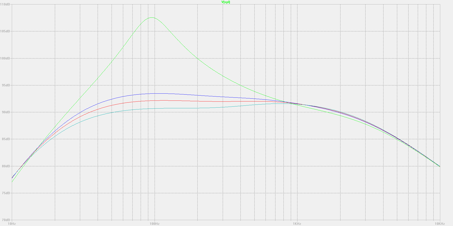

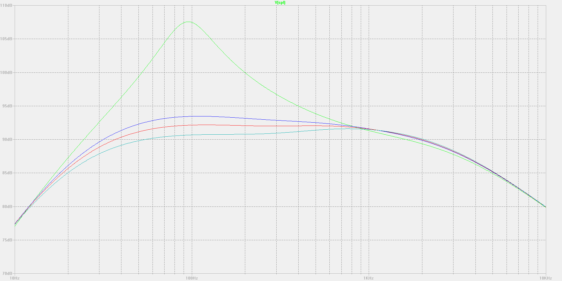

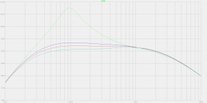

Hi, thanks for your suggestions. Indeed the green line is the open-loop speaker response. Please note, I committed a nasty phasing error in the global DC-servo. The system can't work in real world. What warned me, was the LTspice .tran simulation, constantly outputting Giga volts.Looks like your loop gain is maximum around 90 Hz . I'm assuming the green line is the open-loop speaker response?
Today I have reconsidered the DC-servo arrangement, reverting back to a more conservative "one DC-servo per amplifier" scheme. See the attached files. After carefully tweaking both DC-servo blocks, the LTspice .ac simulation delivers the same outstanding frequency response curve as yesterday. I'm full aware this is only simulation. Like you wrote, I'm not expecting it to deliver such outstanding linearity once in the real world. Anyway, this looks highly encouraging.

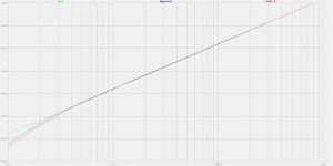

As previously explained, the frequency response curve looks outstanding.
From 7 Hz to 2000 Hz, it fits inside a 2 dB corridor.
Now pay attention to the phase curve.
The phase corresponds to a plain normal 2nd-order highpass inverter, showing a 180 degree phase in the medium frequencies.
Below 20 Hz, the phase progressively goes up by 180 degrees towards the very low frequency, just as expected from a 2nd-order highpass.
Above 1 kHz, the phase progressively goes down by 90 degree towards the high frequencies, just as as expected from a 1st-order lowpass.
This looks ideal indeed.
This time, I managed to successfully run a few LTspice .tran simulations.
They behave nicely. There are no convergence issues, and no Giga volts showing. This is another encouraging sign.

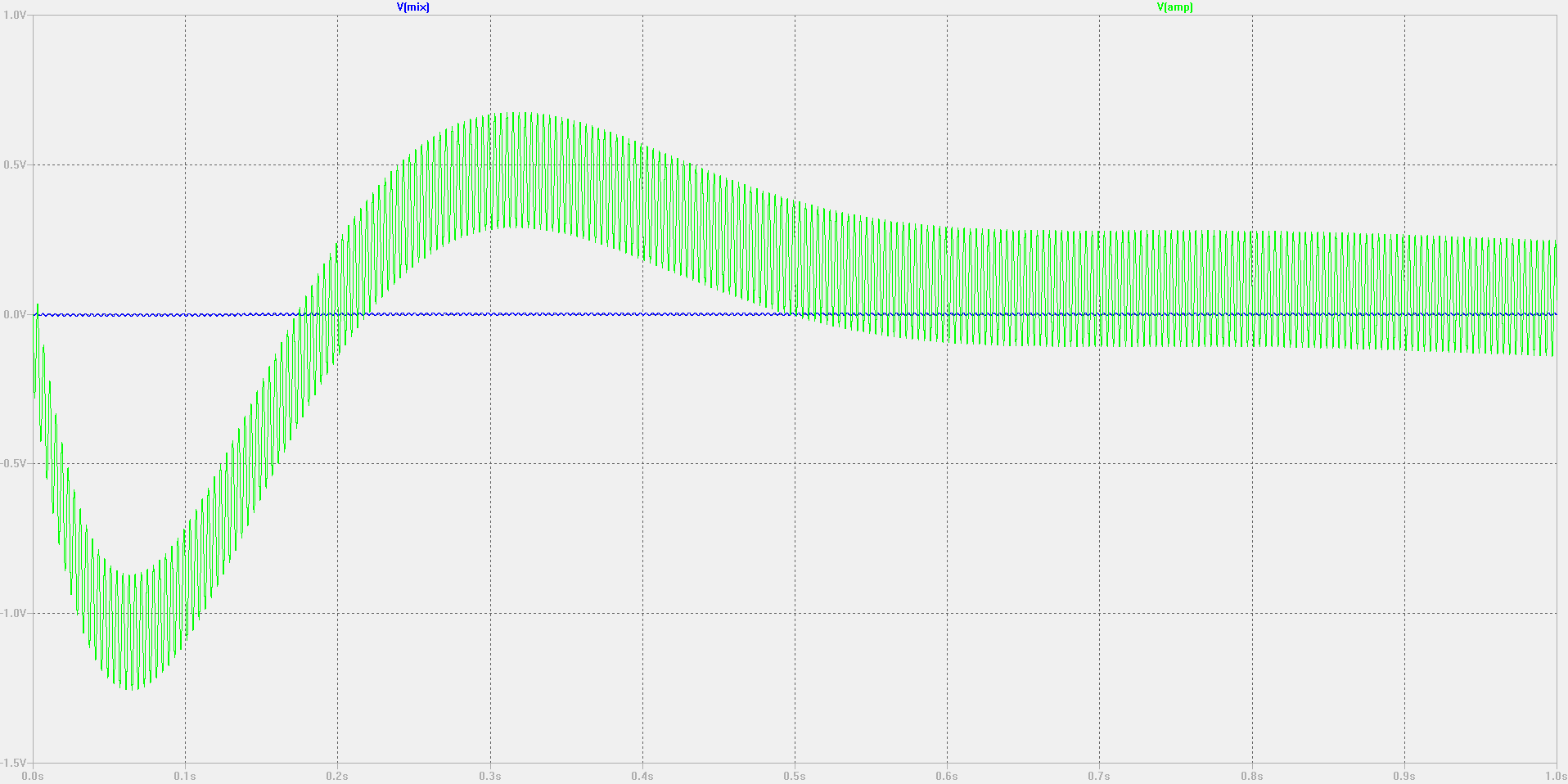

I checked the settling time at power-on, graphing what's happening when the system comes alive while receiving a small audio signal at the input.
I plotted the Mixer output voltage, and the Power Amp output voltage.
The settling is slow (in the order of one second), and this is normal, coming from a electro-acoustic system exhibiting such low frequency extension. There is nothing to worry. There is no DC saturation, no high frequency oscillation.
I also plotted the DC voltages at the outputs of the two opamps doing the DC-servo. They stay withing the power supply limits, even when considering a Mixer opamp and a Power Amp exhibiting DC offsets as high as 15 mV (input referred).
Most modern audio opamps exhibit less than 2 mV as offset (input referred).
You need FET-input opamps, as in this present schematic, they get surrounded by high value resistances, especially the opamps doing the DC-servo (1 meg), the opamp serving as Mixer (4.7 meg), and the opamp that's buffering the piezo sensor voltage (2.2 meg).
The Power Amp may feature a bipolar transistors input stage, as in this present schematic, the DC impedance around the Power Amp inputs is quite low. We have 470 ohm at the inverting input, and possibly also 470 ohm at the non-inverting input in case one adds a 470 ohm resistor in series with the Mixer output. It is thus low impedance, and possibly balanced.
Therefore, one may try a LM3886 as power amplifier, provided the chip exhibits an offset that's less than 15 mV (input referred). The NS datasheet says 10 mV max, with a DC polarization current that's 1 µA max. Looks good indeed.
