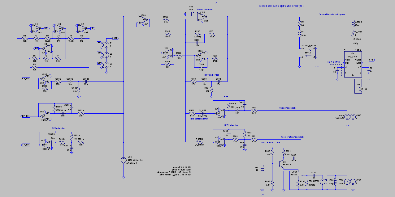

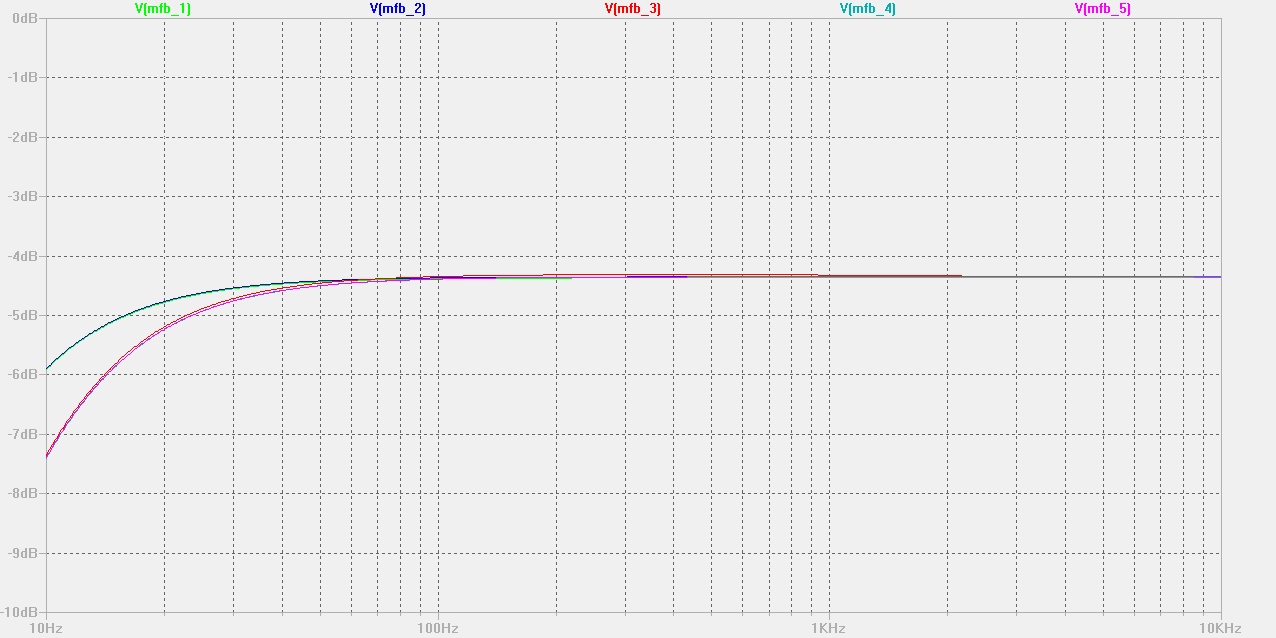

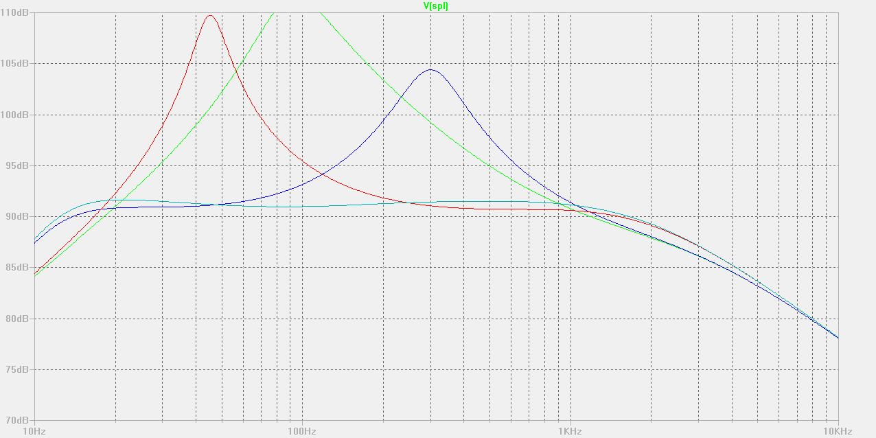

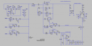

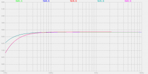

During some time, french manufacturer Cabasse made servoed loudspeakers with a combination of feedbacks from a velocity bridge and from a piezo acceleration sensor.
Cabasse VTA series if I remember. I sketched something like this on diyAudio on post #38 on http://www.diyaudio.com/forums/solid-state/166061-philips-motional-feedback-mfb-4.html#post4909822.
20 dB feedback at 100 Hz (distortion divided by 10 at such frequency)
12 dB feedback between 54 Hz and 195 Hz (distortion divided by 4)
6 dB feedback between 35 Hz and 360 Hz (distortion divided by 2)
Using a Vifa P17WJ-00-08 speaker that's exhibiting no cone breakup, the frequency response could fit into a 2 dB corridor from 12 Hz to 1700 Hz. This will be hard to measure, as practically nobody owns a calibrated measuring mike able to cope with such level of performance.
For not exceeding the Xmax of the speaker, you need an adaptive (variable cutoff frequency, from 20 Hz to 100 Hz) 2nd-order highpass filter governed by a cone instantaneous excursion estimator, that can be a time integrator hooked on the velocity signal.
In the context of an extreme-quality 2-way bookshelf speaker, there is a good match possible with one of those 800 Hz capable dome tweeters from TangBand having a rear chamber. Max height 33 cm (Ikea Kallax series).
What kind of 8-pin opamp would you recommend?
What kind of power amplifier would you recommend? A Kuroda structure, having a 8-pin opamp as front-end?
BJTs, lateral MOSFETs or vertical MOSFETs as power output devices?
Class-A, non-switching class AB, conventional class AB?
Crossover can be a passive Linkwitz-Riley 4th-order.
The woofer and tweeter phases will be synchronous, however the global phase will be damaged (distorted). Consequently, the polar diagram will be good, however the impulse response won't be good.
Crossover can be an active Linkwitz-Riley 4th-order.
Two power amplifiers.
Crossover can be digital, basing on two FIR filters.
The slopes can be anywhere between 3rd-order and 4th-order, the woofer and tweeter phases will be synchronous, and the global phase will be preserved. Consequently, the polar diagram will be good, and the impulse response will be perfect.
Anybody wanting to experiment this with me?

Ah, I see where this is going. Curiously, it goes back to the very thing I've been harping on all along: goals. Different MF concepts are differentially suitable (by Leibniz or by Newton) to different parts of the sound compass. At higher frequencies, to obliterate hearable distortion. At lower frequencies, to obliterate the large resonance, without cutting distortion all that dramatically.
Indeed, if you wanted to make an extremely great two-driver little box, you might do just what steph_tsf has explained as the Cabasse approach. I never think about MF except for subs, but I see how Cabasse (and some of the wise persons on this thread) might think about producing great sound north of 120 Hz.
About Hombre's experiments with a piezo gizmo, might be great fun experimenting with a 10-cent crystal to make a $200 driver sound better (or if you are Philips, to make a $20 driver sound better). But in the DIY world, why not get an ACM accelerometer with spectacular specs for $25 on eBay?
Not easy to work with piezo crystal because of the challenging parameters involved. The device has very large resistances and impedances which might slip hither and yon with frequency. Then you are playing the crystal into a device with an input impedance that may be hard to characterize too. Phase on an oscilloscope doesn't need much prodding to start wandering about. Which what I think Hombre might be finding as an artefact of measurement.

There is the post #35 on http://www.diyaudio.com/forums/solid-state/166061-philips-motional-feedback-mfb-4.html#post4909822 about this.
Perhaps you will recognize the MFB_4 section as the charge-mode amplifier, with X400 as opamp, and X401 as acceleration-to-velocity converter (a time integrator).
The velocity output only serves for checking the time integrated piezo output (supposed to be cone velocity), against a Voight bridge output (also supposed to be cone velocity).
All opamps need to be TL071 or TL072 opamps. They feature JFET inputs exhibiting very low polarization currents, and very high internal impedances.
I made the assumption that the piezo disc exhibits a 2 nF capacitance. Such order of magnitude should be valid for the tiny 3 x 3 mm piezo square used by Philips inside the RH532 MFB, RH541 MFB, RH544 MFB, RH544 MFB, RH545 MFB etc.
One should experimentally determine if a 15 mm piezo disc exhibits a significantly large capacitance, say 10 nF or more.
You will recognize the MFB_5 section as the plain voltage mode.
The piezo element is loaded it by a 10 meg ohm resistor followed by an opamp (X500) used as high impedance voltage follower.

  • Piezo acceleration sensor interfaces (comparison) (ac).asc
