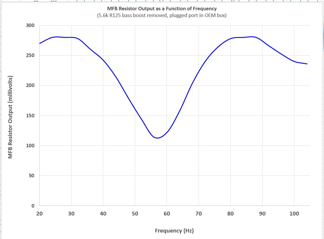

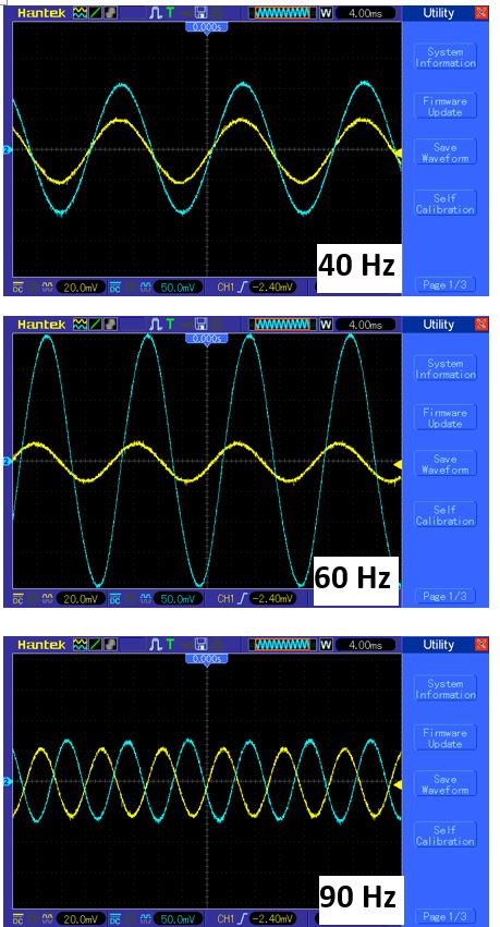

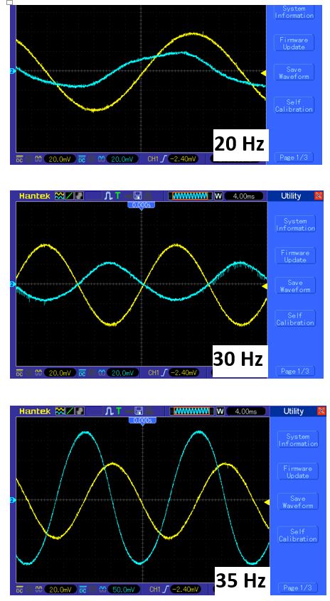

Per Bolserst suggestion: The 5.6k Ohm SMD resistor (+6dB bass boost @ 40 Hz) has been removed (quite skillfully I might add🙂)
Scope snapshots taken 20, 30, 35, 40, 60 and 90 Hz. Plugged port, without 5.6k Ohm bass boost resistor.
Blue Trace - piezo direct into oscilloscope
Yellow Trace - reading across MFB resistor.
Similar readings taken running piezo output through my buffer + integrator noisy circuit (data not shown).
Concerns:
1. Phase shift seems to go through 180 over short interval in frequency relative to MFB output. Running piezo signal through circuit just seems to shift everything but still goes through seemingly at least a 180 phase swing from 20-60 Hz. I guess I could say - "Gnobuddy" warned me.
2. Piezo output from 20-28 Hz pretty low, although I think this easily fixed by adding a bit of weight similar to what I had a couple weeks ago in my first rendition, or changing mounting mechanics.
As Steph_tsf suggested in earlier post, one may be able to modulate the piezo response mechanically by adding a bit of weight or even a drop or two of glue.
Note the changes in amplitude of piezo vs MFB as function of frequency.

I am wondering if someone would be kind enough to explain why I am seeing the phase shift of the piezo output vs. the MFB output as a function of frequency, particularly in the range of about 25-45 Hz - woofer in box with plugged port or woofer out of box - still seems like at least a 180 phase shift - I do not understand. I would think only the amplitude would vary...is the MFB resistor output not really measuring woofer movement? Is the MFB resistor just acting like a voltage divider and sending a small part of the output signal back to the pre amp mixer?
I understand that the woofer has a natural roll off, but I do not understand the phase shift of the piezo vs MFB outputs. Any thoughts / insight appreciated.
