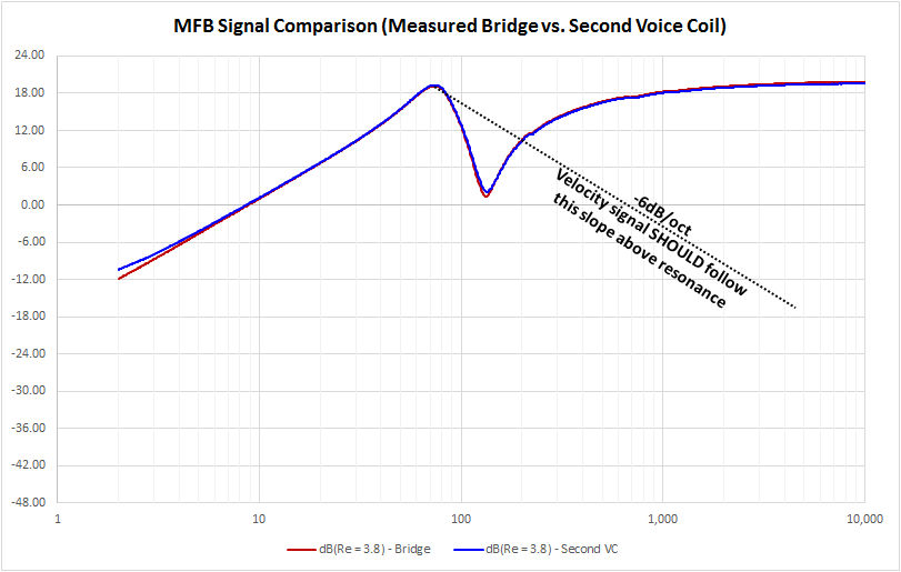

Post comparing measured velocity signals from bridge and 2nd voice coil methods, showing signal “contamination” from inductance and temperature variation.

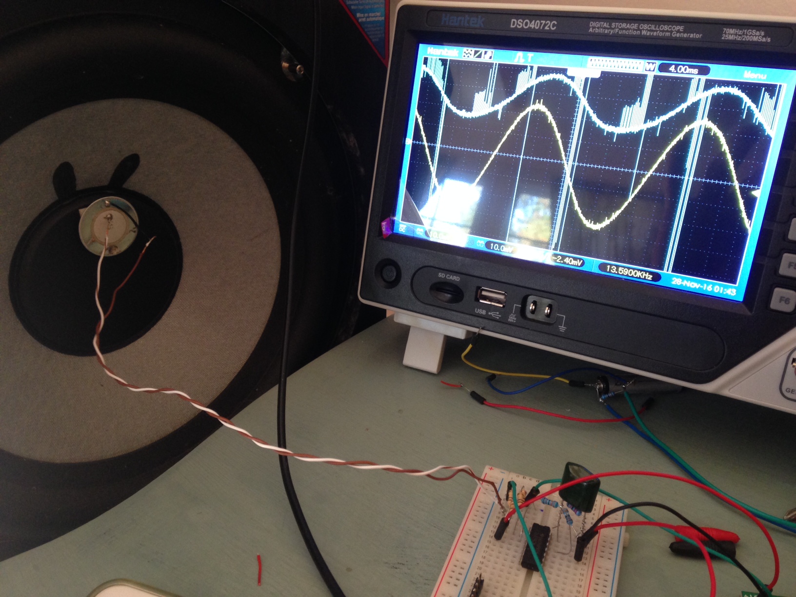

3, 4, & 5 do not in any way avoid instability problems.…the way I have mounted the piezo on the firm dust cap of the Sony W2500 and subsequent testing at low volumes is not a problem or concern to me. Why not?
1. The dust cap is sturdy.
2. The piezo is very light - < 2 grams
3. I am testing at low volumes.
4. Testing at low frequency so no or low decoupling.
5. The band pass built into the Sony preamp really obviates any high frequency of significant amplitude getting to the woofer / piezo.
6. As demonstrated thus far, the output waveform from the piezo looks very good.

Agreed. This is exactly what I was showing in Post#209. In addition, I was trying to show that the signal from the resistive bridge arrangement is corrupted above resonance in exactly the same fashion. The reason being that the same inductance that unbalances the bridge forms a voltage divider with primary winding resistance of the DVC “transformer”, basically forming a HP network for the signal mutually coupled to the sensor coil. I took the first plot from Post#209 and sketched in what the velocity signal SHOULD look like if there was no mutual coupling, or inductance unbalancing the bridge.… the problem here is that, given their physical proximity, the two coils also act as an audio transformer. The coil that's supposed to sense cone velocity, therefore, also has its output signal corrupted by the drive current through the primary voice coil.
I try my best to just let the data do the talking.Now some of my qualitative suspicions have been confirmed by your quantitative measurements.

The voltage induced into the second VC is affected by all the nonlinearites that affect the inductance of the driver while in motion. But, the biggest problem with the inductive coupling is that above resonance where the back-EMF signal is falling at -6dB/oct it is increase by +6dB/oct and quickly becomes the dominate voltage coming from what is supposed to be a velocity sensor. The velocity signal is completely corrupted and no longer proportional to velocity. The best approach is to use drivers that have a very low inductance to resistance ratio. This pushes the onset of signal corruption up in frequency... while harmful to have inductive coupling in a DVC sensor. But how unlinear is that coupling? Can it be remediated using a bridge?
Unfortunately, a bridge is not a remedy.
Remember the measurements in Post#209 show that DVC and bridge sensors are similar corrupted.

Based on GnoBuddy's suggestion about using an integrator to shift the phase shift of the piezo - here is what I think I made - piezo --> difference buffering op amp --> integrator op amp. Snapshot is @ 40 Hz - Lots of noise spikes (BLUE TRACE) but now fairly in sync with the output from the MFB resistor (YELLOW TRACE. [Scale Blue - 50 mv/div; Yellow - 20 mv/div]
My concern (besides the noise spikes) is the piezo output wave still seems to invert, or at least shift significantly sweeping from say 24 Hz to 40 Hz... hmmm?
I think I should take the woofer out of the box...I think the port / woofer / back pressure / resonance interplay are obfuscating the results.
Once I..and when I say I, I am implying the much more erudite posters on this board, make suggestions to help me get this fixed -
Here is what I am thinking - still thinking...I just incorporate the integrator into Sony's MFB circuit...specifically IC201 (2/2) buffer (see attached figure below)...seems IC201 (2/2) is just sitting there waiting for me to slap a resistor and capacitor in parallel from output to inverting terminal (making proposed integrator in situ) instead of the direct connection that is there now.
Hombre - I confused myself briefly earlier in the thread, as to where exactly the integrator goes. In the process, confused everyone who paid attention to my posts, as well.

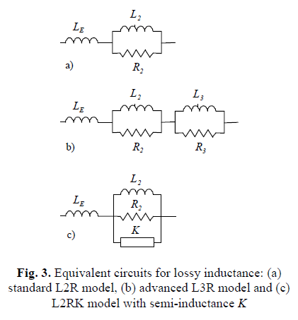

That strategy works in theory, and is documented in several patents. However, since woofer inductance is rather lossy(phase angle closer to 45deg than 90deg) you need to include some resistance in series with the capacitor to improve the compensation. I found to get good compensation for 4 octaves or so, I needed to use the L3R model shown in attached pic for the woofer lossy inductance. Compensation required three cap-resistor pairs in parallel with the lower arm of the bridge. All worked well at lower excursion levels. At higher currents and excursion levels the inductance of the woofer is modulated and you could see the bridge going cyclically in and out of compensation.I have a hunch that a strategically sized capacitor in the diagonally opposite arm of the bridge might compensate for the voice coil inductance (at least to first order).
Lossy Inductance model pics taken from:
http://www.artalabs.hr/papers/mateljan-ela-02.pdf
Other papers of interest on modeling woofer lossy inductance:
http://www.bnam2012.com/papers/Thorborg_31.pdf
http://www.bnam2012.com/papers/Thorborg_32.pdf
Improved Blocked Impedance Model for Loudspeakers
BTW, I just noticed that ScanSpeak has started providing the lossy inductance modeling parameters at the bottom of their woofer spec sheets. Nice!

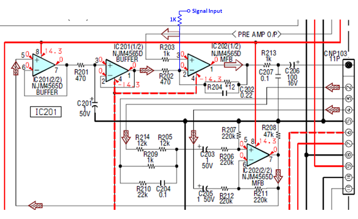

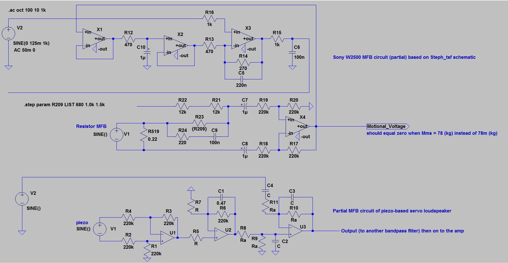

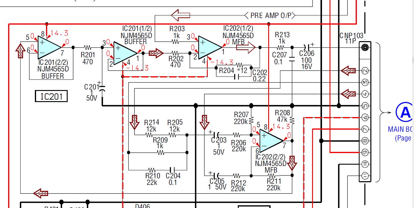

I have created my first schematic in LTSpice (based in part on Steph_tsf's post with Sony schematic to try to illustrate my thinking about using existing Sony MFB circuit to condition the piezo circuit. In the below schematic, I compare the Sony MFB circuit to the circuit on the preamp from my servo loudspeakers that I have tried to figure / trace out (some values missing so far). I am a bit rushed for time but wanted to get this posted before I leave. I also offer my totally amateur rendition of what I think some of these components are doing. My parlance may be incorrect but here goes:
1. MFB resistor output into X4 op amp circuit (sony circuit - top) - this looks a whole like the piezo output (servo circuit) into U1 op amp circuit. Heck, they are even using the same resistor values (220k ohms). I guess this arrangement is called a difference amp / signal buffer. Does this double the signal output from the MFB resistor / piezo because simultaneously comparing the + and - output, or just a 'gain' of 1.0 based on R values?
2. Op amp U2 of servo circuit looks like the 'integrator' to me. Also looks like a filter to attenuate higher frequencies. This is the circuit I would like to build on X1 op amp (just a buffer) of Sony circuit.
3. U3 op amp (servo circuit) (Ra values all the same) and X3 op amp (Sony circuit) look like the mixer / difference op amp + integrator / high frequency filter to me.
It is the above similarities that still lead me to believe this "Plug and Play Piezo" (TM) to servo bass bliss is possible using the in situ Sony circuit add the integrator to X1?
Rebuttals?
