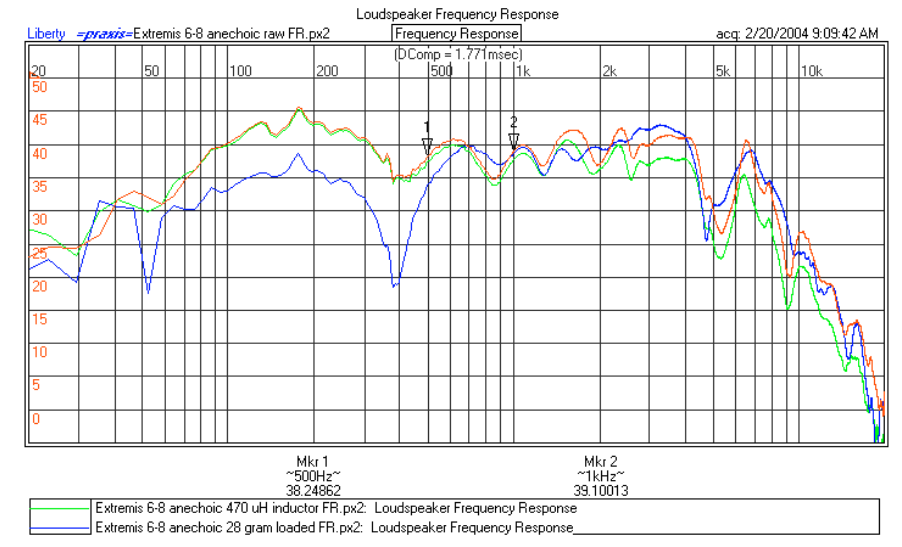

Notice their statement about how they added the mass:
“- Added mass was 28.5 grams (Mms of the Extremis 6-8 is 24.39 grams per Klippel).
Mass added to dustcap only; none was placed on the cone itself (all within the diameter of the former).”
Then look at the frequency response comparison shown on the last page: (attached for convenience)
You can see that at low frequencies the added mass has decreased the SPL by the expected amount, but at high frequencies the SPL is nearly unchanged...with a notch separating the two regimes. Looks like the mass mounted on the dust cap “decouples” from the motion of the VC and cone above 500Hz. Since the high frequencies that define the leading portion of the impulse response, this explains the impulse time histories.
BTW, this is exactly the same problem you run into when trying to mount an accelerometer on the dustcap. The only difference is that you will be dealing with higher frequencies since the mass of the sensor will be less.

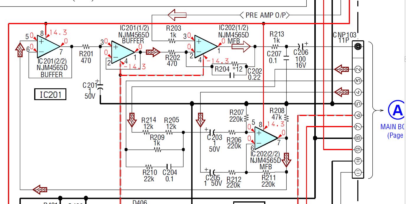

My next hurdle is the electronics. I was hoping to get some 'feedback' 😀 on my small simulation of the Sony sub circuit - simple as clicking the link in my previous post. I think I can pipe in the piezo output into the Sony MFB circuit (with some minor mods) in lieu of the feedback from the MFB resistor - but would like to hear reasons why this wont work.
Why I think this has potential to work (coming from a neophyte who only has limited circuit analysis understanding from watching youtube videos):
1. The unconditioned waveform from the piezo looks similar to the waveform from the MFB resistor, varying in amplitude and phase.
2. Looking at the Sony MFB sub circuit, it appears to have in integrator already built in (IC202). I also think this is a difference amplifier ?
3. I have a spare dead pair of Genesis servo amps - looking at their circuit, it appears to have: piezo -> difference / buffering amp -> integrator/filter -> differential amplifier where the preamp signal comes in and mixes with the piezo input. 3-op amps.
4. Recalling Paul McGowan's post summarizing this (3 parts) is what it took to get their servo system working.
5. I would like to know where pin 3 goes on the Sony sub circuit..is that ground?
Unfortunately, I can't tell much from that simulation. To actually design a servo system from scratch, you really need both the gain/frequency plot, and the phase/frequency plot, of the entire system (amp, speaker, piezo, piezo electronics). And then you tweak the whole thing so it gives you negative feedback, and no phase problems in the passband (region where loop gain is greater than unity.)I was hoping to get some 'feedback' 😀 on my small simulation of the Sony sub circuit - simple as clicking the link in my previous post.
As a loose analogy, the process I just described is like a dressmaker measuring a customer, and then tailoring a custom-fit wedding dress for her.
What you're proposing, on the other hand, is a little bit like asking "My grandma was 5' tall and weighed 80 lbs. I still have her heirloom wedding dress. Will it fit my niece, whom I haven't seen in 20 years, and who is planning to get married soon?" 😀
And I would say "The odds are against you, my friend, but you never know till you try!"
Why not try the wedding dress, sorry, experiment, and see? I think the experiment might be illuminating.I think I can pipe in the piezo output into the Sony MFB circuit (with some minor mods) in lieu of the feedback from the MFB resistor - but would like to hear reasons why this wont work.
I would take a couple of preliminary steps first, though, to prevent damaging anything if things go badly. Then, just connect it up, and find out for yourself what happens!
Protective step #1: put a power resistor between the speaker and amp output. Say 47 ohms, and rated for a watt or two. If your servo goes violently unstable, the resistor will protect the woofer and amp by drastically limiting power delivered from the amp, and to the speaker. At worst, the resistor itself will smolder to death, but resistors are cheap!
Protective step #2: put a pot between the output of your servo conditioning electronics, and the place where the negative feedback signal is mixed with the input signal. With the pot at zero, there will be no feedback whatsoever. As you turn up the pot, you add motional feedback. If the amp takes off and oscillates, quickly back off the pot, while that 47 ohm resistor takes the heat (literally).
Now, with the 47 ohm resistor in place, you have drastically cut the loop gain; if the woofer is nominally 4 ohms, you've effectively inserted a voltage divider in the loop that cuts the signal by a factor of roughly thirteen times. If the woofer is 8 ohms, you've cut the loop gain by a factor of seven times.
In either case, you must make up the deficit by adding extra gain in the feedback loop; temporarily put in a non-inverting opamp stage with a gain of x13 (four ohm case) or x7 (8 ohm case). The opamp must be connected to make your feedback piezo signal bigger, before it's mixed with the input.
I would also add a pot that lets you control feedback signal amount from zero to full; you will have zero feedback at one end, and full (maybe too much) feedback at the other.
With all this done, set the feedback pot to zero, close your feedback loop, and power up. With zero feedback, everything should remain stable.
Now feed in an audio signal of suitable frequency (middle of woofer passband). Monitor woofer voltage - it will drop as you add negative feedback, if everything works properly. Gradually dial up your feedback pot; paying attention to the woofer voltage as you go.
One of two things will happen:
Possibility one (the dress fits your niece, after all): Your woofer signal will fall by "x" dB, where "x" is the amount of negative feedback you've always dreamed of having in your MFB system. Success! You can now power off, remove that extra x13 or x7 gain stage, remove the protective 47 ohm, drop the feedback pot back to zero, and power up again. Once again increase feedback until you have your "x" dB of gain reduction. Done. Celebrate. Enjoy the new MFB system.
Possibility two (the dress doesn't fit): As you turn up the feedback pot, and long before you get to your "x" dB of signal reduction at the woofer, the electronics bursts into oscillation. The 47 ohm resistor smokes, while you rush to turn the feedback down to zero as quickly as you can. Ouch. The old Sony electronics won't do the job, and you have to design the servo electronics from scratch.
Well, at least you're no worse off than before, once you remove that smelly, slightly burned 47 ohm resistor!
-Gnobuddy
