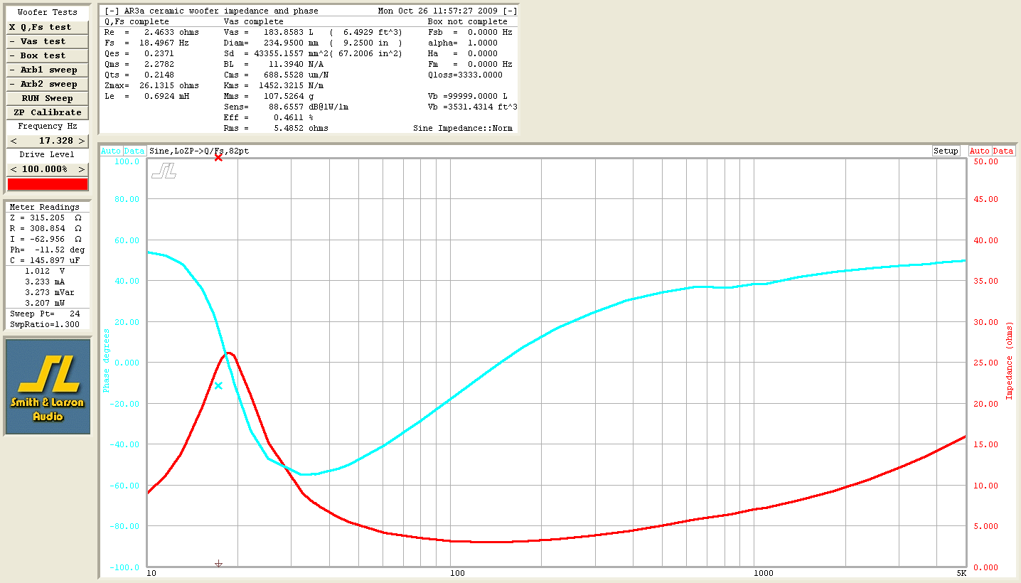

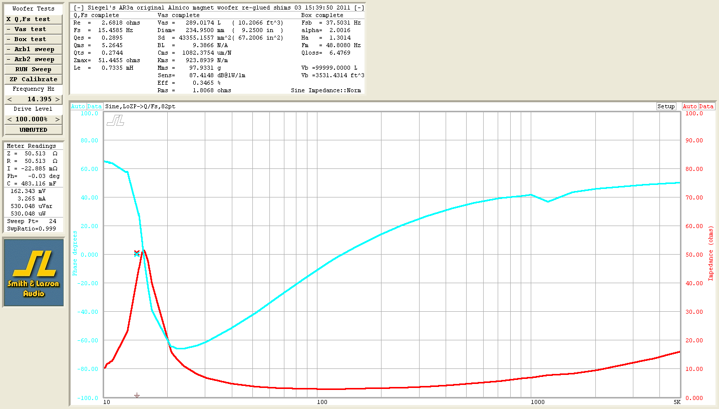

Commercial motional feedback woofer available sort of
