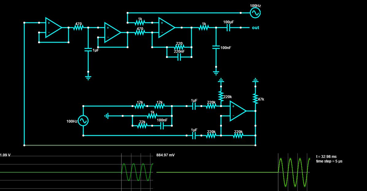

Thanks for the spreadsheet - Excel is incredibly powerful & the more one learns about it the more one realizes how almost limitless it is.
I dont know if this link below (yes, it is long - just copy and paste) is going to work but I have tried to recreate at least a portion of the Sony MFB circuit (no where near as detailed and elegant as Steph-tsf's simulation but condensed down to something I think I can sort of understand). The link below should be the simulation, shown in this pic is what is should look like in the browser.
I am not sure if the ground I have (lower left next to 100 Hz input) that goes to Pin 3 (A) of main board is ground or something else. If someone wants to check and make corrections and repost new link that would be great.
The lower left 100 Hz input signal is what I think would be coming from the 0.22 Ohm MFB resistor based on my previous scope measurements (ball park) - I was thinking still it may be possible to pipe in the piezo output here with the goal of getting deeper and tighter bass.
The upper right 100 Hz signal is what I think would be coming in from the preamp, before being combined with the MFB signal.
Right clicking on the components allows one to change values, phase, etc. The virtual scope on the bottom can be removed and different parts of the circuit can be view on the scope just by right clicking on the circuit pathway wherever you would like to observe.
Thoughts, corrections & critiques invited.
NOTE: WORKS BEST IN CHROME, IE tends to crash.
SONY MFB SUBWOOFER SUBCIRCUIT
http://tinyurl.com/hmu7ev2
