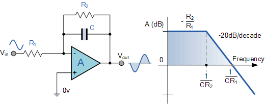

A low pass filter has finite gain at DC. A true integrator has infinite gain at DC…not very practical in analog electronics run between +/-15v rails. When implementing it some resistance is added to limit the gain at low frequencies. So, a first order low pass filter can be thought of as an integrator with limited low frequency gain. Generally the distinction that is being made when using the term integrator rather than low pass filter is that the frequency range of interest lies above the knee in the curve on the -6dB/oct sloped portion. When using the term low pass filter, this usually indicates that you are interested in the frequency range below the knee in the curve where the response is flat....what is the difference between an op amp integrator circuit (see attached on example) and an active Low Pass Filter? They look similar to me.

Doesn't an integrator result in a 90 degree phase shift? According to my knowledge of math, an integrated sinus results in a co-sinus...In thinking of what will be needed to pipe the piezo output into the Sony W2500 preamp circuit - one (of myriad) things I am confused with - what is the difference between an op amp integrator circuit (see attached on example) and an active Low Pass Filter? They look similar to me.
Bentoronto - thanks for the tips. I was rushed last night and wanted to post something - in my excitement I just took some quick snapshots without optimizing the appearance. Do you know - is it possible to capture a sweep function output on this basic oscilloscope? Could I say run a sweep from 28-150Hz and capture output on the scope? This would give a clear indication of voltage output / frequency dependence.
Bolserst - thanks for elucidating the difference between integrator and low pass circuit.

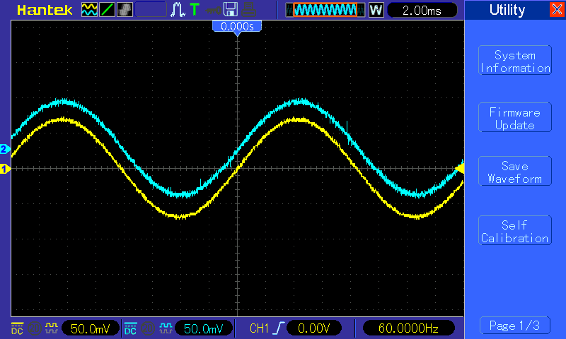

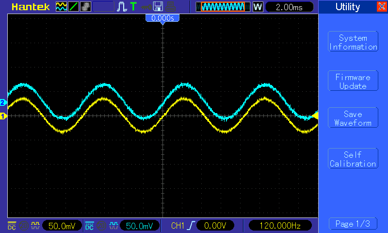

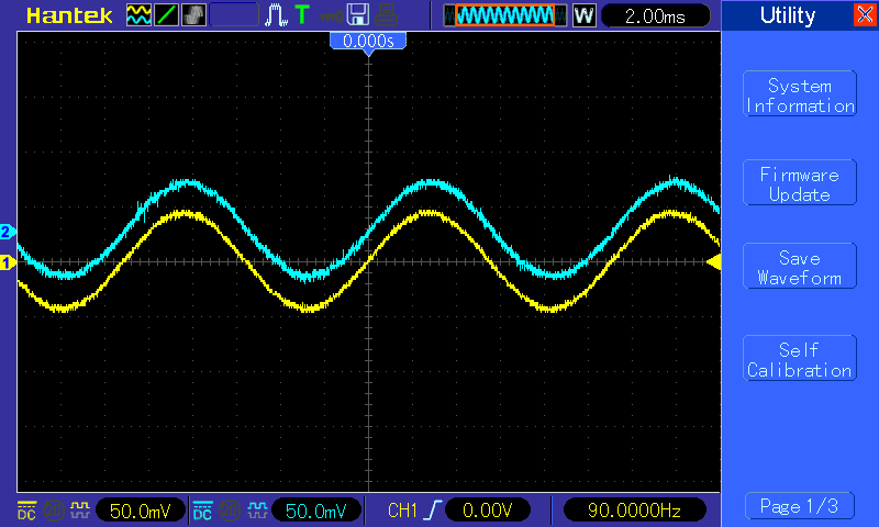

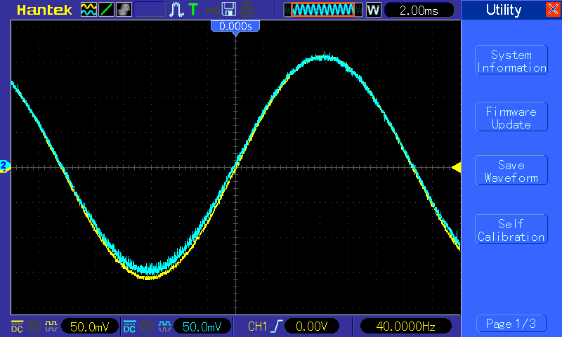

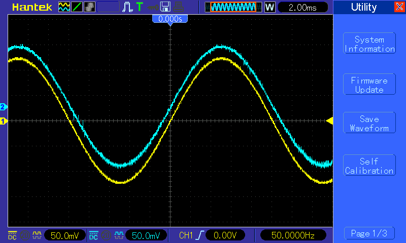

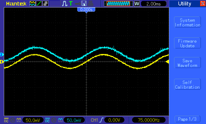

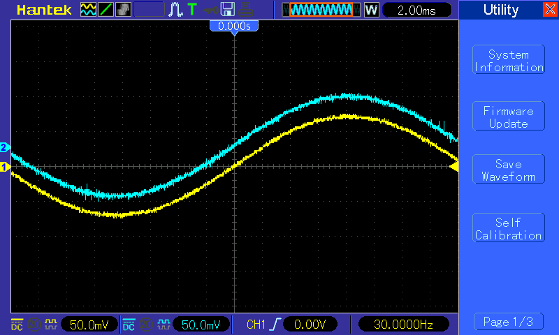

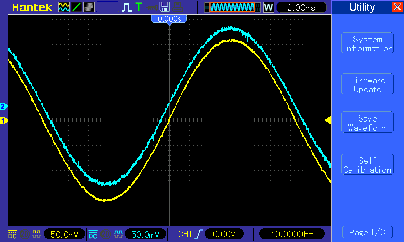

Plots of measurements of voltage across MFB resistor vs. input signal at various frequencies.
Caveat - I am not sure about this data as I wonder if there is some crosstalk from Channel 1 to Channel 2? The signals seem too close in phase? Is this possible? I tried two different signal input sources - from ipod and nice laptop with decent sound card with similar results.
per Bentoronto's suggestion, I tried to get 1-3 wave cycles on the screen.
CONSTANT VOLUME (INPUT AMPLITUDE FIXED)
Driver mounted in OEM box.
BLUE TRACE - Input signal into Sony W2500 (seems noisier than before..must be my set up / cables?
YELLOW TRACE - Readings across MFB resistor.
30Hz
40Hz
50Hz
60Hz
75Hz
90Hz
120Hz
Zoomed in / overlayed 40Hz

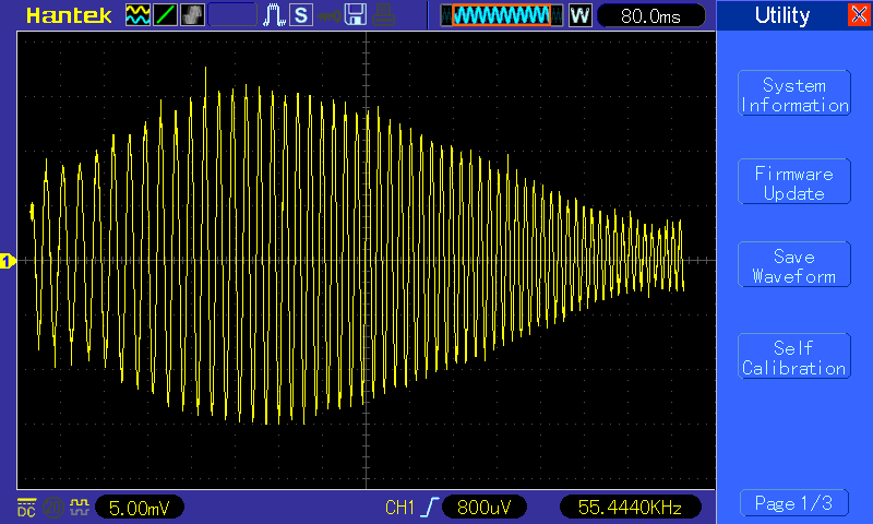

Not sure I did this correctly but tried to catch a snapshot of a 30-120 Hz log sweep across the scope (measured across the MFB resistor)

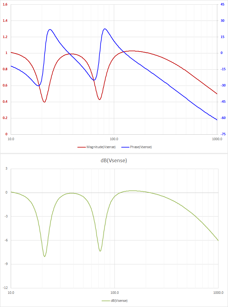

Measured voltage across the 0.22 ohm sense resistor should give a signal that looks somewhat like the mirror image of the impedance curve. With driver mounted in OEM box, the impedance has the usual double peaks surrounding the dip at port tuning frequency. Attached is the trend I measured(top plot magnitude and phase, bottom plot dB). At the impedance peaks on the SA-W2500 the sense voltage should drop to a bit less than half of what you have at the impedance dip at tuning ( ~ -8dB). You are correct that the phase should also shift around at different frequencies as you move through the peaks and dips. I’m not sure why your steady sinewave measurements are not showing this trend. The log sweep does appear to be showing the correct trend, although you need to expand the sweep range to fully show the trend. I would recommend using one of the free PC based measurement tools (REW, HOLMImpulse, etc) to get a better understanding of the frequency and phase response. It will be difficult to complete your project without this information.Plots of measurements of voltage across MFB resistor vs. input signal at various frequencies. Caveat - I am not sure about this data as I wonder if there is some crosstalk from Channel 1 to Channel 2? The signals seem too close in phase? Is this possible?...Driver mounted in OEM box.
I should have some time later today to post the step-by-step measurements for what to expect when you do start closing the loop. It should help you better understand what type of measurements will be useful along the way.
Are you saying your feedback loop was operational (ie open loop gain > 1) all the way up to 1kHz? If so, that was quite an accomplishment. You previously mentioned using an integrator in the forward path for phase compensation. That technique works great for subwoofers, but with < 20dB feedback factors usually limits the upper bandwidth of correction to 2 – 3 octaves above woofer resonance…200Hz – 400hz. Response rolls off -6dB/octave above that point due to the integrator; a little more steeply depending on VC inductance.…I was thrilled when I finally knocked down enough gremlins to get that beautiful ruler-flat close-miked frequency response from nearly 10 Hz to nearly 1 kHz.
The always-wonderful charts and advice from bolserst tell a lot. But, the wild "classical" bass-reflex cone motion revealed in the charts still differs from even more wild acoustic output from a BR box.Measured voltage across the 0.22 ohm sense resistor should give a signal that looks somewhat like the mirror image of the impedance curve. With driver mounted in OEM box, the impedance has the usual double peaks surrounding the dip at port tuning frequency.
So linearizing the swings and managing the phases bolserst posted may do strange things to the acoustic output*.
It would be better from feedback theory to have just one swing and have it outside or nearly outside the passband. The wild phase issues are hard to deal with.

It does indeed, a 90-degree phase lag, to be specific.Doesn't an integrator result in a 90 degree phase shift? According to my knowledge of math, an integrated sinus results in a co-sinus...
That's actually a good thing for an MFB, as it makes the otherwise unusable speaker transfer function into a relatively tame (or at least, tameable) beast.
