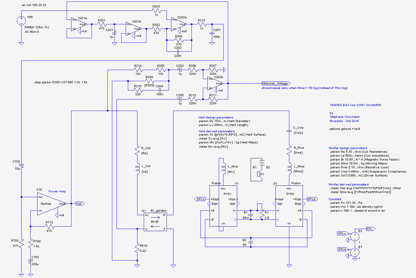

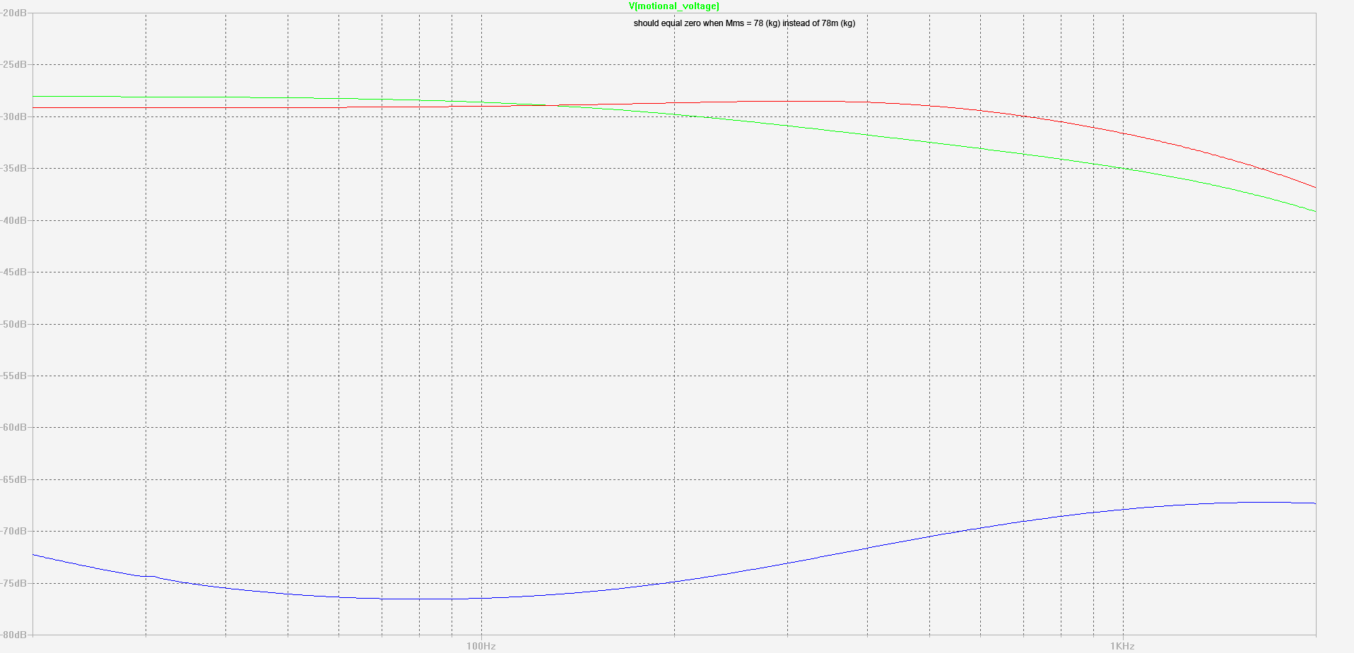

Hi Stephan,
Very nice work but when I load it in LTspice, the speaker model and gyrator don't seem to load.
You need to extract the .zip file prior doing anything. Go in the directory that got created by the extraction. Double click the "Vented Box like Sony SA-W2500.asc" file. LTspice should open and allow you to execute my simulation.Very nice work but when I load it in LTspice, the speaker model and gyrator don't seem to load.

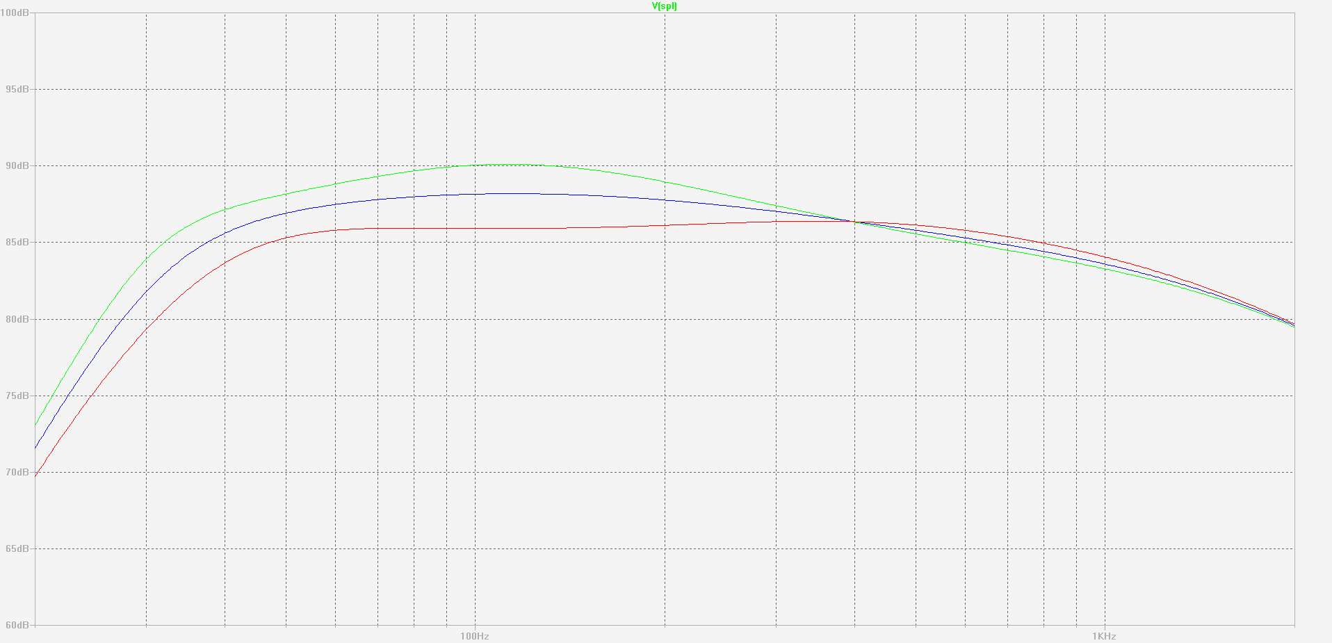

Setting Re = 5.30 ohm (voice coil resistance) makes R209 (1K ohm) ideally tuned.
According to me, C204 (100 nF) is there and optimized for the said-to-be Le (500 µH) coil inductance.
According to me, R210 (220 ohm in this simulation, but 22K ohm in Sony schematic) may be there for taking into account the particular nature of the voice coil. See my post #374 above - Dr. Leach's Refereed Papers - Ahmet Feyz Pirimoglu LTspice speaker voice coil simulation. Please note, in my simulation, the voice coil is a "normal" coil without para-inductance, meaning that R210 is decorative. For better assessing this, one should refine the simulation, by modeling the voice coil inductance like Ahmet Feyz Pirimoglu did. For doing this, we need to setup a LTspice simulation, drawing the woofer impedance curve in function of the frequency. The aim is to model the coil para-inductance, is such a way that the simulated impedance curve, closely matches the measured (physical) impedance curve, from 20 Hz to 2000 Hz and possibly above.

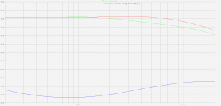

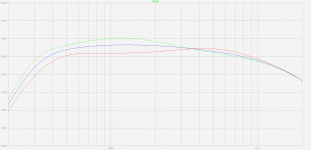

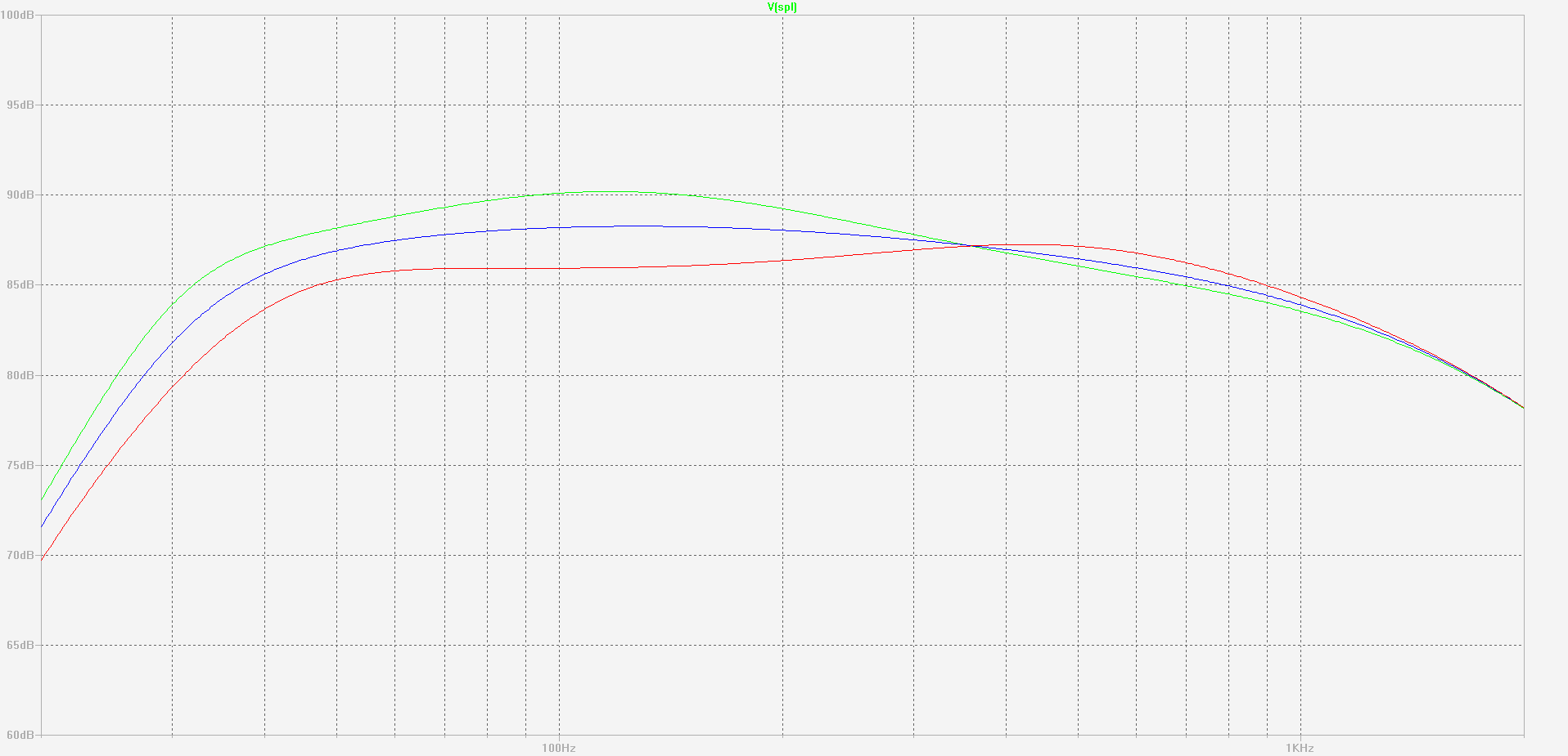

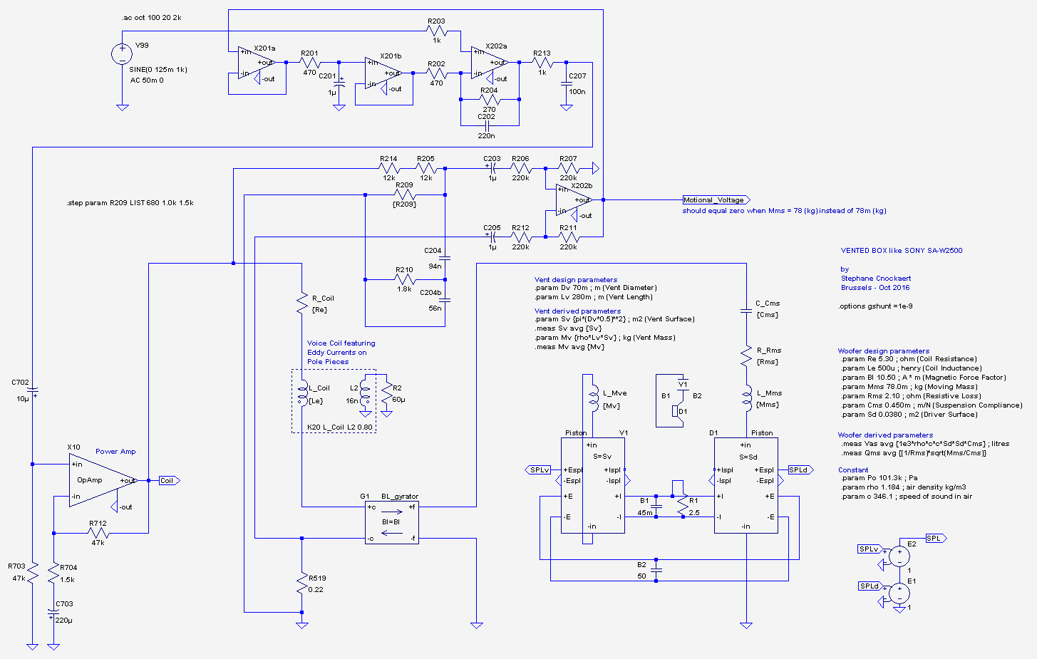

Now with para-inductance simulation. See new attached .zip.
VENTED BOX like Sony SA-W2500 with para-inductance (R209 R210 C204 C204b tuning).png20.8 KB · Views: 114
VENTED BOX like Sony SA-W2500 with para-inductance (frequency response).png20.5 KB · Views: 384
VENTED BOX like Sony SA-W2500 with para-inductance (schematic).png32.4 KB · Views: 408
Yes, setting bridge balance using DC or very low frequency and looking for the null or minimum in the bridge output is an easy way to do it in practice. In Simulation, since you know the exact values of the sense resistor and Re, you can just set the values of the resistors in the opposite bridge arms to have the same ratio.Ah, in days of yore (and by theory) you'd want to balance for DC, frequency of lowest impedance point, or glued voice coil when the speaker is connected! Does that make sense?
Once the bridge is balanced, then you can adjust loop gain. This is adjustment is best performed with the feedback loop broken so you are measuring open loop gain…so no oscillation or smoke. In both practice and simulation, you increase loop gain as much as possible while keeping the measured or simulated phase margin > 30deg. Then, close the feedback loop and measure performance.Today, you could use THD or 10dB before oscillation or 5 dB before smoke comes from the voice coil.Not actually do-able in a simulation I suppose, but just wonderin'.

Circuit looks goodLTspice simulation done. Is it okay like this?
I’m not sure what your goal is, but if you are trying to match performance of the SA-W2500 you will need to use the correct values for R204 = 220, and R704 = 1.2K. These changes will lower the loop gain by about 1.7x from what you currently have and then simulation will match better with actual performance.
What woofer and enclosure parameters are you using?
I posted the T/S parameters and box dimensions I measured earlier in the thread here:Post#211.
I see now that I call out box tuning of 40Hz, but didn’t give dimensions of port.
My recollection was that it was about 65mm in diameter and 240mm long.

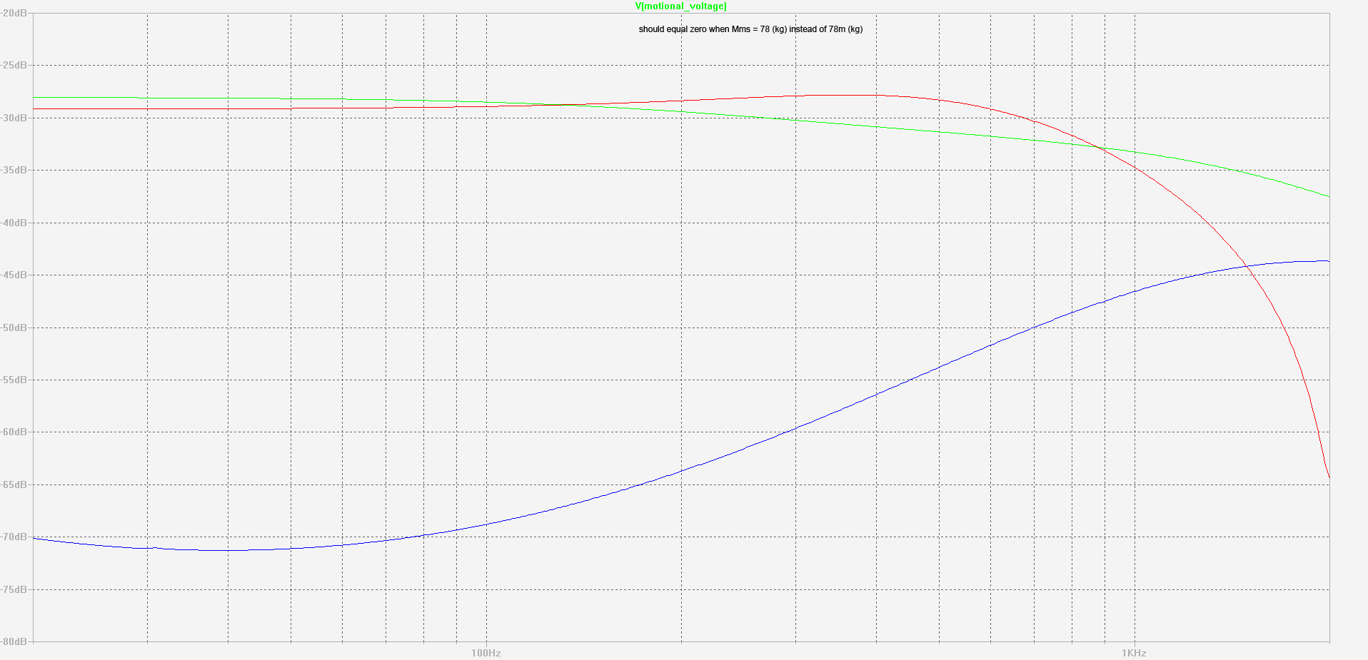

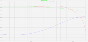

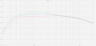

Attached are the Thiele - Small parameters of some 25 cm woofers. I'll try simulating the Sony design with one of those, trying to get a 35 Hz to 120 Hz frequency response, in a 3 dB corridor.
Playing with R202 value reveals the effect of the motional voltage extraction feedback. Increasing R202 value gradually from 0.47 k ohm to 4.7 k ohm corresponds to gradually lowering the feedback.
Sony could have added a woofer excursion protection. Consider X202b output. This is the motional voltage, aka cone speed. Send such voltage into a 3 Hz lowpass filter (aka integrator). The lowpass filter output corresponds to the instantaneous cone excursion. Hook a full-wave rectifier. Hook a peak detector with short attack time and long release time. Add a difference amplifier having a certain voltage gain, one leg is the voltage coming from the detector, and the other leg is a DC voltage corresponding to the maximum allowed excursion. The difference amplifier output could progressively drive a vactrol (LED + LDR combination) or a JFET, acting as input attenuator.

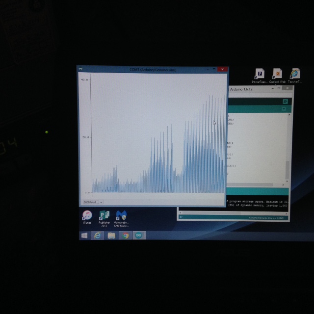

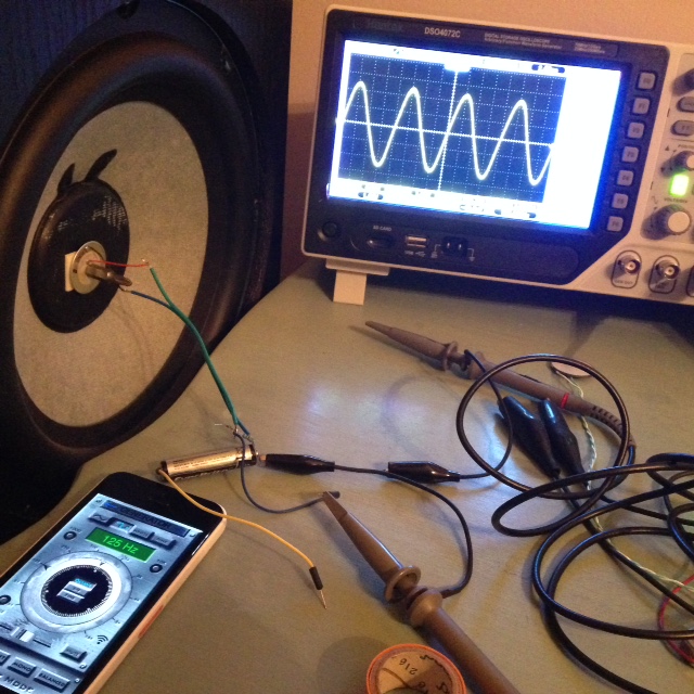

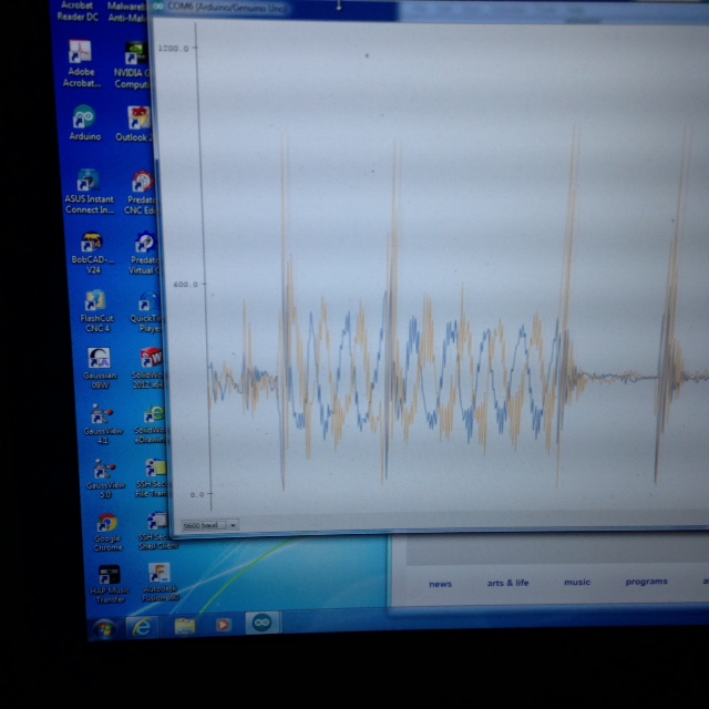

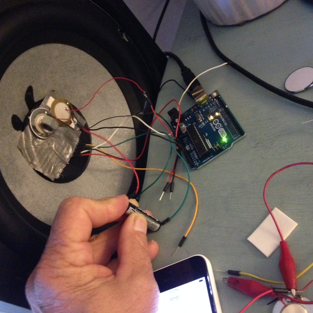

I started reading this thread a couple of weeks ago about motion feedback so I went out and purchased some Sony W2500's, assorted PZT piezo ceramics, and ADXL377 (+/- 200 g's) analog output to begin testing. This is all new and unfamiliar territory for me, but I think it should be possible to substitute the piezo output for the back emf output (with some minor op amp modifications in the circuit already present in the Sony amp board to extend the bass further. I plan to use the modified subwoofers in an in and infinite baffle system. I can tell you that taking the sony woofer out of its box and putting it in a much larger box (using the original amp / feedback) vastly improves the sound. Additionally, I originally thought the Sony mica infused cone woofer was going to be cheap but it is quite lightweight and rigid.
The first part of my efforts here is just to get my bearings and in the ball park of outputs, mounting, etc. Below is a brief progress report on the piezo / accelerometer pilot studies I have been working on. I know there are lots of points to critiques however I just want to get my hands on this concept and try to implement it into something useful.
In the first pic, I have attached (poorly affixed as I do not want to alter the the very solid and flat dust cover or driver yet) piezo and ADXL377 (under the tape). When I handle the piezo (before fixing to dust cover) I feel this thing is sensitive and that flexing the brass plate has a significant effect on the voltage output as much as simulating on / off pressure / rarefraction. I think the voltage output of the piezo can be much greater than the ADXL (about 7millivolts/g). Capturing a good scan on the arduino software is not going to work and I will probably buy an oscilloscope. I understood a priori how critical the fixation of the piezo would be to the driver but underestimated this. I also discovered how critical the orientation of the piezo is with respect to voltage output.
My big concern is when looking at the one photo I have found of Genesis' piezo mounting on the voice coil, I think they have it backwards...or wrong..the pic shows the piezo mounted on its brass plate which makes no sense to me. I would think the small brass plate is the seismic mass that is required to effect a pressure differential during acceleration? This is why I have them mounted this way in the first pic although I think it is wrong..unless the mounting surface under the brass plate is so small that it allows the brass plate to flex which in turn induces a voltage difference in the piezo? But then, the piezo ceramic would have to be cut so the voltage / force is in the radial direction?
In the poor scan shown, the 60hz sine wave output is being shown from the piezo. Attaching a weight (nut) increases output but again, I think the nut should be on the other side. The battery is there in series with the piezo in the circuit to be able to capture the negative wave of the sine wave. I was trying to compare output from two piezos and the ADXL but not satisfied with my set up, but at this point I began to think the piezo was superior device to use for this application vs. the ADXL.

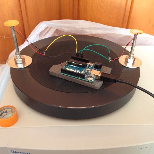

Next pic, by complete serendipity (my career based on it Ha!) I happened to have a sieve shaker (60 Hz) very strong so a couple of pounds on top wont matter..and by some miracle, it has a g-force read out. So I made some short bolts / threaded rod, and to that mounted another bolt to which is attached a piezo...and I have two spots for piezos so I mounted one very securely as per the genesis servo subwoofer orientation and the other the way I think it should be (ceramic side fixed, brass plate free to move)..then I added a seismic mass to it (tape roll affixed to the very rim of the brass plate) - sensitivity up 20-50 fold! Looks like I can get ~1 volt out at 0.2 g's. which will be way more than ADXL and piezo seems much quieter vs ADXL noise-wise. The increasing output shown in the second graph is because when the instrument is powered on is slowly ramps up its g-force.
I need to play around more but I am getting a feel for things. Will need some sort of oscilloscope. I also realize I am rediscovering the wheel here with regard to piezo performance but reading all the tech documents and my understanding how the piezo works would not have led me to think that flexing the brass plate would have such a profound influence on the output.
Any comments or thoughts appreciated...I know a lot of points to critique now but I am learning some things.

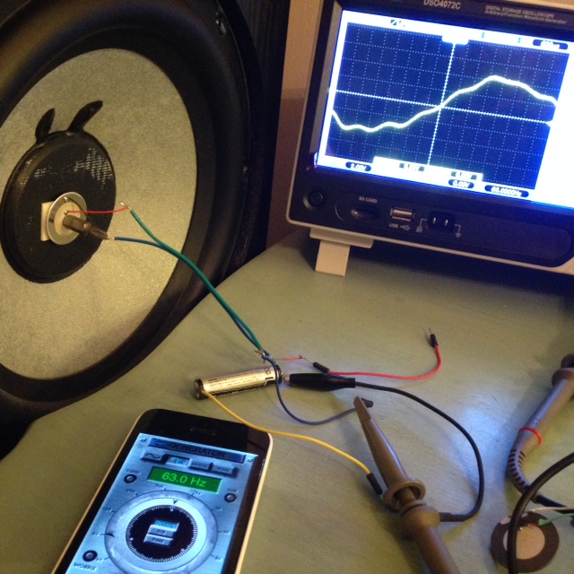

Piezo accelerometer substitute for back EMF in Sony W2500 - Part 2.
First - A big thank you to bentoronto and bolserst for sharing their knowledge and and tips.

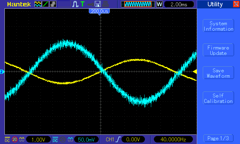

I received my oscilloscope this week and have some data to show. All this is new / first time for me from analyzing piezo's to using oscilloscope, to making circuits, etc. so lots to critique. I do think I have reasonable data here.

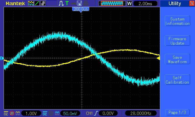

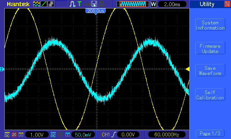

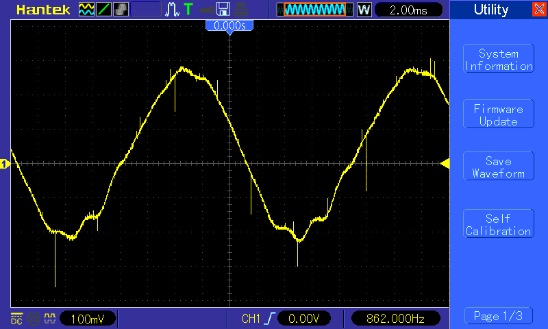

1. Direct readings from piezo
Shown are the piezo affixed to the sturdy dust cover of the Sony W2500 woofer. Mounted / supported from edge of brass ( I think this one is actually aluminum) plate with added seismic mass of a few grams and small surface mounting area at the base to allow for flexing. Not how I would do it in future as the mass it more than needed and sensitivity too high, but it is what I had and is working. First pic (if I get these uploaded in the correct order) is from ipod touch output signal generator at 125Hz. Note the waveform and frequency analysis reading (also 125Hz exact) on the oscilloscope - looks very good, almost too good like I have the ipod touch going directly in the scope (I don't).
Next pic - 60Hz, expanded scale to try to get just one waveform. One can see some harmonics there, but I think it probably is due to the wires acting as strings..the one set of wires is too stiff...need something really fine and flexible.

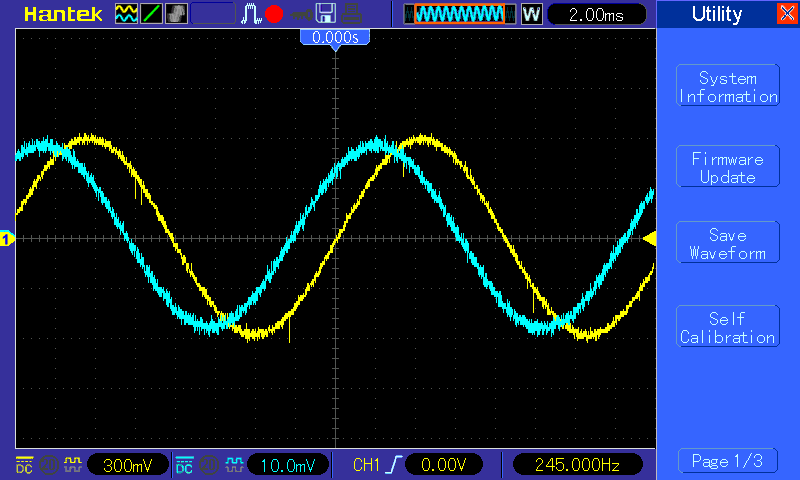

2. Waveforms vs Frequency output from piezo - snapshots
Some snapshots from oscilloscope - sinewave output from signal generator in ipod touch (BLUE trace), simultaneous read from piezo (YELLOW trace).
Note the scale and output of piezo as a function of frequency -output increases to around 60 Hz then tapers off above that I am guessing in part due to cross over in Sony circuit? Also note shift in waveform relative to input wave as a function of frequency. Note the strength of the output from the piezo (different scale settings for input and output)
My thoughts...the waveform from the piezo compares very well to the input signal (at the very low volumes tested). Is the motion feedback from the Sony amp this good or am I not picking up the nuances of the differences between the input and output signal?

The spikes and noise might be just picked up in test wiring. Almost inevitable at breadboard stage. Any wiring links having higher impedance and need shielding?
To see low levels of distortion from an amp on a scope, the usual logic is put the signal through a filter to remove the basic frequency. So whatever makes it through the filter is distortion and noise in the amp.
But the distortion of a cone driver ought to be visible if you closely superimpose it on the driving signal (in which case, it doesn't matter how clean the driving signal is since you are only interested in the visible superimposition to the output signal).
For a driver, a square signal or a non-infinite pulse can be revealing. When you pump in a square wave signal of say, 100 Hz, the device under test would have to be perfect 10-1000 Hz to pass it perfectly. But if you use a 100 Hz signal on a speaker, you would never get a great (or even a good) square wave output... but it would still reveal much about how the speaker is handling the signal.
Likewise for a pulse which will send bass-reflex speakers (or unhoused drivers) into paroxysms of rumble visible on the scope. BTW, listening to how speakers play pulses, undefined as that signal is, dramatically reveals to anybody's ear the benefits of how motional feedback controls speakers. A lot more dramatic than music as a test stimulus. I wonder if bolserst can recall impulse listening tests of his own?
Another test is when you push the system beyond its range. The sensor or driver might get there first! But if the driver is running out of excursion (easiest done at low freq to save your ears and easiest to get driver movin' at resonance). If your sensor is still linear when the driver starts to bottom-out, you'll see fireworks on your screen.
iPod as a signal source. Umm, dunno. On the other hand, any time I've double-checked my test set ups (as you have to do, of course), the analog signal coming out of my Mac laptop headphone jack has been clean beyond anything I can measure reliably.
Moving forward. But with bench R&D like this good stuff, many a hazard along the path.

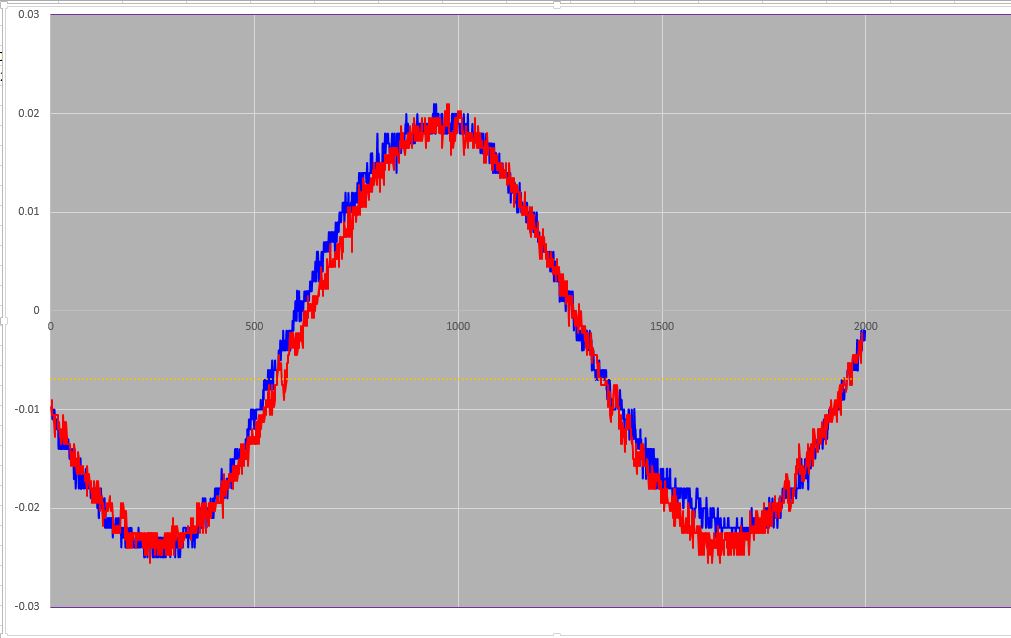

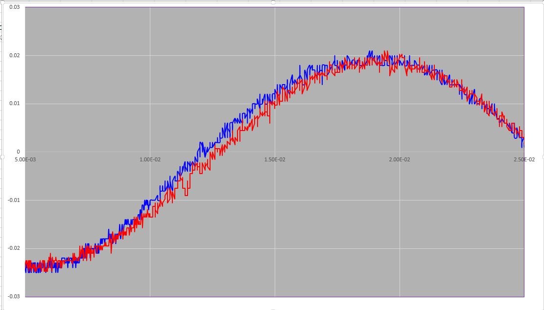

Thank you for your informative posts and suggestions.
Although I liked it, the piezo with the seismic mass has been removed - the added weight, sensitivity and complexity (one more part to potentially fall off or lever / pry off the ceramic PZT layer does not seem necessary. The dust cap on the Sony W2500 is flat and fairly sturdy - I can push the equivalent of ~300 grams with my finger (surface area less than piezo) without noticeable indentation which equates to at least 20g's based on the piezo weight and surface area and I am testing at low volumes so I think this is okay (mounting on dust cap) for now.
Noise spikes really bothering me from my breadboard set up so went back to running the piezo directly into oscilloscope just to get some comparison data that I think is tenable.

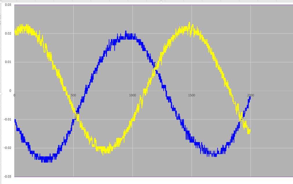

I collected some data simultaneously from input signal from frequency generator (36 Hz) and the output from the piezo mounted to the dust cap in the scope and exported to excel. I manipulated the piezo waveform to overlap as close as possible to the input by adjusting the phase (shifting x-axis values) and amplitude (scaling y-values). My thinking is the difference between the two waveforms would give me an indication of how much correction would be needed from a piezo based MFB. This is with the native Sony MFB active (it would be good if I know how to bypass the internal MFB then have a great comparison / contrast).
Anyhow..here is the data - 36 Hz input.
Figure 1. Raw Data: 36 Hz Input (BLUE trace) and Piezo Output (YELLOW trace)
At first glance, I think this looks quite good. But also makes me wonder if there is much room for improvement. Maybe at higher volumes things would look significantly different?
Figure 2. 36 Hz Input (BLUE trace) and Scaled Piezo Output (RED trace)
Superimposing the waveforms as close as possible showing the difference between the waves - subtle but as expected the woofer acceleration (indicated by subtle difference in slope of the sine waves) is just a bit below that of the input signal.
Figure 3. 36 Hz Input (BLUE trace) and Scaled Piezo Output (RED trace) - Zoomed in.
No too big a difference...is this the efficacy of the Sony MFB at work here? The waveforms match quite well.
Thoughts?

Bentoronto - See above post on superimposing waveforms. Looks pretty good to me at these very low levels. Spikes on signal from op amp are holding me back from adding next step in circuit. Not sure what to do about it other than try to cobble solder things together without PCB.
I understand about trying the square wave as the acid test. Supposedly, the Genesis Servo Bass loudspeakers are the only speaker that can in fact reproduce a square wave.

Great stuff. I was on vacation, but gnobuddy sure knows things I don't (and maybe vice versa).Bentoronto - See above post on superimposing waveforms. Looks pretty good to me at these very low levels...I understand about trying the square wave as the acid test. Supposedly, the Genesis Servo Bass loudspeakers are the only speaker that can in fact reproduce a square wave.
With waves superimposed that way, even little nice-looking departures from matching represent big distortion. Run both signals through an RTA like in REW and see.
Square-wave or impulse signals need a few octaves bandwidth to pass, still you can feed it to your speaker, even through a crossover. Just a matter of what to expect on the scope. With MF, watching the drive signal is great fun because you will see monumental voltage efforts to correct the massive (relative to air) cone inertia (both on onset of pulse and on offset)... which means the MF is working properly.
While it is conceivable that a cone could sort of trace a square wave reasonably well, what a mic picks up is awful looking.
As far as sound to your ear goes, like with cone motion, you can't expect a chirp from a sub playing an impulse (or whatever a square wave might sound like if played in Disney's Fantasia movie). But MF will grasp increase the crispness (speed?) of the sound.
