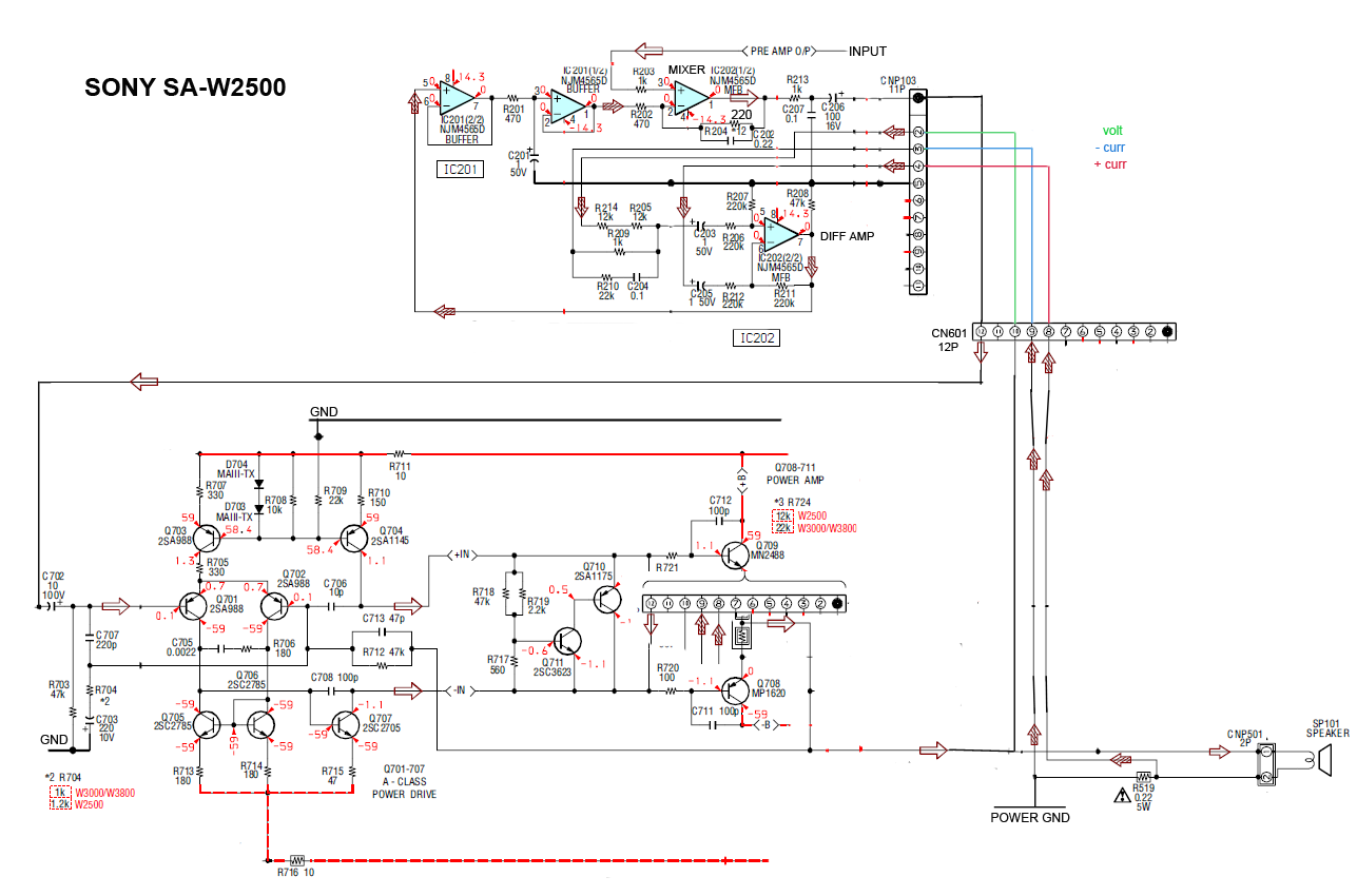

There is a lot of confusion here. Just obey the facts. Sony applies voltage feedback (just as normal) and also current feedback (the 0.22 ohm resistor voltage drop processed by an op-amp). Same as the Yamaha YST-series subwoofers. Such current feedback is a positive feedback. The more output current, the more output voltage. As consequence, the power amplifier emulates a negative output impedance, say - 2.5 ohm. Such negative impedance comes in series with the voice coil copper resistance, say + 3.5 ohm. The system behaves like there is a woofer having a 1.0 ohm copper resistance. The woofer electric damping has thus significantly improved in the low frequencies. This is a significant Thiele-Small parameter change (should I write optimization).
The Yamaha does use positive current feedback to modify the amplifier output impedance.
However, if you trace the circuit for the Sony, you will find that it is not using positive current feedback.
Sony is using a bridge circuit to extract the back-EMF signal and provide velocity feedback.

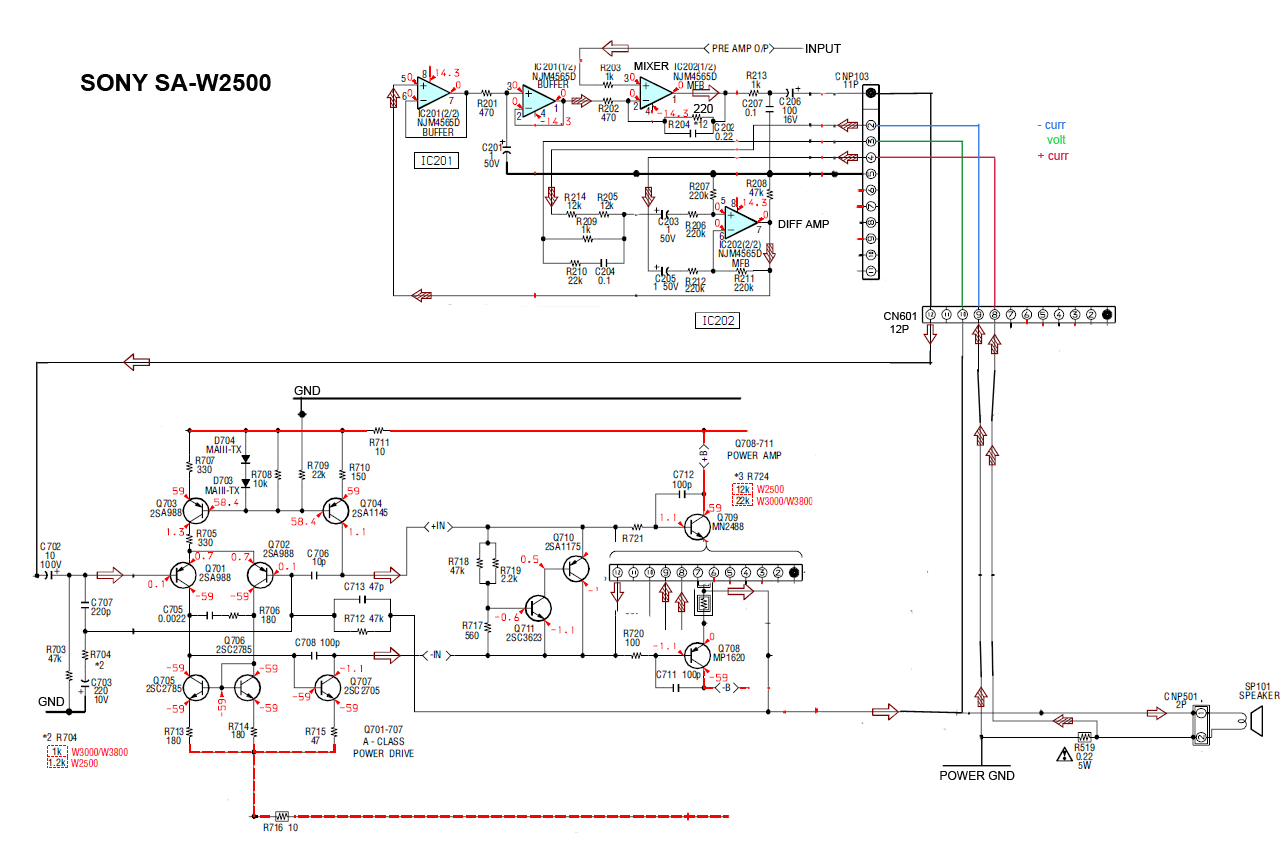

The Yamaha does use positive current feedback to modify the amplifier output impedance. However, if you trace the circuit for the Sony, you will find that it is not using positive current feedback. Sony is using a bridge circuit to extract the back-EMF signal and provide velocity feedback.

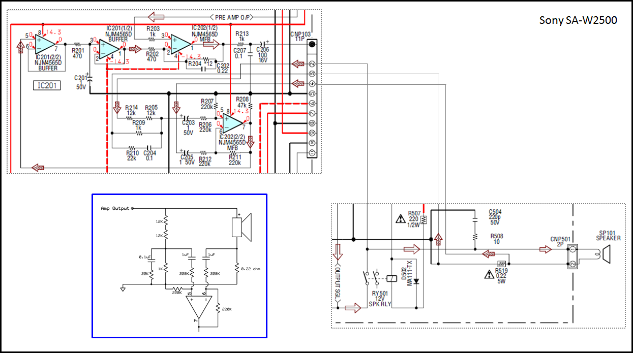

I looked at the Sony service manual. Attached is a simplified circuit diagram. I agree on your bridge feedback idea exploiting the current in one arm, and the voltage in the other arm. I disagree with you about the current feedback. I still think that the instantaneous current measurement serves as positive feedback.
In order not to create a ground loop, Sony relies on a differential amp having four 220K resistors for measuring the voltage drop on the current sensor (R519 0.22 ohm). Such differential amp gets slightly out of balance because of the two 12K resistors in series in the positive branch.
A closer examination reveals that the positive branch of the differential amp gets corrupt by the injection of the voltage feedback materialized by R209 having a value of 1K. Indeed, the "- curr (blue)" signal gets attenuated by a factor of 25 prior entering the differential amp. While at the same time, the "+ curr (red)" signal enters the differential amp without being attenuated. This is unorthodox, and far from academic. One should verify the printed circuit boards tracks, for determining if the circuit diagram duly reflects the circuit board tracks.
There is a problem with CNP103 and CN601 connecting the two boards. Their wiring is tricky. The CNP103 pins don't match the CN601 pins. Can somebody take a picture of the wiring ?
For sure, the "volt (green)" signal is working as negative feedback.
I say this because it enters the positive side of the differential amp (R209 1K), then goes through the two buffer op-amps in series, then enters the mixer op-amp which is low gain inverting, then enters the power amplifier which is non-inverting (amplification factor defined by R712 and R704).
Consequently there is a high probability that the current arm of the bridge is working as positive feedback. I have thus connected CN601 pin 8 to CN103 pin 4, and CN601 pin 9 to CN103 pin 2. This way, the "+ curr (red)" signal enters the inverting input of the diff amp, then goes through the two buffer op-amps in series, then enters the mixer op-amp which is low gain inverting, then enters the power amplifier which is non-inverting (amplification factor defined by R712 and R704). As there are two inversions, this is indeed positive feedback. My hypothesis, thus.
I remain highly perplex.
We should simulate this using LTspice.

The conclusion of my former post is that Sony is faking a differential measurement of R519 (0.22 ohm) voltage drop. As consequence, as soon as there is a voltage difference between the power ground and the signal ground, such voltage difference will corrupt the current feedback signal. Fortunately, it is the "+ curr (red)" signal that's entering the "differential amp", without being attenuated. The current feedback is thus there, however of poor quality because of being not immune from ground noise.
Imagine now, my hypothesis about the "+ curr (red)" and "- curr (blue)" signals to be wrong. That would mean that the ""+ curr (red)" signal gets attenuated by a factor of 25 prior entering the "differential amp". That would mean also, that it is the "- curr (blue)" signal, that's entering the "differential amp", unattenuated. And such signal is the power ground potential. Which then means that there is no current feedback at all. You promote ground noise, that's all.
I found another glitch. You may have noticed it, there is a kind of nonsense with R209 (1K) having in parallel (R210 (22k) + C204 (100nF)). Is the Sony implementation so critical, that it is required to wire a frequency compensation network, that's providing a frequency-dependent correction of less than 0.4 dB?
I guess it depends how you want to think about it. If you want to think about the positive and negative feedback paths in isolation and then sum to get the combined effect, that is fine. The negative feedback definitely dominates with a bridge circuit even if the bridge is out of balance by 10% - 20% as is the case with the Sony. I find it easier to think in terms of the output of the bridge which, when balanced, nulls out the contribution to the current from the amplifier drive voltage so that you are left with only the current contribution due to the back-EMF. Recall that the back-EMF is proportional to VC velocity and opposite in sign to the amplifier driving voltage.
From a signal perspective, with positive current feedback, the signal entering pin 2 of the mixer(IC 202 1/2) would dip or reach minimums at the impedance peaks. With negative velocity feedback, the signal entering pin 2 would peak or reach maximums at the impedance peaks. The feedback signal I measured definitely was of the later variety.
One should verify the printed circuit boards tracks, for determining if the circuit diagram duly reflects the circuit board tracks….There is a problem with CNP103 and CN601 connecting the two boards. Their wiring is tricky. The CNP103 pins don't match the CN601 pins. Can somebody take a picture of the wiring ?
When I was inspecting and measuring the Sony, I did verify that the circuit as built matched the schematic. You are right though….the two connectors shown in the service manual don’t match pin numbers. But pin locations are correct when you line up the missing 2nd pin on CNP103 with the unused 2nd pin on CN601.

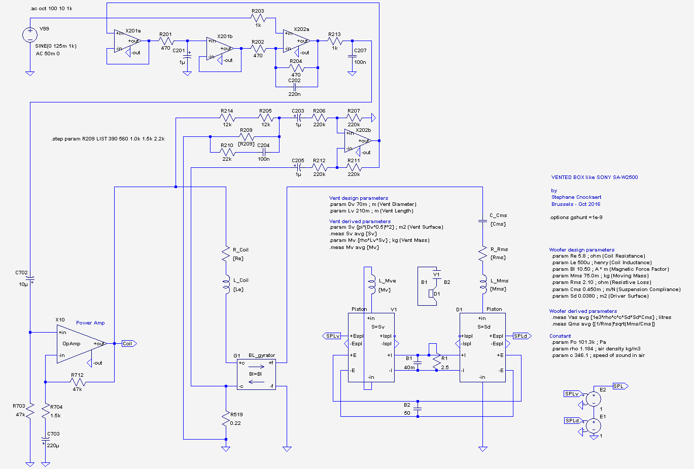

I am about to simulate the circuit using LTspice. Can you please tell if "my" schematic in post #392 above, is correct?
Almost...swap your blue and green wires at CNP103 and you are there.
When working simulation, you might start with a 6.5ohm resistance to represent the speaker, and remove R210 & C204. Then balance the bridge by changing the resistance of R209 and until the output of the bridge at pin 7 of IC202 (2/2) is minimized...output will be very small when balanced/nulled correctly.
Then, add inductance and LCR components to represent the mechanical part of the T/S parameters shown in attachment#2 of Post#211. You will now see output from IC202 (2/2) representative of woofer back-EMF(velocity). Finally, you can add back in R210 & C204 to see the small effect it has at improving balance of the bridge at frequencies > 1Khz.

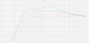

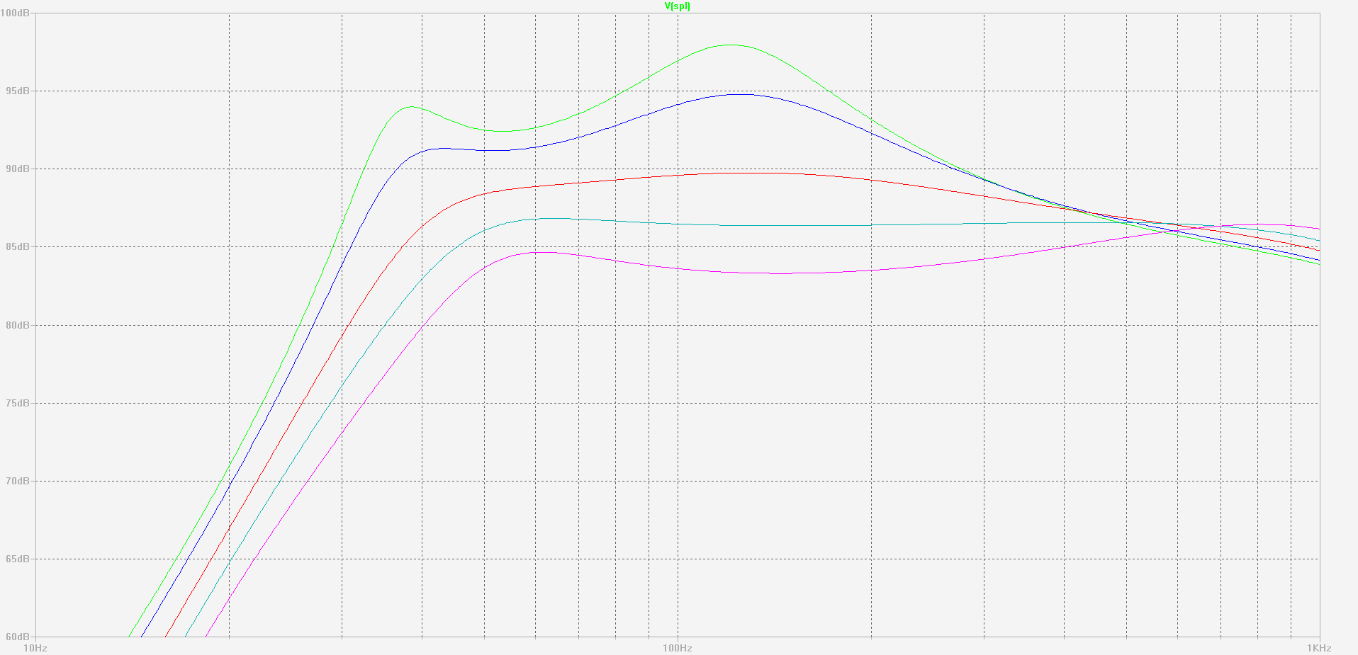

LTspice simulation done. Is it okay like this? The .zip allows you to reproduce the LTspice simulation.
