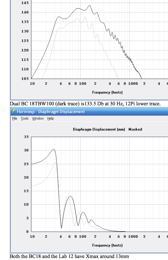

And here is the problem (or at least a problem). For years now I've been telling you that horns have resonances all through the passband, and yet you still believe they are fundamentally different than bass reflex and that the statement "the cone motion around resonance does not reflect total sound output" does not apply to horns.
You are very wrong about horns, the sealed chamber doesn't make any difference, the resonances are a result of the horn flare and horn resonances look remarkably similar to bass reflex resonances in the excursion graph because resonances are resonances.
Here's a picture to illustrate the point. The top row shows frequency response and excursion of a best case scenario - a single driver in a 4500 liter full size 31 hz ideal reactance annulled front loaded horn with 2:1 compression ratio.
The bottom row shows a much smaller, more practical front loaded horn (370 liters) with the same driver.
If you actually look at this data or at horn measurements (frequency response vs impedance of any horn you like) you will see that "making cone motion right makes the output wrong* is a nonsense statement.
The resonances are an integral part of the nature of horn operation. The horn resonances cause a deep notch in the excursion curve, this is not "wrong", it how it works. It doesn't need to be corrected because it's operating properly. If you did "fix" the excursion by making it linear (no dips) the frequency response would be unusable.
Also the frequency response doesn't need to be "fixed" it's designed to be usable without correction, aside from possibly a bit of minor eq.
You should have noticed this on your own by now, having owned front loaded horns. And if that wasn't enough, I've been telling you this over and over for over 2 years now. Look at the graphs.

1) A "true horn" is one that is blown through. A so called "tapped horn" shares some attributes of both FLH and BR designs.
2) The same holds true of what you believe to be a "true horn", only more so, due to multiple resonances.
3) Your not believing facts makes no difference to the fact.
4) No, as anyone can easily see from the excursion in a small rear chamber FLH (and I have, using clear plastic viewing panels) their excursion goes through more than one minima and maxima.
5) Your fifth statement is more or less useless, in light of the fact that your statement #3 ignores facts any horn designer, or anyone familiar in the art is quite familiar with, as this "Art" has been familiar with for over 40 years. In those 40+ years I have been using and designing horns of every description for live use, the most demanding application for reproduction systems. As well as horns, I have extensive use of hybrid dual resonator cabinets, such as the Karlson design, it being the first cabinet I built in 1972, after literally growing up listening to the 8" Karlsons my dad built when I was around 4 years old. Fred, the Karlson Evangelist, now owns those two pieces of my childhood, it is funny how something I thought was "great" 45 years ago was not, after listening to cabinets that have far flatter frequency and phase response for the last 35 years.
An illustration simulating both the output response as well as the excursion required to achieve said response of a FLH cabinet of approximately 30.5 cubic feet net volume, using dual drivers, with two different driver options, an 18" B&CTBW100, and a 12" Eminence Lab12 are offered for your elucidation below.
