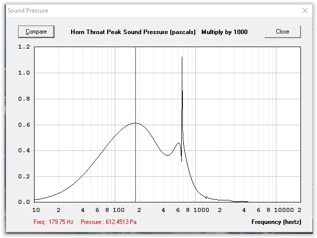

Just for fun I simulated a very short horn for a B&C 18SW115 w/ a drive voltage of 120Vac, the throat pressure peaked out @ 612Pa/180Hz. A normal driver installation @ more reasonable level should be quite a bit lower. 🙂

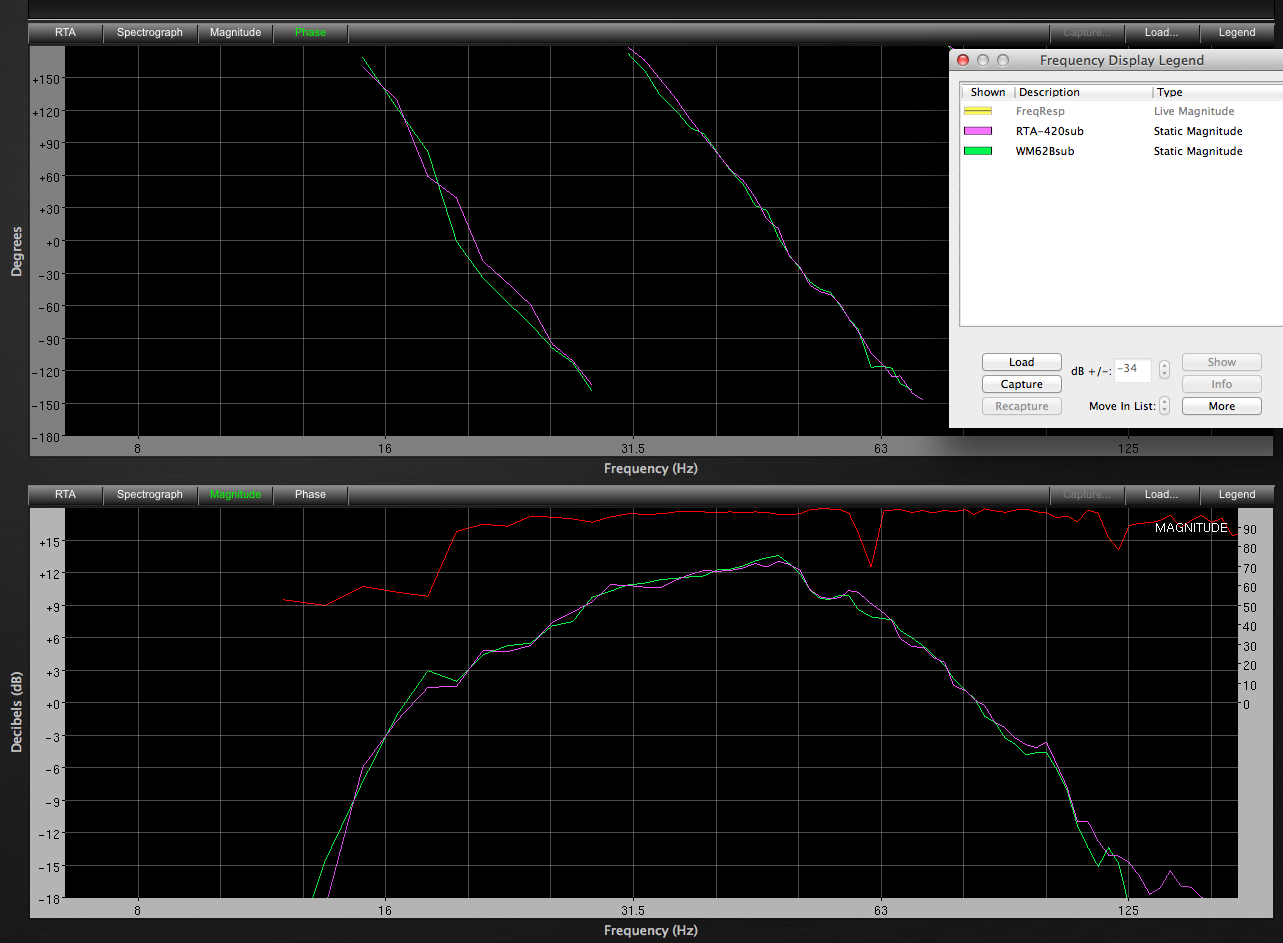

Yes, and those $5 back electret microphone elements are the same as used in many test microphones that have been used by thousands of DIY folks such as yourself, and professional engineers for testing tens of thousands of loudspeakers.
You can see for yourself in the measurements below that the $2.50 Panasonic WM62 (1998 new element only price, less phantom power supply) reads almost identical to the $50 (used, 2010) RTA-420 test mic. Both mics were placed in as close to the same position during the tests as I could manage short of using a micrometer.
The RTA-420 reads almost the same as the B&K 4004, though there is a HF deviation between the two B&K 4004 that puts the RTA-420 as a closer match to one of them than the pair. As mentioned, the RTA is about 2 dB down at 20 Hz compared to the B&K 4004.
You don't need to spend big $$$ to have reasonably accurate gear, but if you want to go "all the way", the tickets get expensive, and don't insure results- the test mic that came with a $1600 Terrasonde Audio Toolbox that I was sure was "the real deal" was about 10 dB down at 20 Hz, the worst response of any back-electret mic I measured, other than flat out defective ones. I did not discover the problem until I started testing my test mics.
I'd be willing to wager your average cost per year keeping your stereo system alive with a few changes every decade or so is considerably less than what most people spend on coffee.
Nothing wrong with being cheap, but there is no excuse for ignorance when the information is at your fingertips- try spending your time looking up some concepts, rather than the price of my esoteric mics, and you might actually come closer to achieving your audio goals.
That said, it is patently obvious you are not on the forum to learn or achieve any audio goal, you are here to troll.

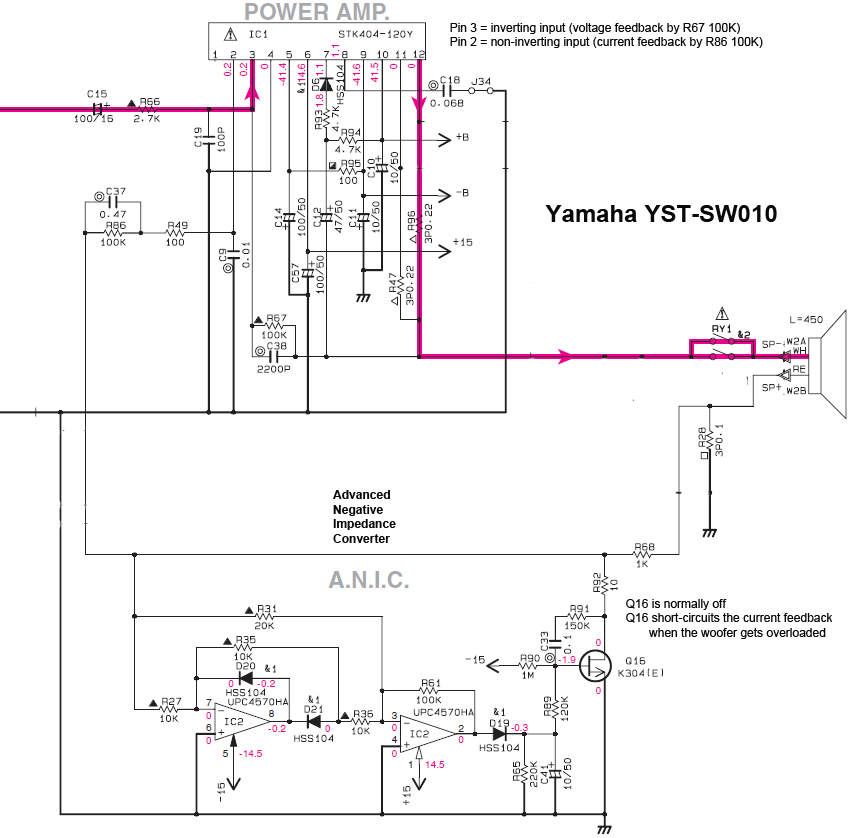

There is a lot of confusion here. Just obey the facts. Sony applies voltage feedback (just as normal) and also current feedback (the 0.22 ohm resistor voltage drop processed by an op-amp). Same as the Yamaha YST-series subwoofers. Such current feedback is a positive feedback. The more output current, the more output voltage. As consequence, the power amplifier emulates a negative output impedance, say - 2.5 ohm. Such negative impedance comes in series with the voice coil copper resistance, say + 3.5 ohm. The system behaves like there is a woofer having a 1.0 ohm copper resistance. The woofer electric damping has thus significantly improved in the low frequencies. This is a significant Thiele-Small parameter change (should I write optimization).Thanks to all for largely sensible discussion. MF in a ported tuned box is totally screwball, but yet still within the territory of HiFi screwballland. Anyone with an understanding of the perverse relation between cone motion and sound output in a BR will understand why. Of course, maybe that wouldn't stop Sony. Even if MF in a BR is actually counter-productive in the bass region, it has benefits everywhere else in the compass. And it is possible, the tuning is nothing like the usual TS-BR theory and it does work beneficially in some unusual way with MF.
I wrote "in the low frequencies" because the voice coil inductance is made of resistance (copper material) and inductance (coil shape having an iron core). The Yamaha/Sony system only decreases the copper resistance. It doesn't reduce the coil inductance. At 1 kHz, in case the coil inductance is 0.5 mH, the module of the inductive impedance rises to 3.14 ohm, indicating that at 1 kHz, the electric damping doesn't get improved anymore. This is the reason why such simple positive curent feedback, gets confined to subwoofers having a bandwidth of 100 Hz or so.
One may try adding a small coil in series say 33 µH with the 0.22 ohm resistor acting as current sensor. This way the positive feedback voltage will take into account the inductive nature of the voice coil, possibly extending the electric damping effect to 300 Hz or so. Try designing a bass-reflex enclosure having a 12-inch woofer only exhibiting a 1.0 copper resistance. Good luck !
Do you get a realistic box size, and a realistic port length and section ?
If not, revert to a closed-box approach.
You'll reinvent the "Servo-Sound SL15" or "Servo-Sound SL20" dating back from 1969.
You'll reinvent the "3A Andante" dating back from 1974.
Anyway, can we say that the woofer coil, truly behaves like a 3.5 ohm resistor having a 0.5 mH coil in series?
I don't think so. Current feedback normally is negative feedback, just like voltage feedback. What they might have done is split the feedback in a current part and a voltage part, each derived from a mirrored high/low filter. I did the experiment with an LM3886 in an attempt to lower driver distortion; voltage feedback in the resonance region of the driver, transitioning to current feedback for higher frequencies. It works, but dunno if this is what Sony did. Positive feedback seems out of the question, though.
Think twice. Get the schematic and simulate it using LTspice. Try with a closed box first.I don't think so. Current feedback normally is negative feedback, just like voltage feedback.
In the Sony / Yamaha subwoofers applications (vented box), the positive current feedback is there for significantly reducing the virtual coil resistance (from 3.6 ohm to say 1.8 ohm), kind of Thiele-Small parameter optimization in function of the wanted box size and vent size. Yamaha adds a trick. When the woofer tends to get overloaded, a FET progressively makes a short circuit on the current feedback signal. Consequently, the virtual woofer coil resistance progressively increases from say 1.8 ohm, to the 3.6 ohm physical value. Consequently, the woofer current gets progressively reduced by 6 dB. This provides a 6 dB headroom extension, causing less audible artefacts than adding a FET limiter at the input.
In a closed box application, the positive current feedback is there for radically reducing the apparent coil resistance (from 3.6 ohm to say 0.9 ohm) for attaining a very low Q factor. The lower the Q factor, the more the frequency response tends to a 1st-order highpass between 35 Hz and 100 Hz. Add a 1st-order equalizer at the input (bass boost with two resistors and one capacitor), and you get a frequency response that's essentially flat from 35 Hz to 100 Hz, and this remains true when the box is small.
By the way this is not MFB (Motional FeedBack). Call it degenerated EMFB maybe (Estimated Motion FeedBack).
MFB means "feedback based on real motion". MFB should thus rely on a mechanical sensor, like an accelerometer (Philips MFB).
EMFB should base on a circuit taking the voice coil current as input, and estimating the instantaneous voltage drop caused by the voice coil impedance (which is more elaborate than a resistor and an inductor in series).
You then subtract such voltage drop from the actual voice coil voltage.
The result of the subtraction is the motional voltage, which is directly proportional to the coil speed, to the coil motion should we say.
And, you shall use such motional voltage, as sole and only global negative feedback. Or possibly, such global feedback governing a power amplifier having a voltage amplification of 1,000 (one thousand) or so.
Good luck ! Most of the time you end up building an oscillator.
The best you can do is to elaborate the voltage drop, and only discount 80% of it, from the actual coil voltage. This, in the context of a power amplifier having a voltage amplification of 150 or so (about 4 times more than what you really need). This way you implement a 80% EMFB system, that should remain stable.
