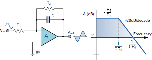

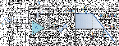

There are two major ways to use a piezo sensor.In my crude set up, the piezo seems to be very sensitive - the problem area are the spikes noise in my breadboard setup
One is to treat it as a voltage source in series with a rather small capacitance (usually only a few hundred pF). So you feed it into a very high resistance, forming a high-pass filter. Your resistance needs to be really, really, really, high, so that the -3dB frequency of the filter is at least ten times lower than your woofer resonant frequency. The extremely high resistance tends to make the circuit very susceptible to noise and interference pick-up.
The second way is to treat the piezo as a current source. If you short circuit a piezo, the (tiny) current from it rises linearly with frequency (doubles for every doubling of frequency).
You can take advantage of this by running the piezo straight to the inverting input of an op-amp configured as an integrator (feedback cap from output back to inverting input). You still need that really, really big resistor in parallel with the capacitor, to keep the op-amp input bias current from driving the output all the way to saturation as the integration capacitor charges up. You also need a JFET-input op-amp, so that input bias current is really low.
Since you have negative feedback via that integration capacitor, the inverting input of the op-amp is a virtual ground. Running the piezo straight to this ground effectively shorts it out - but the piezo output current goes through the integration cap, so you get your piezo sensor output voltage on the opamp's output pin.
Using this method gives you much better noise immunity. The virtual short-circuit across the piezo makes it much less prone to picking up electrostatic interference.
This second method is sometimes called a "charge mode amplifier", since the integration capacitor collects the electric charge generated by the piezo when it is deformed.
You can find a little more information about charge mode amplifiers for piezo sensors in section 3.2 of this Texas Instruments PDF : http://www.ti.com/lit/an/sloa033a/sloa033a.pdf
-Gnobuddy

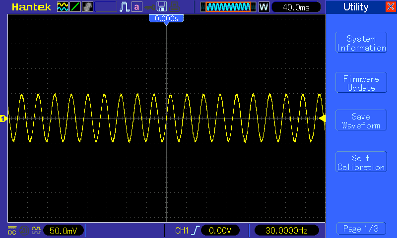

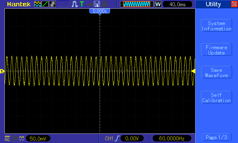

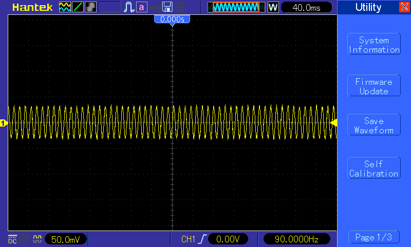

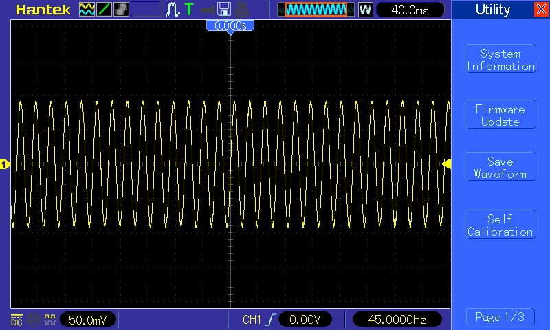

Here are my near term objectives for this Sony W2500 project:
1. So far, I have compared the input signal (from ipod to amp) to the piezo output noting frequency dependent phase and amplitude, but I think a better approach would be to look at the signal coming out of the output of the op-amp (IC104 reference to Sony SA-w2500 Schematic Diagram Input control board). If I understand correctly, this is the signal that would be compared to the output of the piezo (after some processing). I have identified the IC104 op amp but not sure which pin is the output but can probably figure it out once I find the specs sheet on it (IC104 is NMJ4565D). I don't know if I can access that pin to get a probe on it though...may have to try to solder a hair thin conductor on pin 1? to bring the signal up away from the board so I can get a probe on it.
2. I would like to do a comparison of the piezo output signal with and without the native built in MFB. I am not sure how this can be safely done without damaging the amp...short out feedback resistor? But that doesn't make sense to me as I would think doing this (shorting out the resistor) would cause the amp to think it needs to put out max power to try to get the speaker to move as a shorted MFB resistor implies no woofer movement?
3. Get some voltage readings across that feedback resistor (R519) as a function of frequency / amplitude.
4. Work on my noisy op-amp circuit.
Crazy thought....what if one could judiciously match the piezo output to the voltage difference across the feedback resistor R519 and just pipe it (instead of that from R519) to IC202 and use the existing 4 MFB- associated op amps in the Sony circuit ? At first glance, this sub circuit of op amp look like they have much of what is needed already in place. Could 20 Hz for $0.20 be in the horizon ?

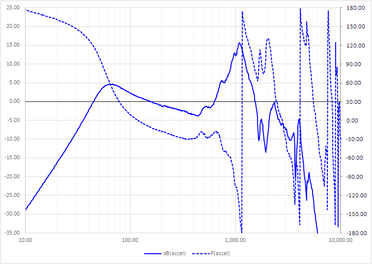

Ok, now for the promised levity…measurements of the Sony SA-W2500 “subwoofer”
Attachment #1: Here is measurements of port, piston, & summation made straight from the test computer, no EQ, no MFB, just woofer + box response.QUOTE]
May I inquire how you measured the response without MFB - curcuit mid?
I did it a number of different ways. The easiest is to solder a temporary short across C201. This grounds the input of the buffer stage for the MFB signal, effectively removing all the feedback signal reaching the opamp that subtracts it from the preamp signal.… how you measured the response without MFB - curcuit mid?
Be aware that the preamp includes an underdamped HP filter built around IC103(2/2) which adds a +6dB EQ boost around 40Hz and rolls off -12dB/oct below that. If you plan to use the SONY electronics module for an accelerometer based MFB system, you will want to fix that. If you remove R125 (5.6K surface mount resistor) you will remove the boost, and have a flat response down to a -3dB point of about 16Hz. Also, you will want to transplant the woofer into a sealed enclosure or effectively seal or block the port.

I am trying to figure out a non-destructive way to probe the output of the signal coming out of IC104 op amp (that would be compared to the output of the piezo) to get an idea of phase and amplitude rather than comparing the frequency generator output to the piezo output as I have previously shown. This is because there is a band pass and other caps in the preamp pathway to IC104 which must be shifting the phase. But the IC104 output pin (similar to all the other solder joints on the board) are tiny! I don't want to bust out the solder gun yet - any tricks to probing such small points on the board?
Maybe tonight, I can see if I can at least get a read across the 0.22 Ohm MFB resistor just to see what's going on there.
I have a question for GnoBuddy if you don't mind me asking - what happened after you succeeded in creating you MFB system? That must have been an exhilarating feeling. You mentioned the 8" woofer you applied MFB to was too small so why not scale up to a couple of 12" woofers? It seems like once you had a working system, and one working so well, the temptation would have been to do more / home installation in the walls...something?
First readings: Voltage across Sony W2500 0.22 Ohm MFB Resistor at Various Frequencies
Proud of myself here...managed to get a probe on the MFB resistor without shorting things out and get some measurements. I kept amplitude from frequency generator fixed (low volume) and took snapshots of the waveform at 30, 45, 60 and 90 Hz. The frequency indicated on the scope snapshots is in excellent agreement with what I was feeding into the subwoofer preamp. Note amplitude dependence as a function of frequency.
Fig. 1. 30 Hz
Fig. 2. 45 Hz
Fig. 3. 60 Hz
Fig. 4. 90 Hz
Fig. 1. 30 Hz
Fig. 2. 45 Hz
Fig. 3. 60 Hz
Fig. 4. 90 Hz
